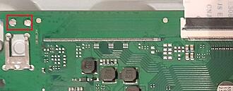

    hi guy my friend gives me this tv a 50tu8070u that has no picture at all, sound ok, backlights ok. i tought it was a bad panel, but the tv has many horizzontal lines green, i tried with the tape method but nothing change, only the green lines disappear but still no picture. You that have more good than me, do you think it s a panel or can be the main board, because my friend wants buy a new main board....but the tv respond to the remote control, have sound only no picture so i think it s a panel problem that is so broken that i cant fix with tape...or i wrong if someone can help me thanks, i give you the photo of the panel
  • Diah
    • Feb 2013
    • 6500

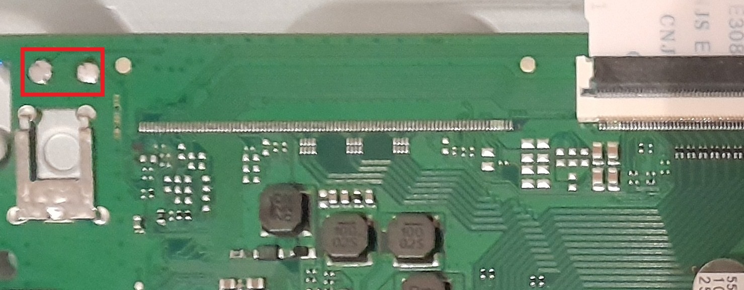

    50 size panel are rubbish ......make jumper between this 2 feedback points, then disconnect one half screen ( U Ribbon on the panel buffer boards ) see which side will make picture and clean

      thanks diah but i give it back to my friend...how u say display is rubbish...so he will decide what to do thanks for your help, but he is stubborn say it the main board...
