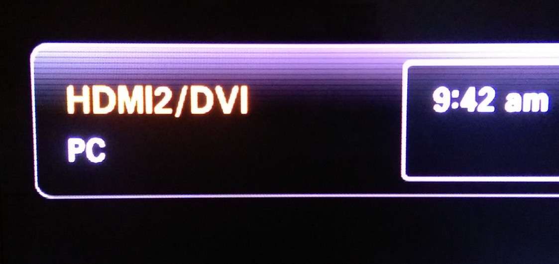

    So not long after my original report above, the TV started to display a more serious problem. See here:
    https://www.youtube.com/watch?v=VR5zBy14yys
    I shared the video with a repair service and their first thought was something going on with my main board. This prompted me to remove it, inspect and clean all cable connections and look for any other signs on trouble. I found nothing obviously wrong and reinstalled everything.
    What do you know.....it has been a couple of weeks now and I am not seeing that particular problem anymore!
    The original horizontal lines are still there, however. But, this got me thinking....if you look closely at the video around the 24 second mark, the channel indicator graphic does not appear to have any lines through it! Of course, it is possible my low quality video is simply not able to resolve them properly but I dunno....it looks too smooth to me. So, if this more serious image stabilization problem temporarily replaced the horizontal lines and I have since returned to a stable image by working on the main board, perhaps my lines problem can be traced to the main board only.
    I am sure there are any number of reasons that would cause horizontal lines in the display to appear besides the most common one being a bad panel but could a faulty main board be the cause of what I am seeing in my original photo?
    I have a attached a better image of the lines I am seeing right now.

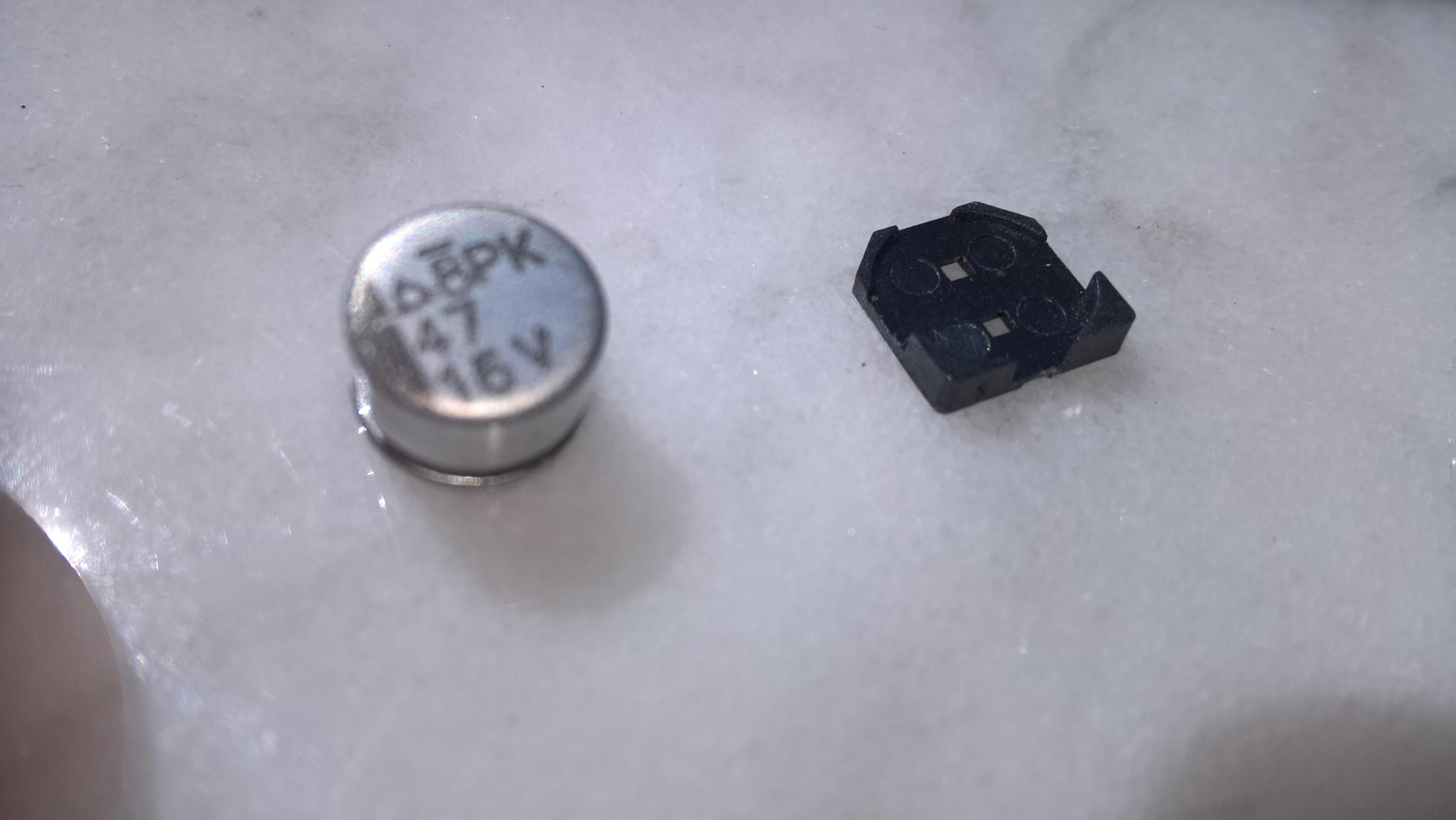

                      Yahoo, I get to join this club - NOT
                      Anyway, same TV, horizontal lines as described in right side of screen. Exactly like the very first post - just on the right side.
                      Also have bulging 25v 1000uf @ CB855
                      But I also noticed an odd thing when I was dissaembling the TV. A solid state capacitor fell to ground. I have no idea where ti came from.
                      I check but didn't notice any missing capacitors. I posted a pic - any ideas about it's origin?
                      I loved this TV so much. It saddens me that it's on it's death bed.

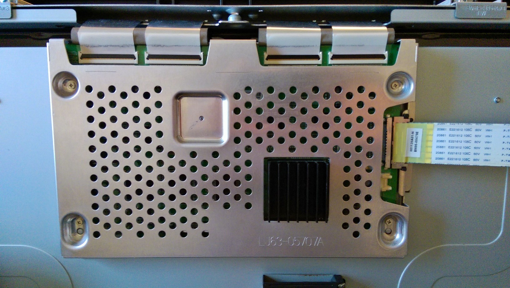

                        Well, a follow-up!
                        I gently removed and reinserted the ribbons from the top of the Tcon board to the panel - BOTH ENDS. I Basically messed around, blew some air, took our the ribbons reinserted while the tv was on in Demo mode - over and over until somehow - poof no more horizontal lines.
                        I Still have to replace the PS caps and have no clue as to where that mysterious cap came that fell out during disassembly. See prior post for pics.
                        Stay Tuned. Please wish me luck!

                          Re: 2008/9 Samsung LN55A950 Displaying Horizontal Lines
                          Originally posted by hexpope
                          I have the same issue with another TV, It's funny as I cleaned and then while the TV was turned on I started playing around with the ribbon cables and everything and nothing changed it was exactly the same. Now after two hours of looking around and checking voltages, it has some mysteriously come back perfect.
                          Would this be a TCON board issue, or the set ribbons leading to the different sections on the main panel ?
                          NOTE: It's the ribbon cables on the Panel. Time to restock the parts bin and send the rest to the recycling Centre..
                          I need help getting new cables or finding equivalent. What are general specs on these cables?
