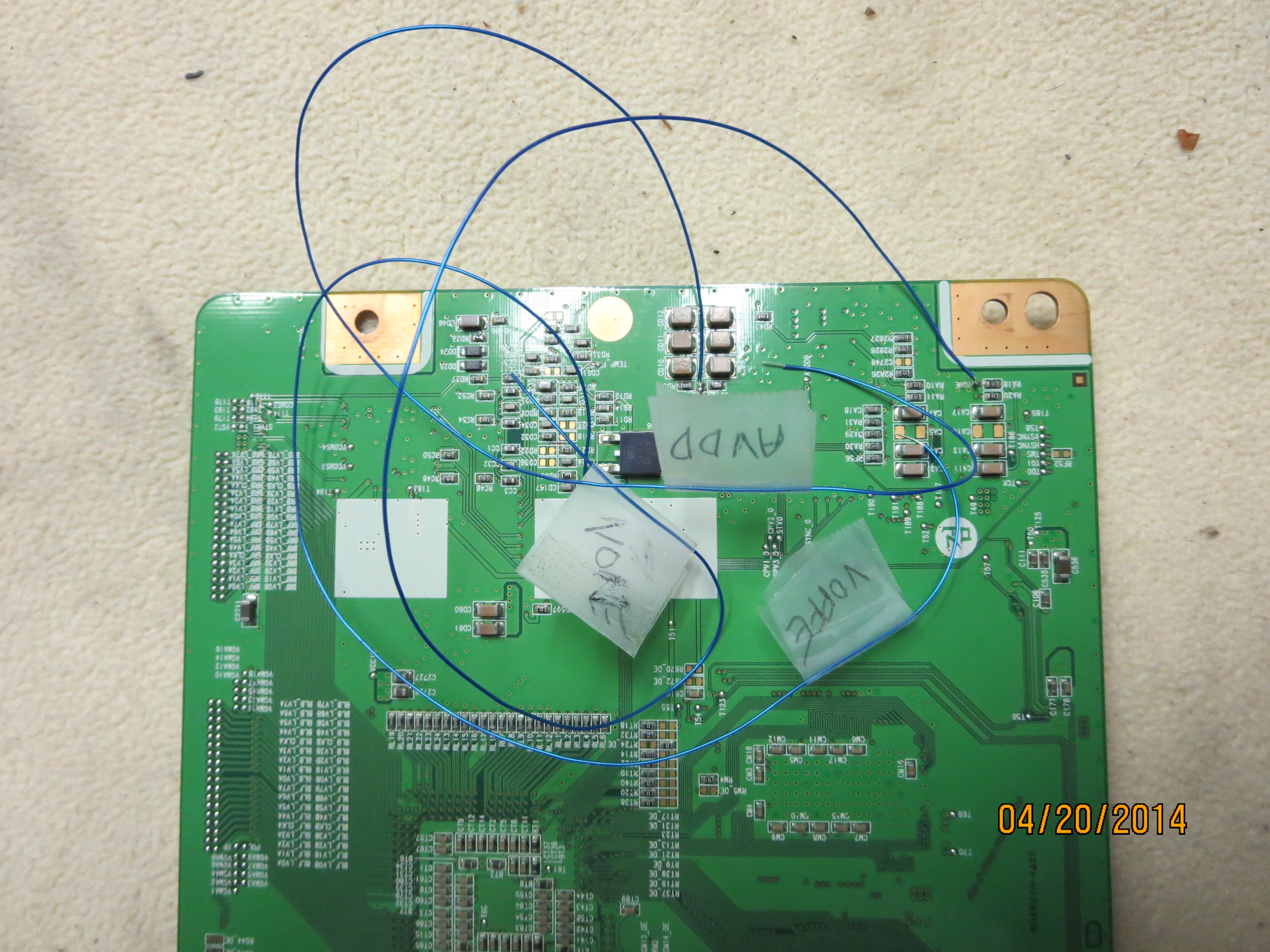

    VONE: +20V to +33V
    VOFFE: -5V to -10V
    AVDD: +14V to +18V
    Suspect AVDDB to be same as AVDD, not sure though.

      assuming just check with VM ?? no scope needed ? didn't realize wire was covering up one of the test points in pic
        #83
        Re: 2008/9 Samsung LN55A950 Displaying Horizontal Lines
        Yep, red probe on wire, black on chassis of TV.

          VONE = +9.7 volts
          VOFFE = +0.7 volts
          AVDD - +15 volts
            #85
            Ok, so that is bad, but we need to rule out the panel. Remove the ribbons from the top of the t-con and re-test the voltages.

              assuming u meant all 4 ribbon cables on top of tcon. no change in voltages
              VONE = +10.1 volts
              VOFFE = +0.65 volts
              AVDD = +15.1 volts

                OK, it seems like T-con is defective. But one final check, need to see if panel caused it.
                With ribbons out, and power OFF, use your multimeter on the diode test mode and see what the reading is from VOFFE to chassis ground. Then repeat with the ribbons in, power off still.

                  VOFFE to GRD is 10K ohms - both polarity
                  AVDD to GRD is 2.8K ohms.
                  cables off or connected - NO CHANGE in ohms
                    #89
                    OK, so there is a good chance the panel is OK.
                    I cannot guarantee it! but it seems good.
                    Typically VONE and VOFFE are generated by same circuit using a "charge pump".
                    Confirm my suspicion in this photo is the bottom left hand corner where VONE is (on the other side of course) and middle left is where VOFFE is?

                          had a little fun ! pic show where signals are roughly.

                            TPS65167 is the IC which controls the VGH, VGL and AVDD generation.
                            Check D14 is not shorted/open, it's just above the IC.
                            If that's OK, then replace the IC... That would be my guess as what to replace, if you feel confident in replacing it, it's available:

                                diode D14 (KJH v9) is open. trying to cross it over to an obtainable part

                                  subs BAV99W readily available.
                                    #97
                                    can't find any locally - tried to find the mmbd7000. 2 electronic stores locally don't have BAV99W. going to use 2 - 1n4148s. should work

                                          no change in voffe - same symptoms. ordered a TCON board - this one is toast.
