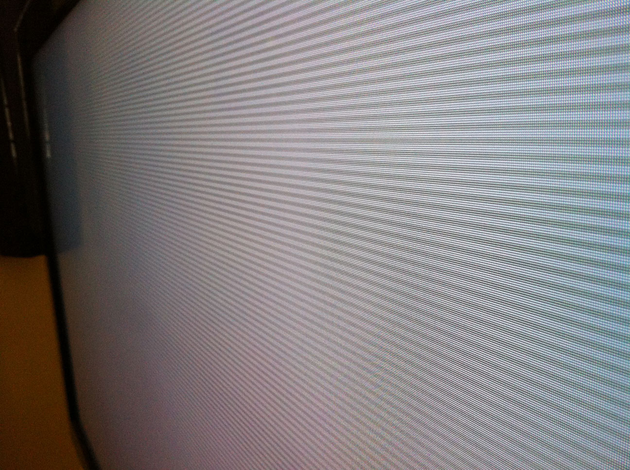

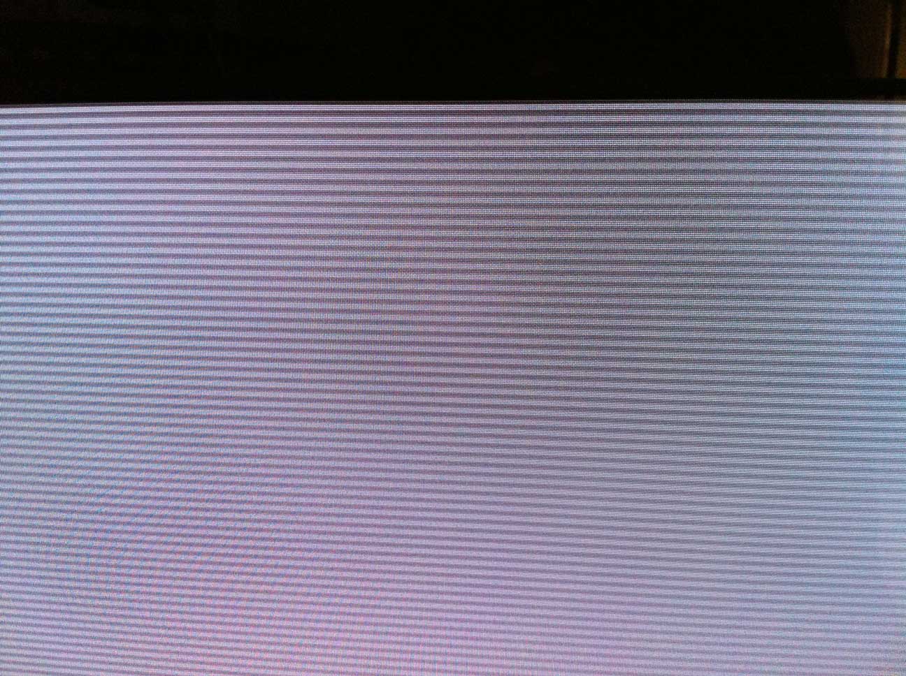

    Hi everyone. I just joined the forum - first post - need some help/advice. I fairly techinical/handy with electronics, but this my first venture into troubleshooting and fixing a flat panel TV.
    The patient: A 2008/9 era Samsung 55" LED backlit LCD. Model: LN55A950

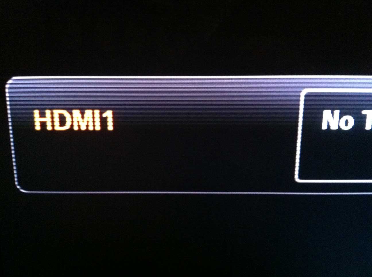

    The issue: It's displaying black, horizontal lines across the entire screen. The lines appear to be 3 pixels wide, approximately every 1/4" uniformly down the screen. The lines are little more pronounced on the left of the screen and slightly less as you move right... but the lines run across the entire screen horizontally, and vertically.
    Troubleshooting: The problem persist even when light direct pressure is applied to the panel/pixels with my finger. It also doesn't seem to be a tension/pressure issue on the perimeter of the screen (or if it is, I can't find it). It displays the issue consistently across all colors, all inputs, all built-in screens, logos, displays, etc. It displays the issue w/ no inputs hooked up, and when powered from any 120V plug (inc. the one that has worked fine for 4 years). I've disconnected both ends of the LVDS cable between the Tcon & dimming board, blew it out w/ compressed air and reconnected - didn't help. The cable appears to be in good shape visually - no way to test it.
    Just from Googling and reading online, it seems like a lot of these 2008 era Samsung LCD suffer from this same issue. I need some advice on what to do next. My top 2 suspects are the Tcon board or the LVDS cable, but these are just novice guesses from a DIY'er. I'm really hoping it's not the panel - it would be a shame for a TV this nice to be junked. The uniformity of the lines tells my gut it's a signal issue though, not the panel... but this is just me guessing.
    Any suggestions? Could be it the Tcon? Should I try replacing it? And if so, should I also replace the LVDS cable at the same time?

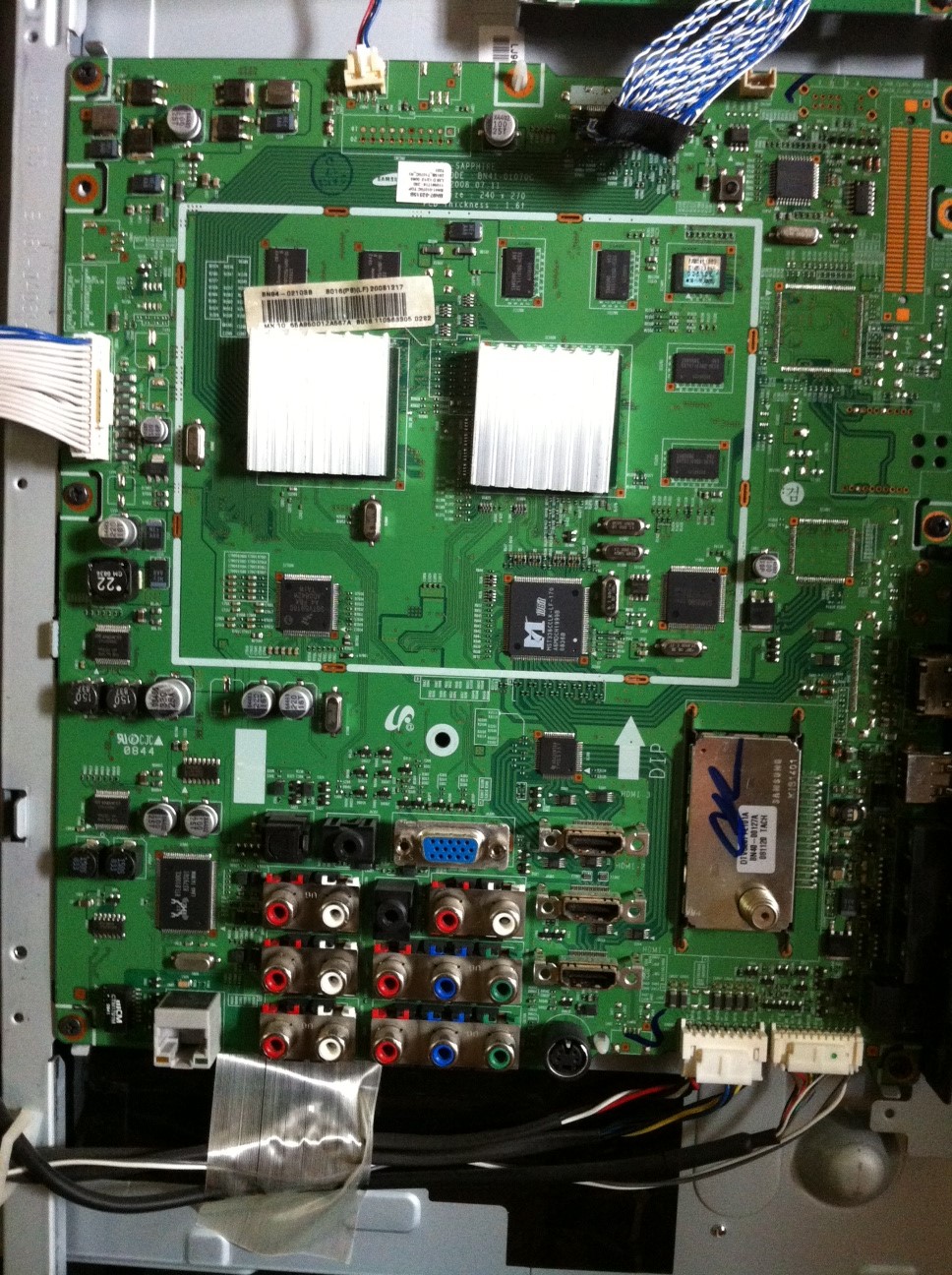

              I've attached a picture of the mainboard. I don't know if this is the same on all TVs, but the dimming board (i think that's what it is) is in the signal path between the main board and Tcon. Any way the dimming board could be causing issues too? Just asking based solely that it's in the signal path. The LVDS cable going off the top of the picture heads to the Tcon.
              Let me check out price & availability for another mainboard. I really like this TV, but just debating how much $ to get into this to try to fix vs. calling it. If it's the panel, the TV is DOA. I think I may recall hearing that there was a Samsung recall/class action for bad capacitors on this era TV... though I don't see any obvious signs (bulging, etc.)

                Re: 2008/9 Samsung LN55A950 Displaying Horizontal Lines
                This problem isn't caused by bad capacitors.
                Yes the dimming board could cause it, interesting, is this an LED backlit TV?
                I also notice the main board has the 120Hz motion interpolator, instead of the typical location on the T-con board. So it could be either dimming board or main board, assuming the T-con is good. Very difficult to tell!
                You could most likely get $150 for this with the shown fault if listed on Craigslist or eBay, if you do decide not to fix it.

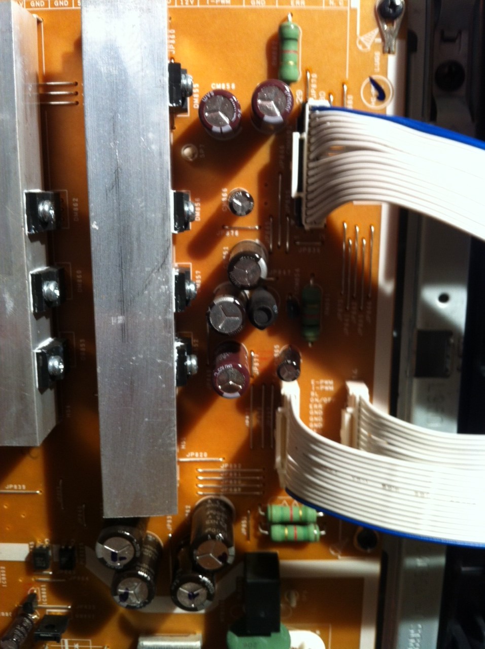

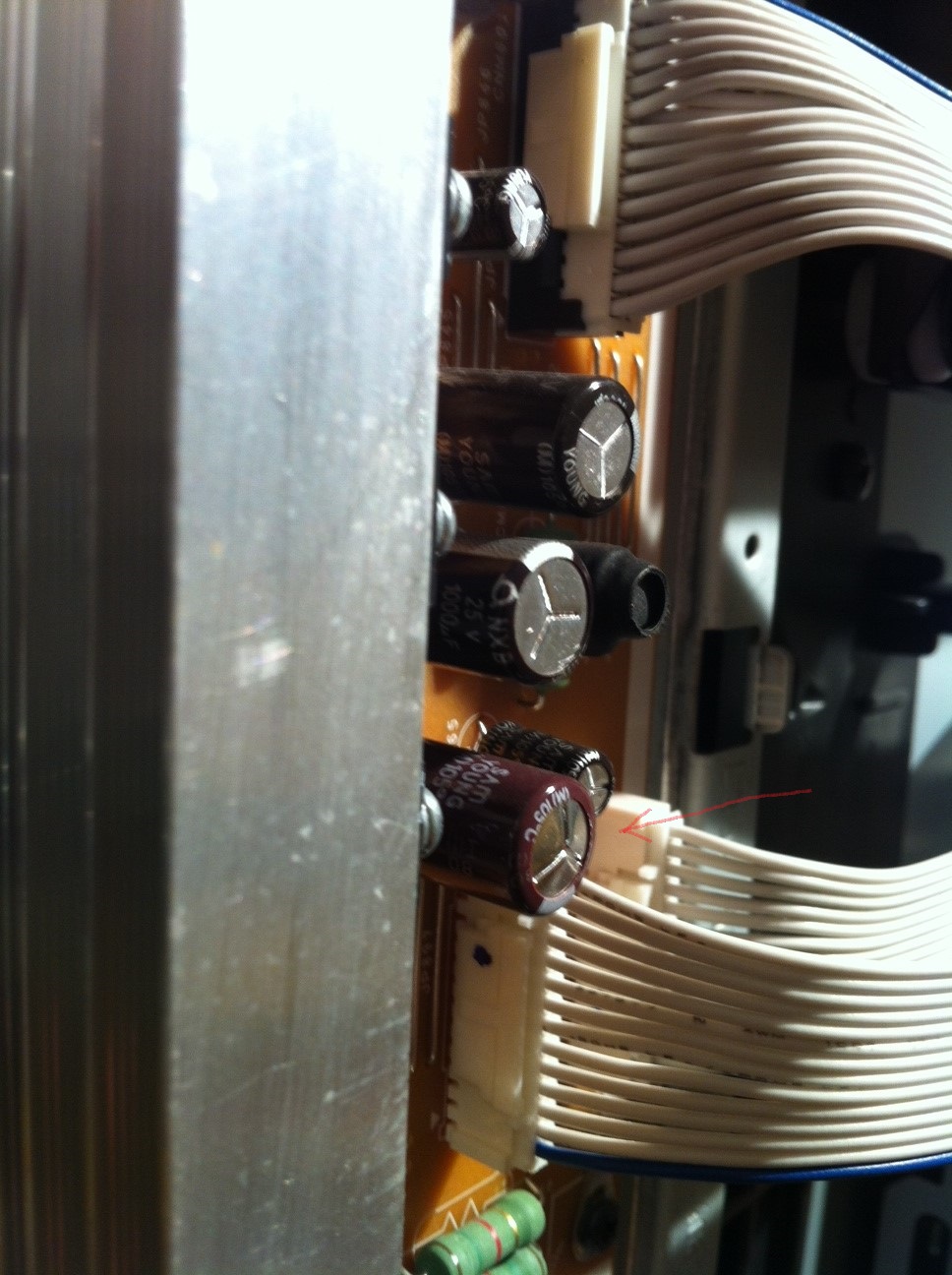

                                        On my unit, there's a very faint, high pitch whine/hum coming from the top center/right portion of my power board. It sounds like it's coming from the transistor rail (on the heatsinks), but the noise is likely coming from the power transformer that is just to left of the transistors, also in that same portion of the board.
                                        In that same area of the power board, there are several caps, and yes, the end cap of one of mine also appears to be a little swollen and puffed out. You can kinda see it in my attached picture. Although, while I'm not an EE, I don't see how a bad cap on the power board would be causing the picture issues as documented above.

                                        Originally posted by tom66
                                        I doubt a bad capacitor would cause this, can you show a picture of the slightly bulging cap though? It may be a panel defect, nothing that can be done about that unfortunately.
                                        Agreed. Suspect cap at the red arrow. Can't really see the concave-ness, but you can definitely see the glare difference between the top 2 caps and the bottom one, all of which are identical caps.
