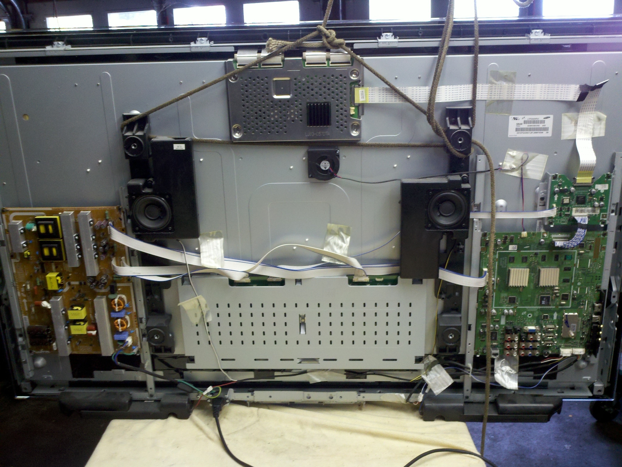

    Anyone have anything new to add? Otherwise, I'm going to starting stripping my TV tonight -- no going back.

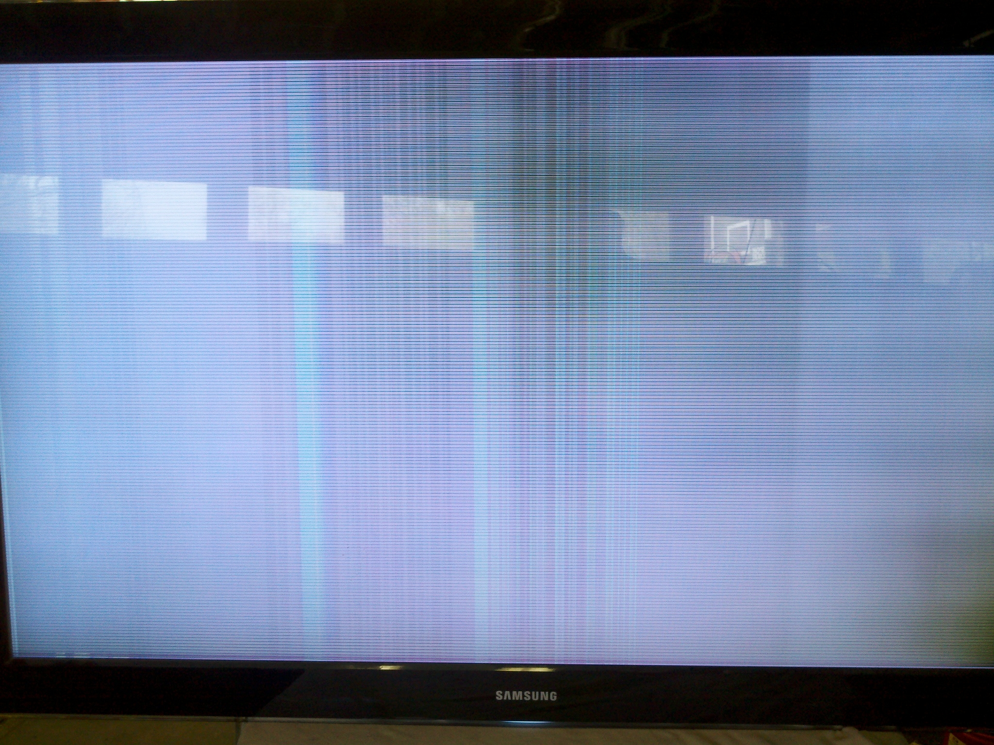

      Re: 2008/9 Samsung LN55A950 Displaying Horizontal Lines

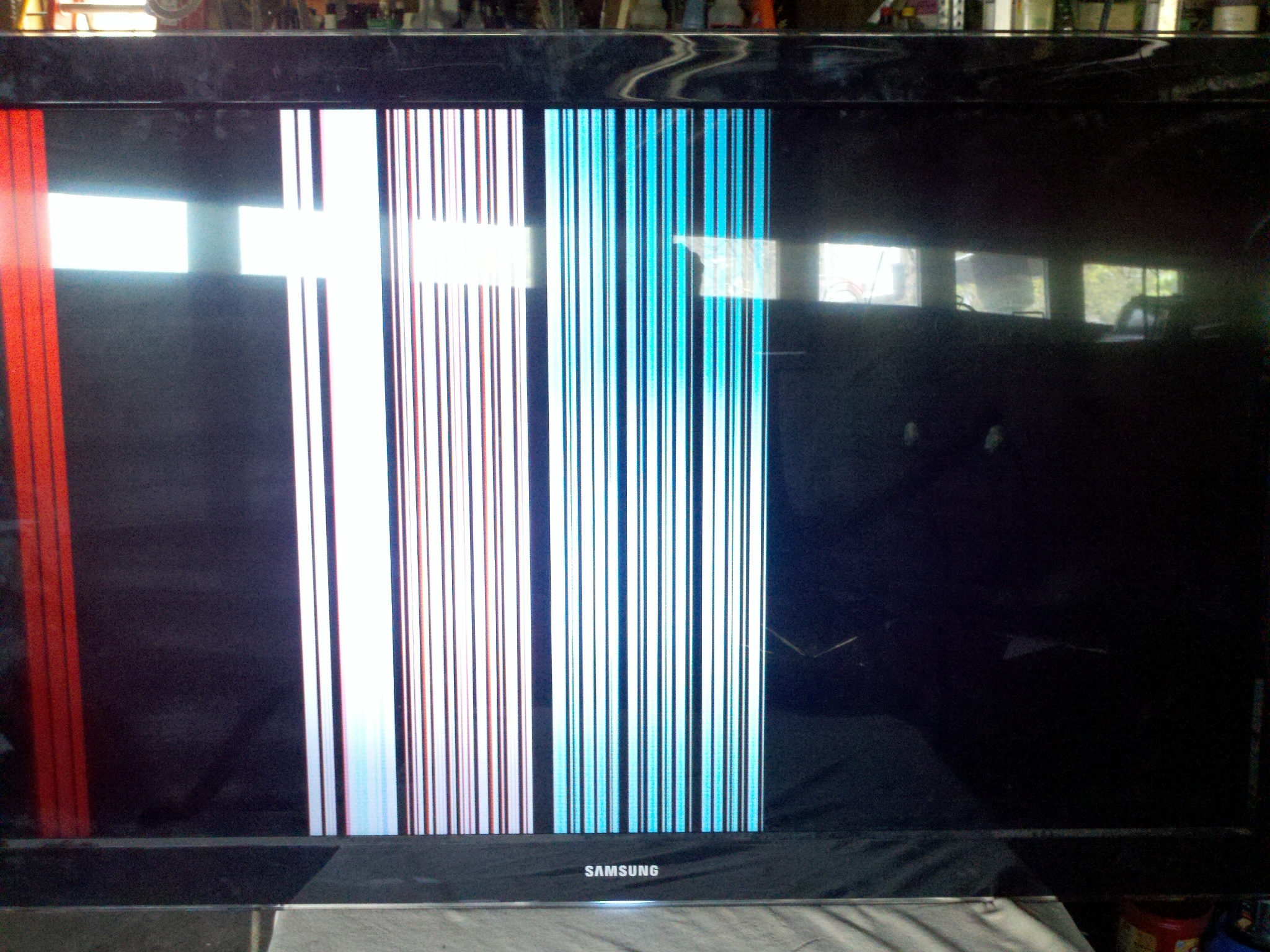

      Have same set - vertical lines. anybody seem this ??? going to fiddle with wires. Is this problem similiar to sony bravia distorted screen (buffer tabs). Has anybody tried pushing on the tabs on this set ????
          90% that's a bad panel, small chance of a bad VGH/VGL circuit on the t-con causing issues.
            reconnected all connectors - now screen show this on power up. OSD does nothing. can this be a buffer tab "fix" ?? flexing tv does nothing

              after a minute = the screen is completely white. menu does nothing, TCON board heat sink is cold - think TCON board is bad
                It's screaming panel to me, you can try checking VGH and VGL on T-con if you want, but I suspect the panel is bad.

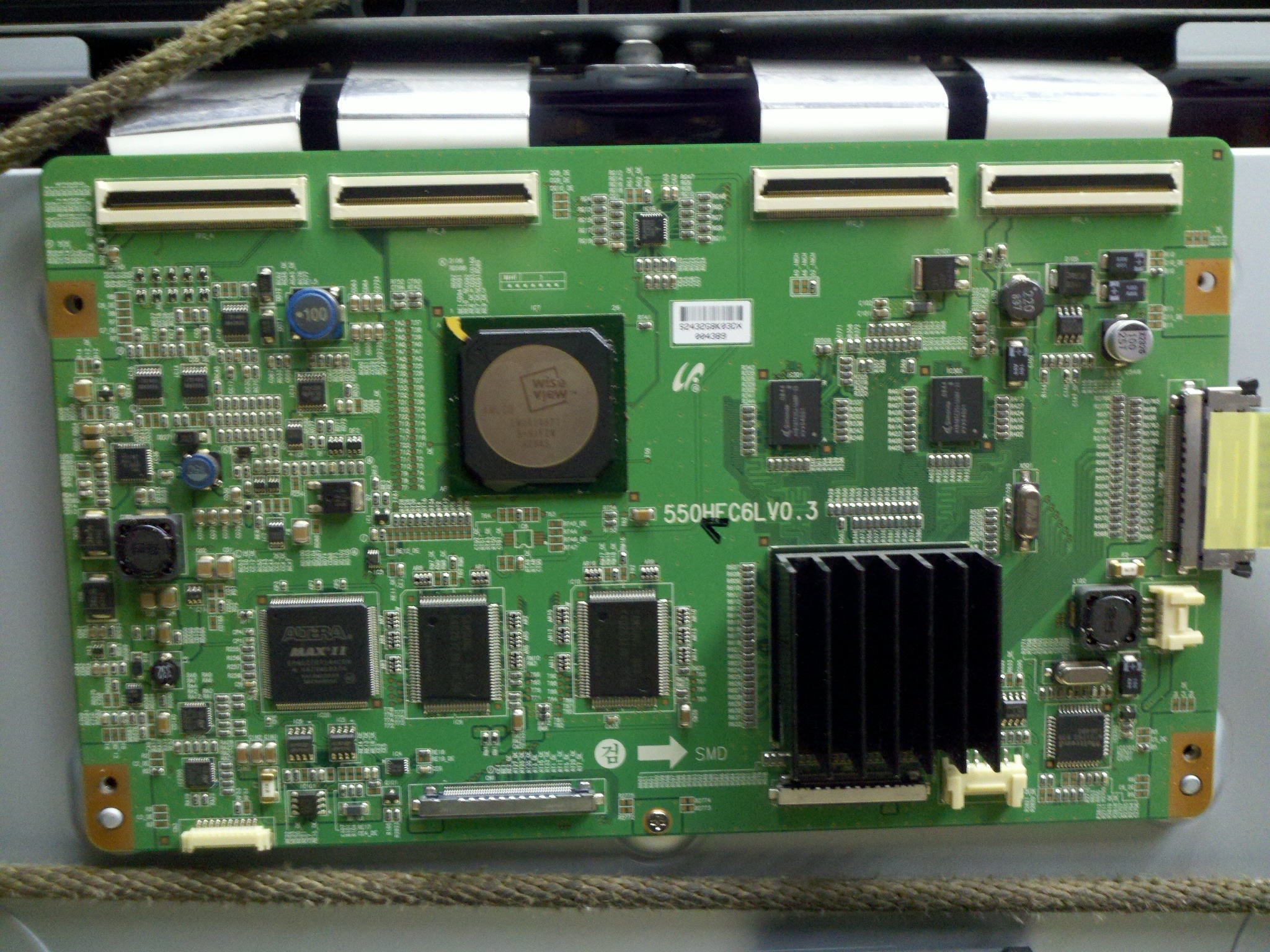

                        Hmm, that can mean that the problem could be away from the panel, so you've got that going for your at least. I'm not sure what the "buffers" you refer to are. This is an LCD TV, not a plasma TV.
                        Post a picture of the t-con, I can highlight some possible test locations.

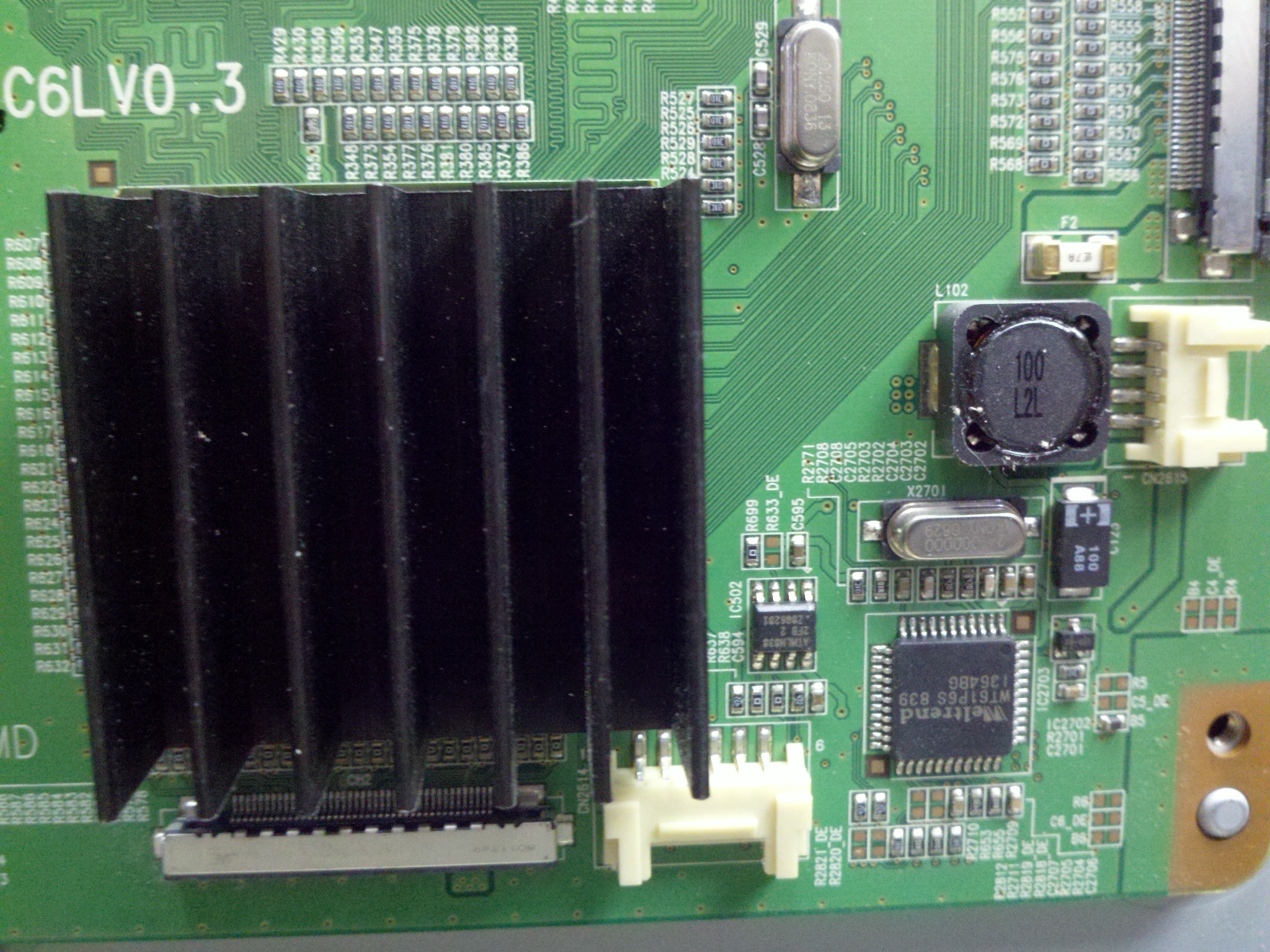

                          When I first turn the set on - white screen. push menu button - have some faint vertical lines on left side. doesn't display anything legible. looks like the tcon board isn't doing anything. black heatsink is cold. chip with rubber heatsink is warm (metal can container is heatsink - not shown on pic).

                            #73

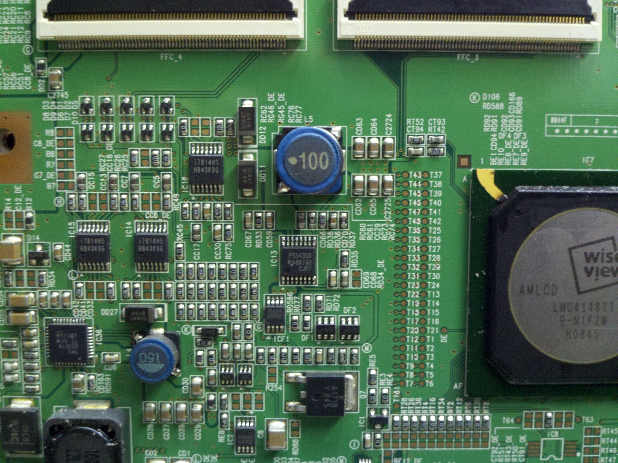

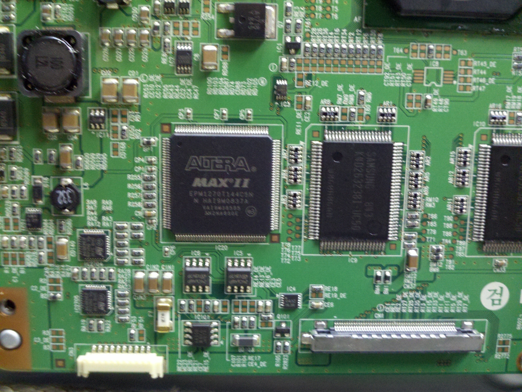

                            I need to be able to see the very fine print on that board, can you get a picture in focus? If not possible at a further distance, break it into quarters and take a photo of each, with a little overlap. Sunlight is a great diffuse light source, avoid flash if possible.
                              #74
                              When tv first turned on - (takes about 20 secs) totally white screen. press menu, screen has color vertical bars. phone pics of TCON board close up (4 quarters).

                                Can you see any labels VONE, VOFFE, AVDD as I can't...

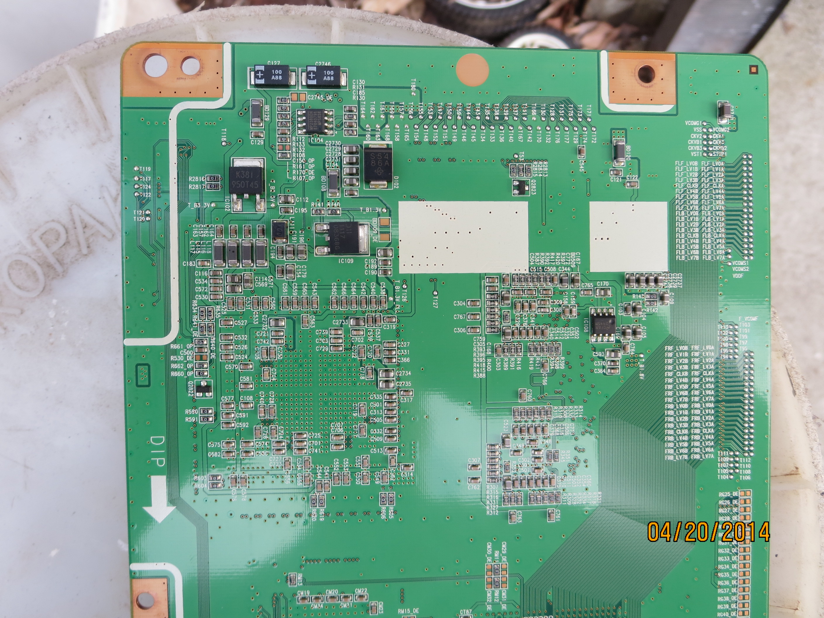

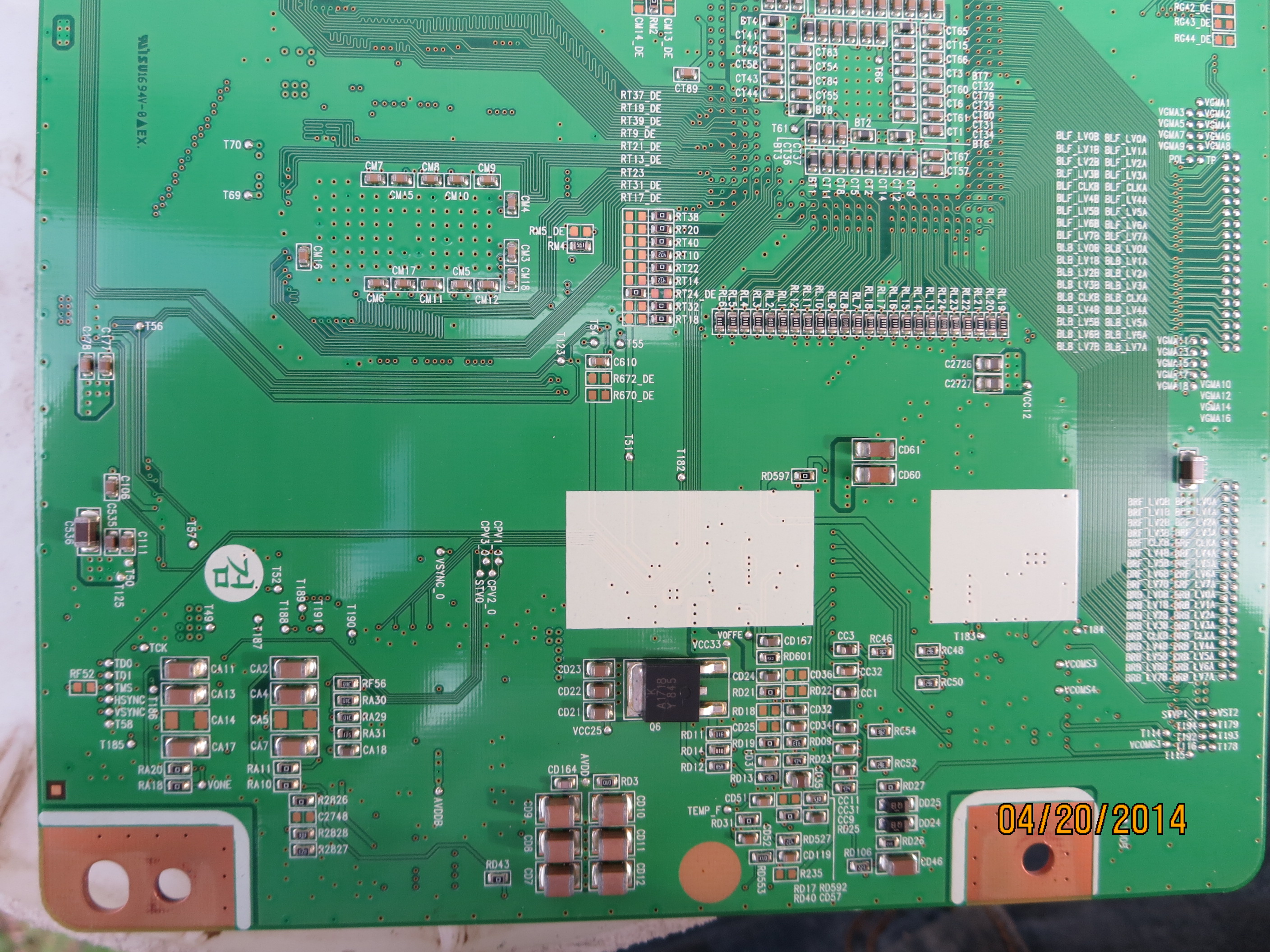

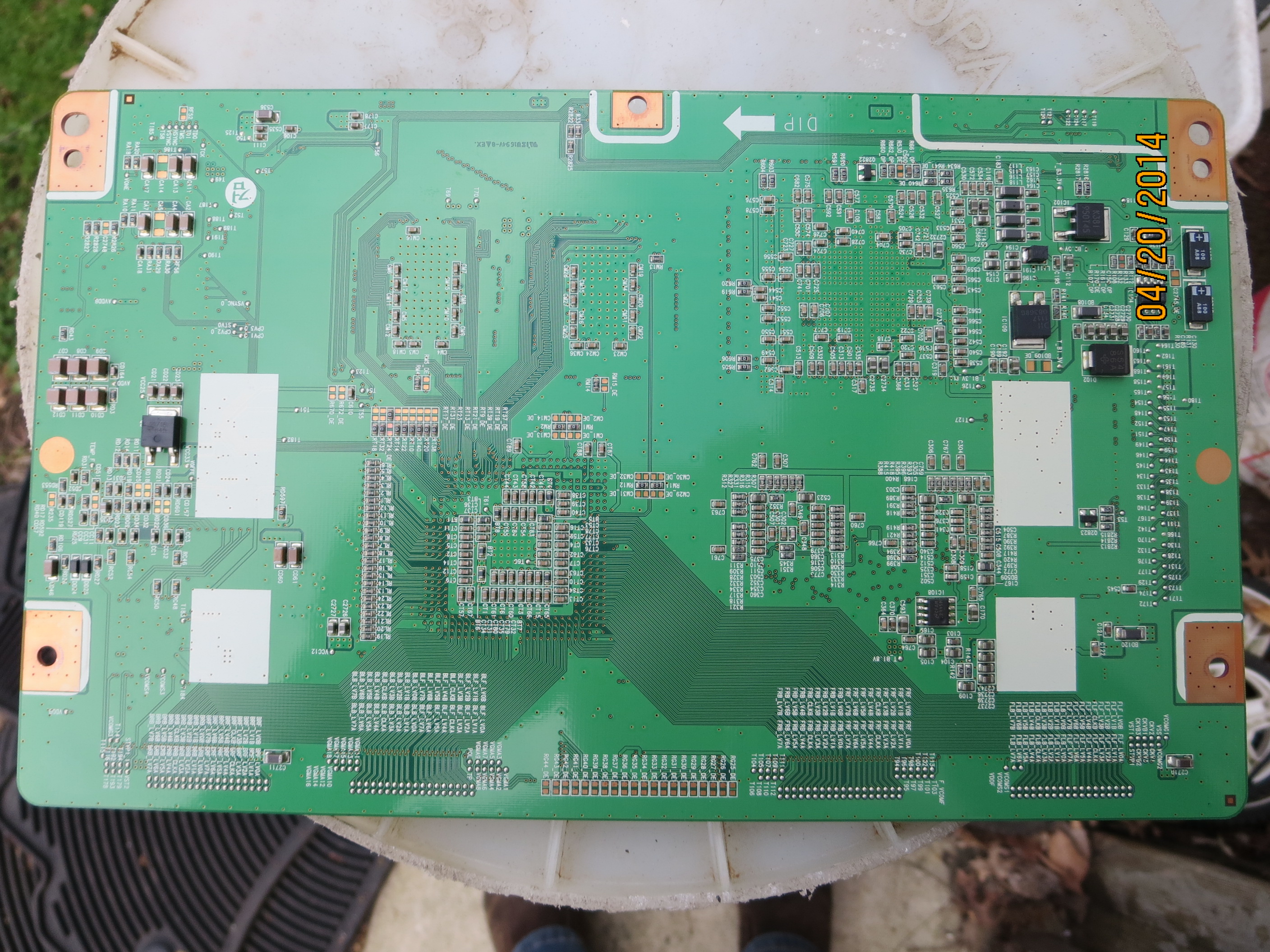

                                      OK - signals are label on back of board - see pics (found camera charger - real camera pics !)
                                      AVDD is pic 1 top left, voffe is middle left, Vone is very top left
                                        #79
                                        It's a bit awkward but can you solder wires to each of those points, label them or colour code them, and test with board in place? Note, be very careful not to short them you could damage the panel or t-con.

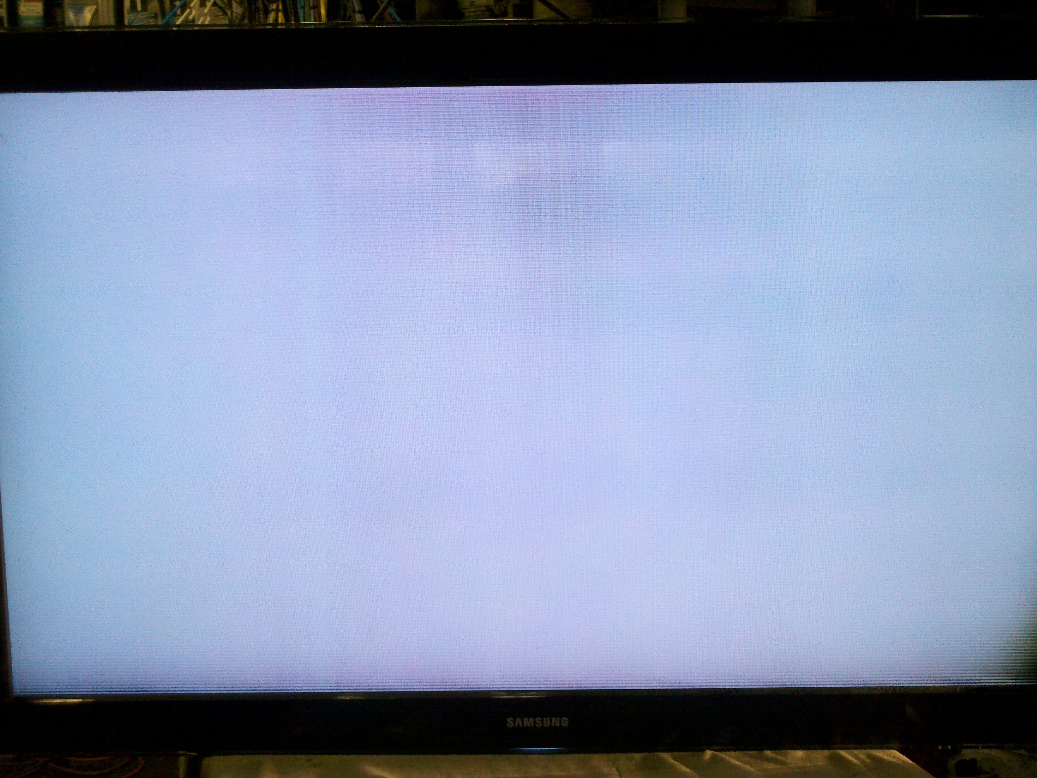

                                          #80
                                          can do - VONE, VOFFE, and AVDD (there also a AVDDb). what am I looking for ?
                                          turn power on - 30 seconds later - have totally white screen. see pic
