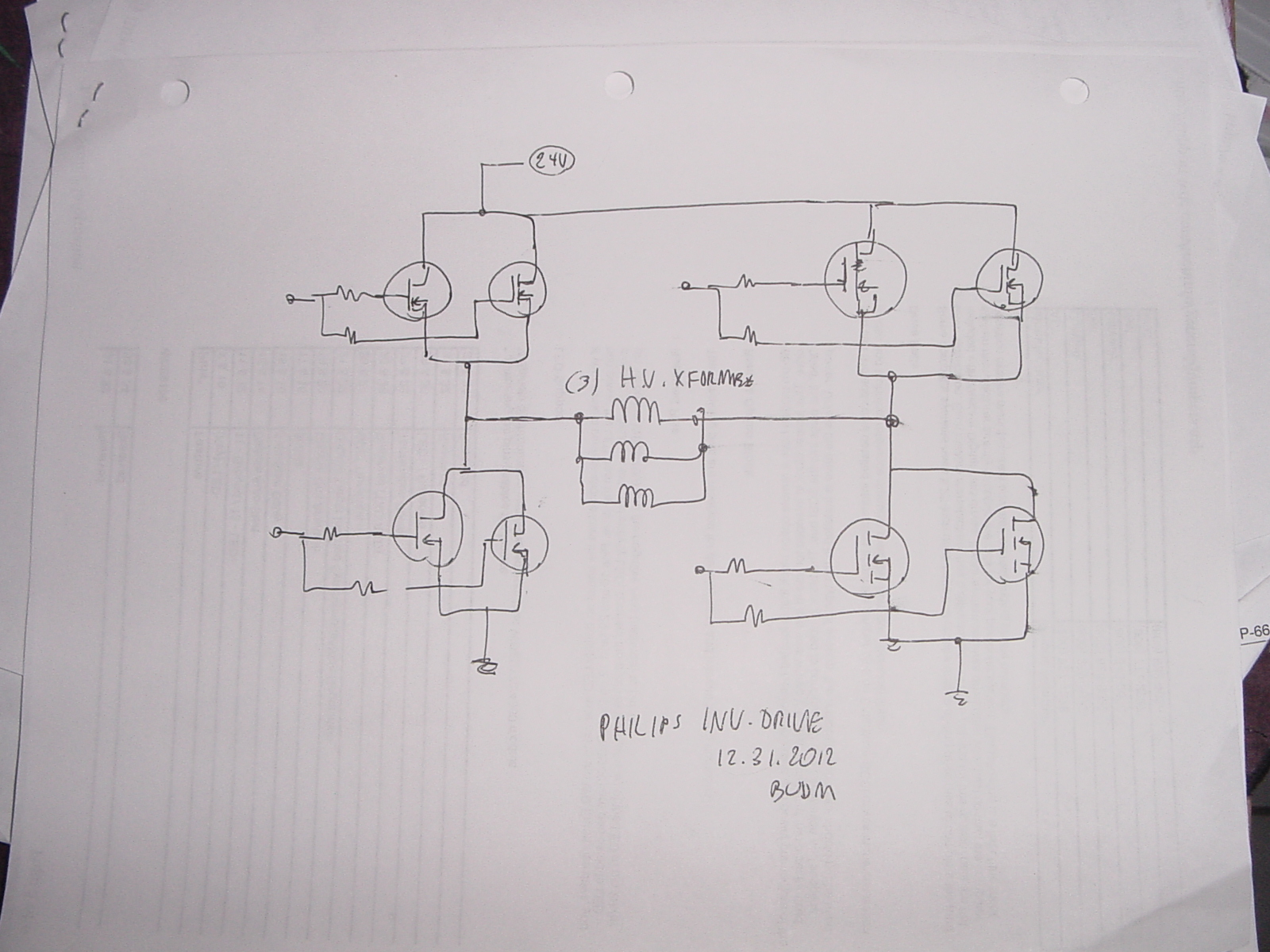

        #103
        Re: phillips lcd keeps blowing fuse
        here are my results. tested transformers with power off, meter set to 2000 ohms using the + - probes on the pins all were 958. reversed probes all same 958.
        selldoor the Mosfets are 50N04. tested powerd on - grounded to chassis. meter set to 200 dcv
        results are in picture. thanks everyone!

          #104
          OK Did all the transformers test the same?
          I was expecting this test
          Mosfets
          If you have a manual range multimeter, set it to 200 ohms (two hundred). This is for 3 pin ICs only. You can test a mosfet (Q, IC designation) "in circuit" by (power off and unplugged)
          a) black on pin 1- red on pin 2 - record ohms
          b) black on pin 1- red on pin 3 - record ohms
          c) black on pin 2- red on pin 3 - record ohms
          If any reading is less than 30 ohms you might have shorted mosfet. Remove from circuit and repeat the tests to verify.
          So I dont really know what to make of the voltages - perhaps Budm will comment.
          Can you do apicture of the full boards as he requested - I tried to piece them together but dont think they overlap.

                #107
                That suggests they are ok - at least to the point of not being shorted - as I said perhaps budm will comment on the voltages - please post the picture he requested.

                    #109
                    OK, let's see what you get at the current sensing transformer.
                    The voltage reading on the MOSFET's indicated that they are not being driven after the backlights go out.

                        #111
                        I expect something like 0.2~0.5v when lamps are on, and more than a volt if the lamps draw too much current.
                        I am running out of idea, I am thinking about put the jumper on the two terminals on the left side of that current sensing transformer to see if the lamps will stay on, that will tell us if the lamps shutdown due to too much current or not.

                              #114
                              I got a new multimeter today (Klein) so I retested the current senser transformer. when lamps kick in 0175. tested twice. it's Auto Ranging.
                                #115
                                Did you try jumping those two pin on the left side of the current sensing transformer yet. If it still does not stay when they are jumped then we can eliminate lamp over current as the cause of the problem and look some where else.

                                  #116
                                  budm you talking about these two pins?
                                    #117
                                    Yes, that is the primary side of the current sensing transformer, the output winding on the right side feeds the Dual Diode to convert AC to DC for the current feedback.

                                      #118
                                      no luck with the jumper
                                        #119
                                        Well, that eliminate the over current shutdown problem. Need to look some where else next.
