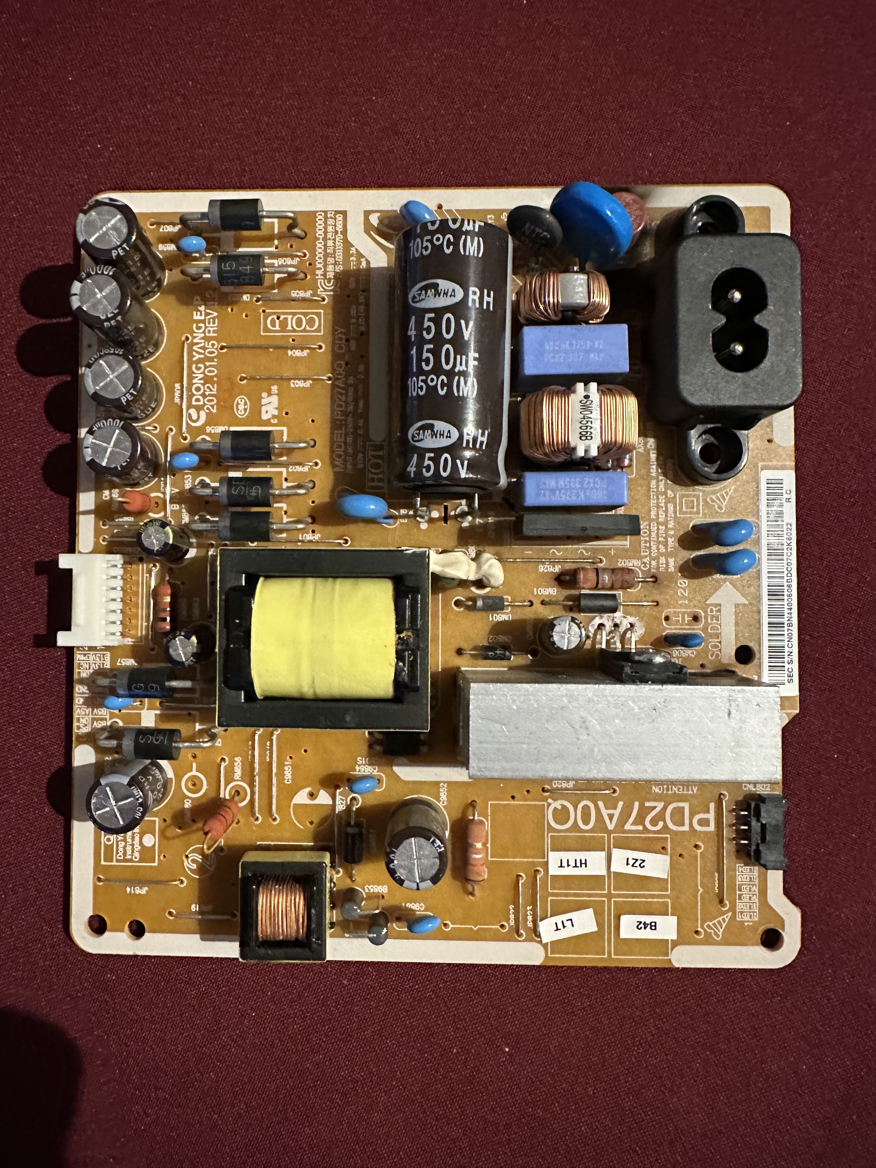

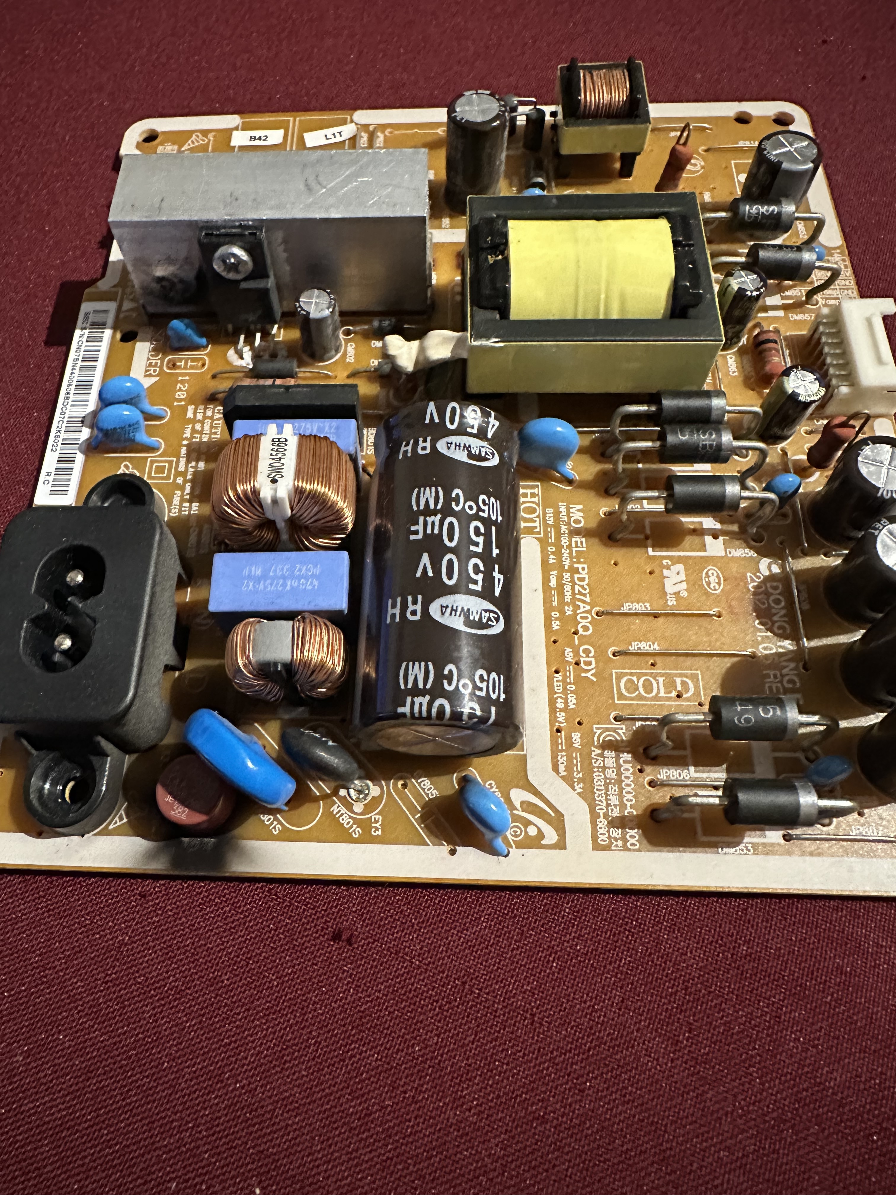

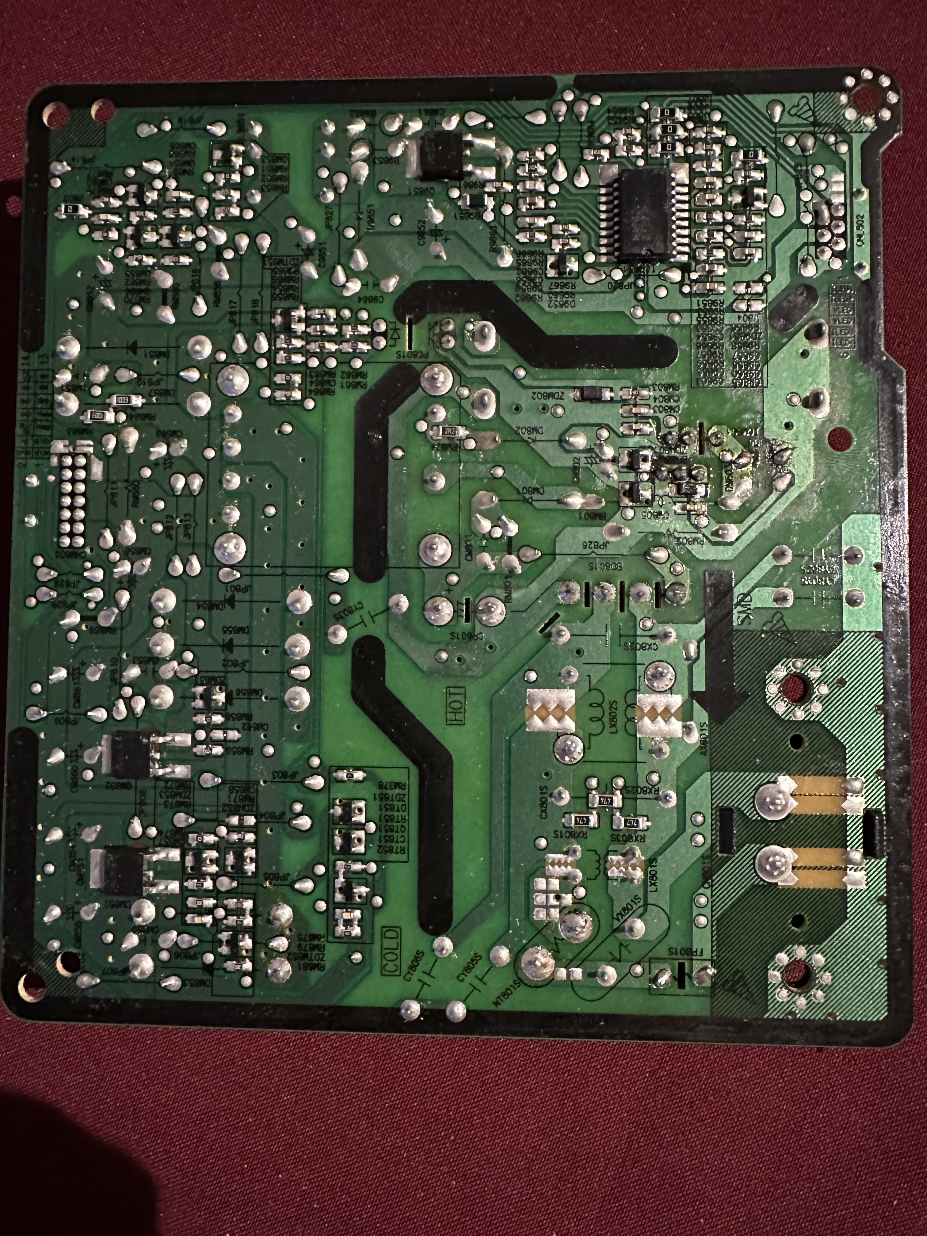

    Samsung PD27AOQ (BN44-00506B) constantly blowing internal fuse.
    Looking for some assistance please.
    Trying to repair a PD27AOQ samsung power board.
    Initially had the typical problem of cm806 capacitor blown, additionally thermistor NT801s blown.
    Replaced the ceramic capacitor, str60252s, bridge rectifier, thermistor and fuse.
    Testing it the fuse blows immediately power is turned on.
    diodes dm852 and dm853 test as shorted when in the board but fine when removed.
    any assistance, guidance would be appreciated.

    Pictures.we don't have boards by memory
    • Tips
      • Feb 2014
      • 15
      Sorry, my bad.
      Attached as requested, and thank you for your response
      • EazyBone
        • Jun 2023
        • 1356
        • United states
        What about that mosfets, are any of 3 legs shorted with each other?
        • Tips
          • Feb 2014
          • 15
          No shorts on them, all testing ok.
