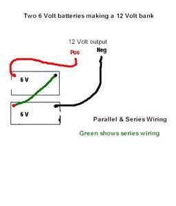

                                    confirmed PWM-SEL is 0. are you sure about connecting -+ together? so just solder -+ at top and bottom " one battery will be upside down " then run two leads from each. any lead could be the ground?
                                      Re: phillips lcd keeps blowing fuse
                                      It's like putting 2 batteries in a flashlight, the positive post from one battery touches the negative post of the other battery, the nipple end being positive and the negative end being flat, here's a picture diagram of two 6 volt batteries wired in series, just look at this as two 1.5 volt batteries wired like the picture and it will produce 3 volts, the nipples of the two AA Batteries would be facing to the left in the picture.
                                      Black in picture is Negative to ground, the red would go to the PWM-SEL
                                        Do you have flux for soldering? applying flux to the battery ends where you solder wires will make the solder stick better, if not apply solder to the wires prior to soldering them to the batteries.
