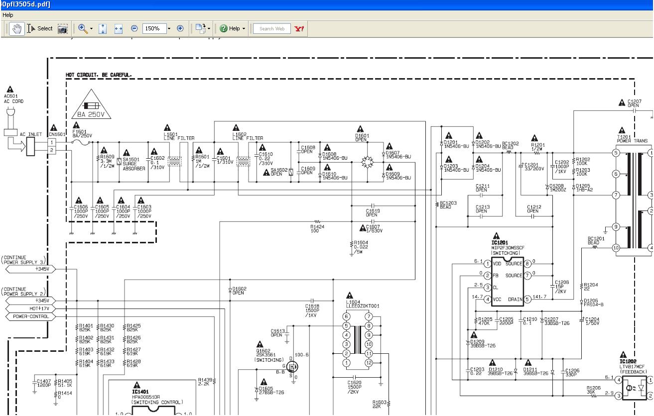

            I just read over this thread from start to end and all that you've tested so far was the diodes. Has anyone found a schematic on this set??? Is there a possible shorted FET? I'm sure theres a way to find the faulty component that's blowing this fuse? These problems are usually the easiest to find and cheapest to fix.
              #46
              Re: phillips lcd keeps blowing fuse
              Here, I did you a little legwork. Pull the first transformer (L1501) out of the circuit and see if your short is still there by checking ohms across from fuse (both sides) to ground. Here is a schematic of this primary side of your power supply.

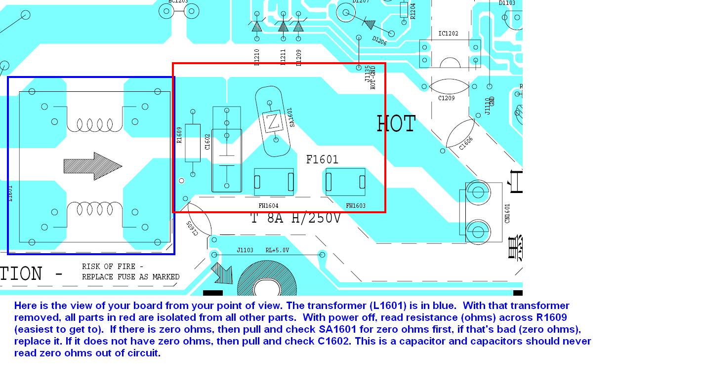

                  Better yet, I'll go as far as to just say, CHANGE SA1601 and SA1602. If you just pull these parts out I'll bet you that one of them is shorted.
                  This item is listed on the parts sheet as:
                  SA1601# SURGE ABSORBER 470V+-10PER
                        do you mean L1601 I don't know where L1501 is.
                          #52
                          You are correct, L1601, i read wrong. Look at my notes on the schematic below.
                          ALWAYS CHECK OHMS WITH THE POWER OFF.

                            Here is another way to look at it from your point of view.

                                Originally posted by TimT View Post
                                I pulled 1601 and 1602 showing 00.2 ohms on both. did i need to test something on the board with these removed?
                                The measuring of the transformer is not going to be accurate for now. Read the ohms across R1609.
                                  #56
                                  R1609 is 0 no reading at all on meter. tested other resistors of same type tested good. pulled C1602 dead 0 on meter. wanted to make sure i was testing the cap correct. tested on new cap. new cap test ok! so bad cap and resistor?
