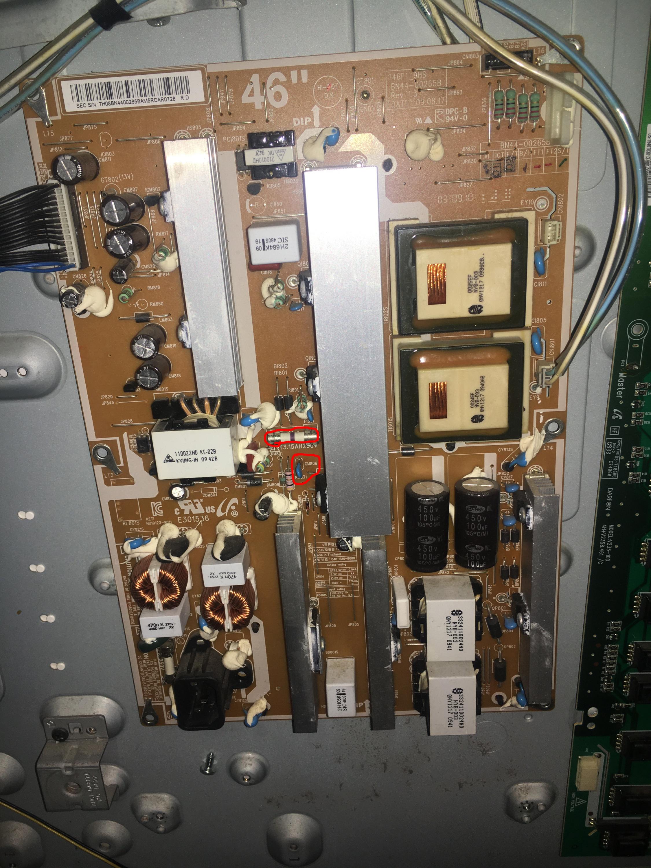

    I am a newbie and not very experienced so bear with me if i struggle sometimes with technical language - but I'll do my best. I searched "Samsung" and the model number on the forum but didn't find anything I could understand!
    I'm not an electronics guy - just picked up stuff over the years through my flight-simming hobby.
    I have the above mentioned 46" tv as the monitor for my flight-sim setup. Recently it went "crack" and stopped working. No standdby light and no response. I assumed a fuse had blown and after investigation found a fuse on the main power board gone.
    There are two fuses on the board - one 15A and one 13A. The 13A fuse had blown, not the 15A and also not the 5A in the mains plug (I'm in the UK so we work on 250v here).
    In a fit of extreme optimism I just replaced the blownfuse and hoped for the best. Of course, the tv blew again. This time, though, all fuses remained intact and it blew the leg off a capacitor on the main board _ CM806 on the attached photo.
    Once I find out the value of the cap I can solder a new one in - but could it be that simple? Or might there be another problem further down the line?
    Thanks in advance for the help,
    Roger.

    In general, this fuse is not 15A, but 3.15A (3A).
    • R_J
      • Jun 2012
      • 9610
      Re: Samsung 46" TV LE46B530 blowing fuse
      CM806 is a 68pF/1kv ceramic disc , replace with a 68pf/2kv, check the solder connections on ICM801, Do a search for the board number BN44-00265B, there you will find a schematic.
      https://www.badcaps.net/forum/showth...ht=bn44-00265b (post #6)

          Thanks for that - yes, it reads "T3.15A" - reading it upside down I saw it as 13.15! Thanks for the heads-up :-)

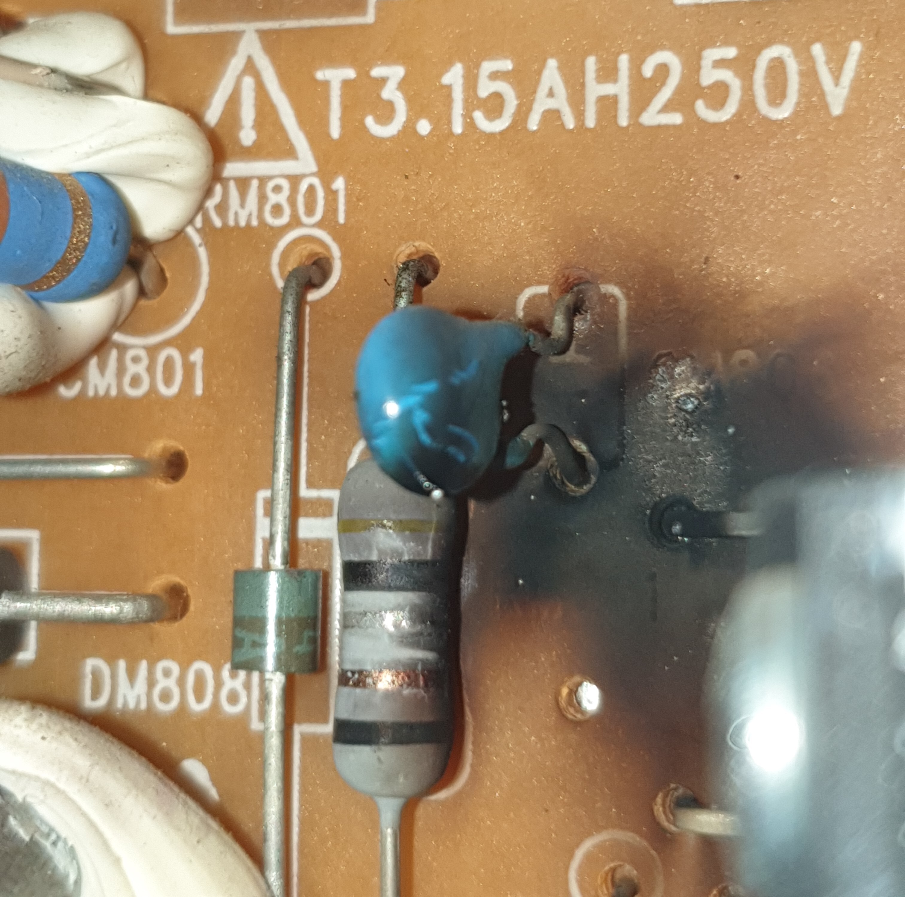

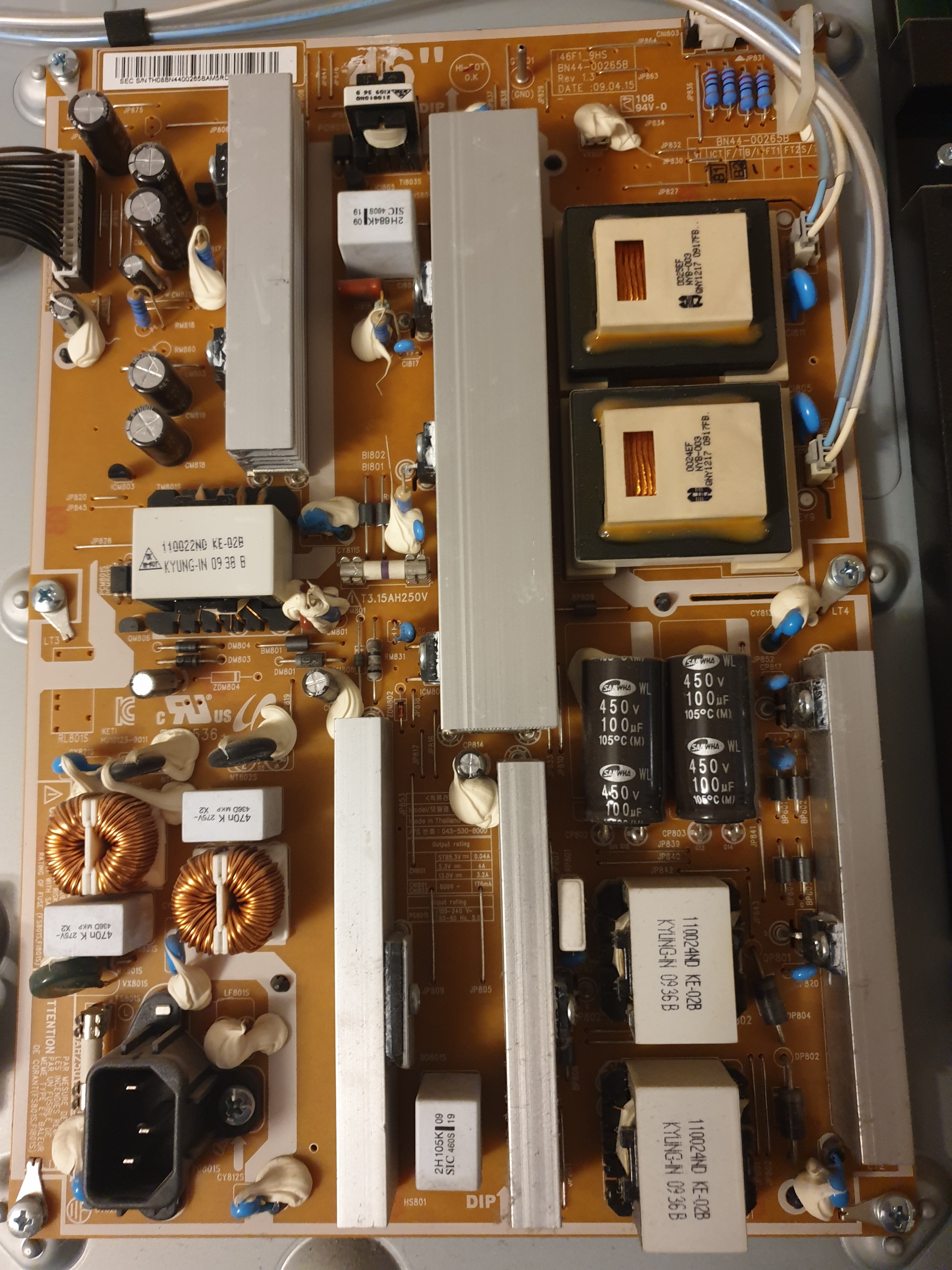

            interestingly, I had exactly the same sequence of faults with a Samsung LE46B530 that was about 14 years and 6 months old, as Roger had already described:
            - First the fuse "T3.15AH250V" was blowing. I was able to identify the faulty fuse using a multimeter (continuity test), the other fuse "T6.3AH250V" still gave an acoustic signal, so it was OK.
            - After replacing the 3.15A fuse with a new one of the same type, there was another bang when the TV was switched on.
            - This time the ceramic capacitor CM806 had blown in addition to the newly installed fuse - the circuit board was blackened at this point.
            - As R_J has already recommended, I have ordered new 68 pF 2 kV capacitors, delivery may take a few days.
            I would now like to know whether the problem with the faulty CM806 capacitor has been solved by soldering in a new component? Or will other electronic components break afterwards, which I hope will not happen?
            Thank you in advance for your help!

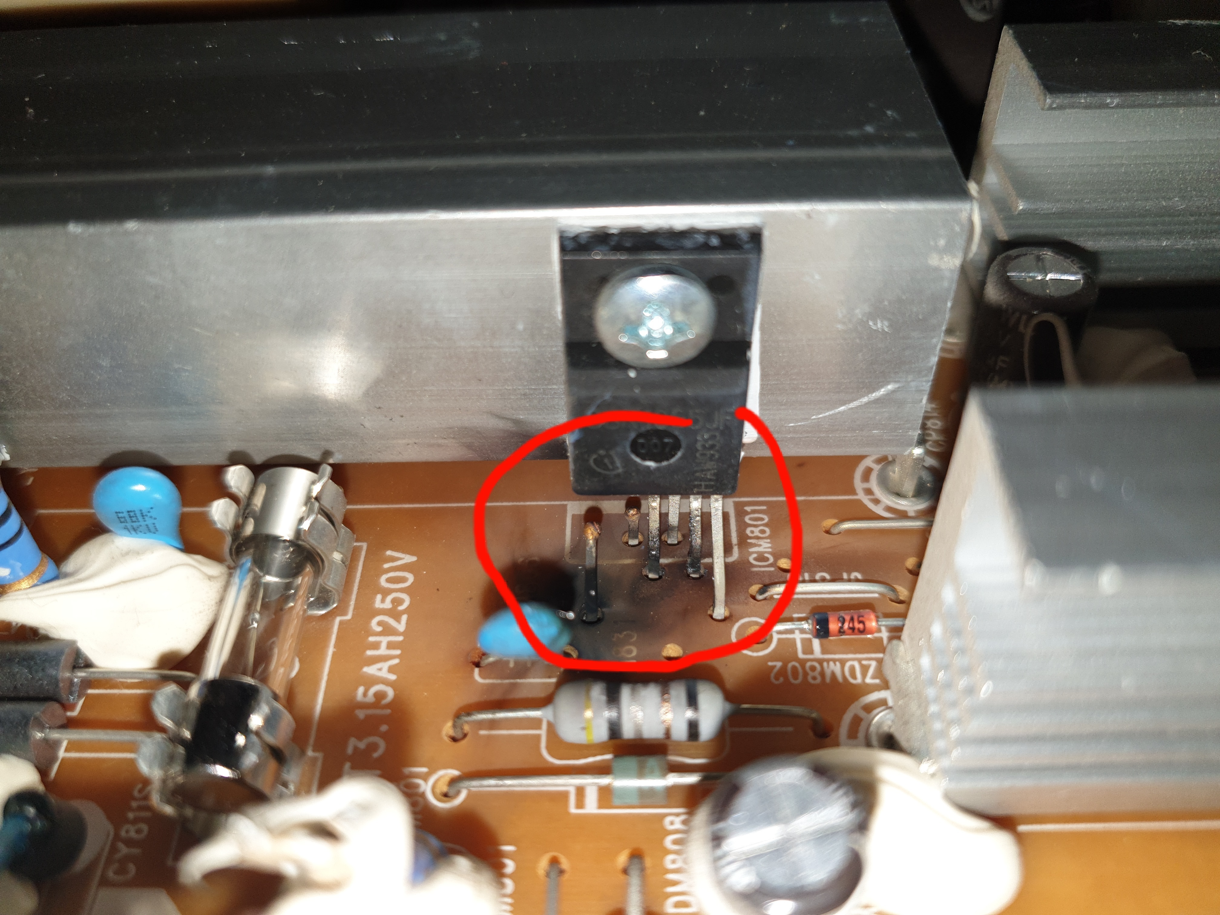

              Hello again,
              I have discovered that there was another, much more serious damage on the circuit board: two of the six contacts on the component labeled "ICM801" are broken, you can recognise the melted, round ends on the pins, see attached photo.
              Replacing the ceramic capacitor CM806 is thus not enough. Unfortunately, I will therefore be forced to buy a new television.

                    ICM801 - ICE3BR1065J
                    schematic Power Supply Inverter BN44-00265B
