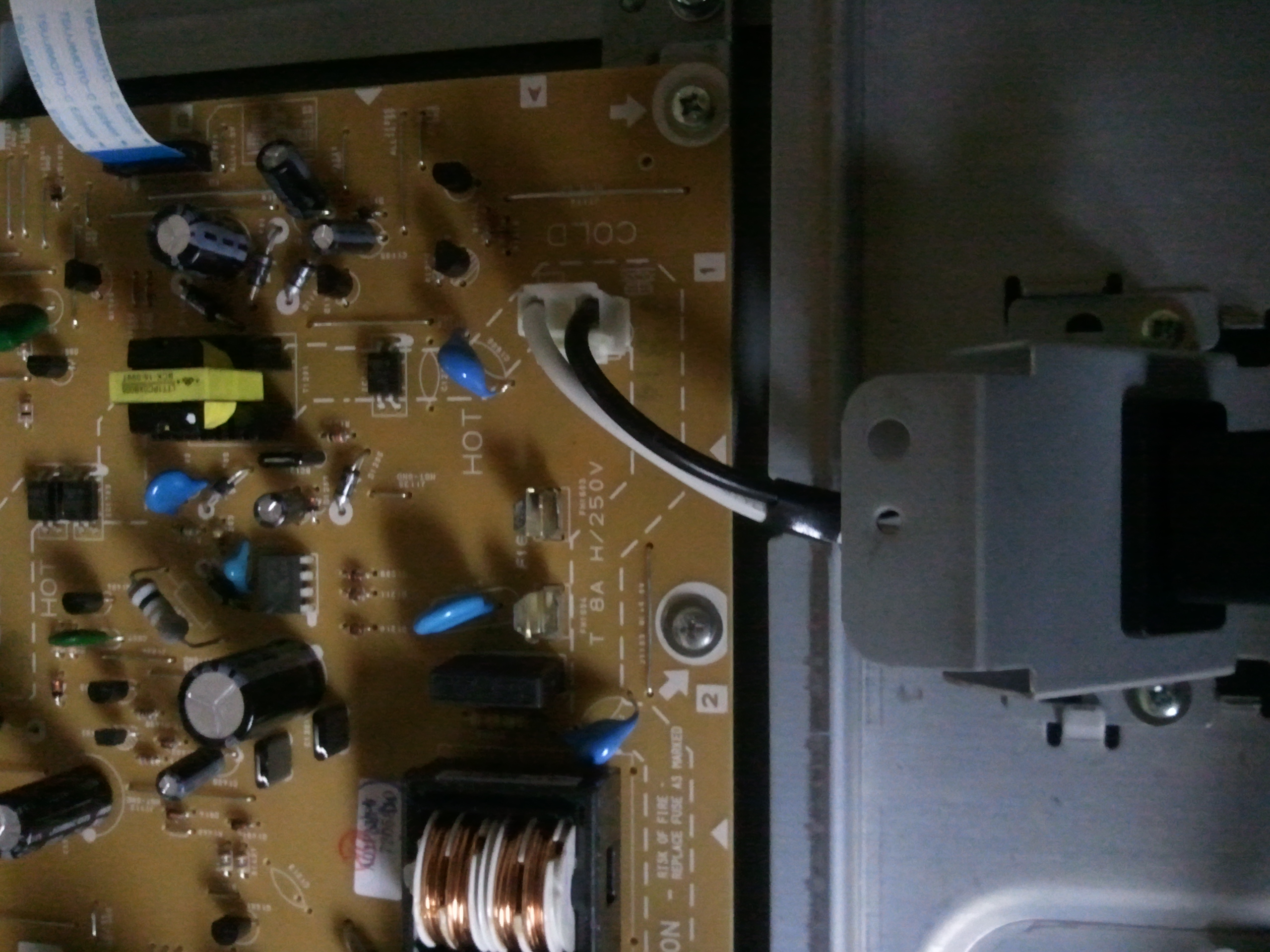

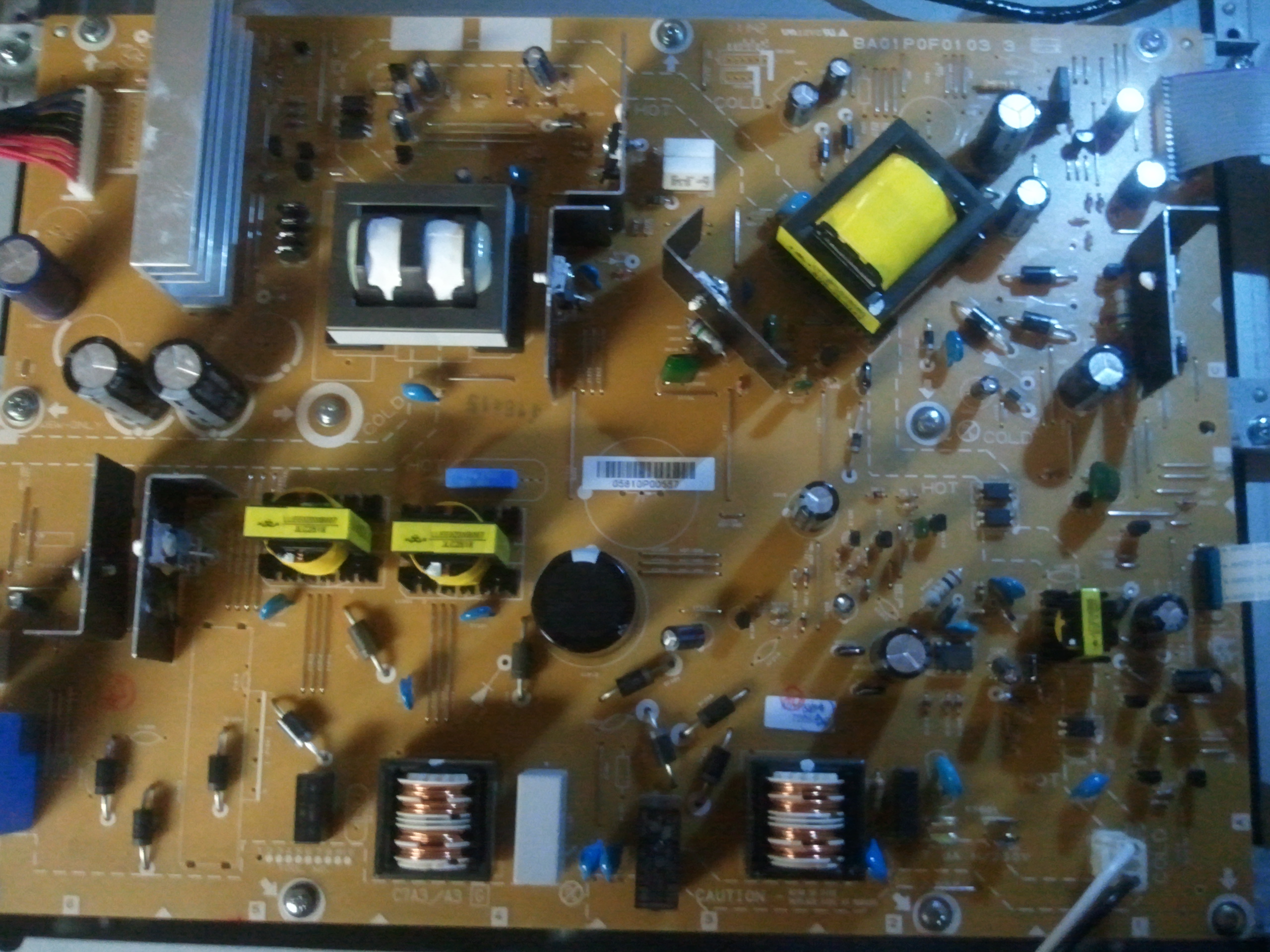

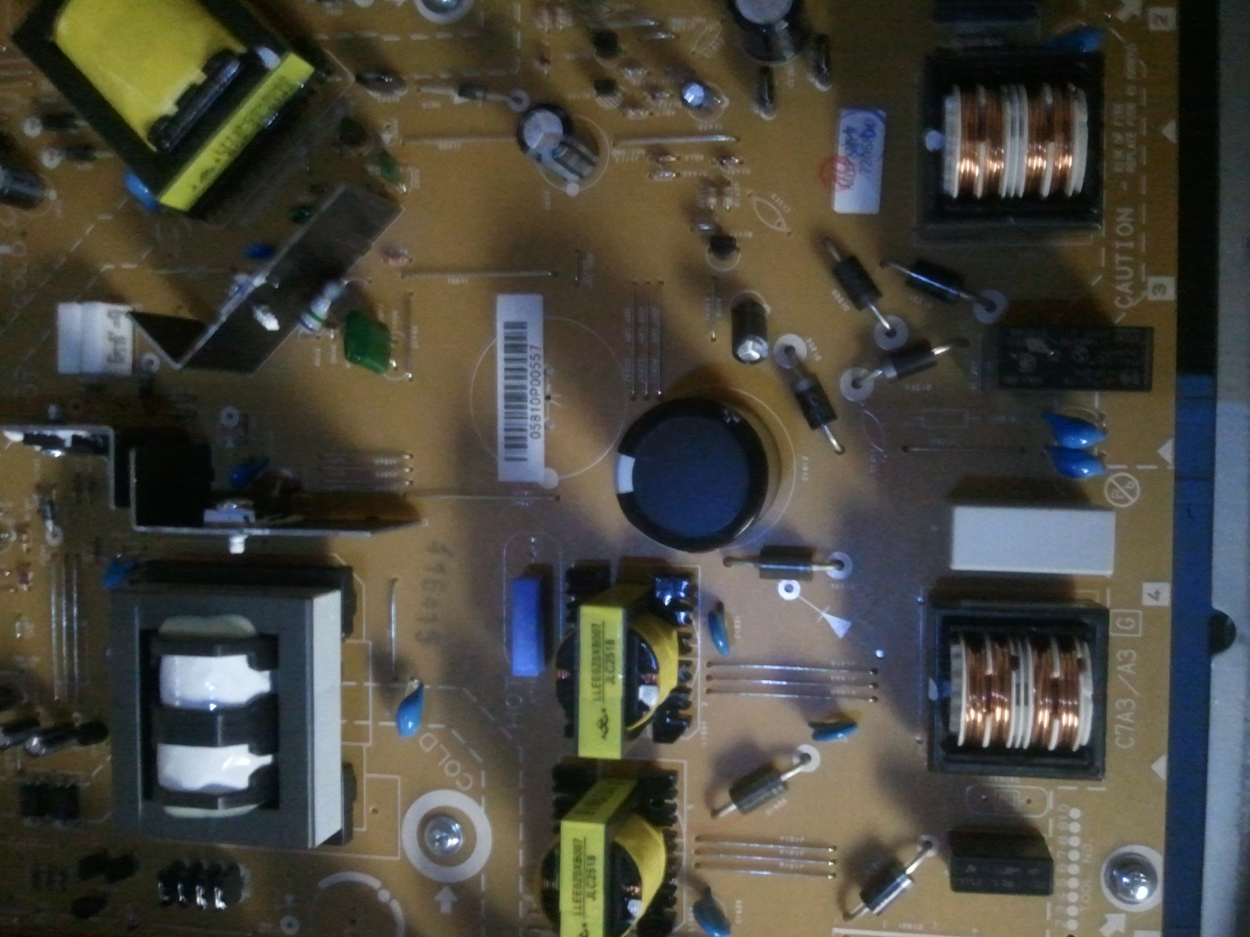

              about the only way i can get a reading is to set meter to 20m or 20k is that correct?.. here are some pictures of the power board im not 100% . sure what a bridge rectifier is but i think i have it circled alone with a diode and something else im not sure what its called . ..sorry im still learning
                Re: phillips lcd keeps blowing fuse
                Set the meter to the range which looks a bit like this ->|-
                If that highlighted diode reads zero in both directions it could be the fault. On these power supplies (resonant self-oscillating, no intelligent control) a shorted output will blow the fuse.
                This is a bridge rectifier, typical appearance on a power supply:
                http://media2.rsdelivers.catalogueso...7005465-10.jpg

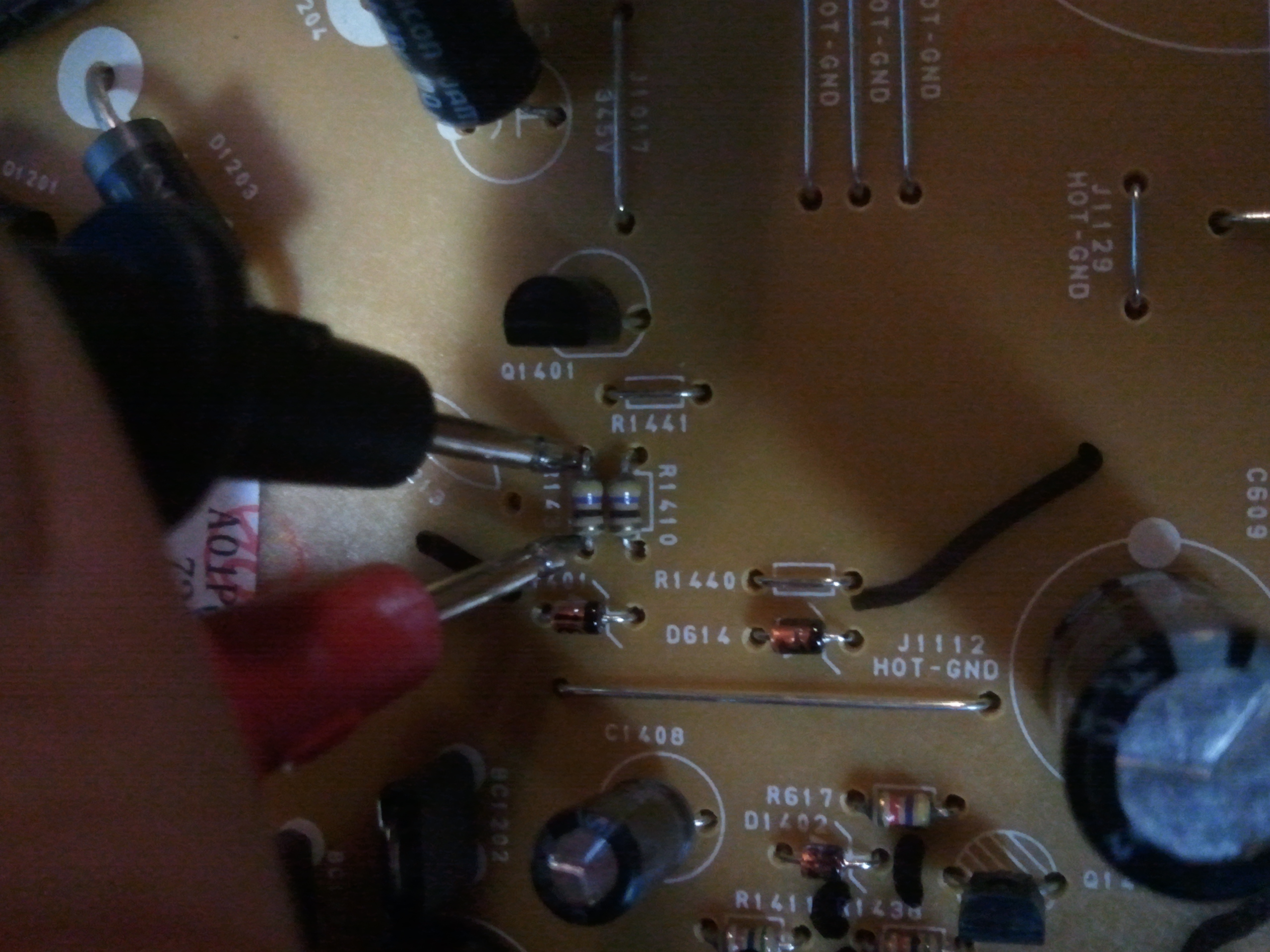

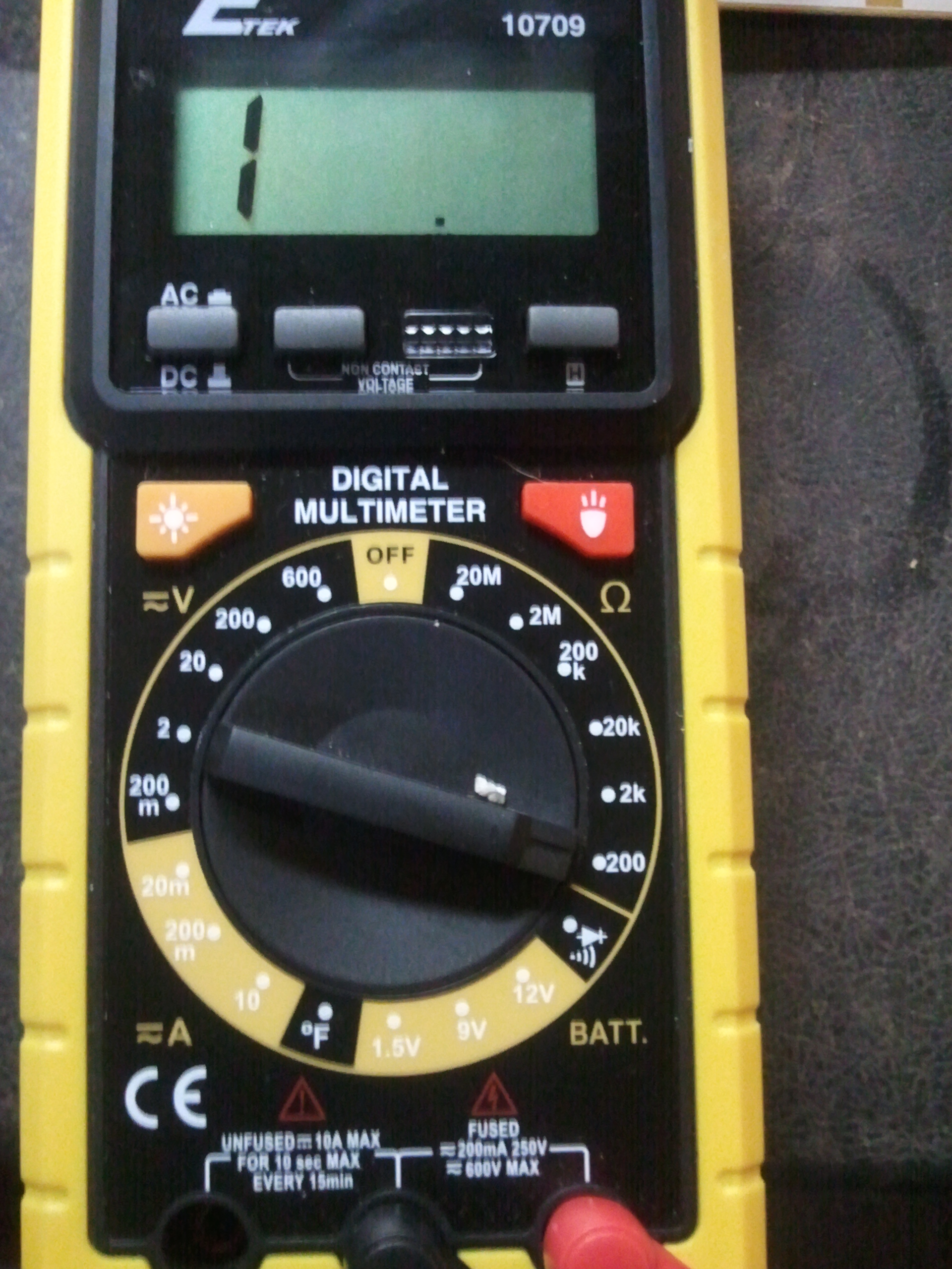

                          the meter is a Etek. the pictures show the settings and how i test.
                          • Mark369
                            • Jul 2009
                            • 163
                            what your testing in pic no 2 is a resistor not diode. turn your metre one more clockwise.
                            that is the diode mode.
                            • TimT
                              • Nov 2012
                              • 268
                              • us
                              I know thats was not a diode..i was just trying to show the way i test. i was hoping i had done something wrong! lol ok i will retest again with the right setting. thanks
