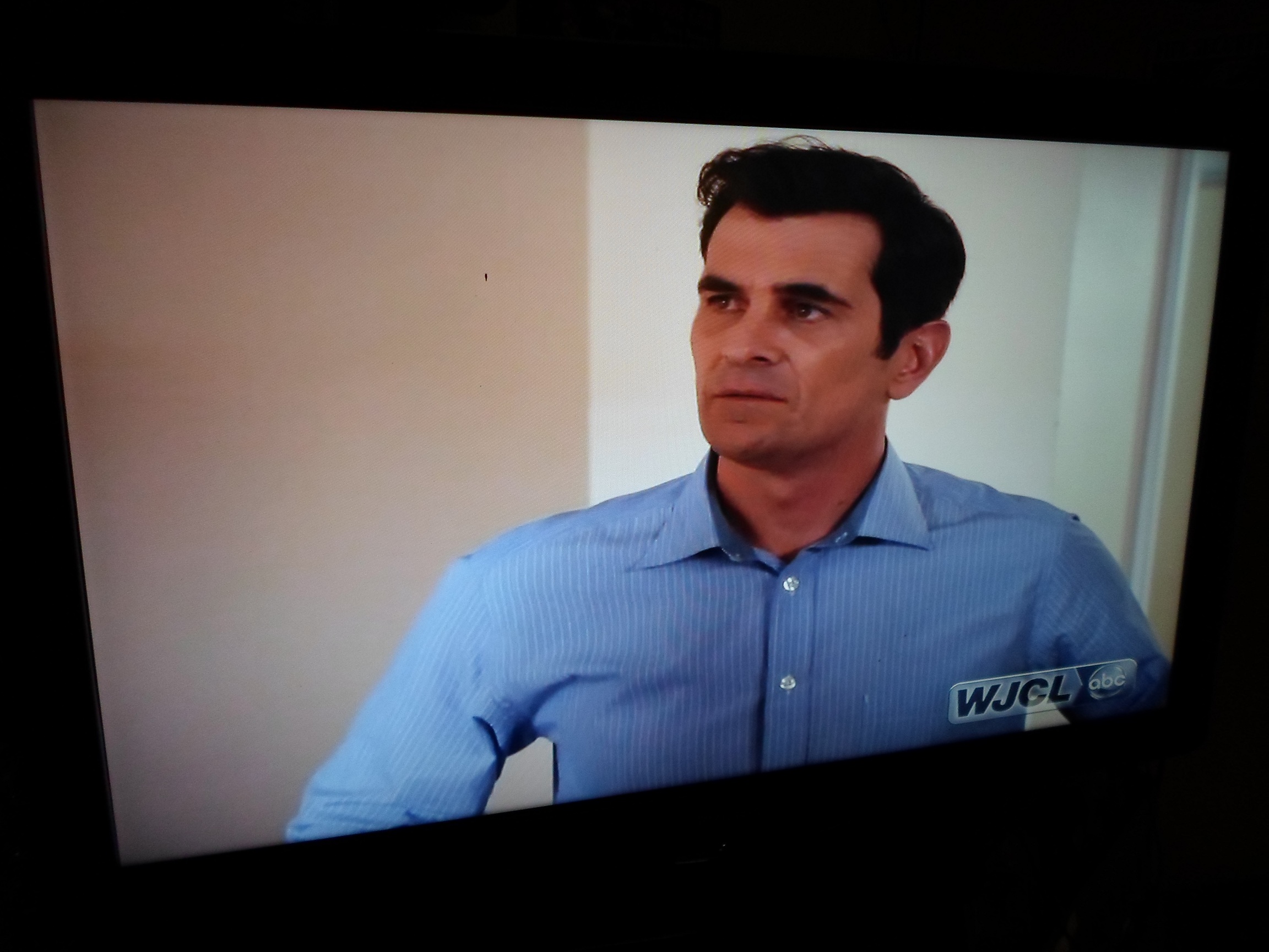

    Got The Tv back together! picture seems fine!! I would like to thank Budm, MisterD for hanging in there with me. Tv is working and looking good! and it seems I CAN ajust the brightness! Thank you guys so much!!

      Not bad! But what is that spot on the screen?

          LOL tom66 a little speck on screen. it will come right off, and thank you for your help!!! it will be a sad day when your no longer here!!

                  I'm glad to have helped and that it's fixed, I didn't want to give up, so did you just leave the PWM-SEL wire unhooked? btw save those AA Batteries you soldered together, you may need them for a future project.

                    yes I left it off it's working fine. thank you very much

                      You're very welcome! It would only be used for Backlight Level, that's why you can still adjust the brightness level because it's for the LCD Panel, I just checked my 42" Vizio and it's running at 85 percent backlight.
