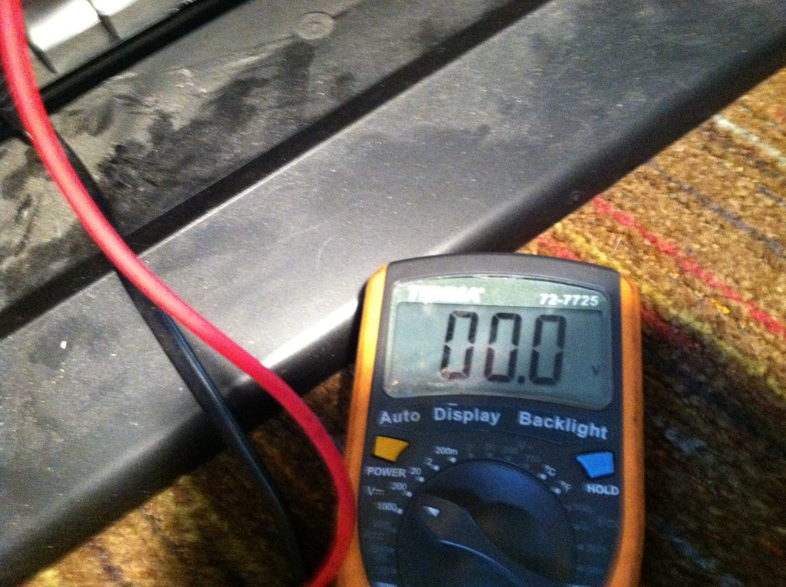

Am i measuring a/c volts or d/c volts for my 24 volt voltage?i have been setting my meter to d/cYou need a 24V, 8-10A power supply... if you have one, then provide 24V and connect INV-ON to 5VDC and DIM to 5VDC. [per TOM66]
I guess your friend didn't say anything new?
If you want to test your meter you have a reference with your powersupply for 24v.....at least human error is almost completely ruled out that way.Comment
Re: Sanyo dp42848. No picture no sound?has anyone found the problem
. Left upper on meter d/c vAttached Filesif you find these attachements useful please consider making a small donation to the site

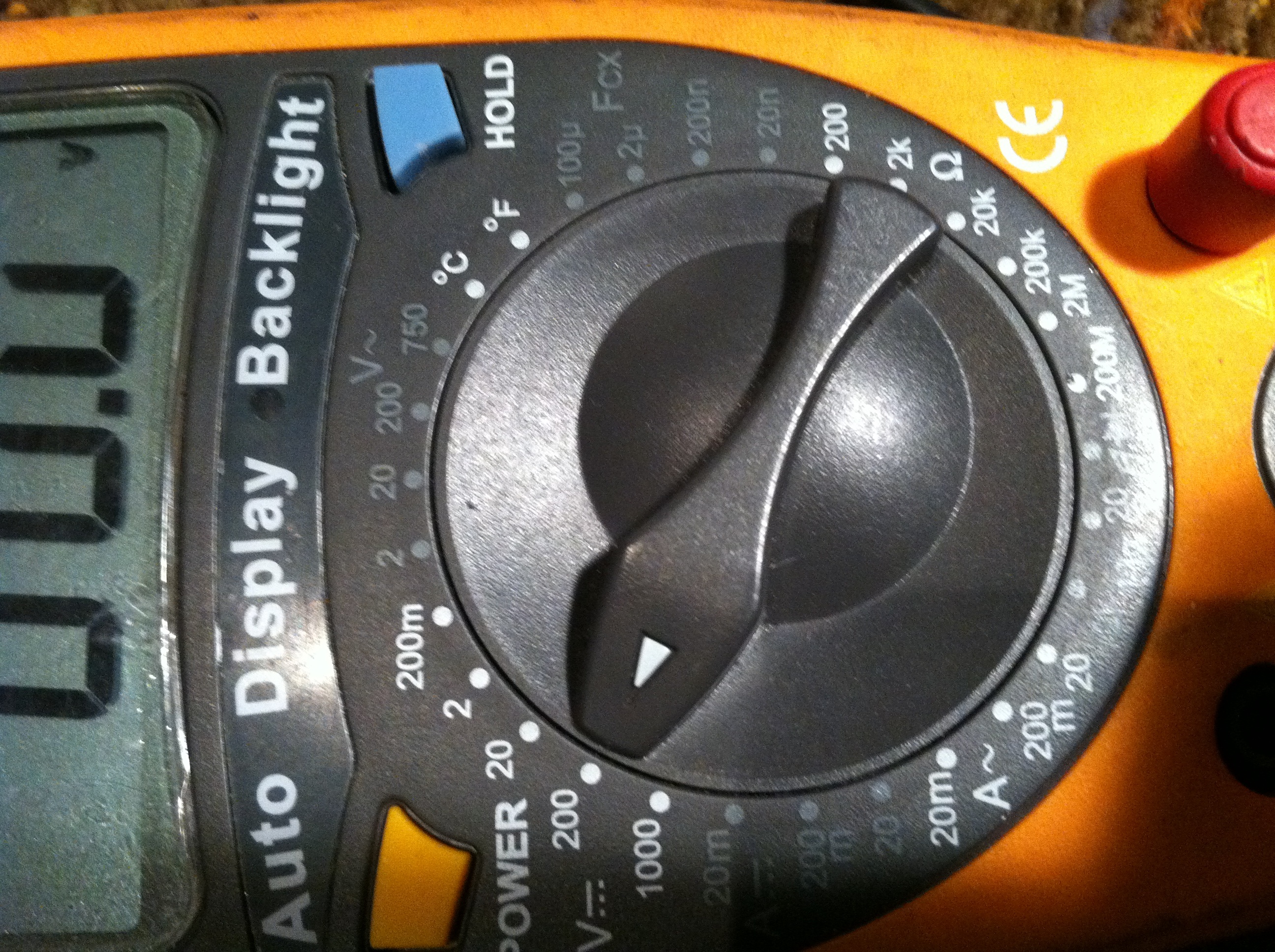

Wrong setting!!! Set to DC200V (the dashed and solid line.)Please do not PM me with questions! Questions via PM will not be answered. Post on the forums instead!
For service manual, schematic, boardview (board view), datasheet, cad - use our search.Comment
No wonder why we are not getting correct reading.Never stop learning
http://www.badcaps.net/forum/showthread.php?t=24809Comment

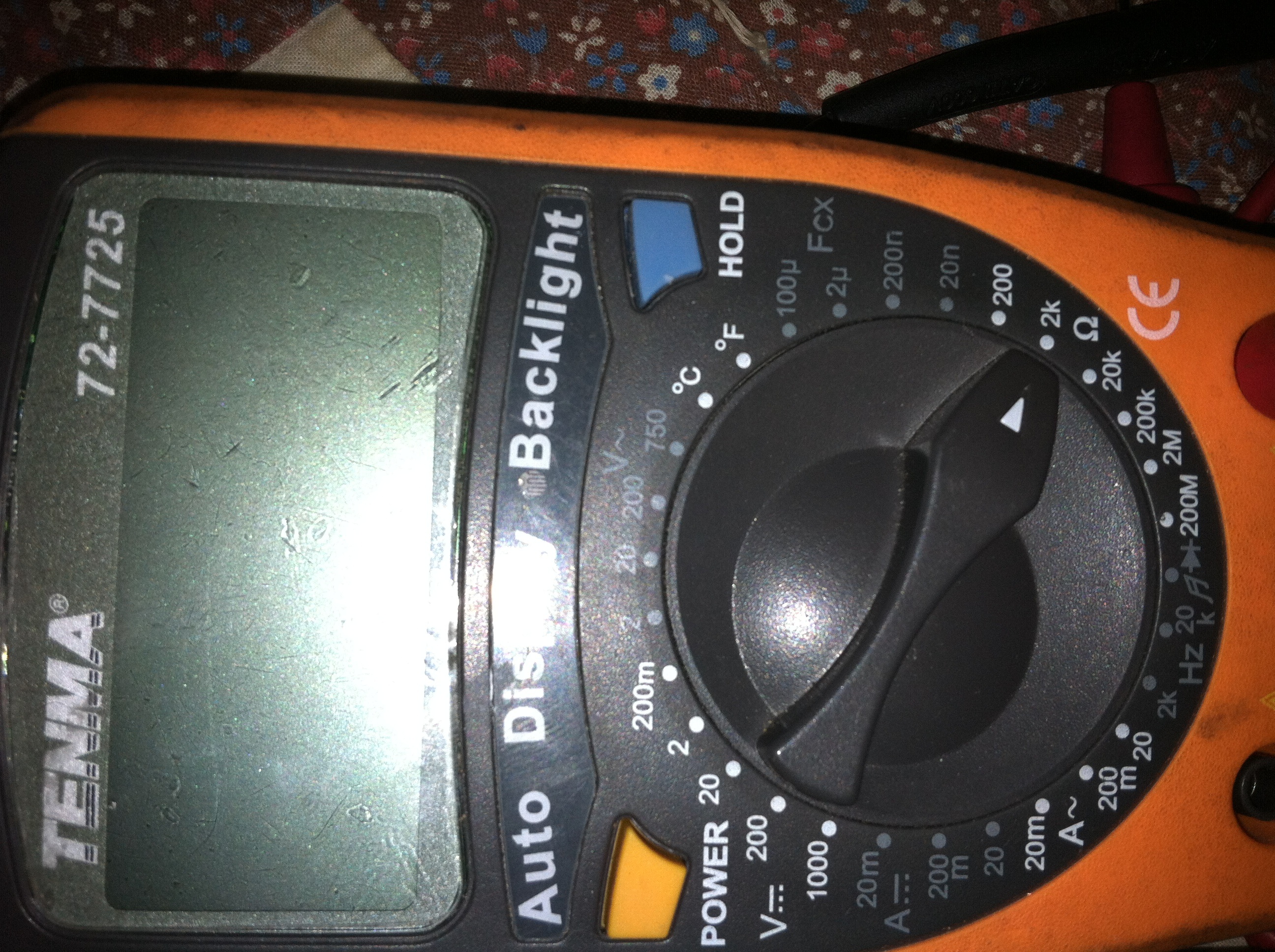

The picture of the meter shows ohms thats not were i set it too this picture of the meter is a stock picture of my meter,the setting when testing WAS SET TO D/C 200. So i was reading the meter correctly!so i will check the volts and send a pic of the meter with the setting before i start testing again..Comment

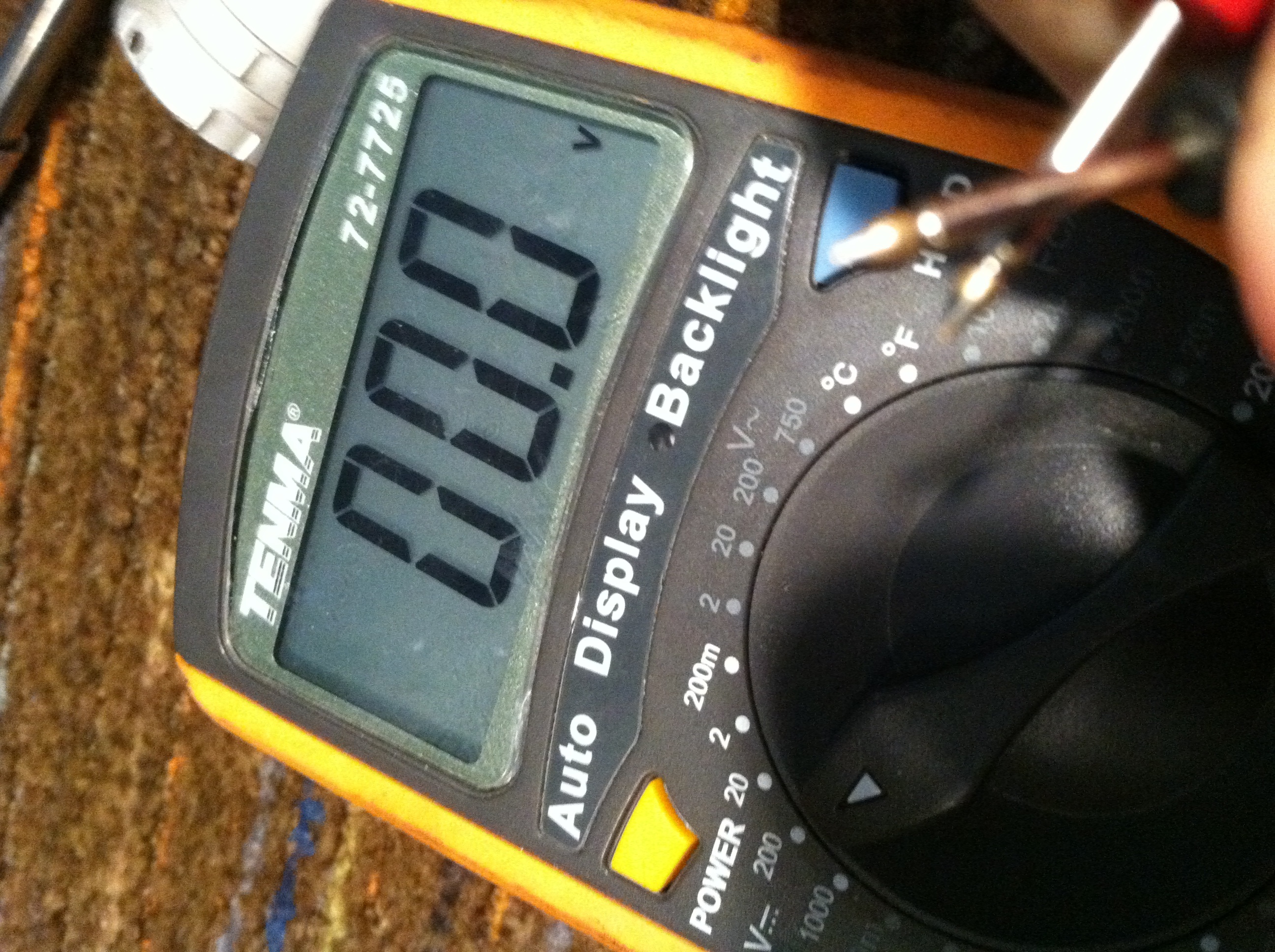

ok fresh start - check meter ohms 200 touch probes
reading +?
tv connected and all set up powered on

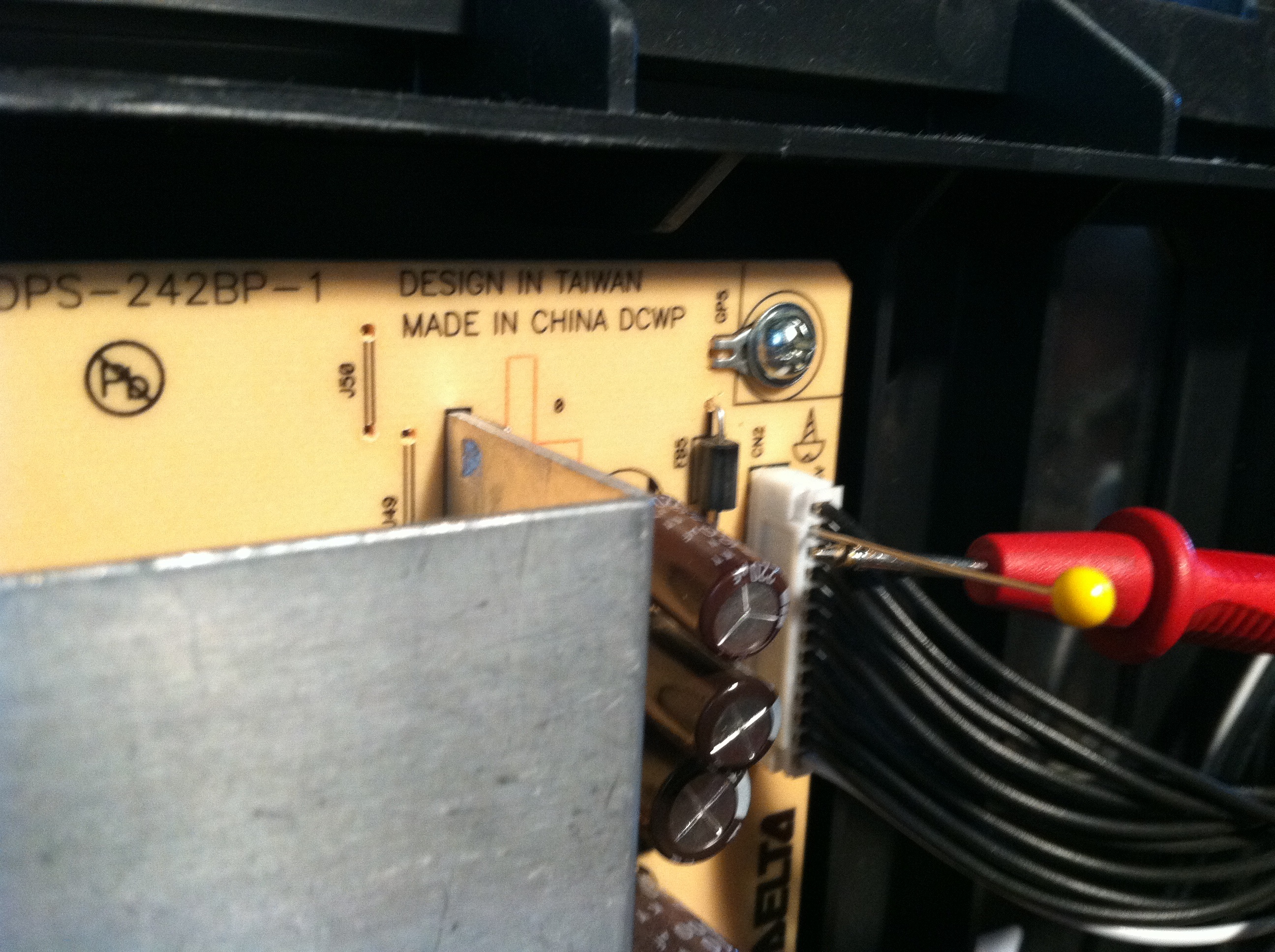

meter on 200vdc black probe on ground screw in corner of power board where it says made in china and the socket CN2
With the red probe test each pin and list the results in a column:
pson =
sgnd =
sgnd =
+5vsb = and so on.
