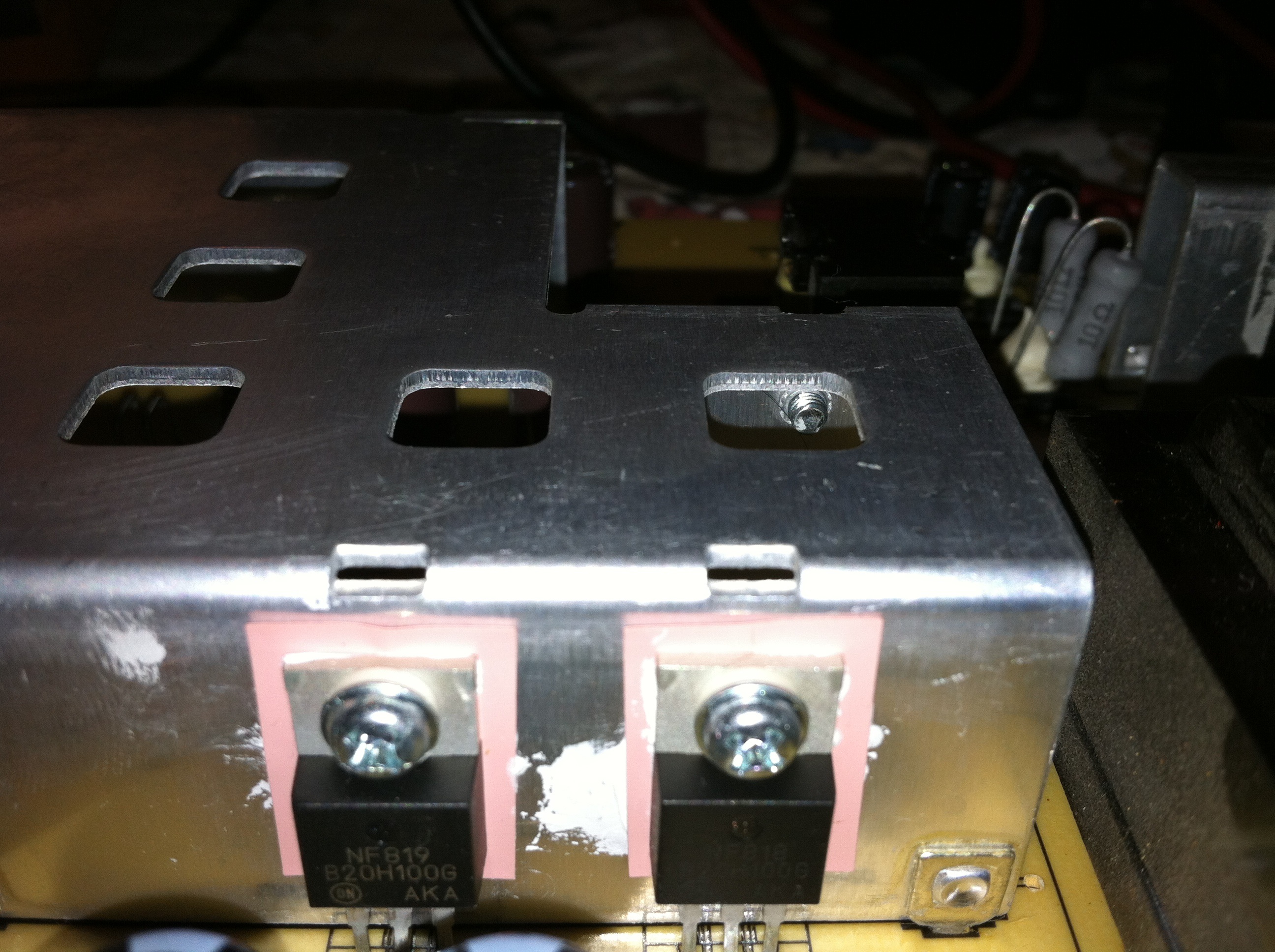

    Post 37 METER IN DIOD TEST RESULTS ON CIRCUIT-D240B- AND D-240A 217. IS THIS OK? THEN I PUT BLACK TEST LEAD ON LARGE SOLDER JOINT,AND RED ON LEFT SOLDER JOINT,AND THEN ON RIGHT SMALL SOLDER JOINT SAME READINGS ON BOTH CIRCUITS, 217 READINGS,WILL SENT PICS OF FLIP SIDE OF BOARD TO SHOW WHAT IM TESTING.

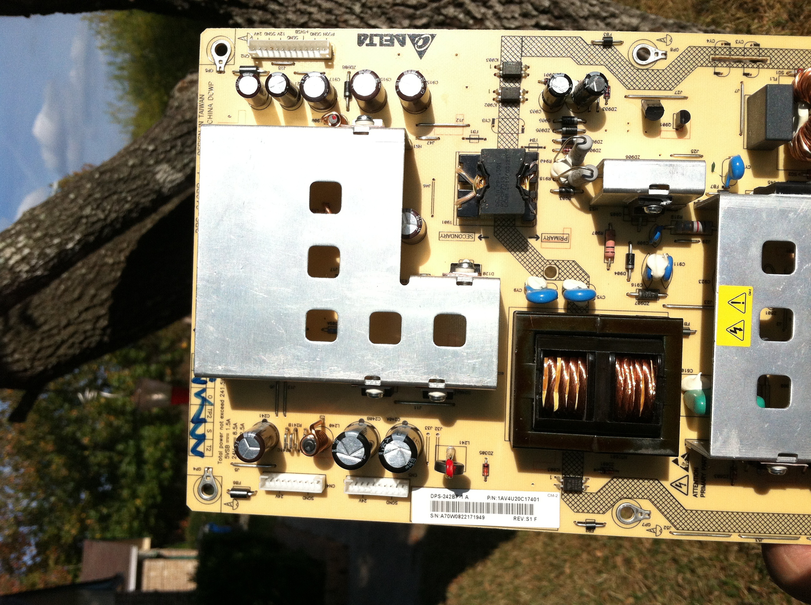

      HERE ARE THE CIRCUITS D240a D240b ARE WE WORKING ON THE RIGHT CIRCUITS?

            Post 62, yes, they are the two diode for the 24v POWER SUPPLY.
            Do you mean .217V as readout shown on the meter?

                [QUOTE=budm;287348]Post 62, yes, they are the two diode for the 24v POWER SUPPLY.
                Do you mean .217V as readout shown on the meter? NO METER IN DIOD TEST IS 217. NOT VOLTS
                  #68
                  Re: Sanyo dp42848. No picture no sound?has anyone found the problem
                  Well your meter must not be the same as most other meter, my FLUKE show 0.290V which represents the Forward voltage drop of 0.290V, but any way, that seems OK if I can believe your meter reading, the Forward voltage of your Diode is .217V.
                  Well I cannot see why you are not getting any 24v since the transformer is OK, the Didoe are OK, the 12v section is working.

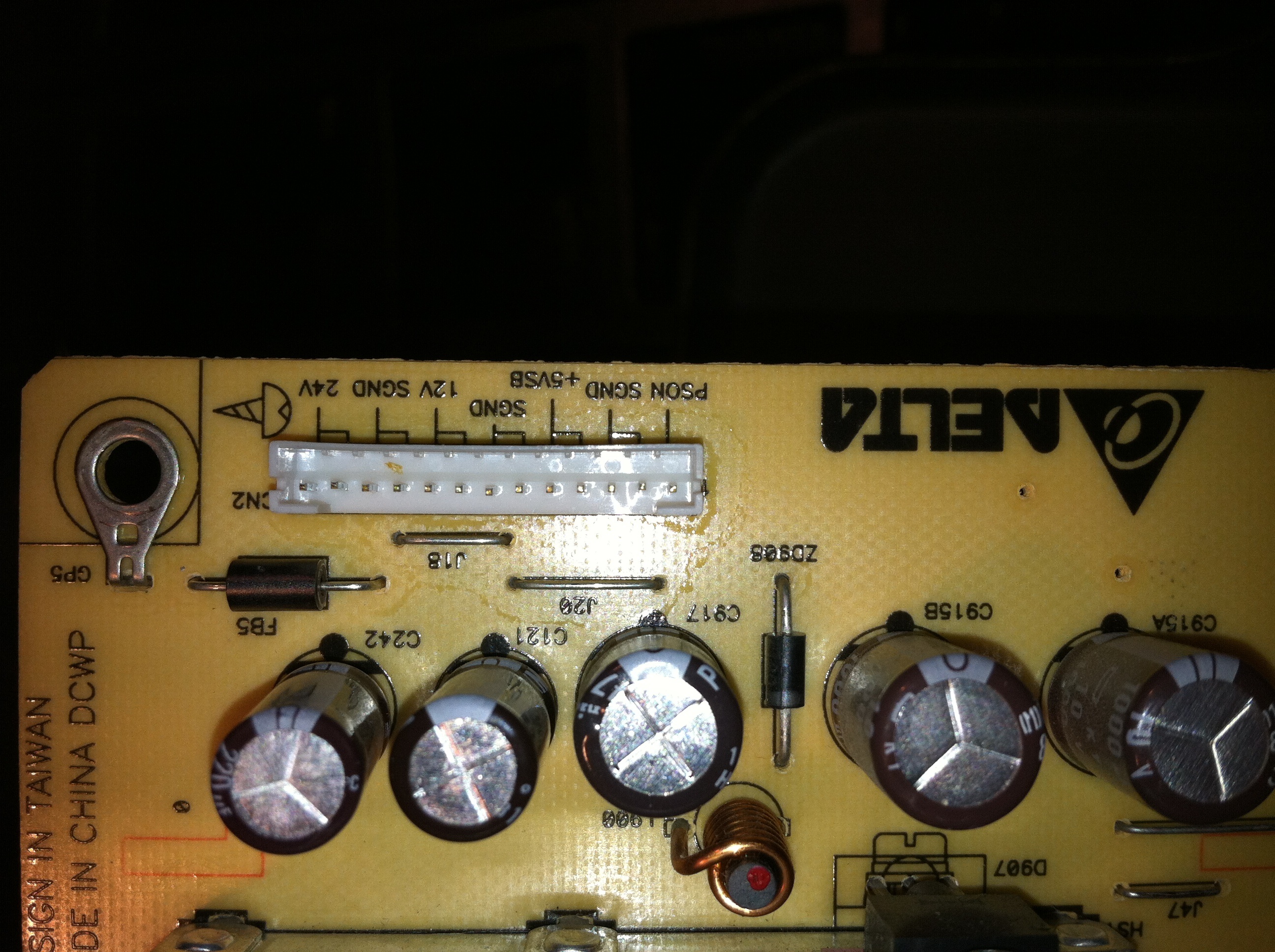

                                  IF YOU LOOK AT THIS PLUG YOU CAN SEE WERE IT SAYS 24v THE BOTTEM SAYS PSON STARTED AT THE TOP WAS NO RECIVING 24 volts WITH CONNECTOR PLUGGED IN I BACK PROBED WITH A SEWING NEEDLE?

                                    STEP 2 ON THE LEFT SIDE YOU CAN SEE TWO PLUGS,UPPER LEFT I STARTED AT THE TOP PLUG NO 24V TO THIS PLUG ALSO,ONCE AGAIN WIRES PLUGGED IN AND NEEDLE TO BACK PROBE..SAME AT THE BOTTOM PLUG NO VOLTS. Here is a picture

                                      Please don't type in all caps -- it's quite hard to read.
                                      Anyway, I know some Delta power supplies of this generation used fuses on the output. I have seen a few of them. Both in Philips LCD TVs.
                                      It would be very rare for a power supply to fail to produce 24V, but still be able to produce the 12V, etc.
                                      Fuses will be marked like "F8A/32V" near them; can you see any?
