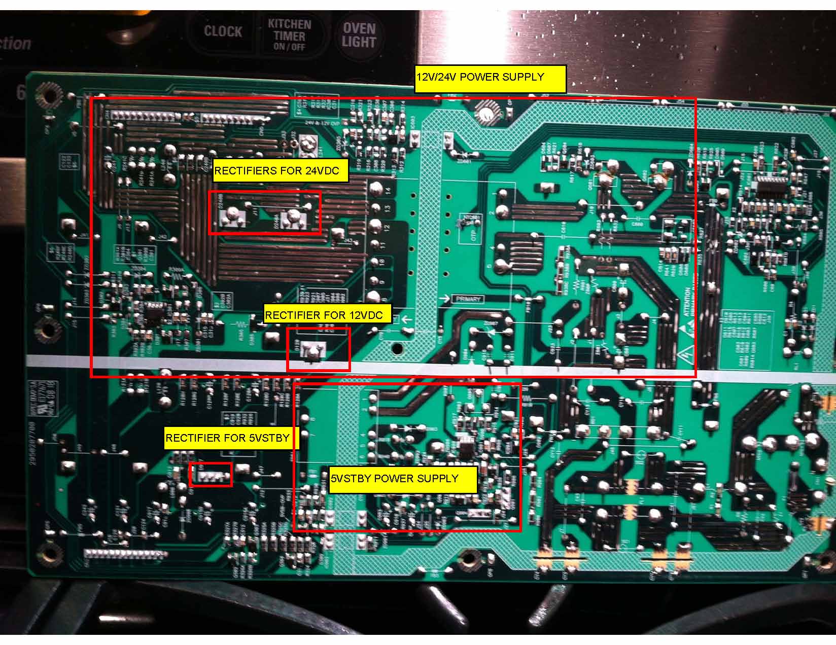

                    #29
                    Re: Sanyo dp42848. No picture no sound?has anyone found the problem
                    Ok here are the readings. P/S CH-2 circuit top to bottom sgnd-0 sgnd-0 sgnd-0 sgnd-0 sgnd-12.05 sgnd-12.05 sgnd-0 sgnd-0 sgnd-4.96 sgnd-4.96 sgnd -0 sgnd-0 sgnd-4.89. The tv is powered on all circuits plugged in, don't know what else to check on the power board?seems to be a fuse or no high voltage at all ...
                      #30

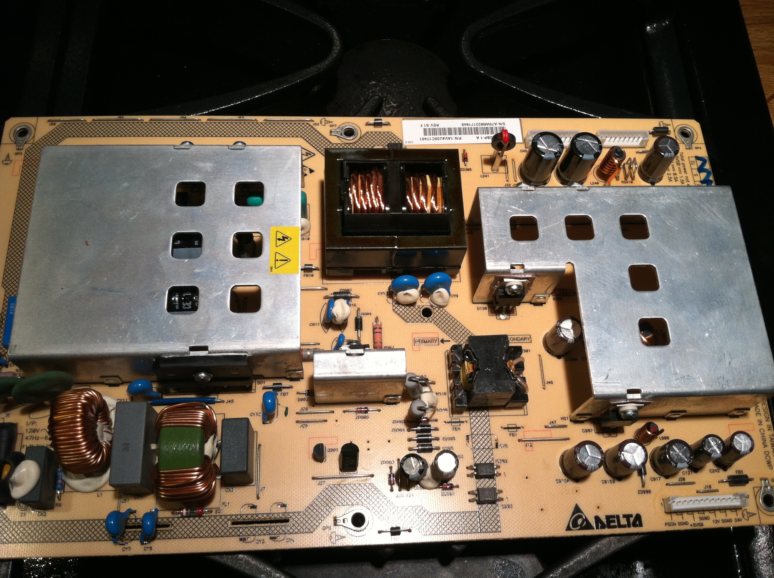

                      Can I get good clear pictures of both sides of the power supply board, I need to see how this 24v section is controlled.

                        #31
                        Hope this helps

                          #32
                          Ft of board
                            #33
                            It is not in focus, I think I can see the problem but it is out off focus.

                              #34
                              Is this the side you want to see?
                                #35
                                OK, the 12vdc and the 24vdc are generated by the same transformer and circuits, since you are getting the 12VDC OK, then you have problem in the 24vdc rectifying circuits. I can see bad solder joints. Also take the resistance reading on those two points.

                                    #37
                                    OK, take the reading between pin 12 and 13, and 12 and 14 of that transformer T1.
                                    RECTIFIERS check, see picture.
                                    By the way, just to be sure, you do have 12vdc reading when you hit the TV power switch and the 12v is there but no 24v, is that correct?

                                        #39
                                        SO it has to be in the 24v output section, please read updated post 37.
