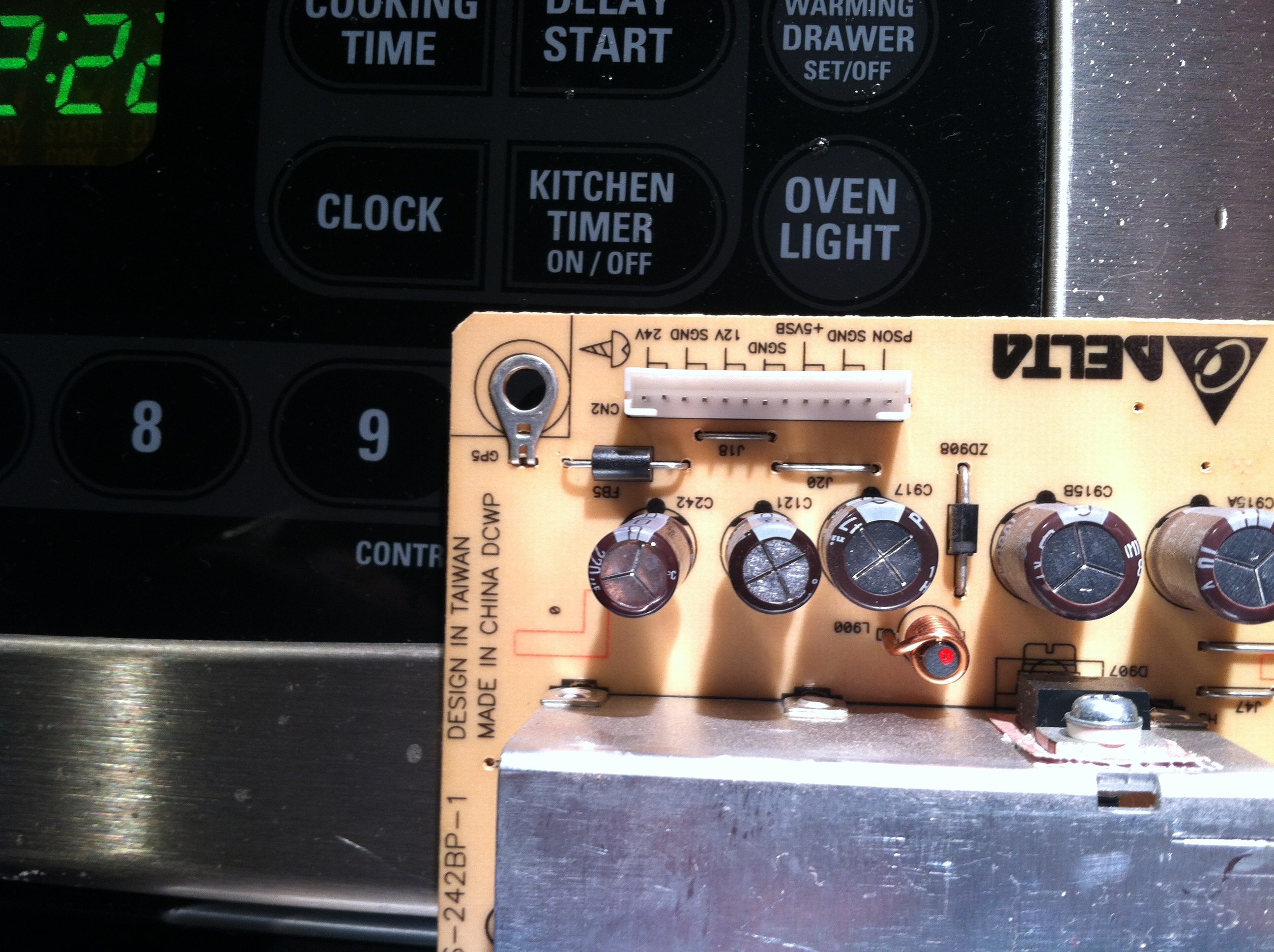

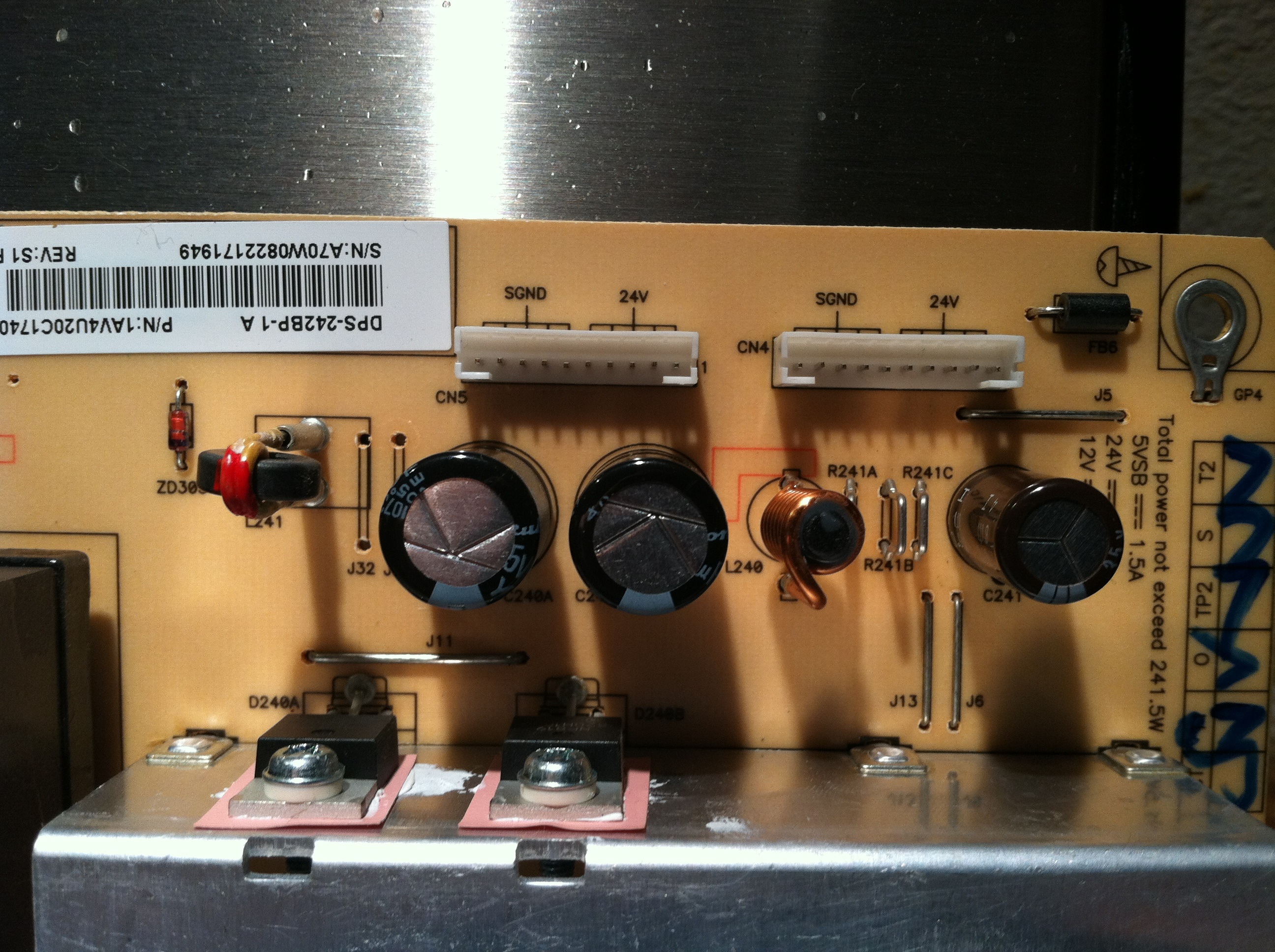

                              Re: Sanyo dp42848. No picture no sound?has anyone found the problem
                              OK, the 24v power supply is not working.
                              johnboy1313 posted the picture of the power supply board but did not show the closed up pictures of the 3 white connectors, we need to verify if the power supply is getting the PS_ON signal from the main board to turn on the 12v/24v power supply.
                              Can you post the pictures of the connectors?
                                Hope the pics help
                                  Hope the pics help
                                    What is the voltage on the first pin (PSON) of that connector (CN2) when turned on?
                                    Actually, listing the voltages at each pin when the TV is on might be helpful.
                                      I will reinstall the board in the morning in a couple hrs.i think the voltage is low what should it be?
                                        It should be >3v for PSON.
