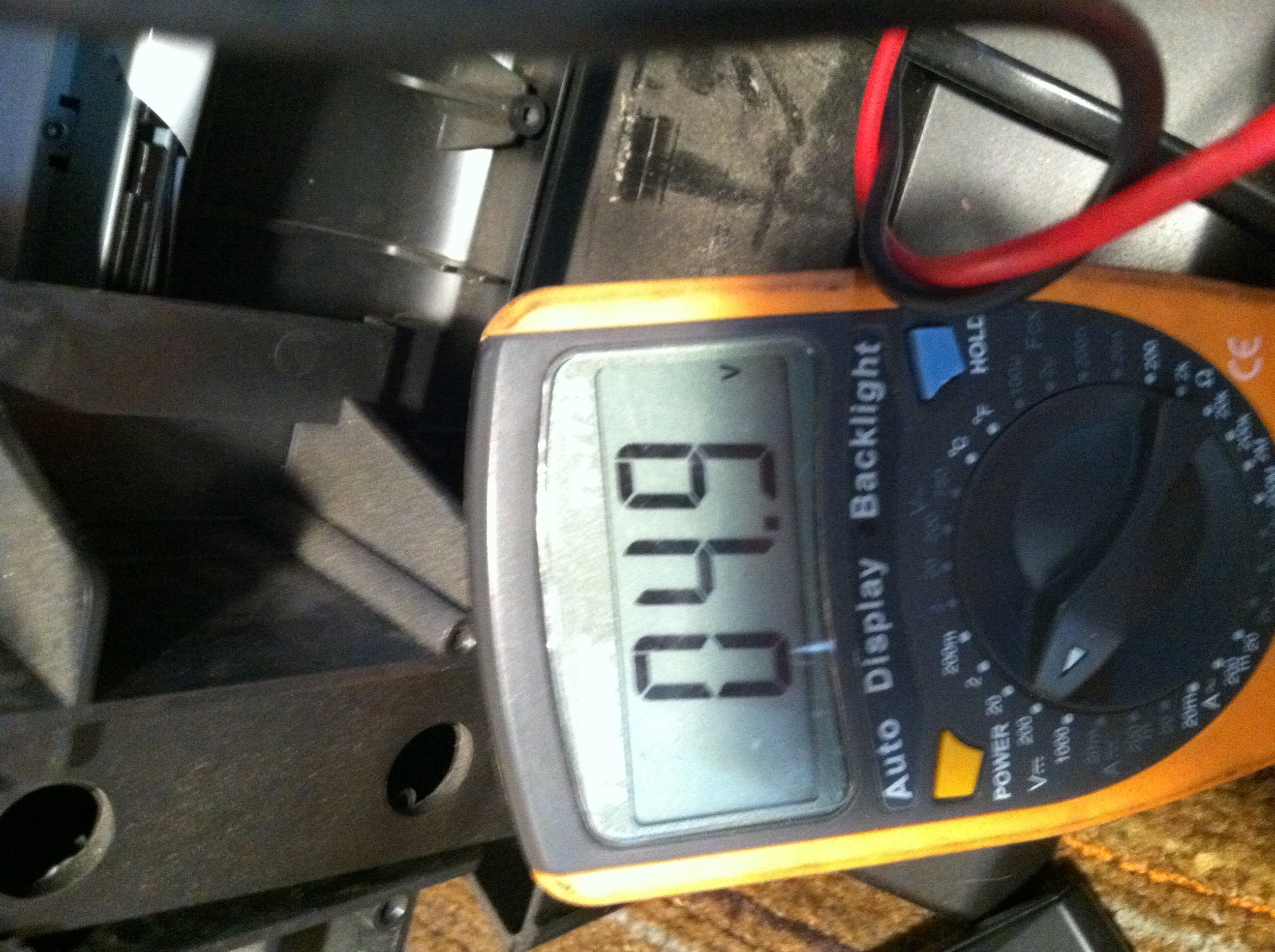

      Re: Sanyo dp42848. No picture no sound?has anyone found the problem
      Pson-4.9 v
        Pson results-

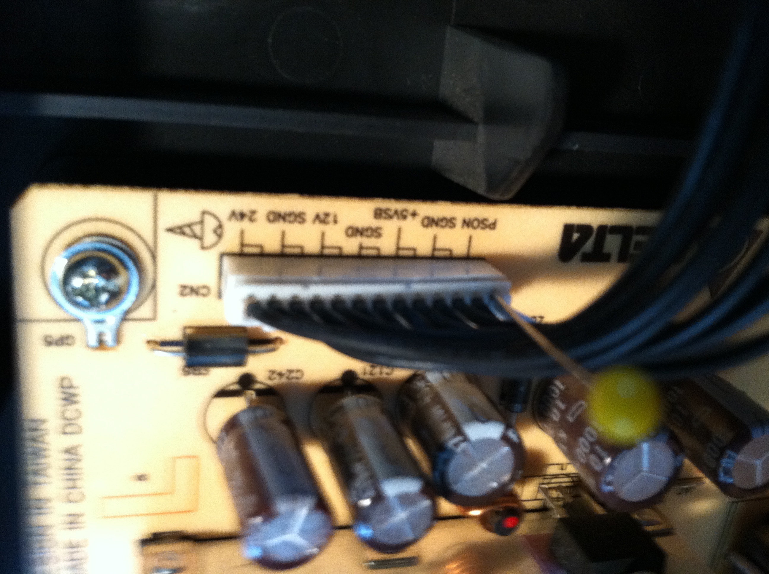

          The pson voltage
          • selldoor
            Slow Learner
            • Dec 2010
            • 7870

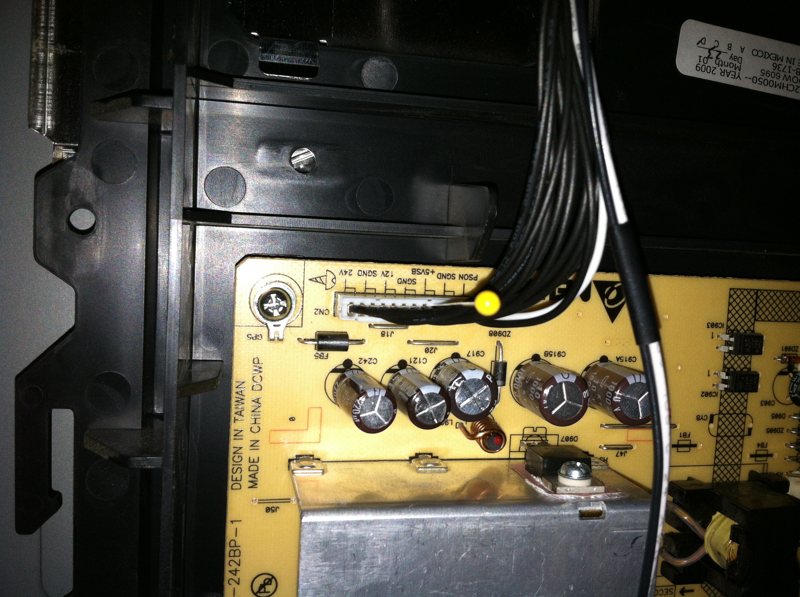

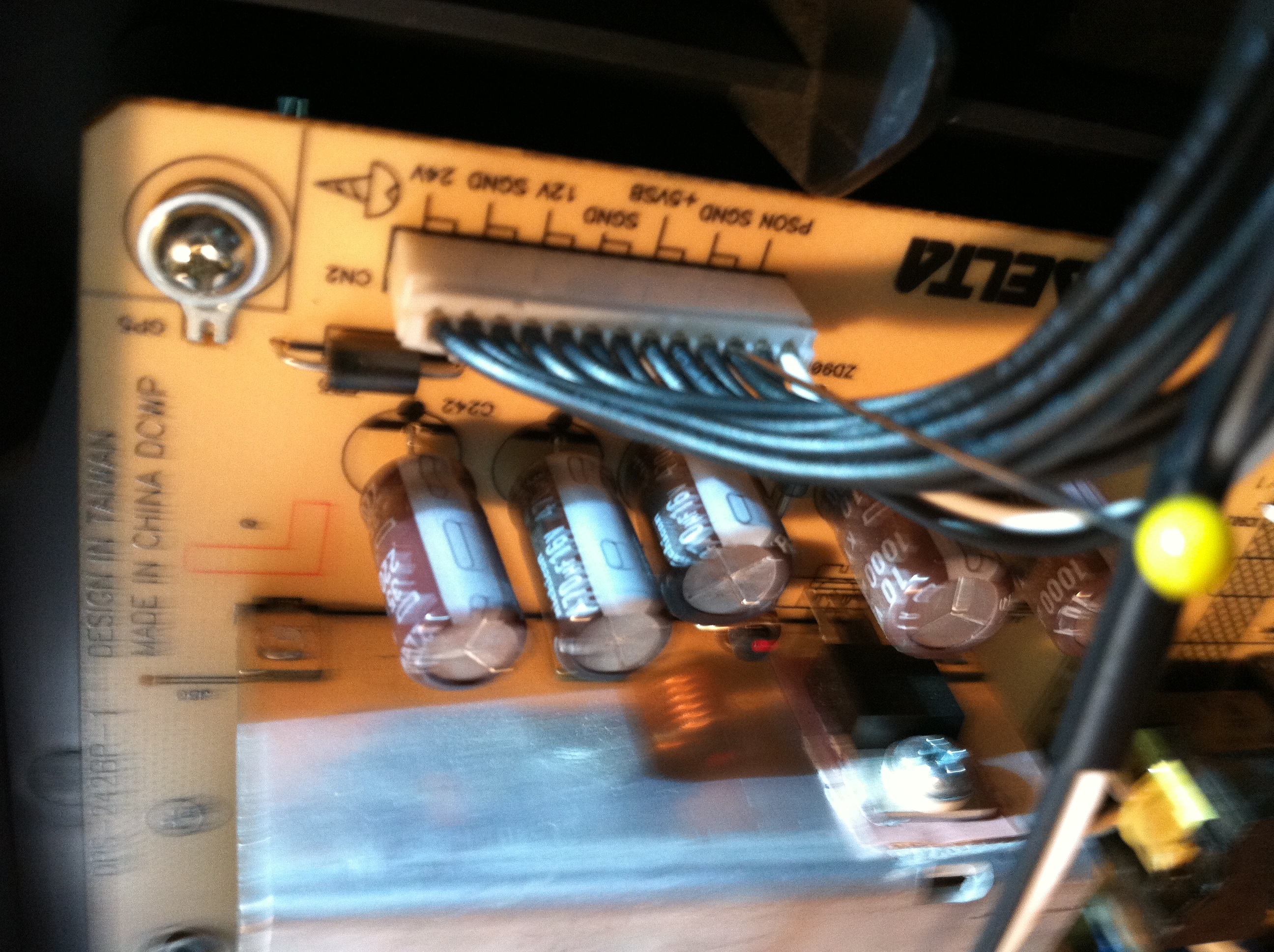

            #165
            Stop that and just list the results as I asked you to - Are you using that ground screw we can see in the pictures for the black prob.
            And did you do the first Ohms probes touch meter test.

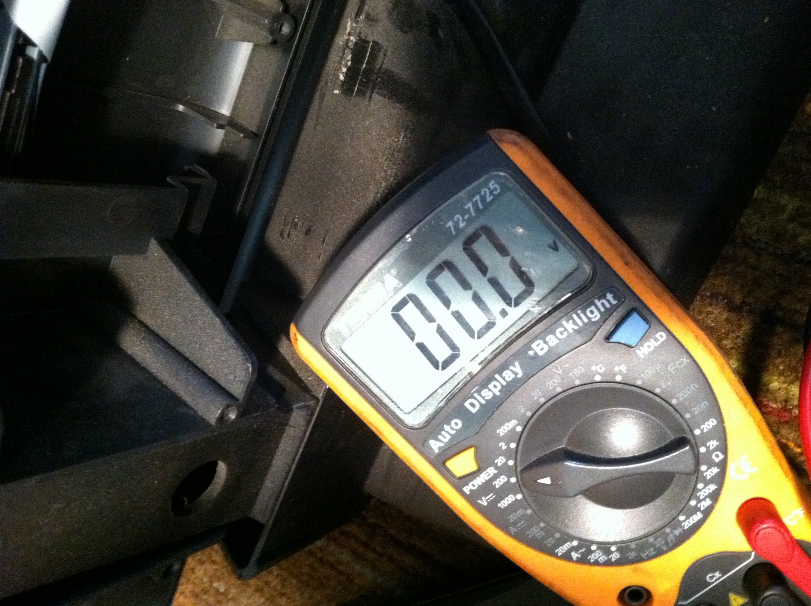

              Sgnd 0 volts
                0 volts sgnd

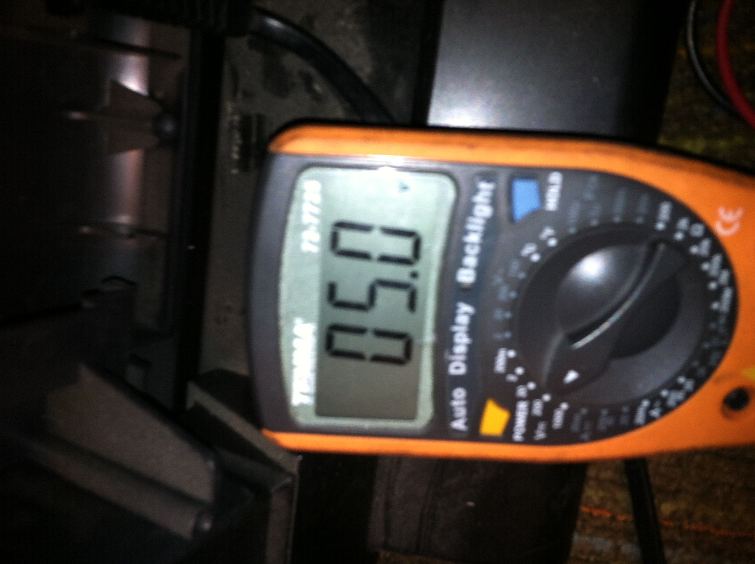

                  5vsb
                    Results 5vsb-05.0
