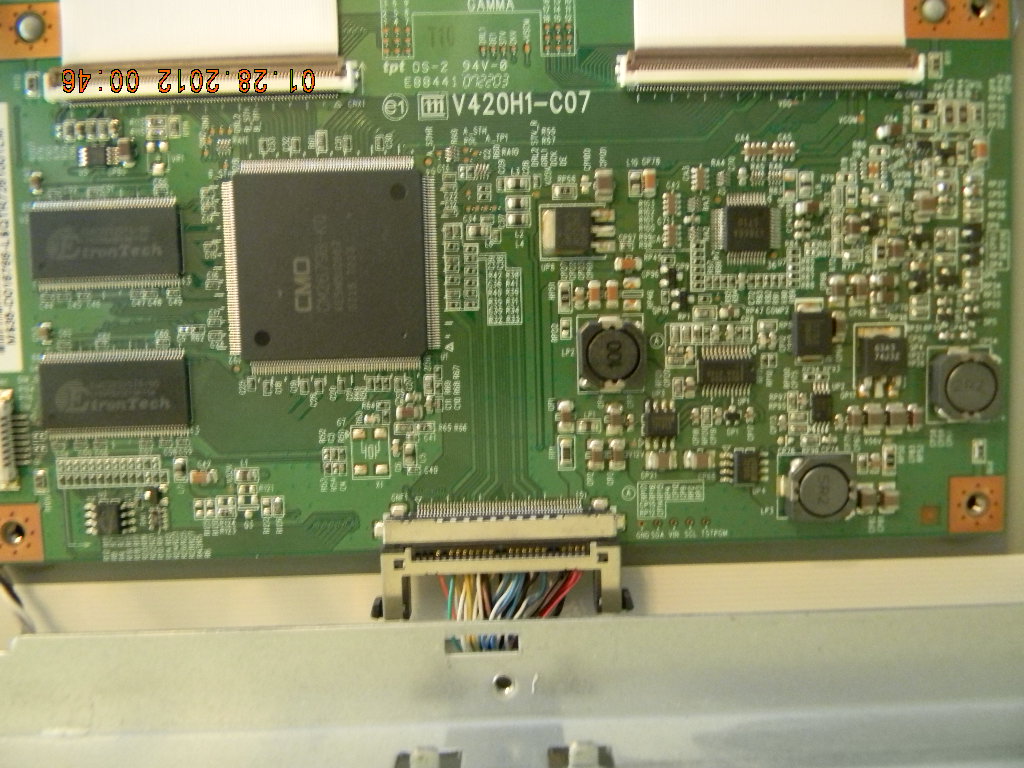

                  #108
                  Re: Philips 42PFL5432D/37
                  THE NIGHTMARE CONTINUES !!!!!!!!
                  The t.v. played all night last night so I put the cover back on this morning, hung it back on the wall, and within an hour, IT WENT OUT AGAIN !!!
                  I turned it off and then back on only to get less than an hour, sometimes only a few minutes, before I lose the picture again.
                  So, when the hubby gets home, he helps me hoist the big stupid heavy thing down off the wall, and lay it flat on the entertainment center. I proceed to take everything off the back once again. I inspect all the caps, new and old, nothing is visibly wrong, polarity is correct, no bloating etc. So, I switch it back on, wait for it to go off again, and it plays for over 3 hrs. What the heck is going on?
                  This time however, there are a few things different, when I lose the picture.
                  1. The green light stays on.
                  2. White lights in the back stay on.
                  3. Sound stays on.
                  Any suggestions ????????????? I'm sooo frustrated with this t.v. but am not about to give up. IT'S WAR
                  • retiredcaps
                    • Apr 2010
                    • 9271

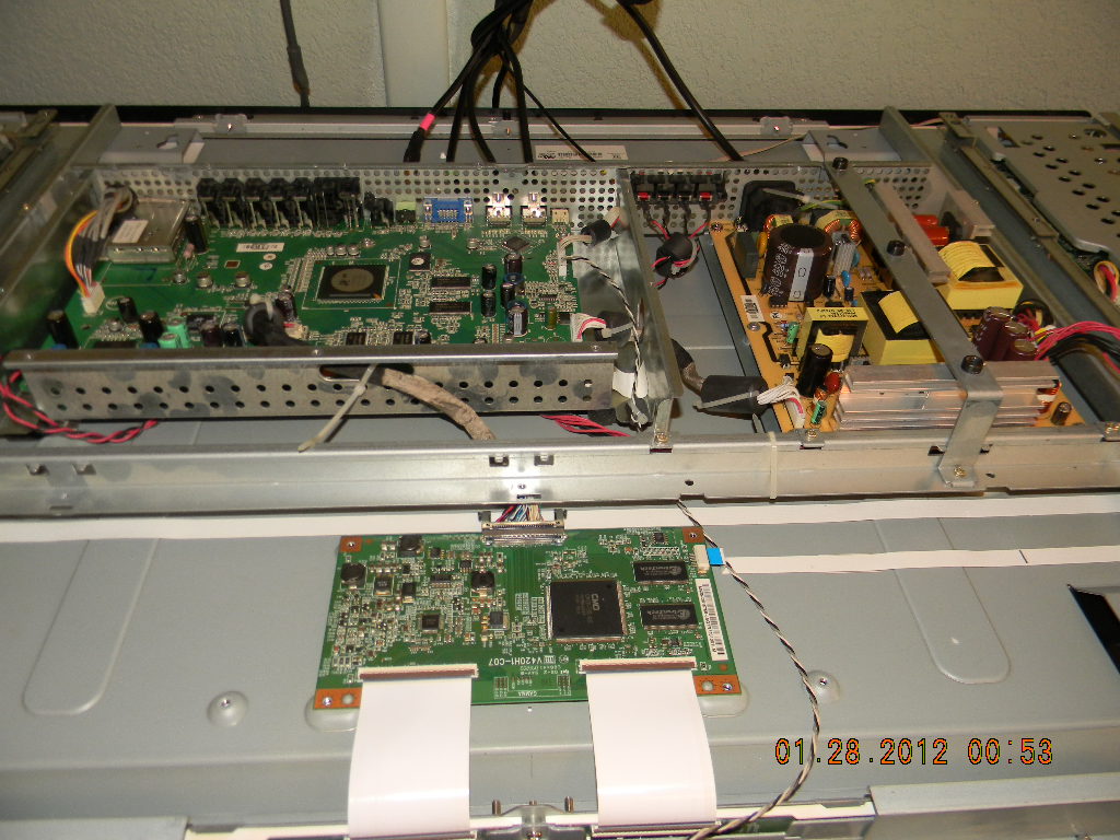

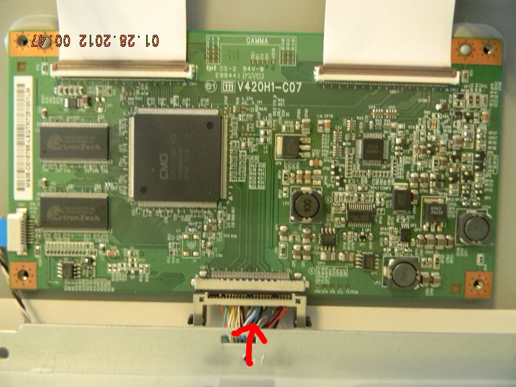

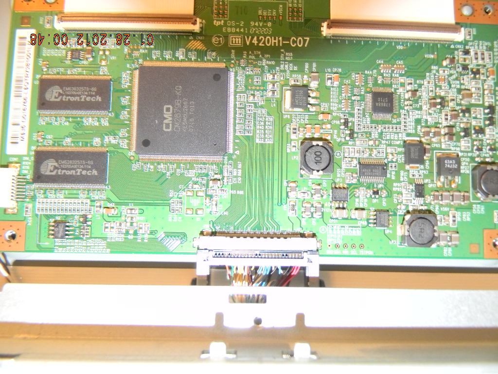

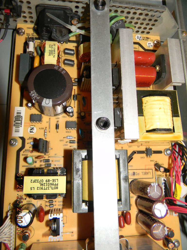

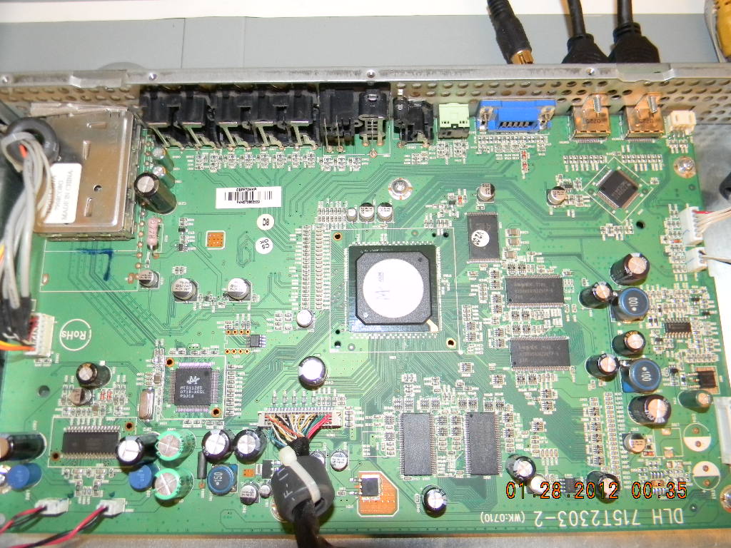

                    #109
                    3. Sound stays on.

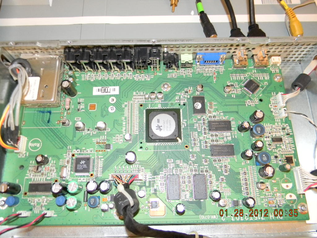

                    1) That suggests your main/logic board is working.
                    2) That suggests the inverters are getting 24V DC (that is new Panasonic 1500uF 35V caps are working).
                    3) That suggests your main/logic board is working.
                    New ideas.

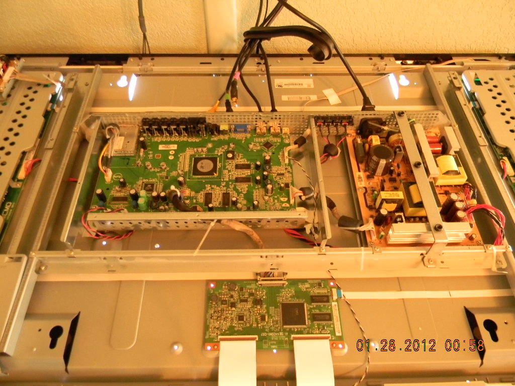

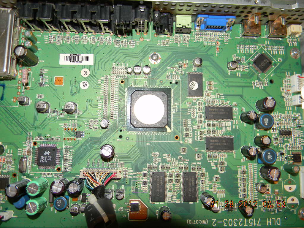

                    1) Let's get an overall shot of the main/logic board so it looks like this (top down view). Tbuch saw 3 bad caps on her main/logic while I spotted 4. Maybe there is another on the main/logic board that you are missing?
                    We want the picture composition to be like this with resolution as close to 2000x2000 as possible.
                    https://www.badcaps.net/forum/attach...6&d=1310471174

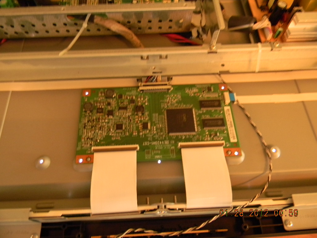

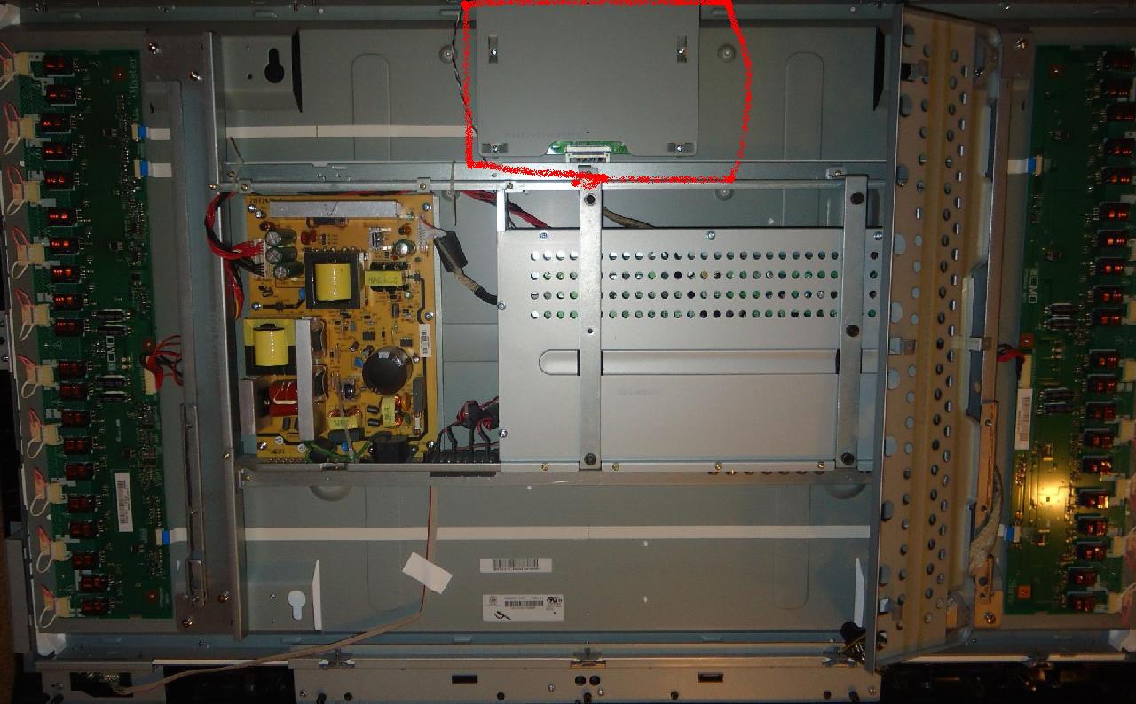

                    2) This is a shot of the same TV by someone else. Circled in red is the t-con card. Take off the metal shielding and post a picture of it with the same picture composition as above.
                    3) Notice that the t-con card has a connector coming in from the bottom. Reseat this connector. There is a very small possibility that the connector when in the vertical position isn't making 100% contact.
                    The connector may be fragile so be gentle/careful with it.
                    4) Notice that the t-con card is the most northern module. When the TV is vertical and mounted on the wall, it is possible that all the heat rises towards this t-con module and it is failing due to heat and no air circulation. With the cover off and the TV in the horizontal position, heat dissipates in a different pattern versus wall mounted/covers on.

                        #111

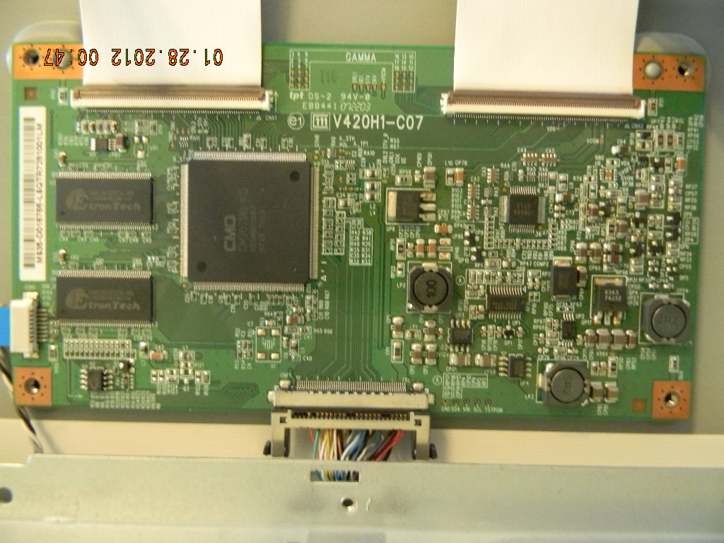

                        Here are the latest pics. Notice the lights are on in the first & last pictures.Thanks sooo much for all your help.........AGAIN !!!!!!
                          #112
                          Try checking if this connector is fully plugged in. Trace it to the main board and check that side too.
                          • PoteauPets
                            • Jan 2012
                            • 65
                            #113
                            Just checked it and the side that you indicated was okay. I traced it and found where it went to the board. Left side popped off when I gave a little tug, then I lost picture. I snapped it back on, picture came back. Tugged it gently again to make sure it's locked and it is. Think that may have been the problem ?
                            Hubby is on his way home & I was thinking about having him help me prop it up to see what happens.
                            BTW, The stupid thing has been on ALL DAY while laying face down on the entertainment center.
                              That would make sense you probably had to remove the connector to solder the replacement caps.
