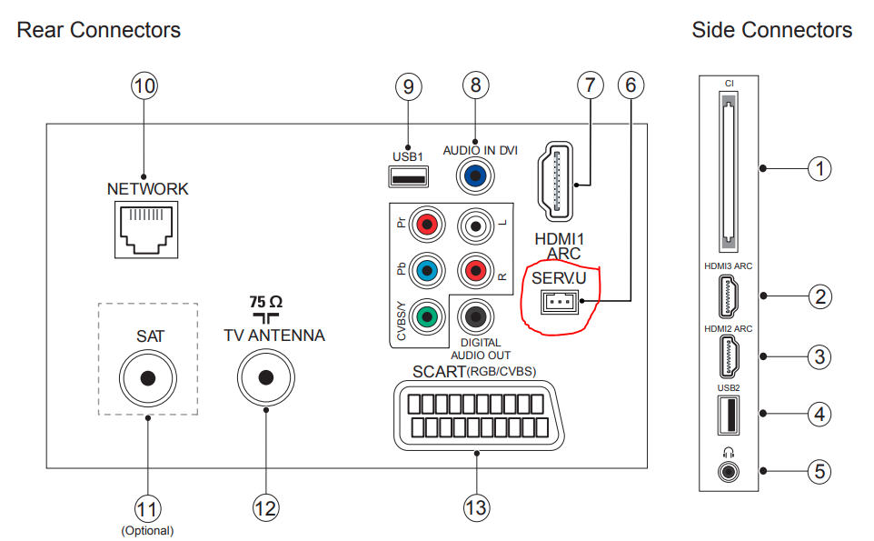

    Maybe i could make an RS232 connection to check the boot messages?

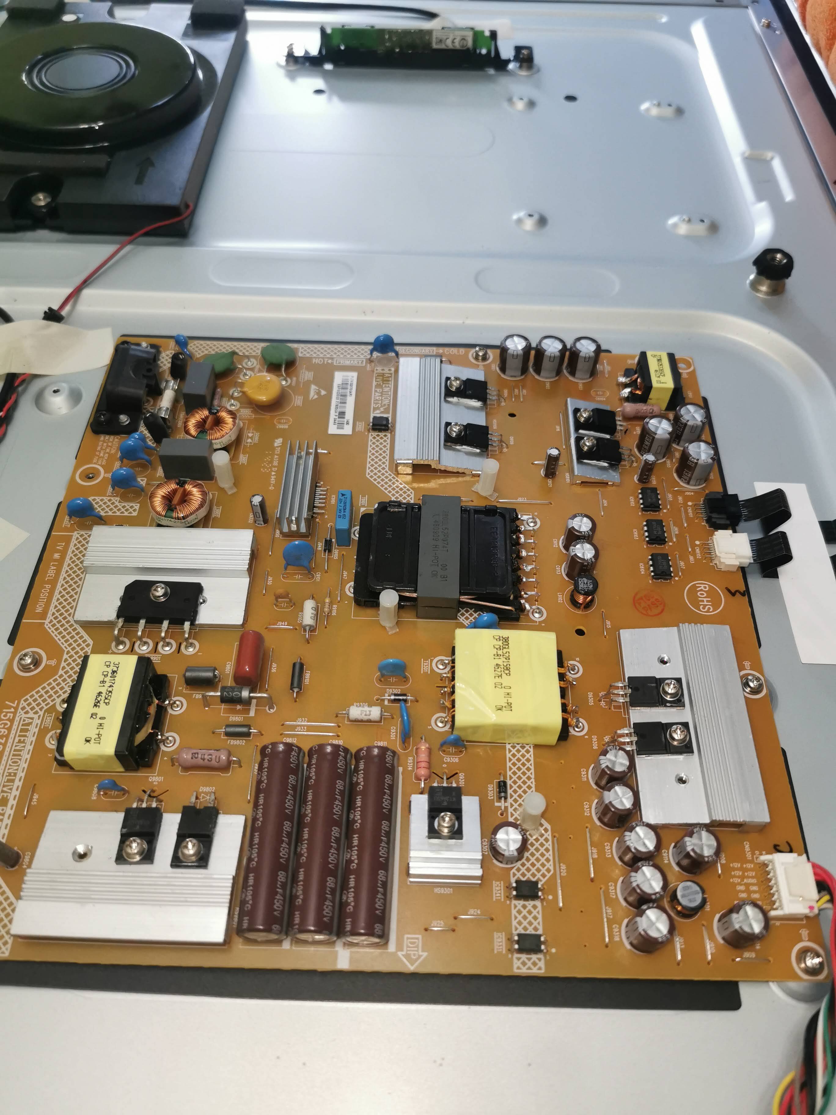

                The TPM14.X series are known for the bad caps in the power supply, several caps will be bulged.

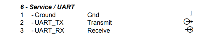

                    I will probably try that. I need to build a cable. My UART connector seems to be on jack, being a 7500 series TV

                      I know it is not OK to judge the capacitors only by looks, but these seem perfectly OK. If you think there is a reasonable doubt, i can desolder the and measure/change them. I attach a picture.

                        i say backlight not ambilight, in the picture i do not see the bottom 4 pins label of connector, can you list them?
                        But first of all follow what William says , try to apply 12v from external PSU to the tv PSB 12v output, check if the ext psu goes in protection, there are some rare cases of el. caps. that goes short on a certain load, locating the bad dude is a bit complicated , so replacing them all can be an option.. instead of protected psu you can use bench psu with fixed current.. you can also contemporarily add a strong load like 12v 50w light bulb/s to increase curent in el. caps , or you can heat them..

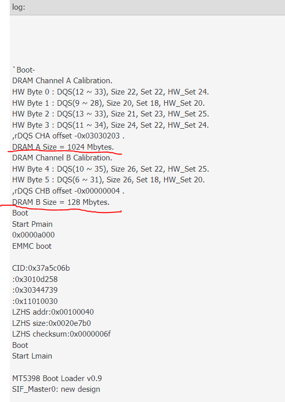

                            OK, this UART idea was brilliant, thank you.
                            I made a cable, connected to PC with Putty and made a log.
                            I already see some issues, but i am pretty sure that many if you will see the problem.
                            eMMC Name: UNKNOWN
                            Dev Num: 0, Timing Position: 1, Sample Edge: 0x00
                            Dev Num: 0, Timing Position: 2, Sample Edge: 0x00
                            : 0
                            *** Warning - bad CRC, using default environment
                            It may indicate a bad eMMC, but verifying the firmware update seemed OK.
                            Please analyze the log and advise.
                            I also attach a "normal", cold boot log, here i don't see that warning.
                            Best regards,
                            Janos

                              i read it alll, also in working tv there are many "error" here and there, its normal, the only my suspect here is the DRAM B detected as 128mb, is it so by the chip marking? (the other one is 1gb)
                              ..at a certain point there is an "environment" error for low memory maybe.. and the program stops..
                              this tv symptoms leads to many fault types..

                                "eMMC Name: UNKNOWN"
                                Either the eMMC is dead, or the processor does not see it.

                                  if both ram are the same, try reflow at the ram 2 maybe
                                  • lotas
                                    • Jan 2016
                                    • 4912
                                    • Russia
                                    What does DRAM have to do with it, everything is fine with it, why re-solder it to kill the motherboard completely, what kind of advice is this? Here is the boot log of this chassis and the same thing.
                                    • Davi.p
                                      Hobbist Tech
                                      • Sep 2009
                                      • 4546
                                      • Italy - Milan
                                      what i read is the size of dram b is 128mb, i asked the user to check it first.. if you have a correct log then ok, i do not own every tv model of the world or do not have so much amount of informations.. (maybe i have to pay for them)!
                                      Anyway i don't like the polemic way of such comments.. i'm not here to destroy other people things, foget that manners please..
                                      • janos6662000
                                        • Mar 2015
                                        • 48
                                        • Romania

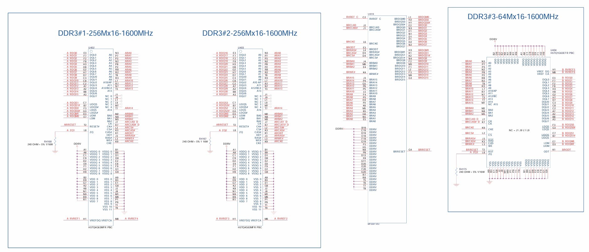

                                        The service manual mentions 3 DRAM's:
                                        DDR3#1-256Mx16-1600MHz (U402 H5TQ4G63MFRPBC)
                                        DDR3#2-256Mx16-1600MHz (U403 H5TQ4G63MFRPBC)
                                        DDR3#3-64Mx16-1600MHz ( U404 H5TQ1G63EFRPBC)
                                        So yes, i think, that the log reporting 2 different size DRAM's can be OK
