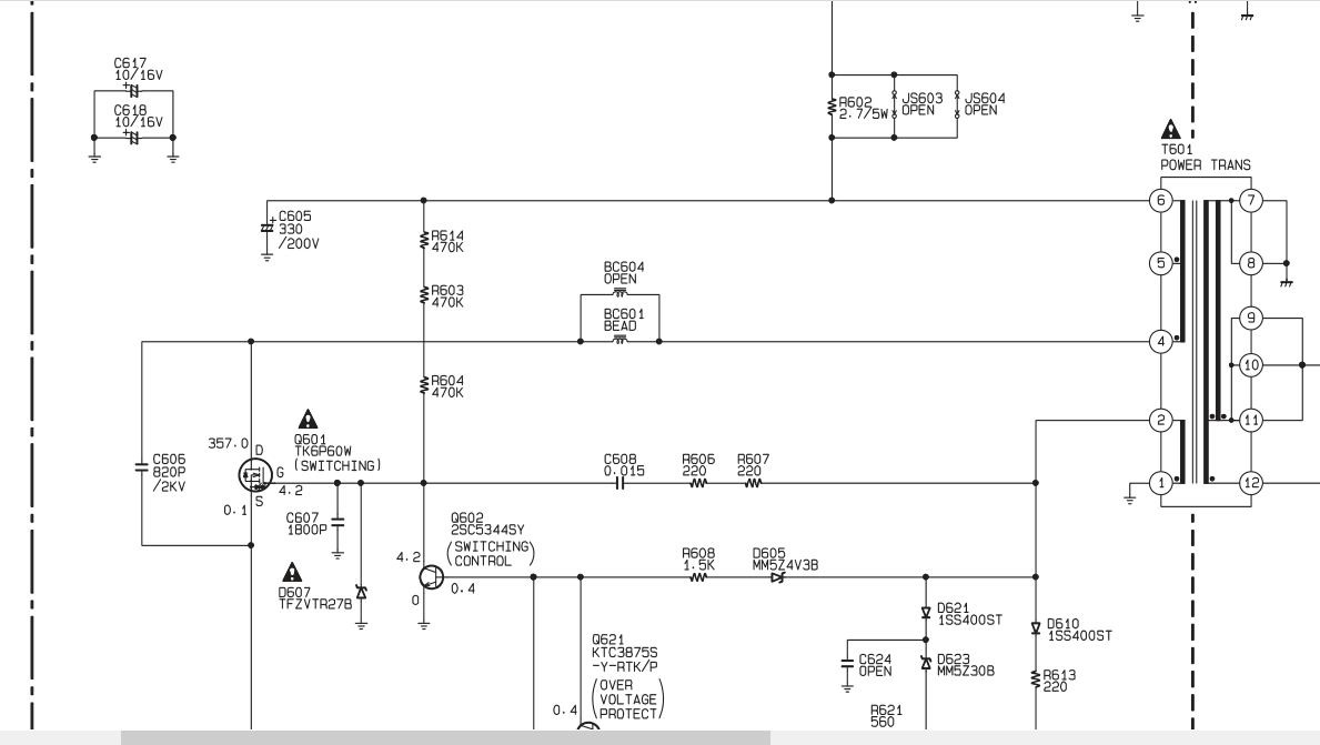

    Hello, guys!
    The same 32" Philips TV I was having video issues, but now I don't have standby led at all. Someone here shared with me the schematic of the power supply, and checking the voltages, I see right after the resistor R604 I'm getting 1.6 v which is too low for enabling the Gate of the Q601 mosfet (the diagram says 4.2). On the R614 resistor I'm getting 181 V in and 117 V out, then through R603 I'm getting the same 117 V in and 59.9 V out, finally getting the latter voltage in the R604 BUT getting just 1.6 V out, which is the voltage that goes on to the Gate of the Q601 mosfet I mentioned. Any clues on why I'm not getting the stand by led? Because the mosfet is not switching on and off, there's no standby or secondary voltages.
    Thanks in advance!

    I must add that all the readings I'm getting is without pressing the power button, only having the TV just plugged in to the outlet and with all the ribbon cables off (mainboard and backlight leds).

      UPDATE: On the mainboard connector I'm getting:
      Pins 1 to 4 (P-ON+21V) = 12.73 V
      Pins 6 to 9 (AMP+13V) = 8.0 V
      Pin 16 (AL+3.3V) = 8.0 V
        Those are readings on the power supply (mainboard connector).
