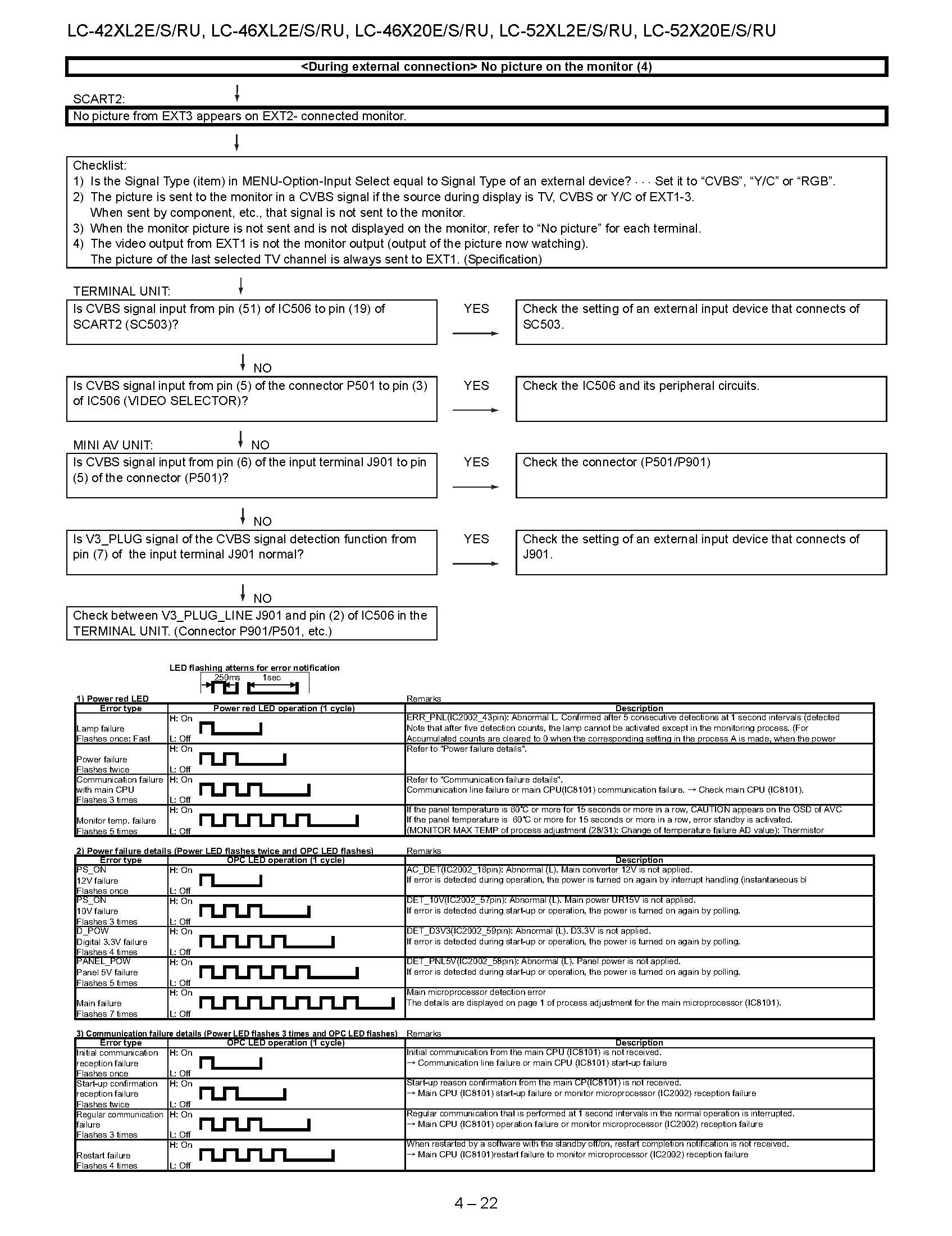

                        Hi guys I have same tv (Sharp LC40X20E) and I get 2 power blinks and 4 OPC blinks. Anyone know what this error means.
                          #32
                          Re: Sharp Aquos LC46XL2E LCD (2 flashing lights)
                          sorry I meant 2 power blicks and 3 OPC blinks
                            #33
                            Here are the codes.
                              #34
                              Here are the codes.
                              Thanks budm. Mine says power on 10v failure. How do i repair this fault ?
                                You can start by downloading the service manual from elektrotanya, it is about 65MB so I cannot upload to BC.
                                  #36
                                  Im unsure what im looking for. Im not even 100% sure its the right manual i found.
                                    #37
                                    this should be the one as budm says it too large for us to upload so if you download it maybe budm can advise you what you need to check
