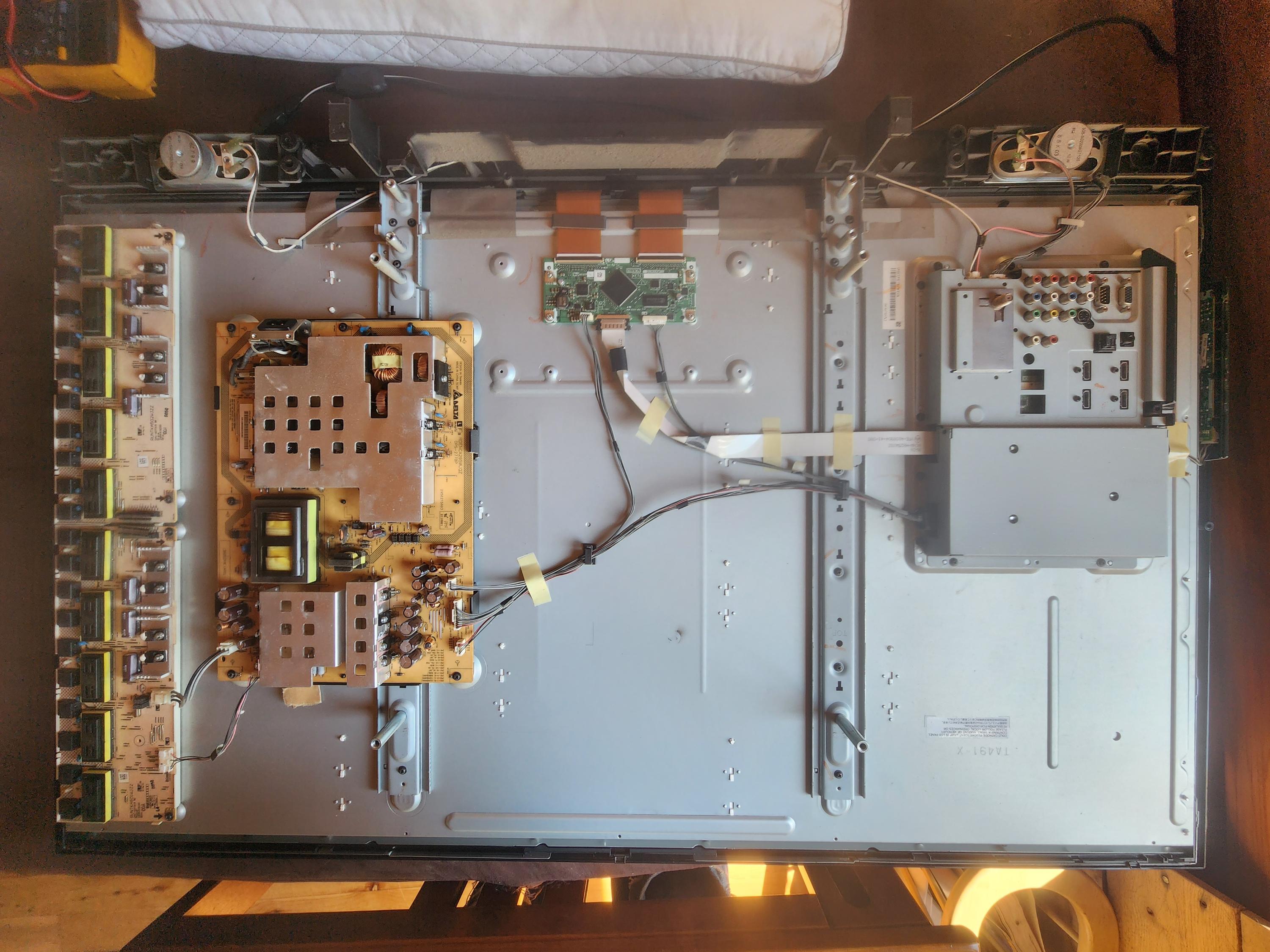

      Re: Sharp LC-C4655U Flashing OPC and Power lights.

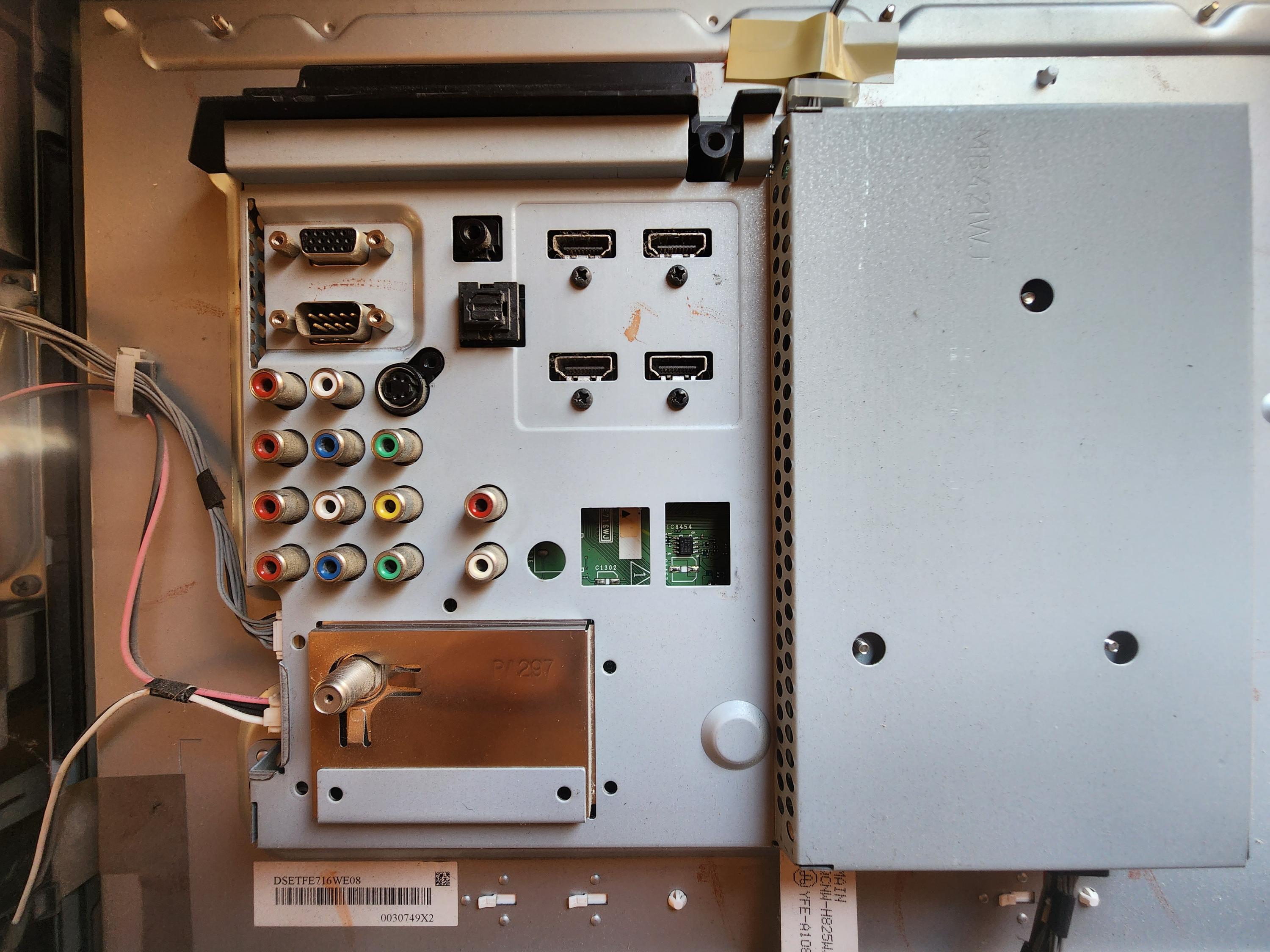

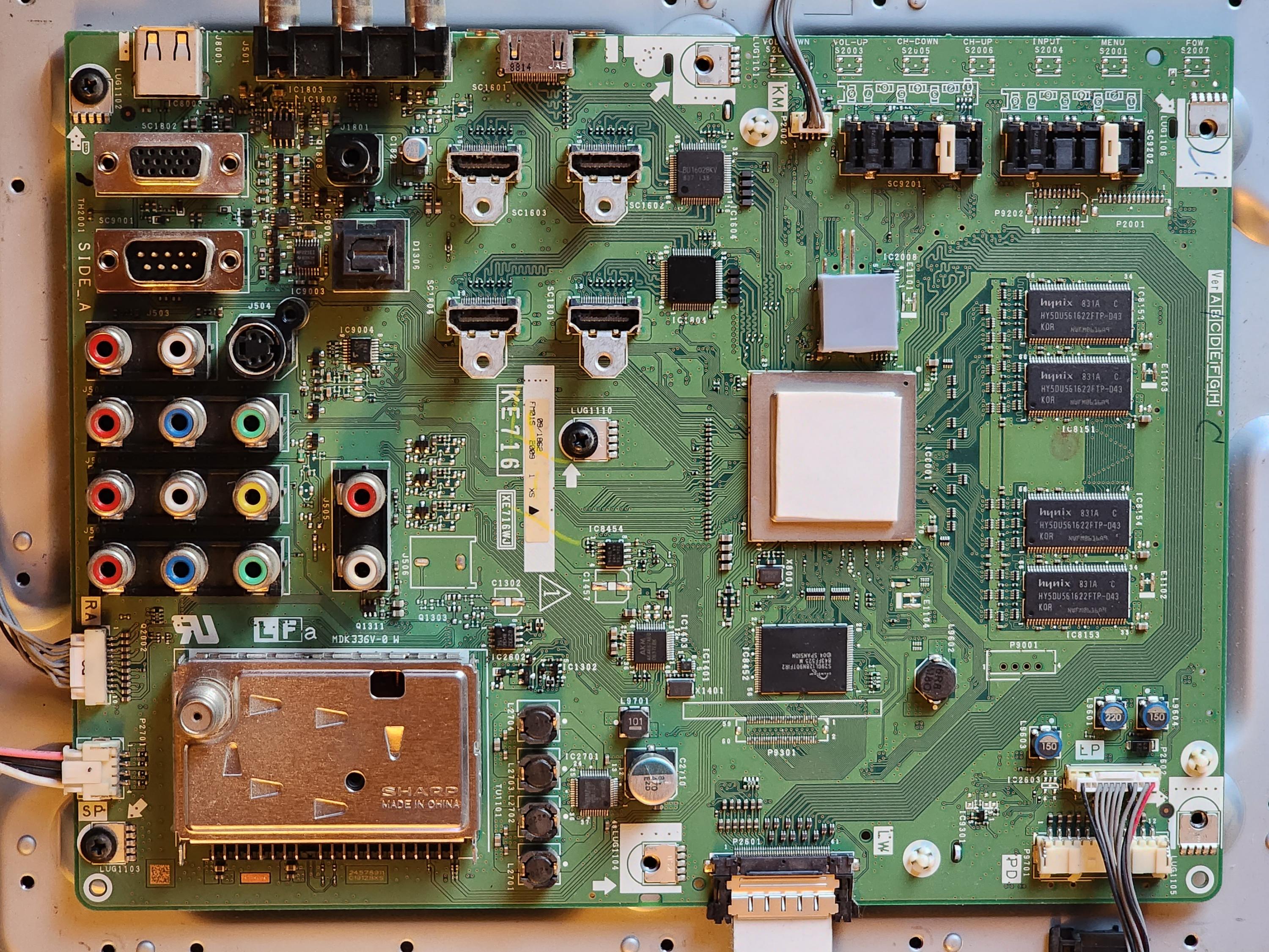

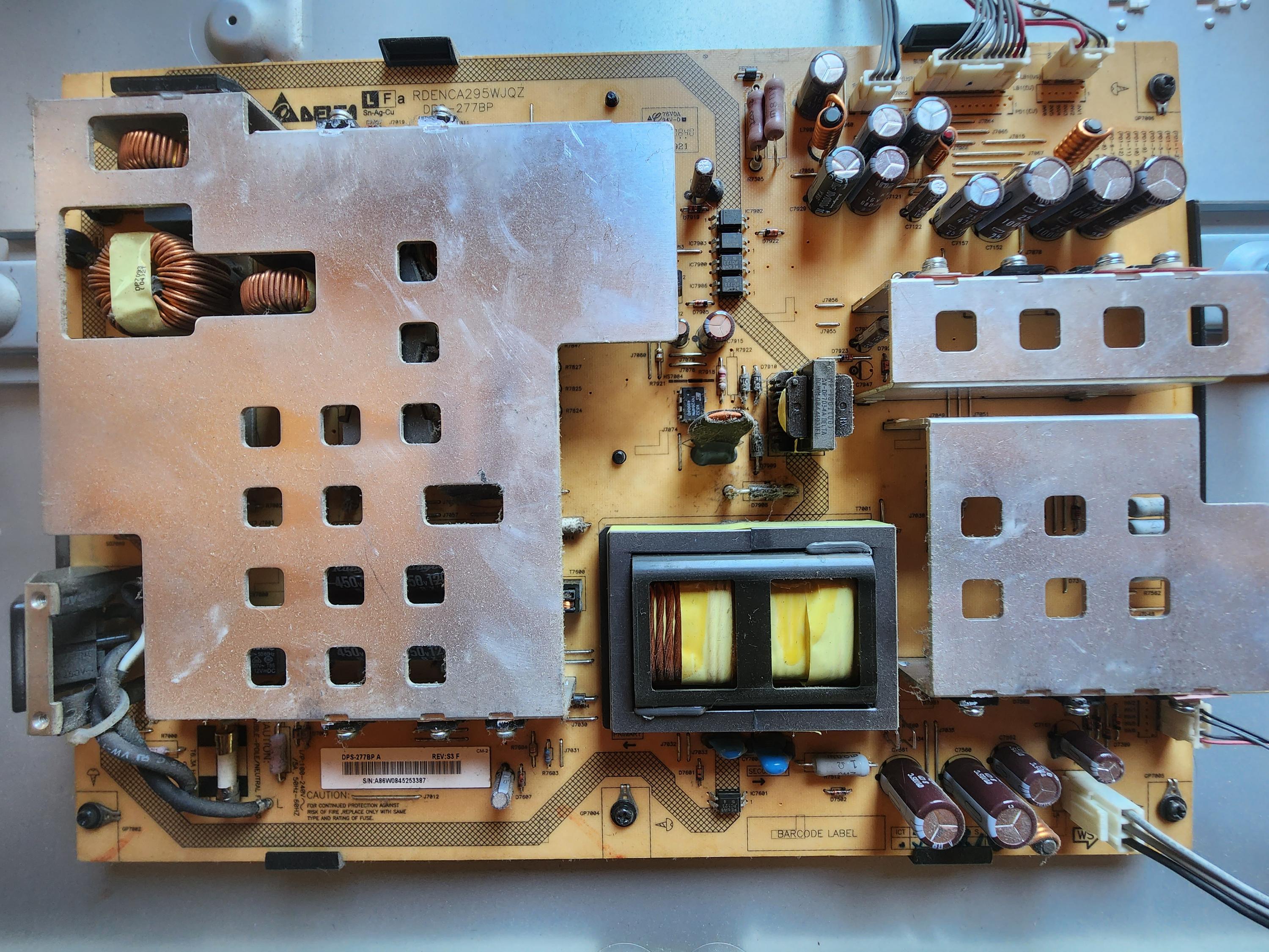

      Good focused straight on pictures of each board and one of the whole back as to see how everything is connected.
      • berrmich
        • Aug 2023
        • 30

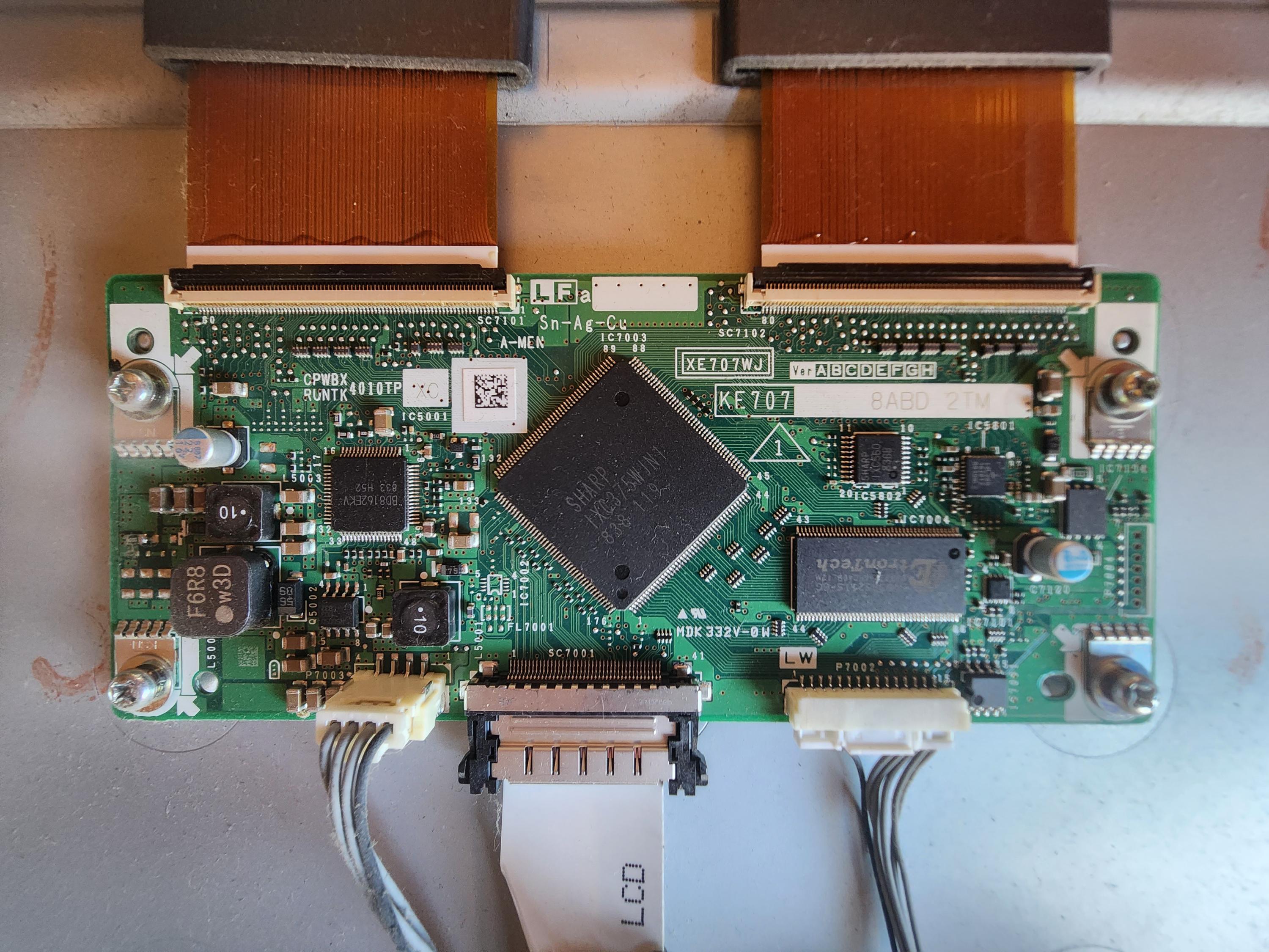

        Thanks! Here are some pictures.

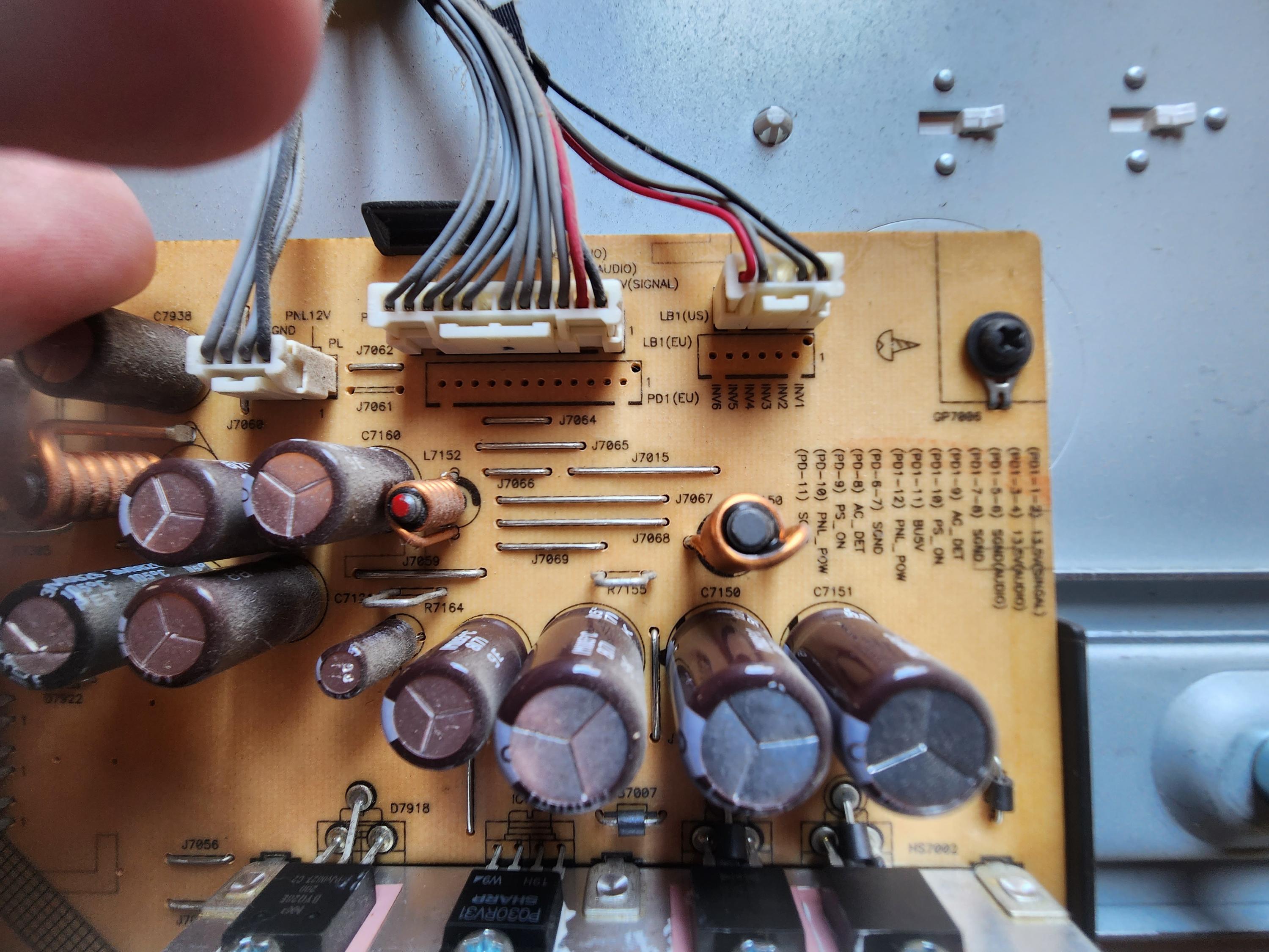

          Check voltages on PD1, meter set to vdc, neg. probe on metal chassis ground, pos. probe on each of the 12 pins, report results as pin 1 sv signal and the voltage, do that for each pin.
              Not exactly sure what all pins need to be connected but you can try unhook cable from powerboard to mainboard, I do it on mainboard side, trace the wires out from pin 8 and pin 10 take about a 1k ohm resistor and jump from those two at the cable connector end, so the cable will be unhooked at the mainboard leave that end uhnooked for test, put jumper resistor in and retest those 12 pins voltages and see what you get.

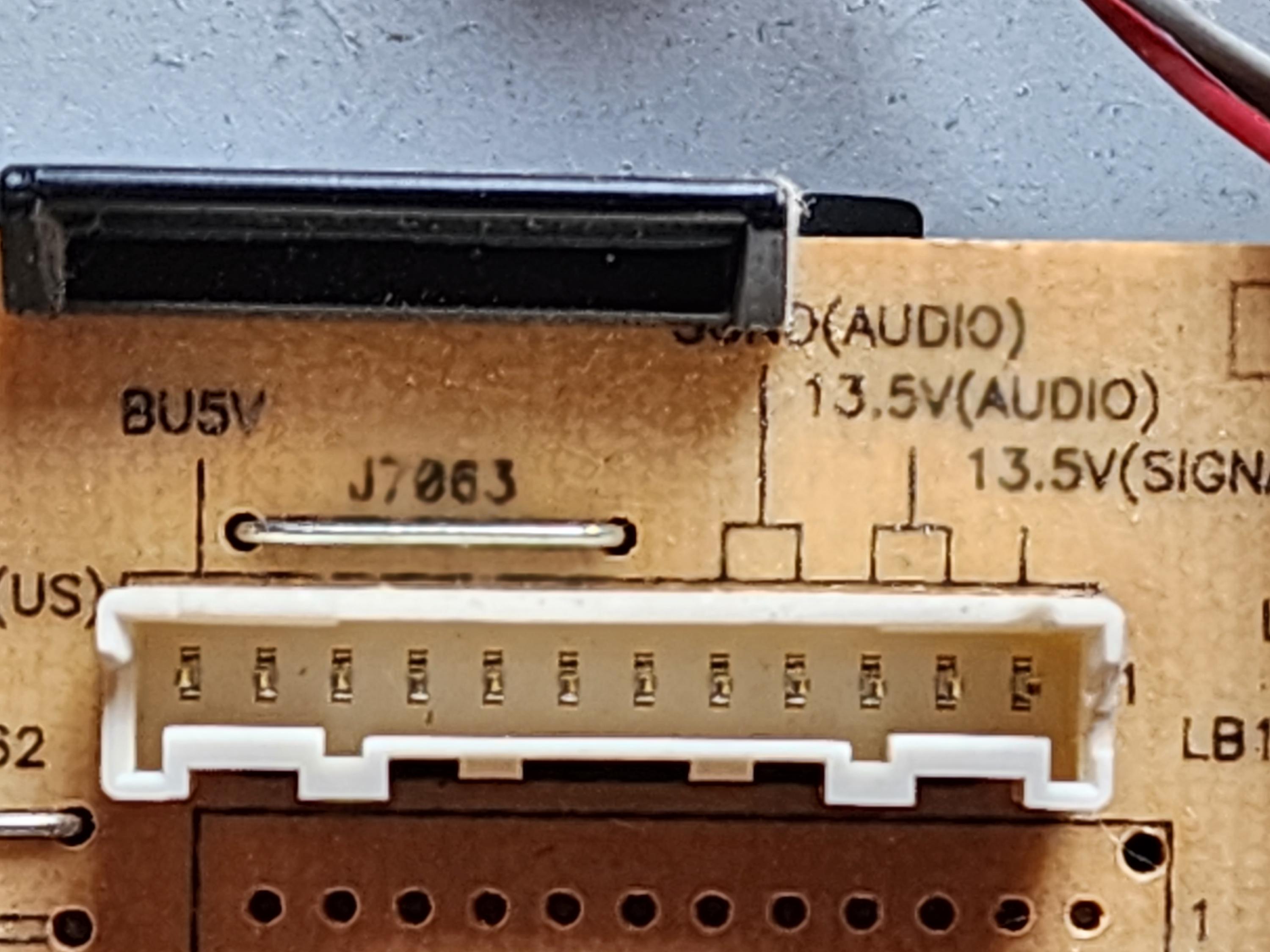

                  • R_J
                    • Jun 2012
                    • 9556
                    This is the US model board so the pin numbers for plug PD(US) are different than PD1(EU)
                    1-13.5 (sig)
                    2,3-13.5 (aud)
                    4,5 (aud gnd)
                    6,7 (sig gnd)
                    8 (ac_det)
                    9 (PS_ON)
                    10 (pnl_pow)
                    11 (sgnd)
                    12 (BU5V)
                    To turn on the power supply board (disconnect cable from main board) connect BU5V to PS_ON This should give 13.5v and INV60v

                    • berrmich
                      • Aug 2023
                      • 30
                      Ok. Now I'm a little confused. PD1 is EU. PD is US. Probably makes a little more sense. PS_ON is still only 0.7V. I'll see if I can get a resistor tomorrow and see if 3V will turn everything on? Could be the main board then?
                      Also PS_ON is only 0.7v if I start it with channeldown/volup. Otherwise it is 0.
                      Pin 1 - 0 (13.7V_Signal)
                      Pin 2 - 0 (13.7V Audio)
                      Pin 3 - 0
                      Pin 4 - 0 (SGND_Audio)
                      Pin 5 - 0
                      Pin 6 - 0 (SGND)
                      Pin 7 - 0
                      Pin 8 - 3V (AC_DET)
                      Pin 9 - 0.7v (PS_On)
                      Pin 10 - 0 (PNL_POW)
                      Pin 11 - 0 (SGND)
                      Pin 12 - 5V (BU5V)

                            • berrmich
                              • Aug 2023
                              • 30
                              Pin 1 - 13.2V (13.7V_Signal)
                              Pin 2 - 13.2V (13.7V Audio)
                              Pin 3 - 13.2V
                              Pin 5 - 0
                              Pin 6 - 0 (SGND)
                              Pin 7 - 0
                              Pin 8 - 3.2V (AC_DET)
                              Pin 9 - 5v (PS_On)
                              Pin 11 - 0 (SGND)
                              Pin 12 - 5V (BU5V)
                              With Pin 9 and 12 Jumpered.

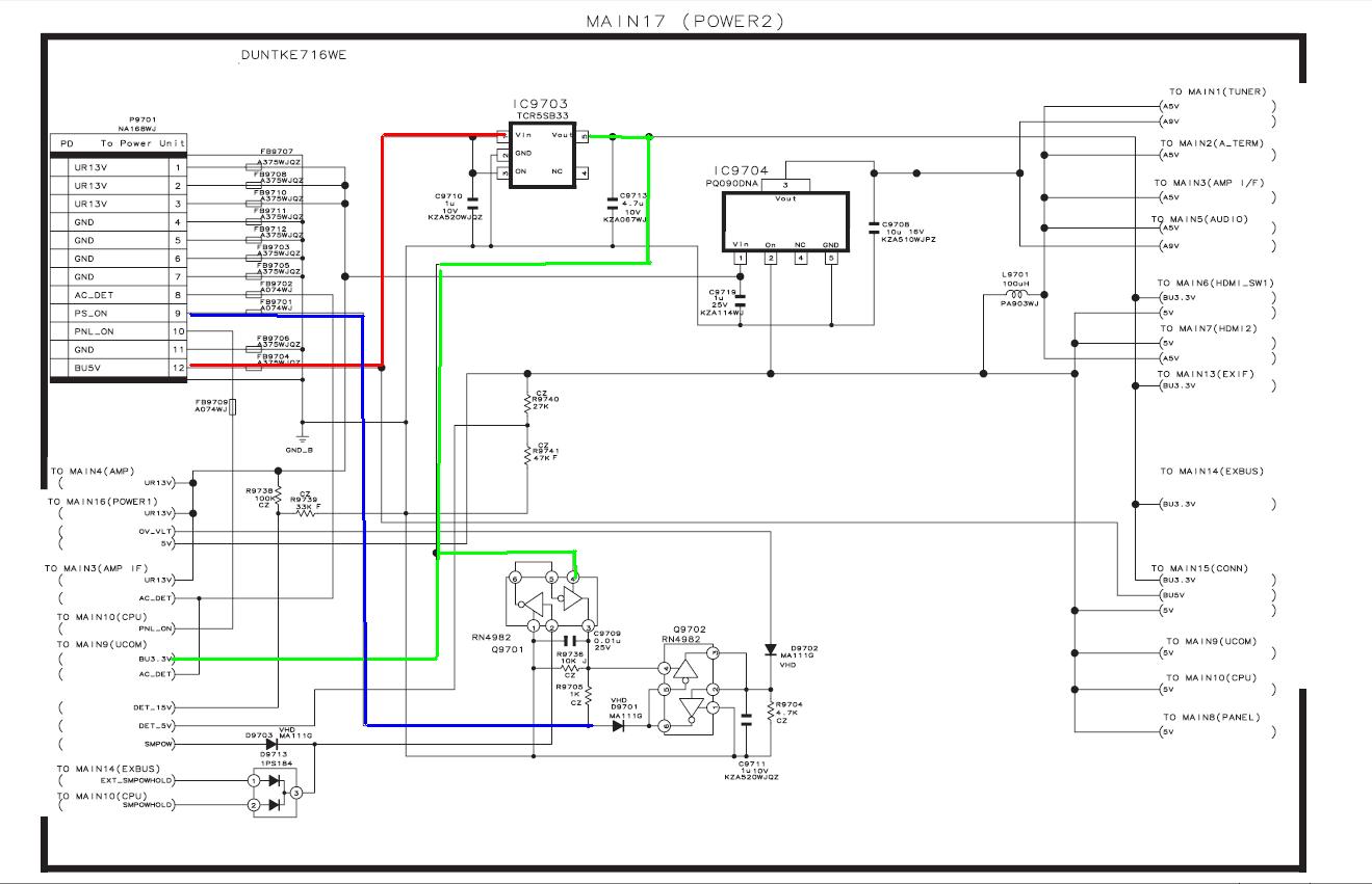

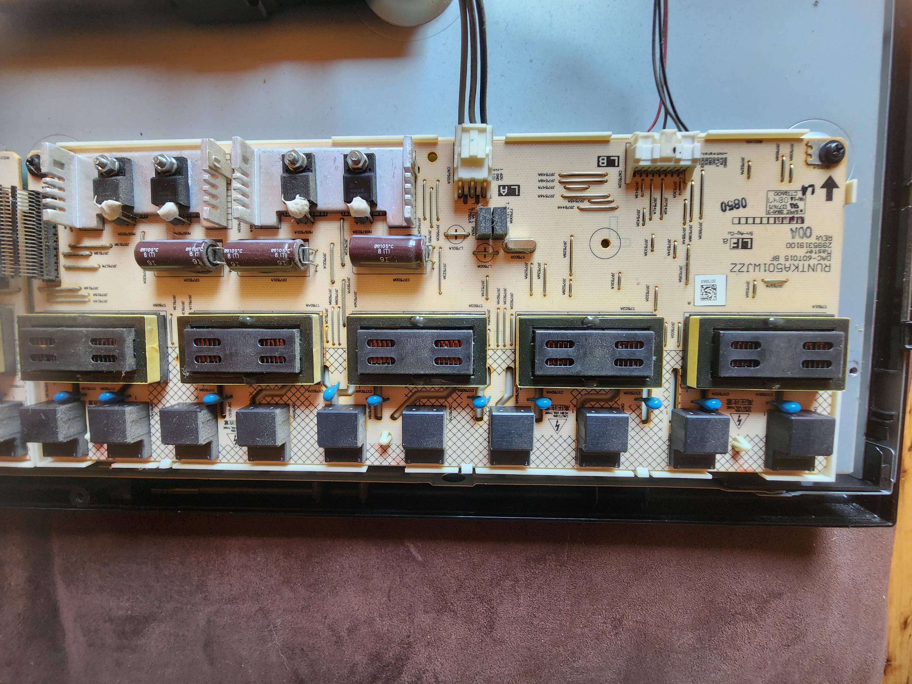

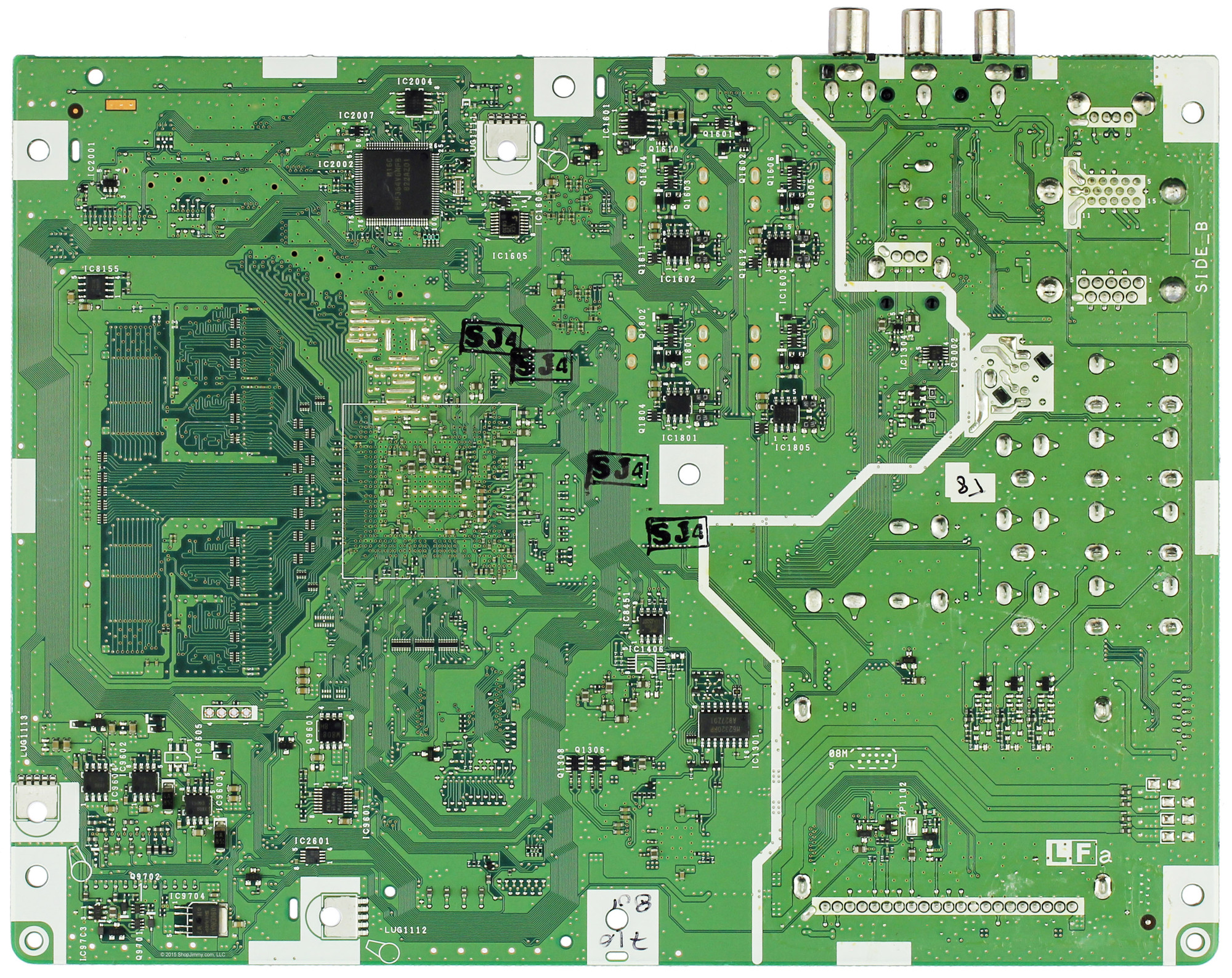

                                Check the back of the board for IC9703 (BU5V to B3.3v) regulator, that feeds Q9701 (lower left corner in picture)
                                One other thing to check would be if Q9702 is being triggerd by the OV_VLT line
                                LC42d65u service manual has the schematic of the main board
                                Did you check that both fuses are ok on the inverter board?
                                • berrmich
                                  • Aug 2023
                                  • 30
                                  I don't see IC9703 or Q9701 on my main board. Yes I am getting INV60V and 12V with the jumper.
                                  My main board is KE716 XE716WJ
                                  Thanks!
                                  • berrmich
                                    • Aug 2023
                                    • 30

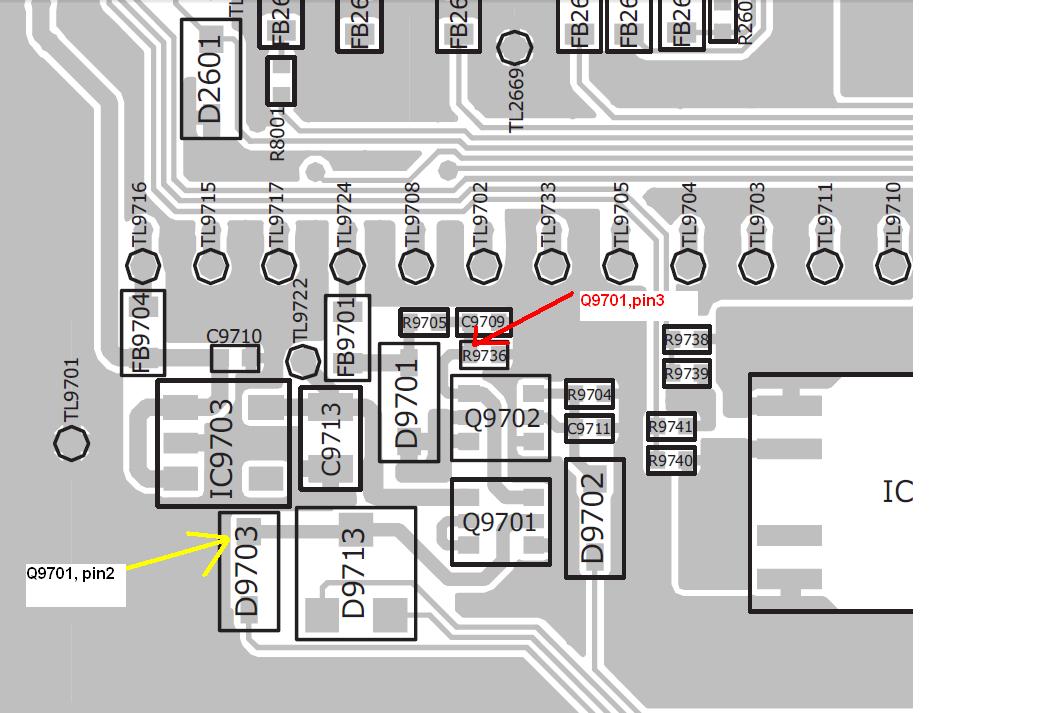

                                    Picture.
                                    • berrmich
                                      • Aug 2023
                                      • 30
                                      Pin 5 on IC9703 reads 3.3V
                                      Not sure how to check the second thing you said.
                                      I did not see fuses there. I checked the one on the power board.

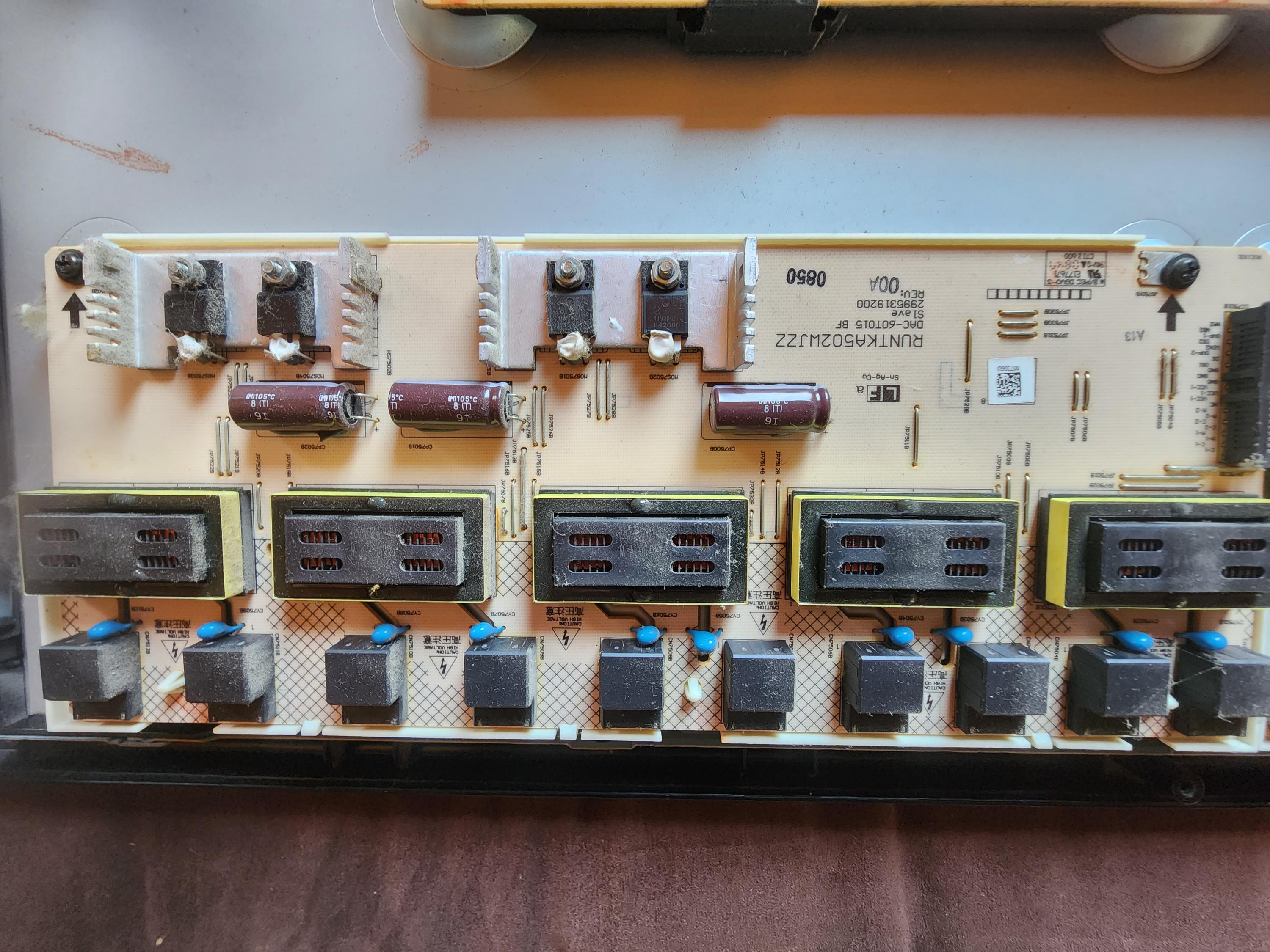

                                      • R_J
                                        • Jun 2012
                                        • 9556
                                        Something may be causing the power suuply not to turn on, It may be due to an error from the inverter board. If you force the tv ON with the button combination, do you have the inv12 and inv60v? if you do and you don't have backlights, the fault may be on either the inverter or maybe a bad ccfl or bad ccfl connection in the panel. and NOT the main or power supply boards.
                                        Fuses on inverter board are in front of plug LA (post 4 second picture) Check for voltage (60v) on L7500A and L7501A
                                        Q9701 should have 3.3v on pin4 and when the power button is pressed pin3 should also be 3.3v, Pin 2 should also change when the power button is pressed
