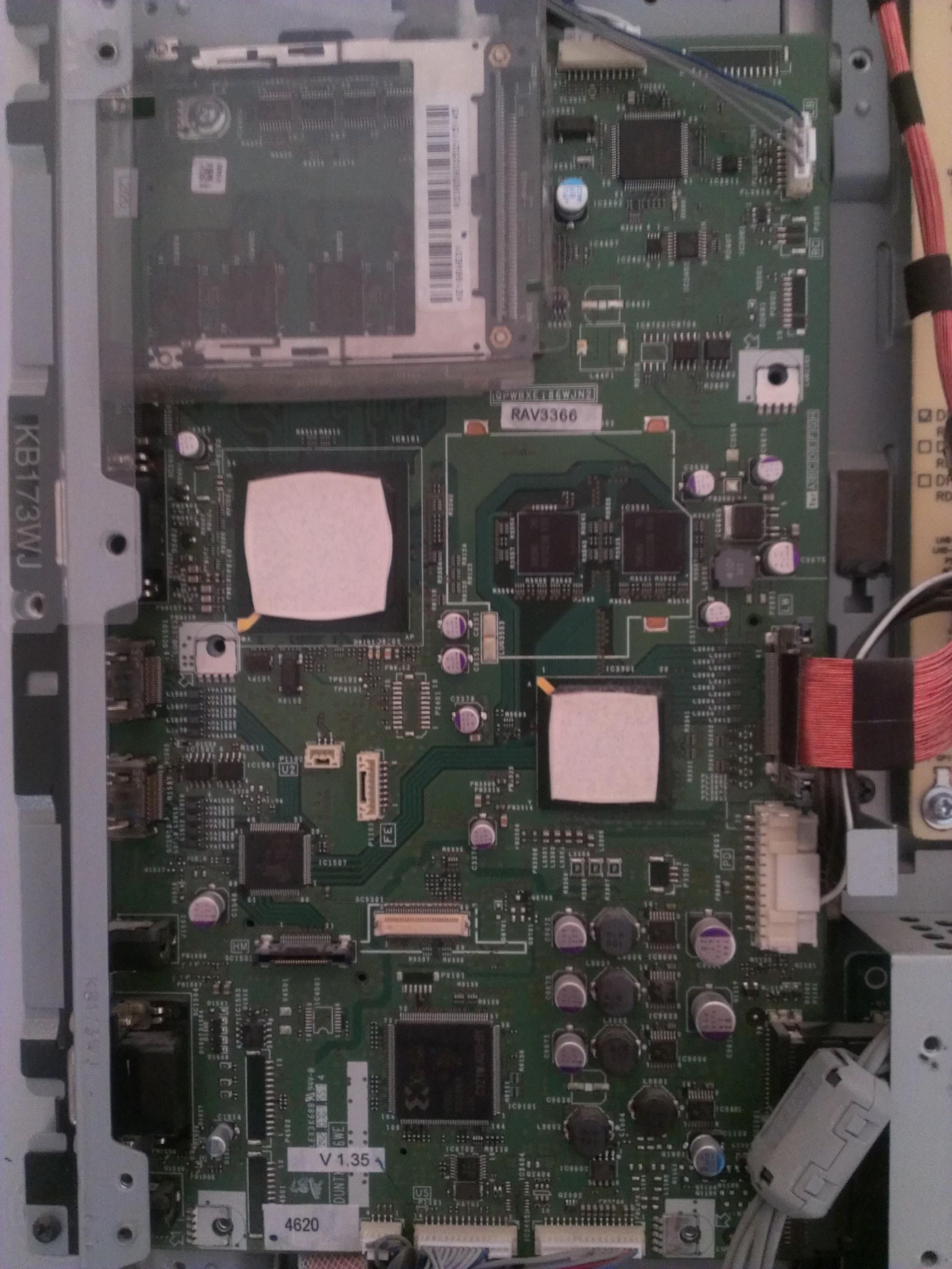

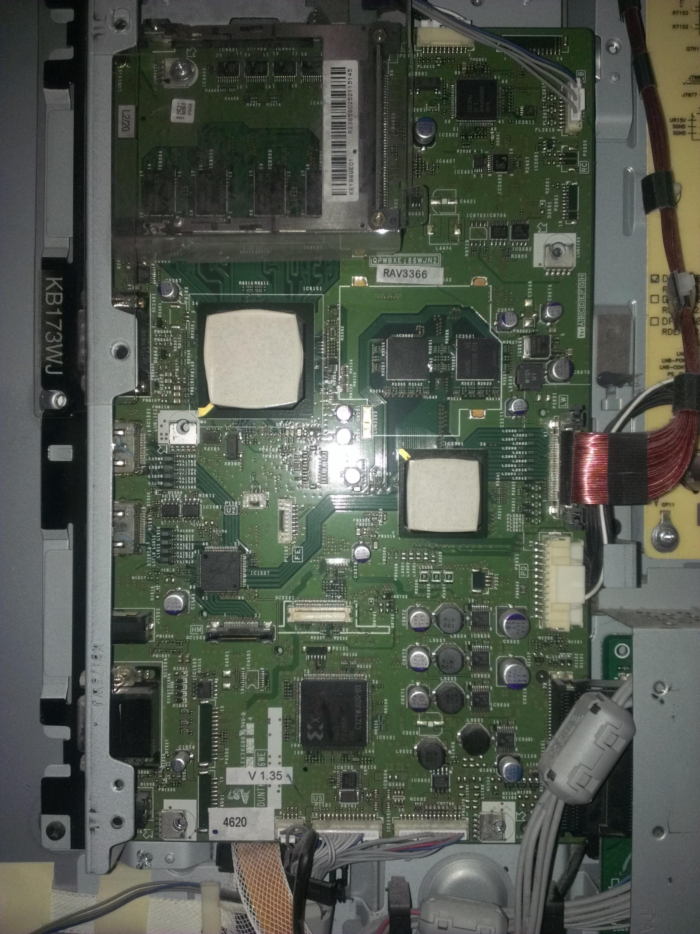

                          I have the same problem with mit LC46X20E. Power led flashes 2x and OPC led 4x. So there is Digital 3.3V missing. Where is it generated? Are there common faults on other sharp LCDs? Is it repairable? I don't want to buy an entire board and just swap it. I want to find the fault.

                            Digital 3.3V is generated on the main board usually.
                            There is a common fault with those main boards caused by a small ceramic capacitor on the SS pin of the buck-converter IC failing. If you post a picture of the main board, I can highlight where to test for this issue.

                                Here are he pictures. I hope the quality is good enough. How do I have to test the cap? I just own a DMM.

                                  There is a capacitor C4707. It will be a little silver cap, near IC4701, an 8 pin chip. Can you see this?
                                  This board is different to mine, so I can't highlight where it is unfortunately.
                                    Re: Sharp Aquos LC46XL2E LCD (2 flashing lights)
                                    There is no cap with this Number and also no IC4701.
                                      It could be on the bottom of the board.
                                        Okay, now I'm at my parent's and I can't check till sunday. Will give a reply then.
