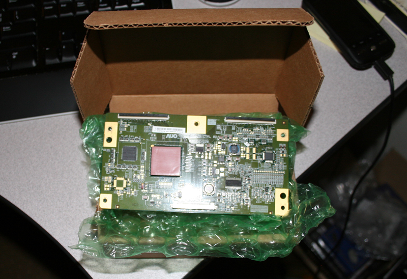

            After troubleshooting this problem for a while now I figured out what the problem was. The long use is throwing off the timing control board which is connected to your LCD lamp. This pcb board is located under the sheet metal under your power supply.
            This unit was hard to get from Proscan but when I replaced it the tv was fine. This t-con board is not repairable because of the way it's made. I had Joe order me one but they are around $100 if you can even get them for that much.
            It was a small price to pay to fix that dam 40" however I still got a free 42" from Proscan for the trouble and they never wanted the 40" back so I wound up with two nice LCD's for $435.00. Better then a kick in the head I guess.

                      OK so after testing and testing and testing, there is indeed an issue with the t-con board. If there is an issue with a power supply pcb itself the caps would show damage.
                      . But if you see no bad caps, it's the t-con board.

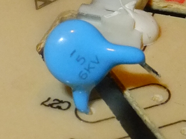

                                      Post a photo of the cap and someone will advise you.
                                        #39
                                        Re: Proscan 40LD45Q 40" LCD TV Help Needed!
                                        'it says 5/ 6KV and I do not know the value'
                                        5pf 6000V. I expect the inverter circuit to go into shutdown if the Ballast cap in nit in the circuit, but at this point I really know as to which cap is disconnected.
                                        Still need to see the pictures

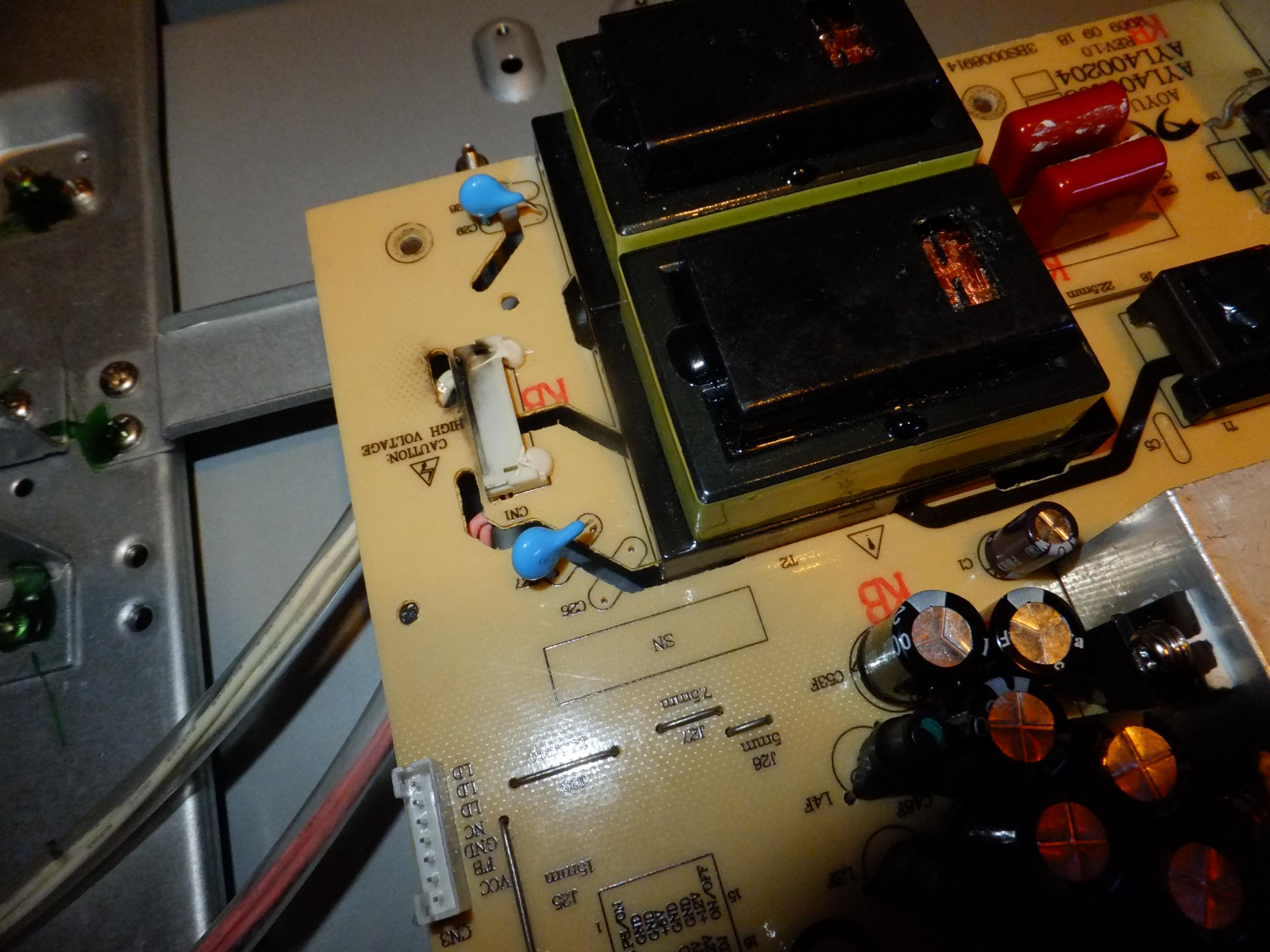

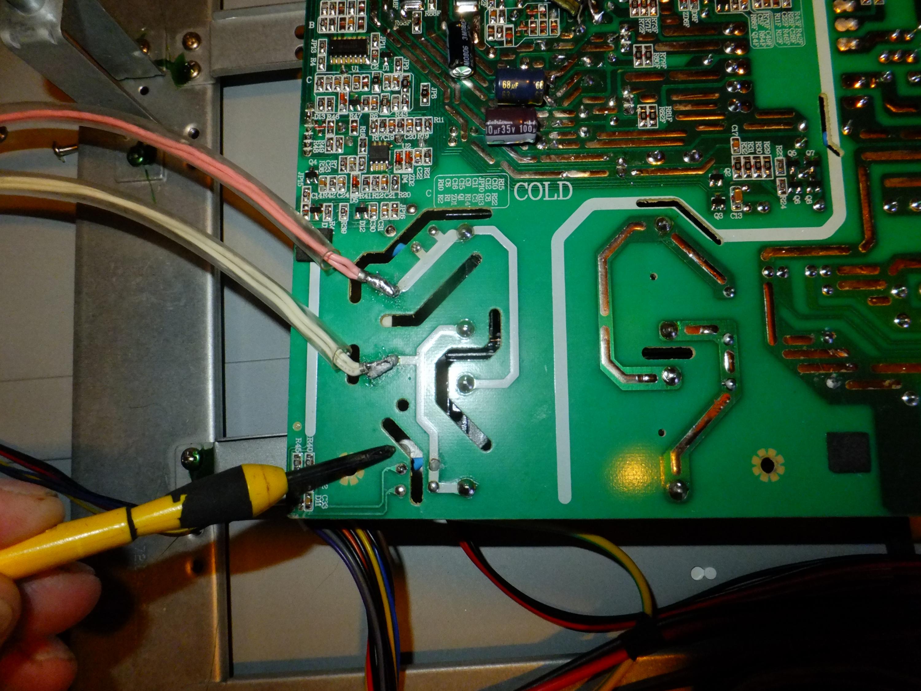

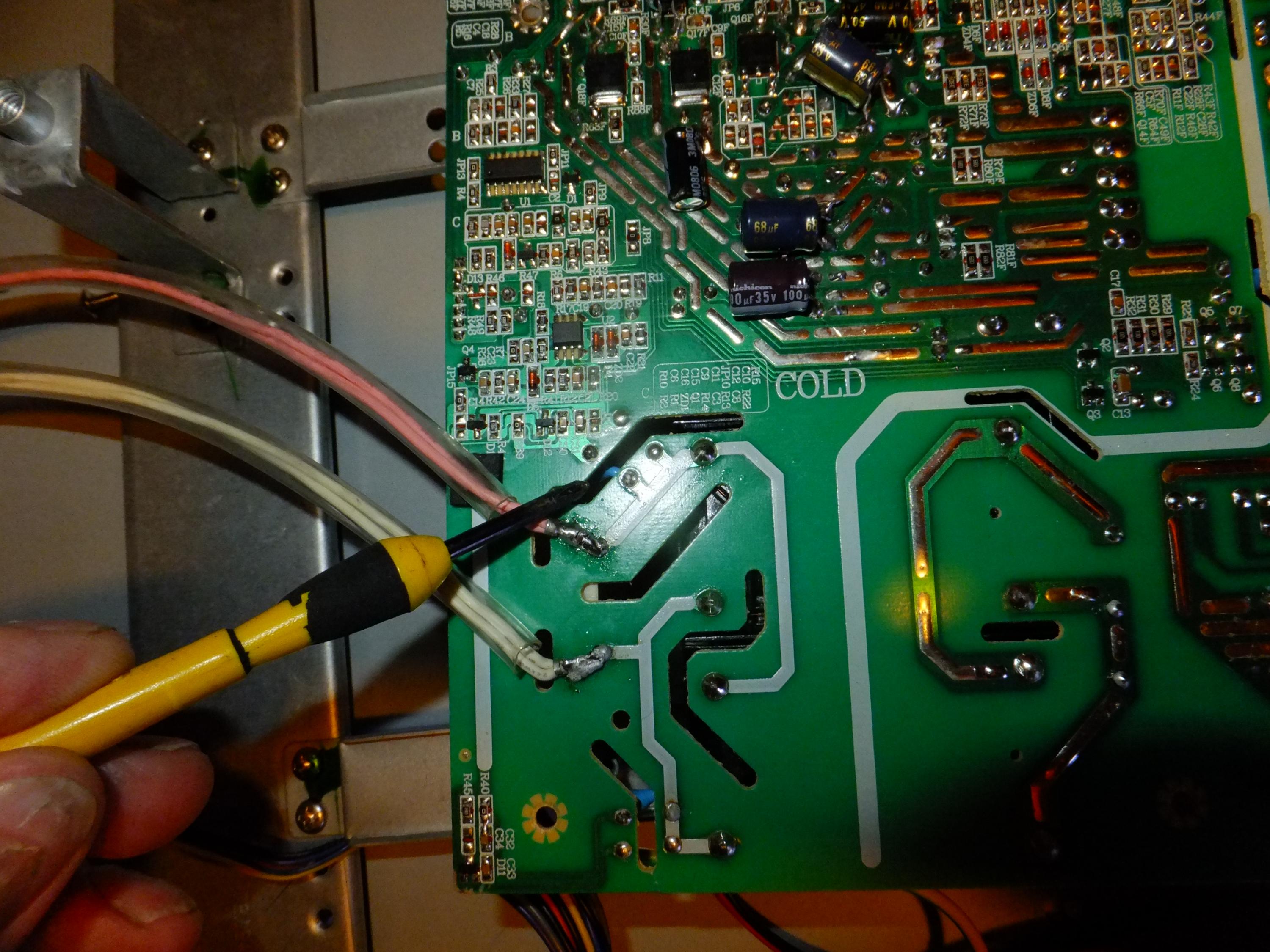

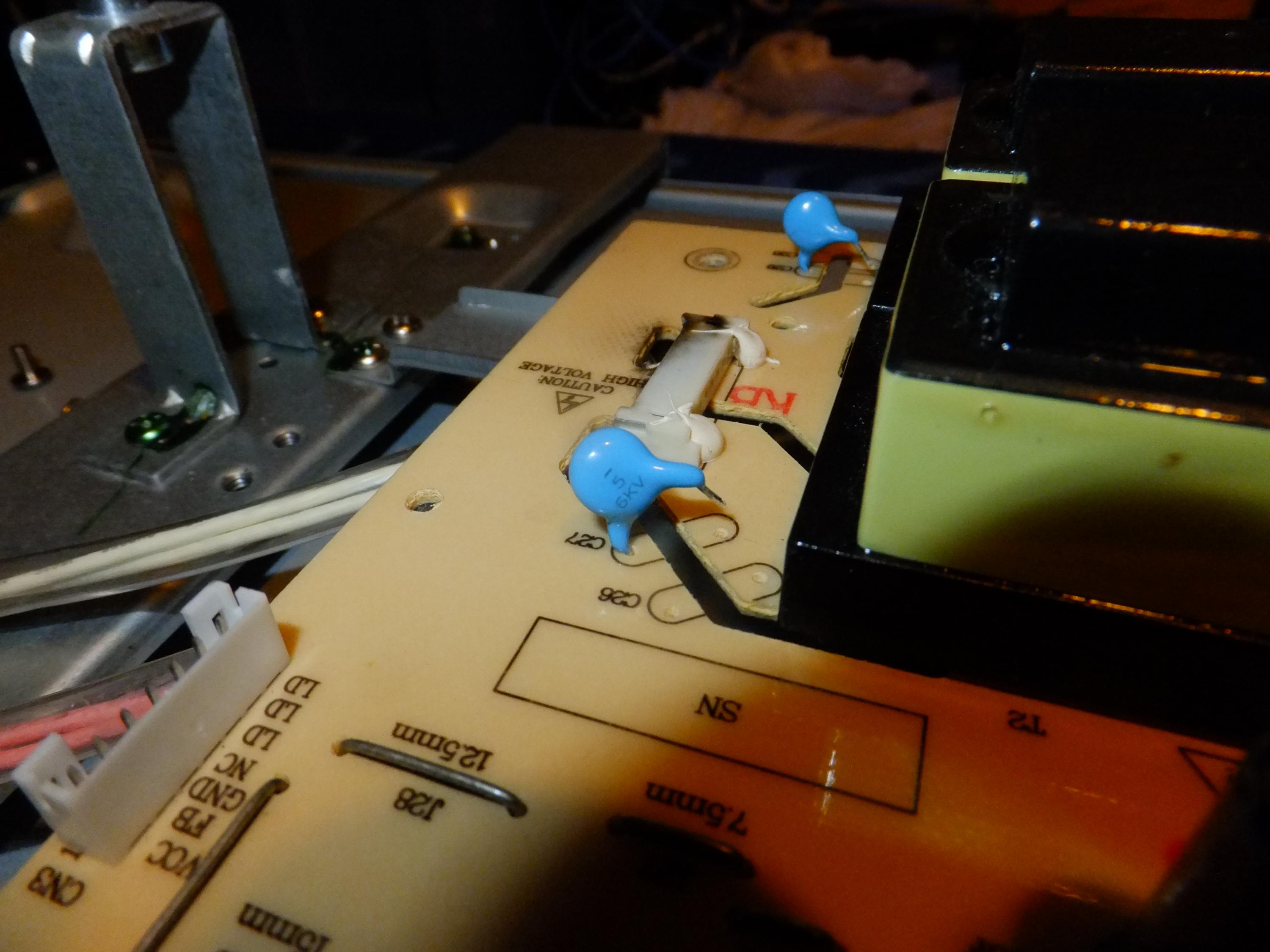

                                          OK, here are some pictures. Ignore the burn marks. Someone before me busted the wire connector and they had the wires pressed into the socket. There was arching and so I just soldered the wires to the bottom of the board.
                                          In the last 2 pictures I am pointing to bottom of where the caps are.
                                          Is a RM5101 IC the same as a AS15-F IC?
