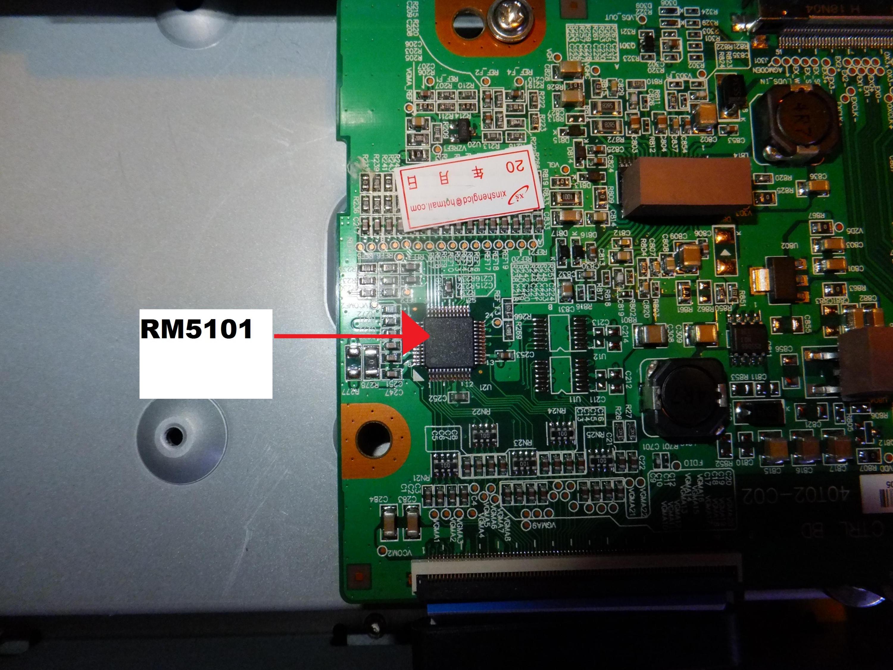

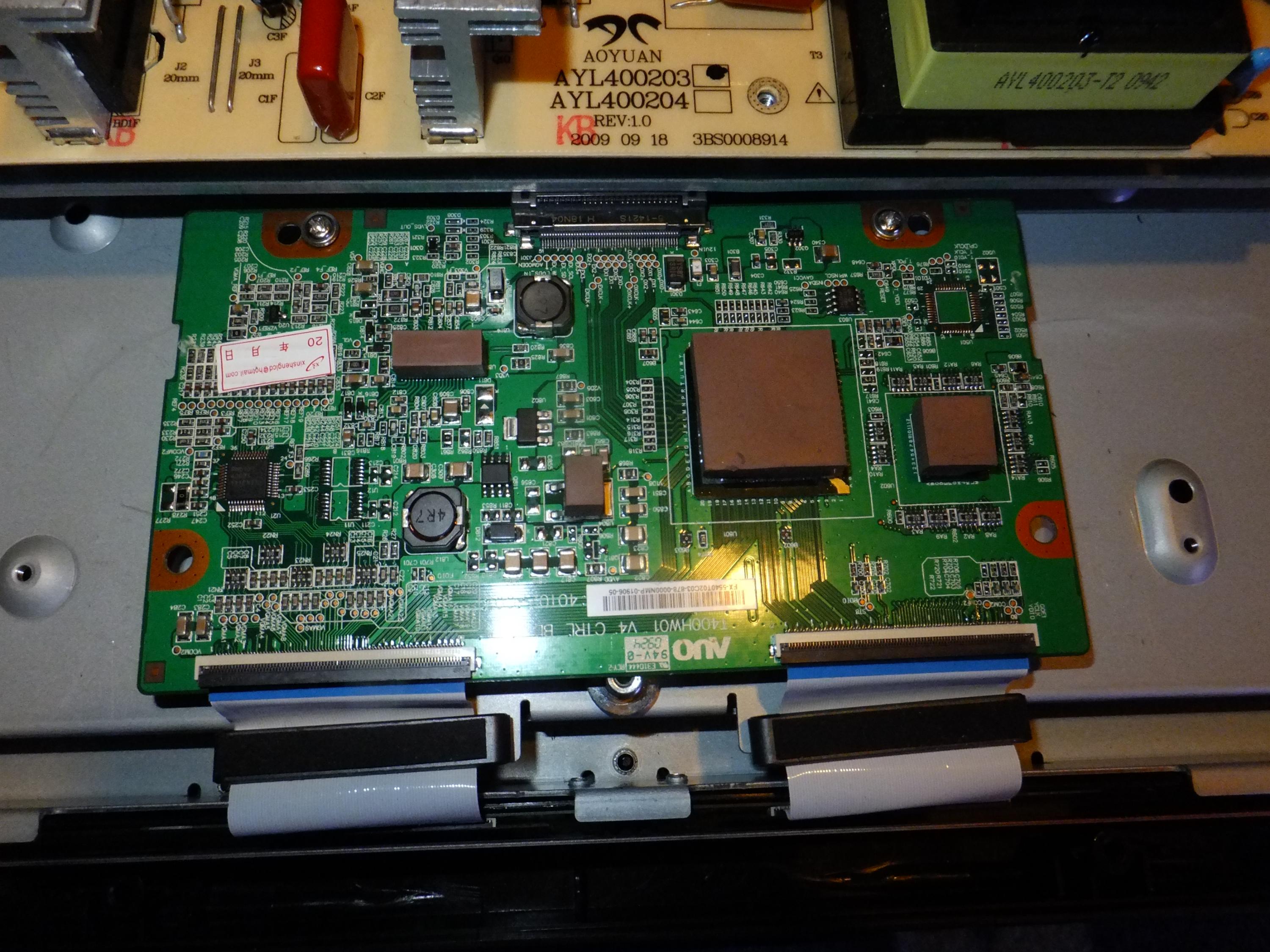

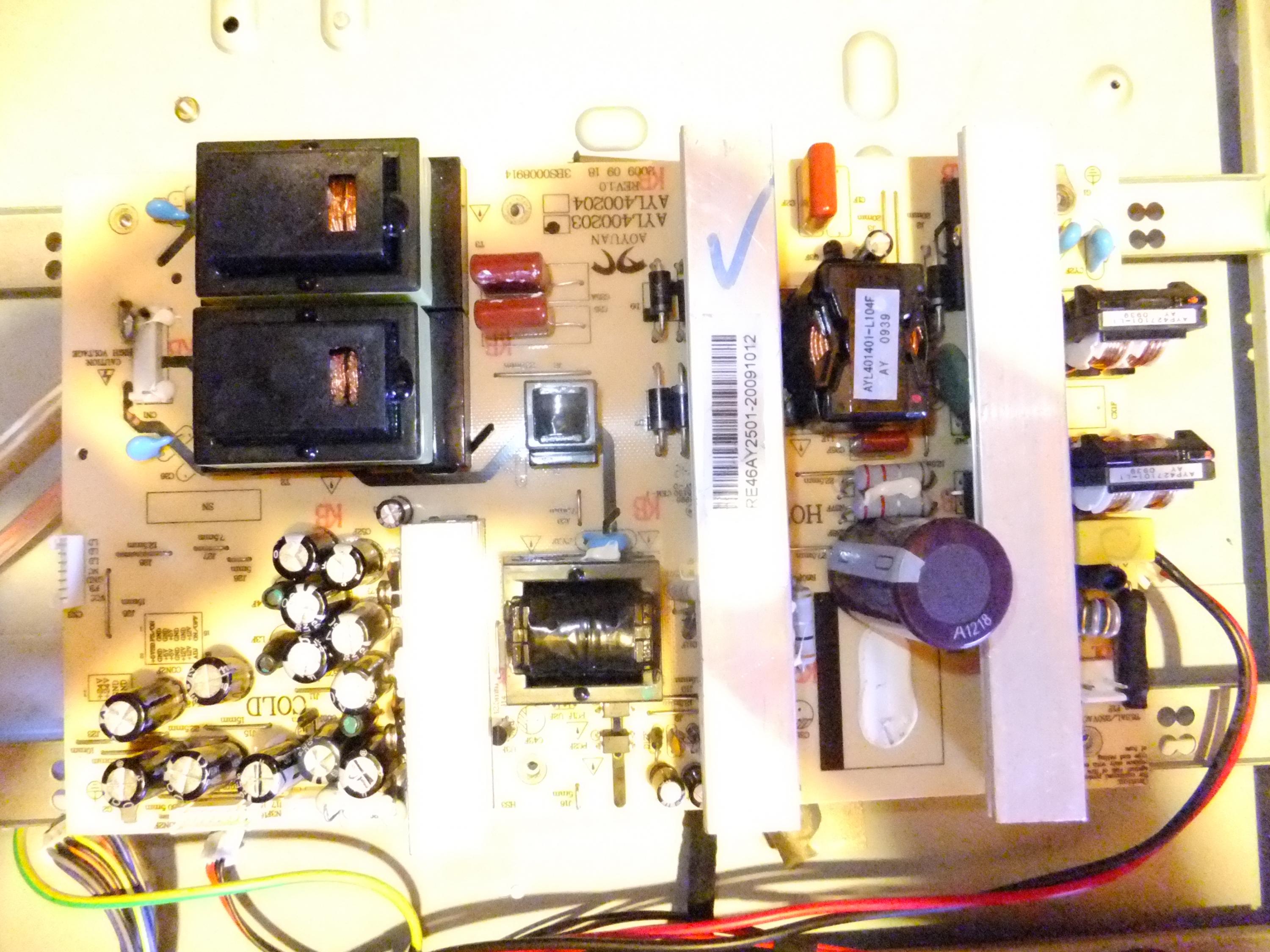

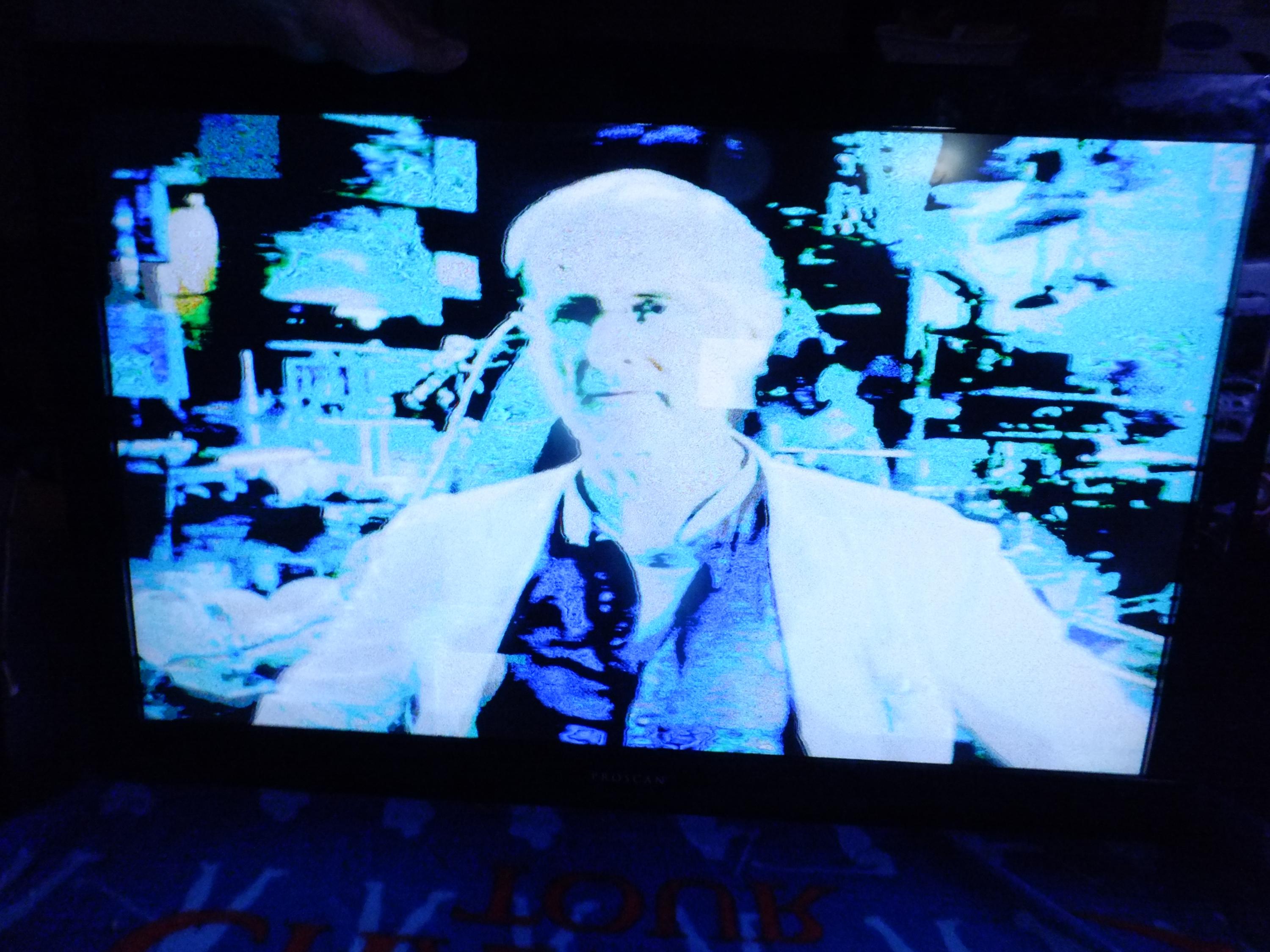

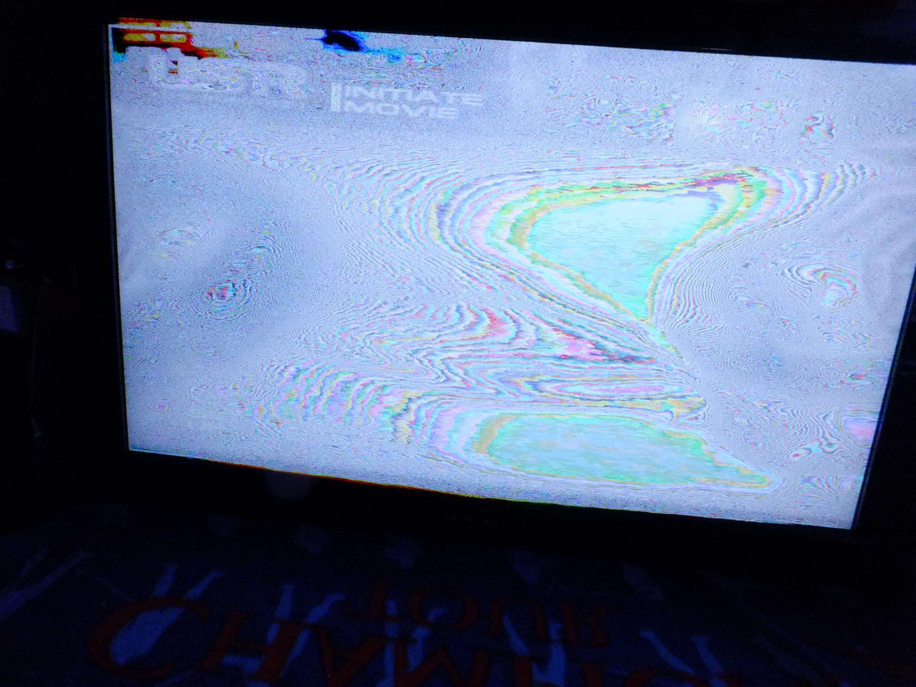

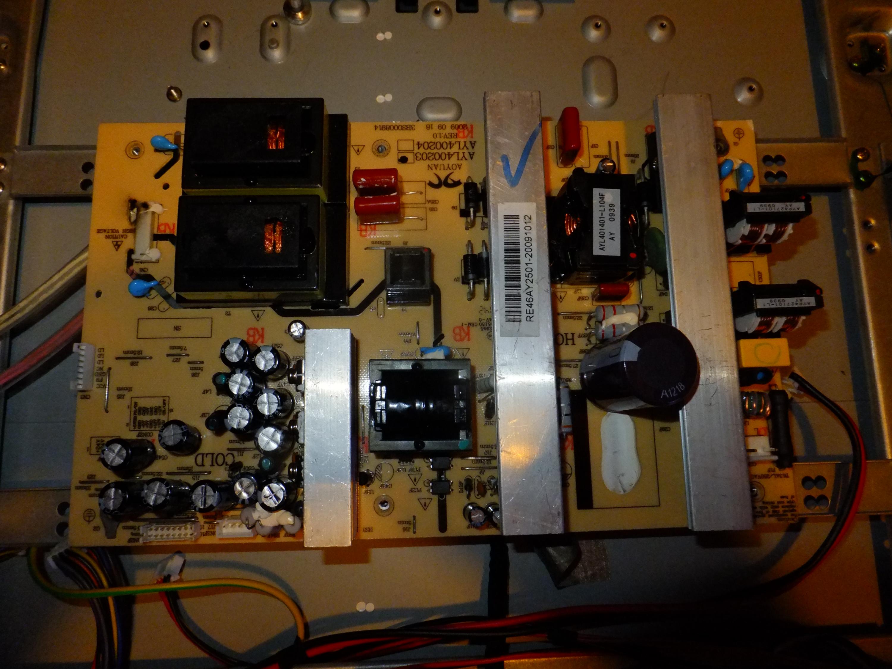

    So are those 2 caps the ballast caps? Here are some more pictures. I even got pictures of the color bleeding. Looks like I will be replacing the IC on the T-Con board. My previous attempts on other T-con boards failed but I have better equipment now.
    That big cap on the board is just temporary until I get a replacement.

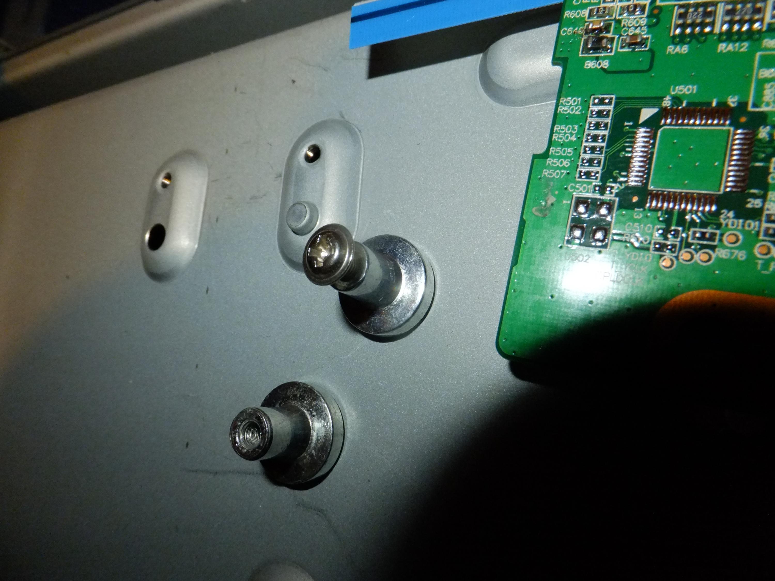

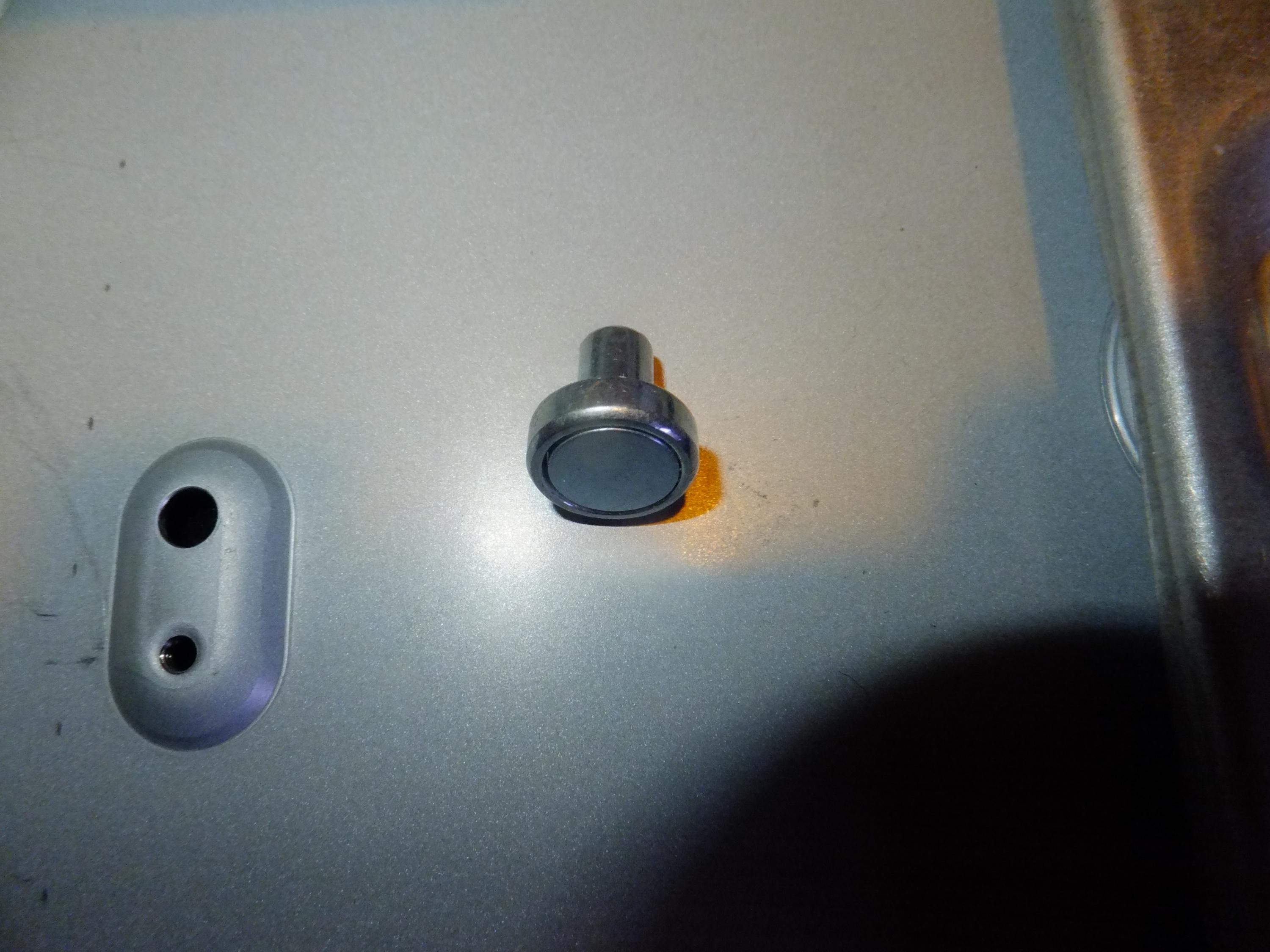

    Also this T-Con board had magnets that it was screwed down with, never seen these before. I tried to remove them but then there was no way to screw down the T-Con board.

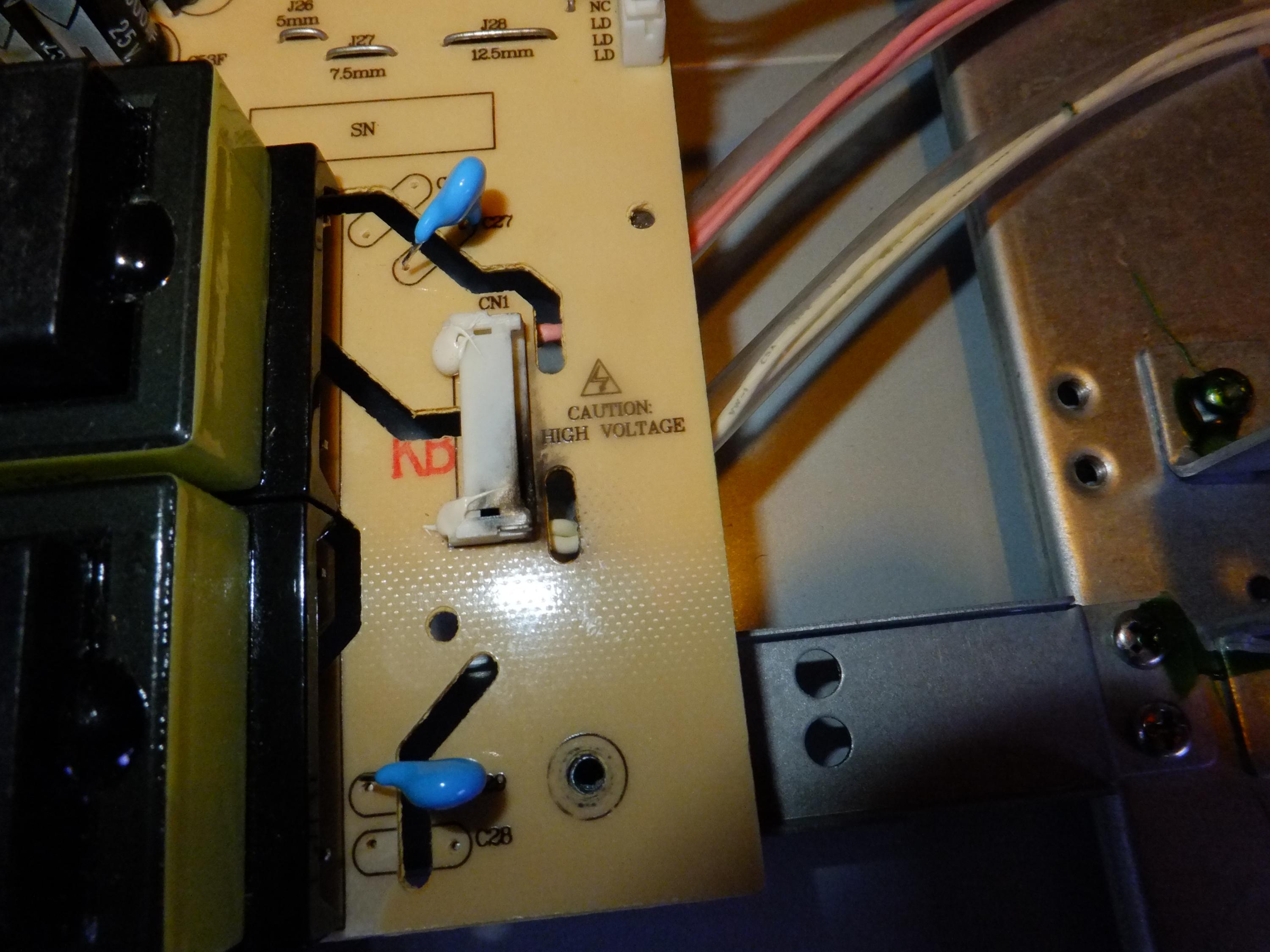

      OK, so I am having a problem testing these blue caps. I have 3 multimeters and I am getting nothing. I also tried to test some other blue caps but I still get nothing. So I guess I do not know how to test these. What is the proper way? Please & Thank you.

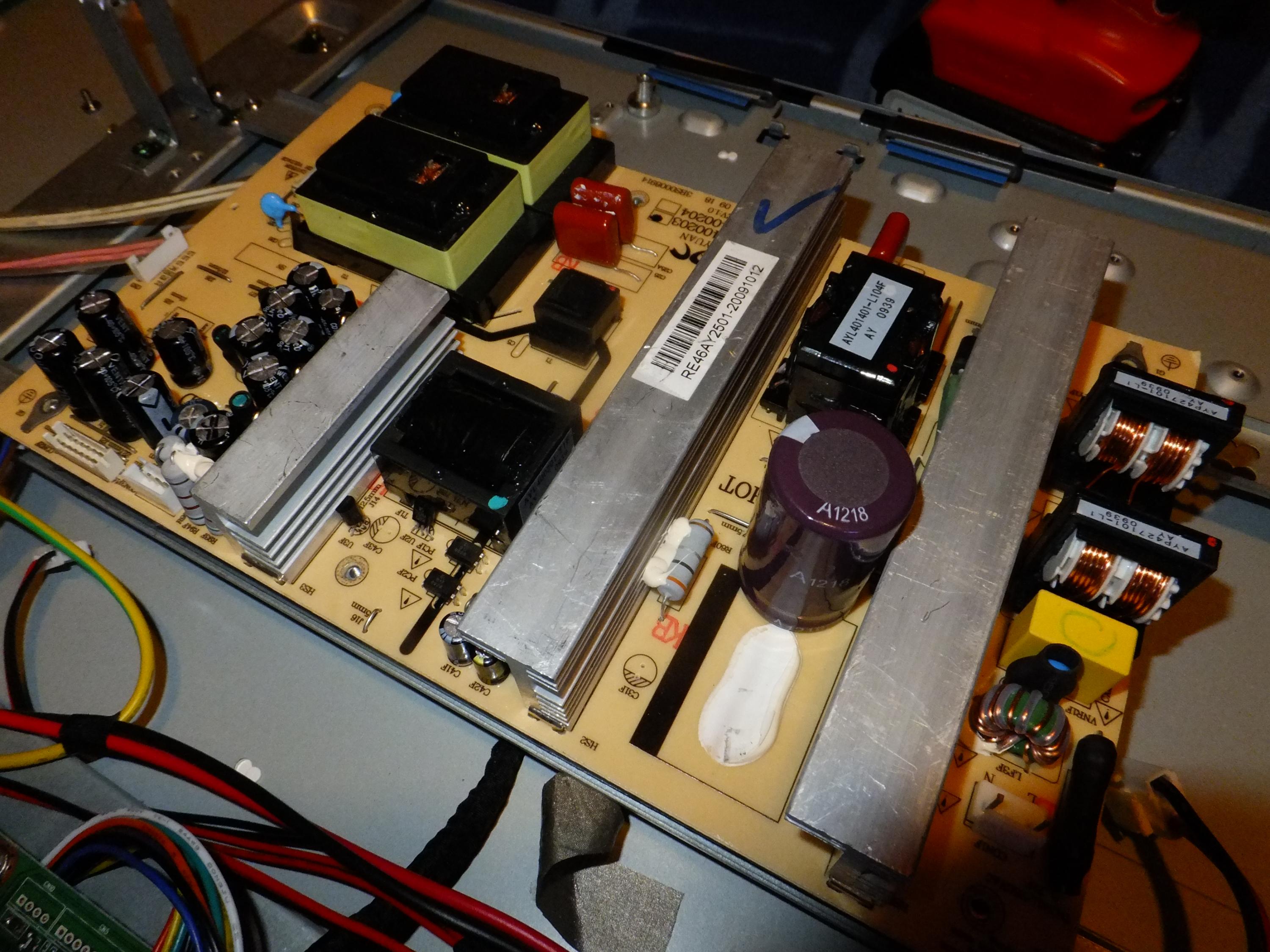

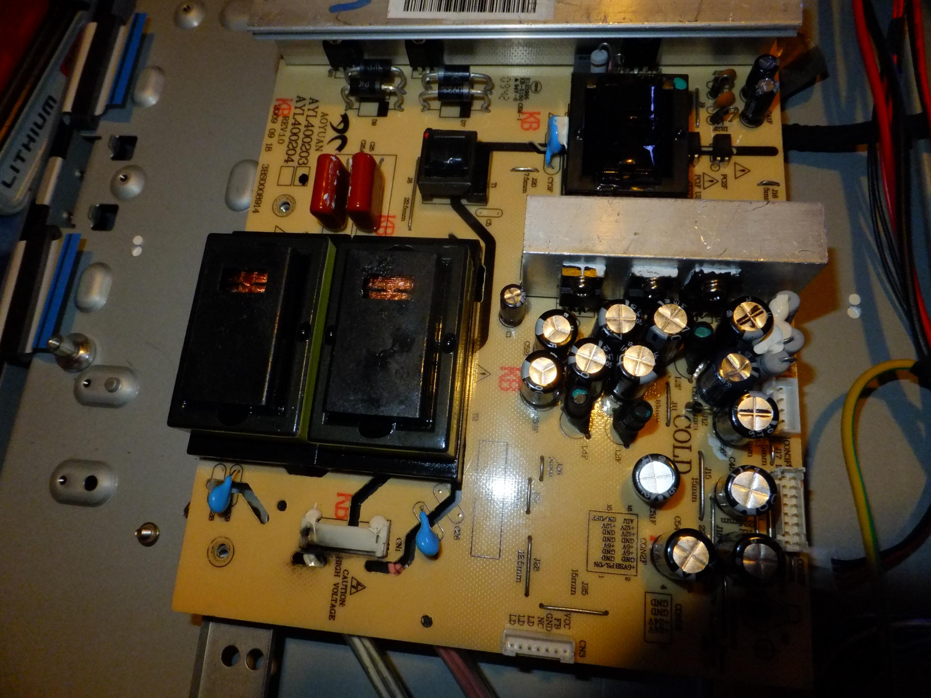

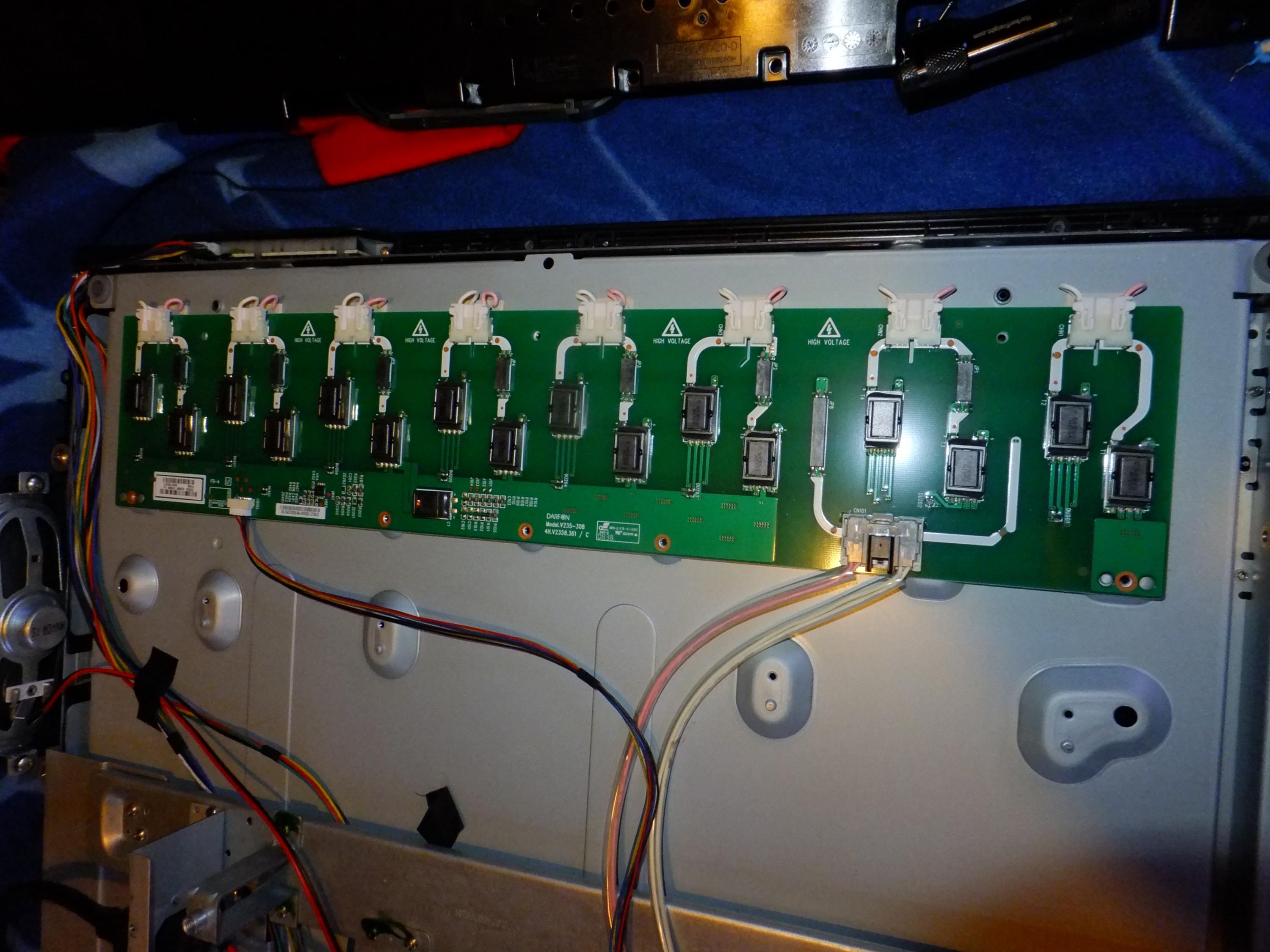

          Looking at the bottom side of the board, it looks like the Inverter transformer high Voltage winding of the the two Inverter transformers are connected in parallel to drive the lamps, and those two high Voltage caps are used for the lamps sensing circuit.
          Testing those cap with low Voltage does not give real indication of the leakage, the cap is exposed to 1000's of Volts in the circuit.

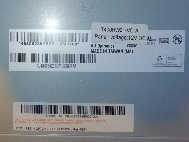

          BTW, do you have the LCD panel model number?
            #45
            Re: Proscan 40LD45Q 40" LCD TV Help Needed!
            I believe it is TH400HW01-V5 A and the brand is AUO
              #46
              T400HW01-V5 A. I did not find the spec for the 'A'. I found V5 version 1 which uses the long Inverter board, not the same as your screen.

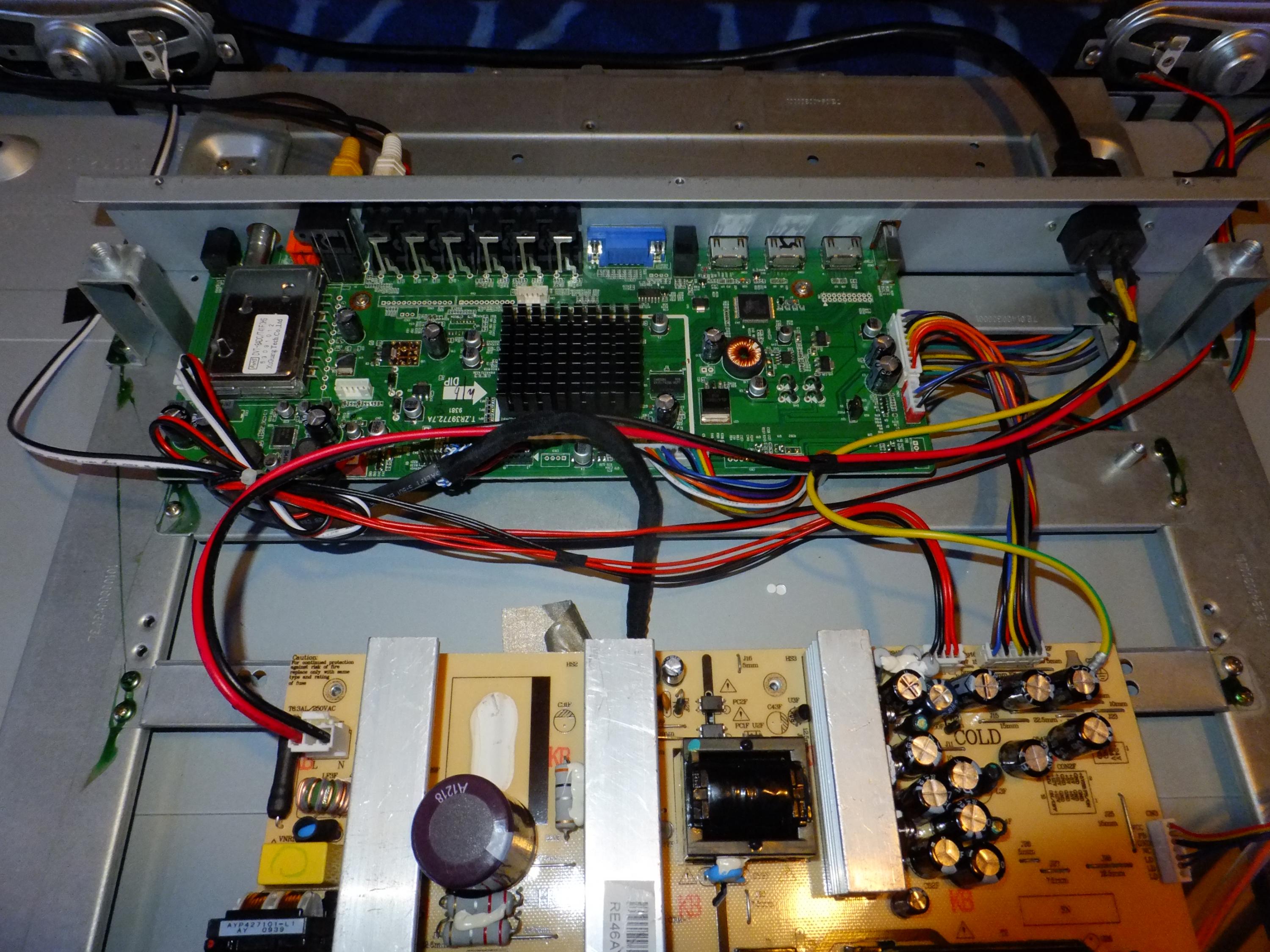

                  #48

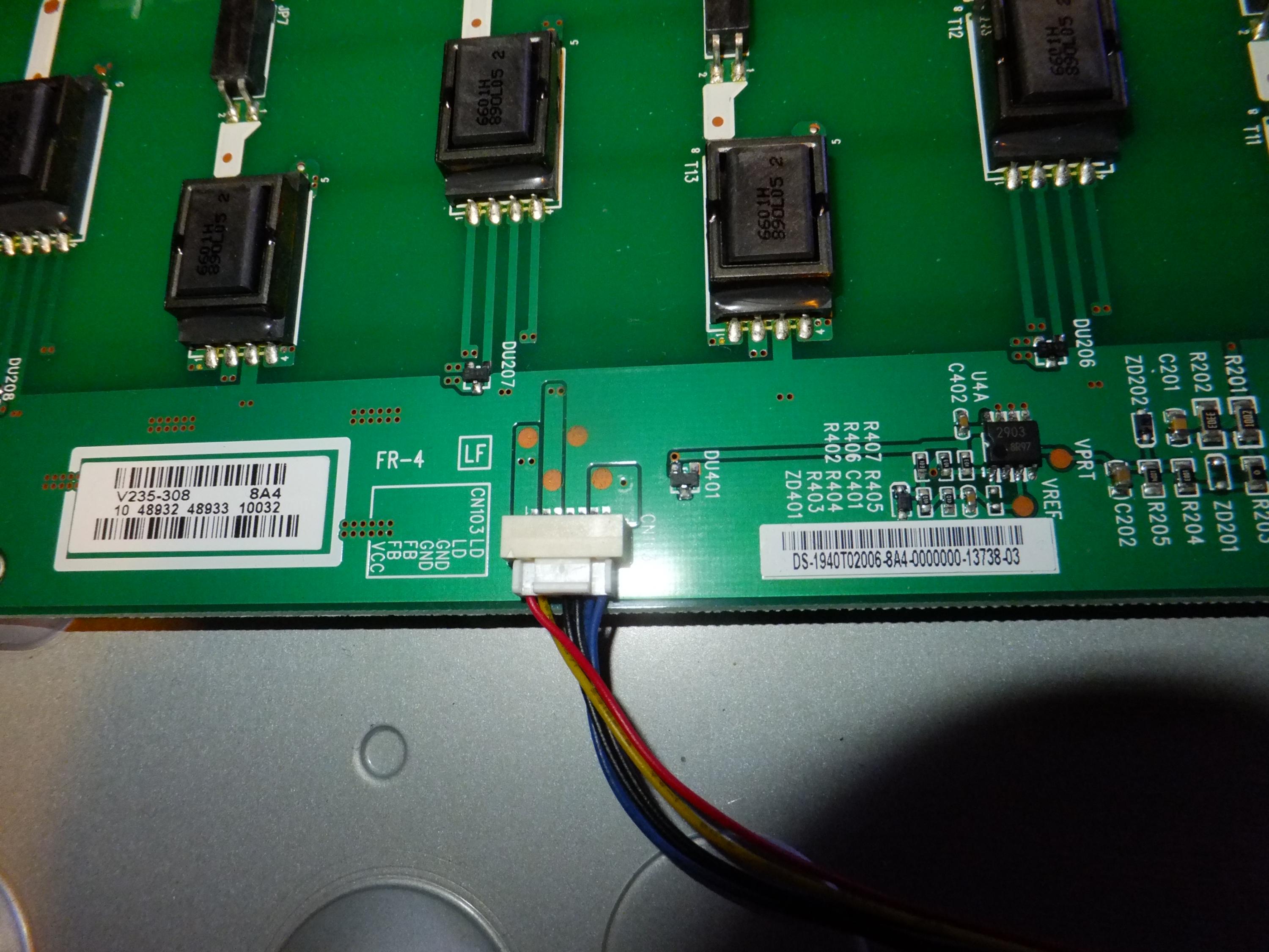

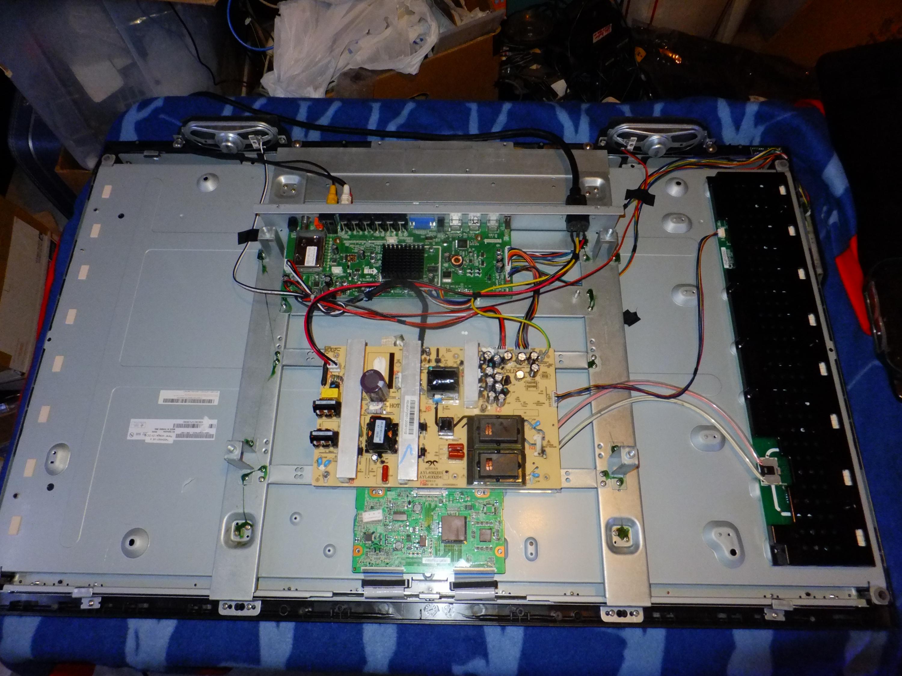

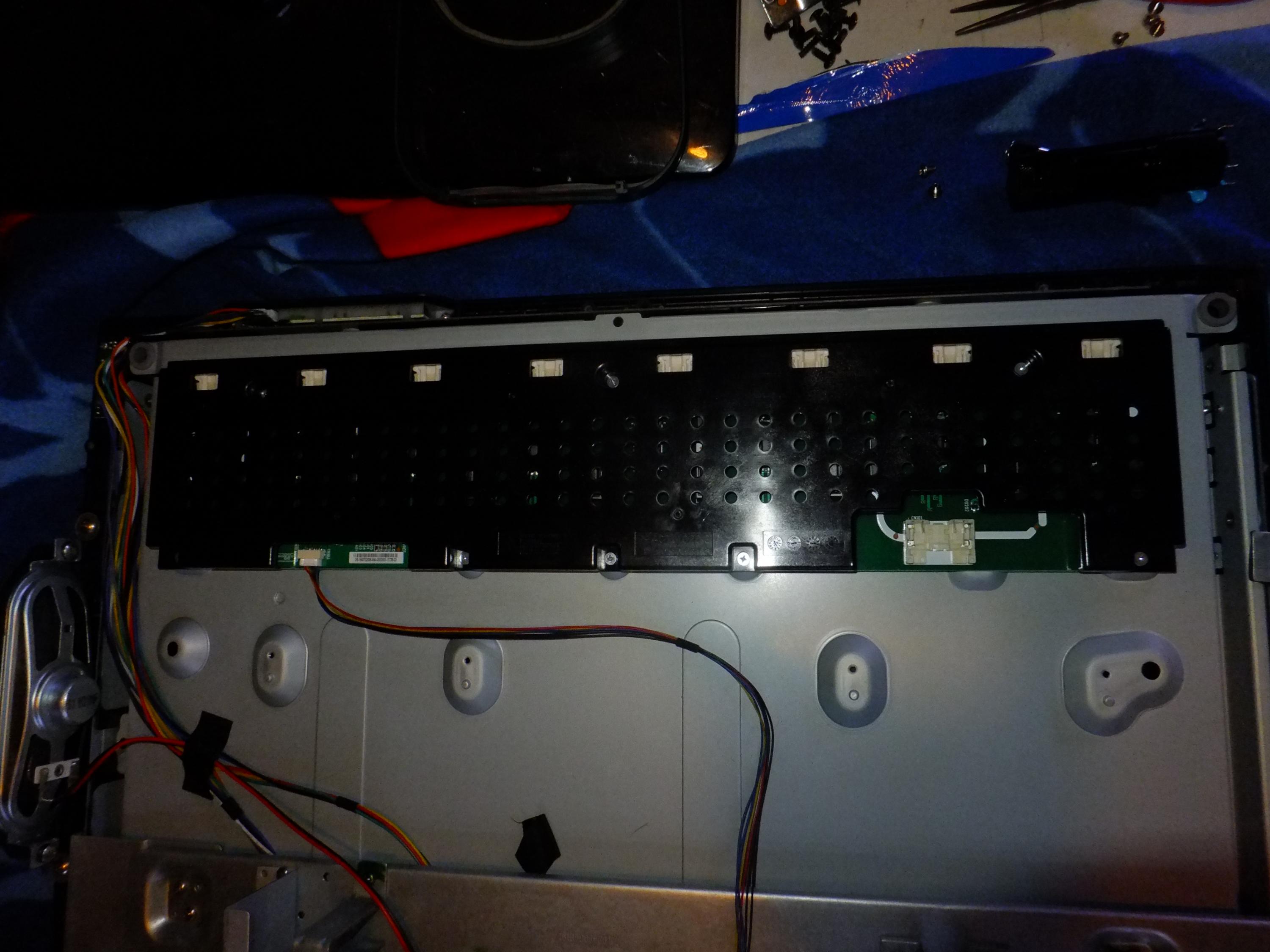

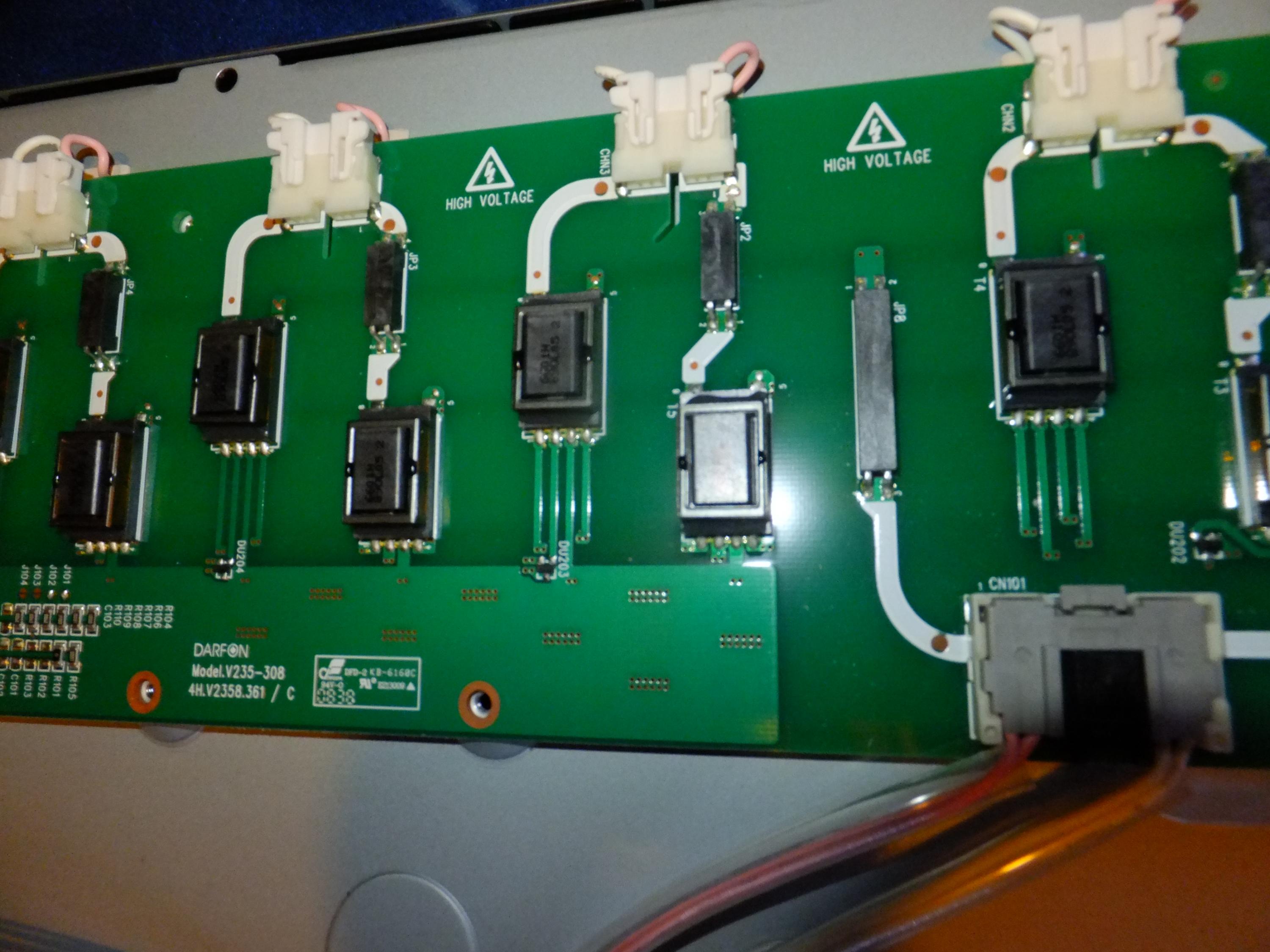

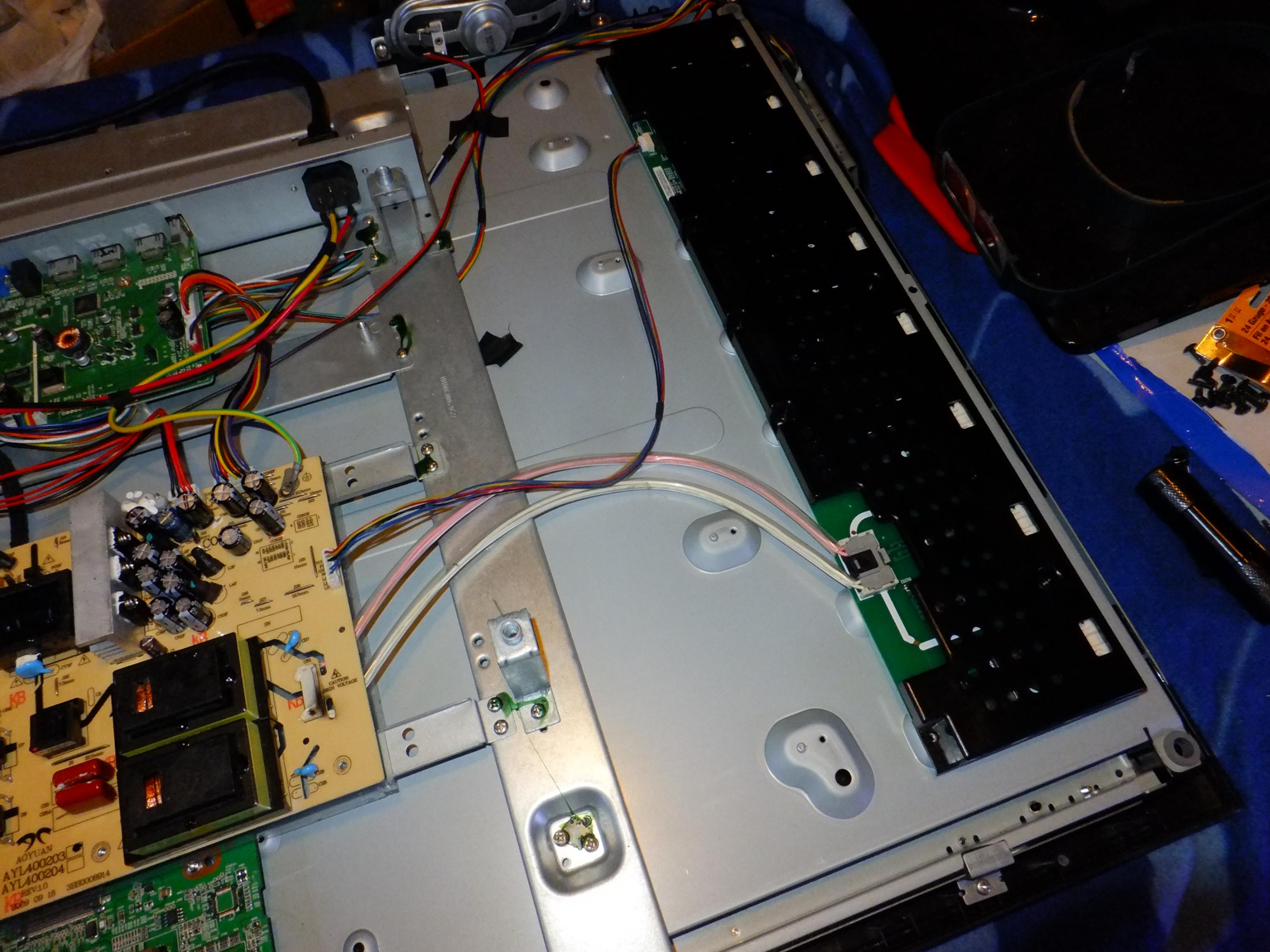

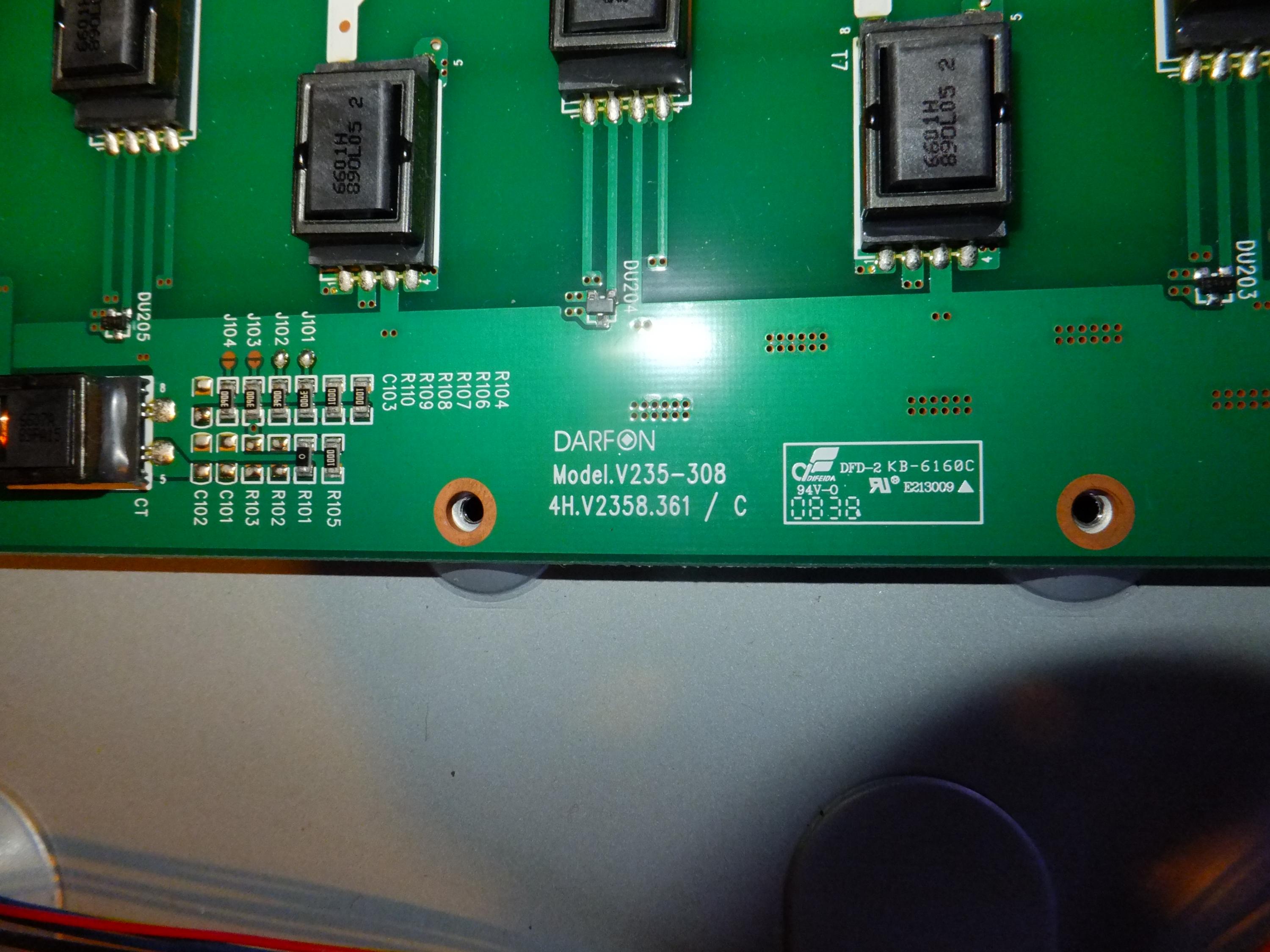

                  Your TV uses power supply/Inverter combo board, that long board attached to the lamps is Balancer board, it is used so all the lamps will evenly conduct.
                  This why it is important to see the whole backside of the TV so we can see all the boards and how they are connected together.
                  That small connector on the Blalancer board, can you get close up picture so we can see the pin labels. An where does that cable go to on the other end?

                    Here are some better pictures. I am about to close it up until I get parts in.

                                    The LD signal is generated by the comparator IC. Detect the output of those little transformer on the Balancer board.

                                        I would try replacing those two high Voltage caps since you do not real tool to simulate a couple thousand Volt to apply to the cap to find out if the caps are good or not for sure.
                                        You can also try putting the caps back in place and then removing the LD signal wire from the inverter board and then use 1K between the 12V and the LD wire to fool the circuit and see if the Backlights will stay on.

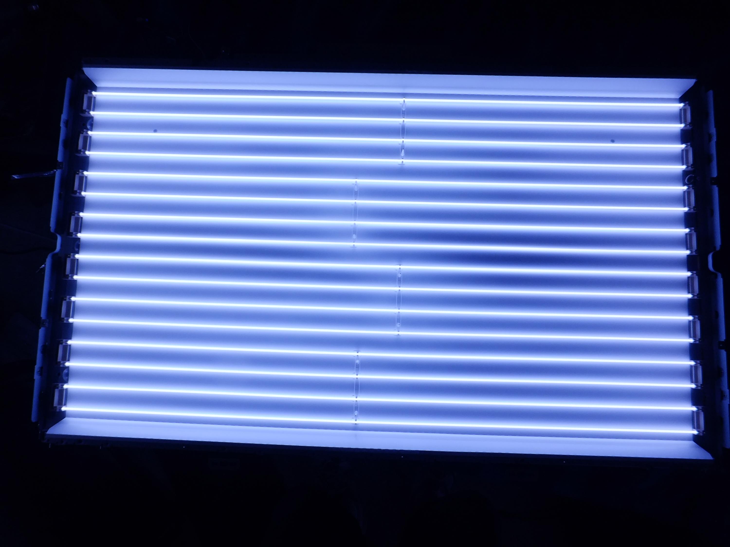

                                          OK, so I watched the videos and I did all the testing. Reconnected the 2 blue caps. Tested the outputs on all the transformers and they all were about the same, 0.350 VAC. I even disconnected all the backlights and only had 1 connected at a time, I power cycled it each time and all the lights lit. Looks like the inverter board and the CFLs all test good.
                                          When I have the 2 blue caps disconnected and the TV on, after a minute or so all the outputs on the inverter transformers drop down to 0.002 VAC
                                          Is 0.350 to high of an output? All the CFLs look good, no burn marks on the ends.
                                          I did notice I have a bad ribbon cable from the T-Con board to the Panel. I will replace that to see if it fixes the color bleeding. I ordered some RM5101 & AS15-F ICs just in case. I still have that Vizio with a bad AS15-F that I have not fixed.
