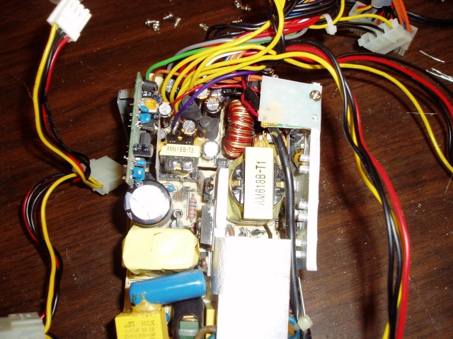

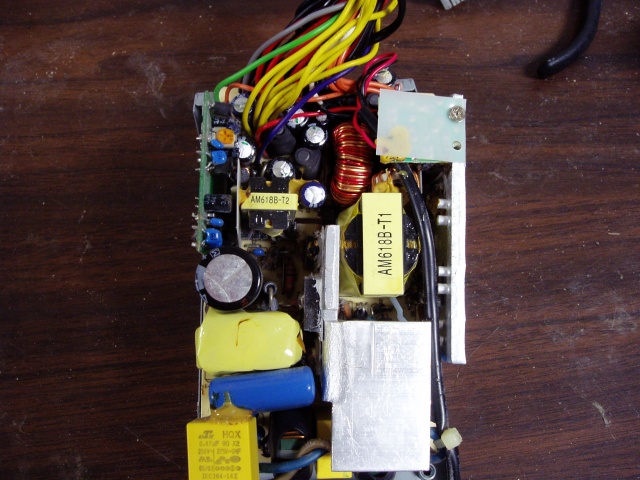

    A family member was having problems with a Shuttle SK43G computer that I built for them a few years ago. They were experiencing occasional instabilities, as well as an intermittent delay or pause between pressing the power button and having the computer turn on. It was kinda freaky pressing the power button and having it turn on 5 minutes later!

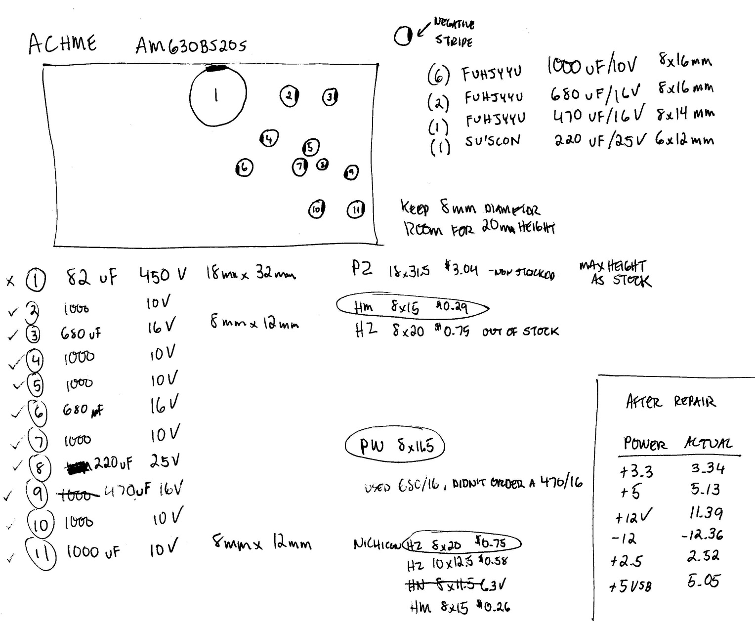

    Anyways, all the caps on the motherboard looked fine, even though not being the best of brands. I remember some OSTs on the mobo. The problem turned out to be in the power supply. Most of the caps in there were bulging and leaking. Unfortunately, this is a small & proprietary power supply and replacements are hard to find, and not cheap when you do. It is an ACHME AM630BS20S.
    I replaced all 10 caps with Nichocon HZ and HM from Mouser. There was one 220/25/6x12, and I had to squeeze an 8mm PW in there. I only made one mistake and didn't order a 470/16, so I used a 680/16 in its place. oops. The machine has been stable and turns on correctly. I'm a little disappointed that the +12V rail is showing 11.39V, that seems a little low.
    I really like these little Shuttle XPC boxes, and I hope this post helps someone else rescue one of them.

    Welcome to Badcaps and congrats on the success
    Just a FYI; many mobos are very inaccurate with their voltage readings, use a DMM to see what 12v really is if you really want to know

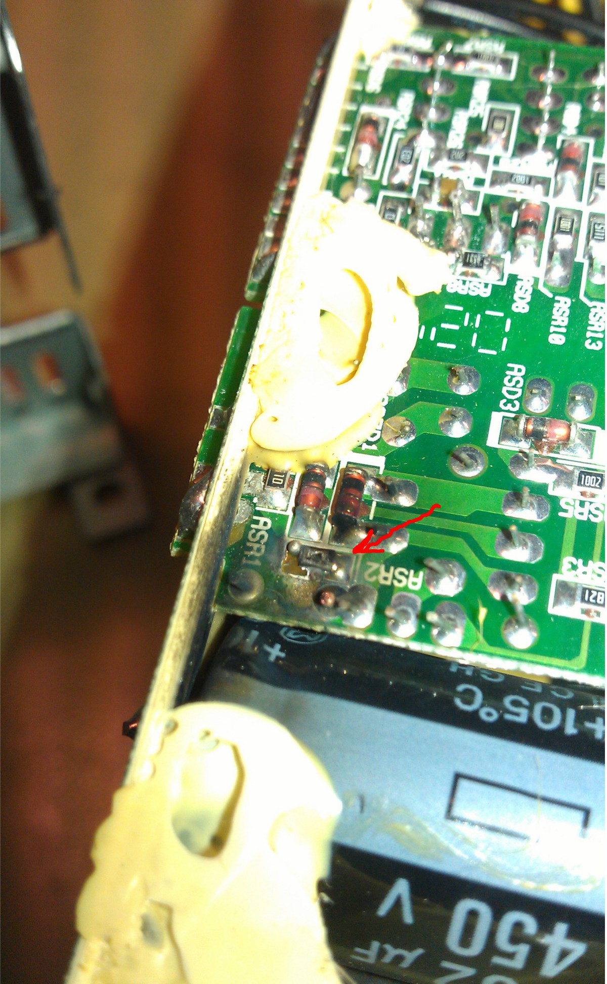

                              I have gathered capacitors and was about to start replace them but found the PWM controller ic blown, missing its cap. New KA3842AN can be found, but on the backside of the PWM controller board there is a small SMD resistor witch has gone up into smoke, burning the markings so i don't know what resistance to replace it with.
                              Has anybody got a clue what value resistor ASR2 shall be? (It's placed on the back side of the small sub-board witch is close to the DC output wires. The resistor is close to the edge nearest the big input capacitor 82u/450v.)
                              Help much appreciated.

                                A good clear picture of the area might help, also smoke mark/burn might rub off with
                                some isopropyl alcohol. Have you got it off the board - may have markings underneath.

                                  Okay, fixed some acceptable picures:
                                  No big hope of finding any remaining markings on this one.

                                    I checked the Resistor ASR2 value. It's 512, 5.1kohm
