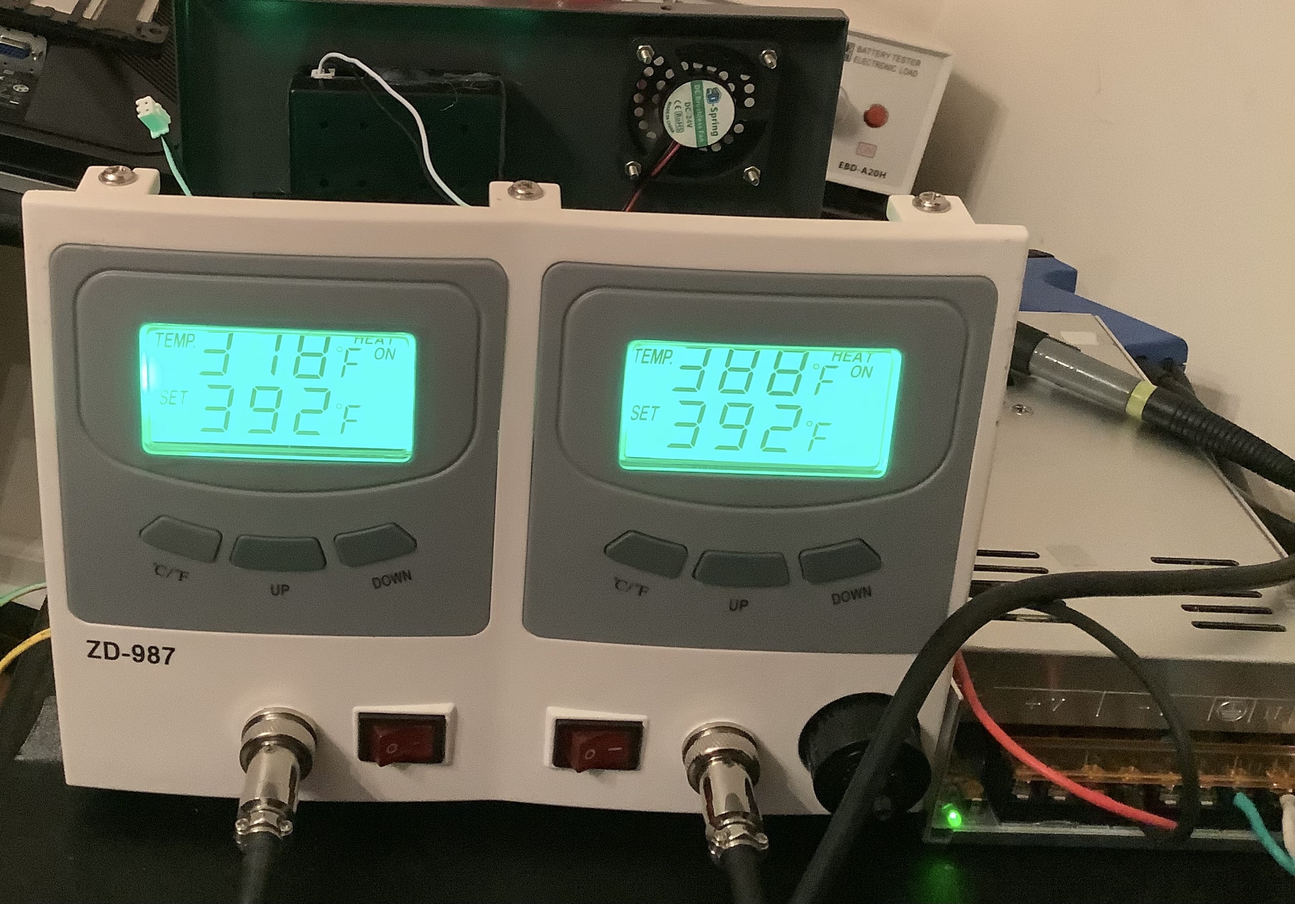

    I once tried to get a ZD-915 desoldering station to work on a 18 volt battery power supply but unfortunately things did not go well but I did find a work around but I might try this idea again but going at a little differently more about this another time
    I talk about doing this in another post which I will link it to this post
    I did this at first as a proof of concept and was not sure if it was going to work with out issues but it does work and better than I expected it to
    Here is the switching power supply that I used for this project
    https://www.ebay.com/itm/164440680270?var=464055952719. 18 volt @ 20 amp switching power supply

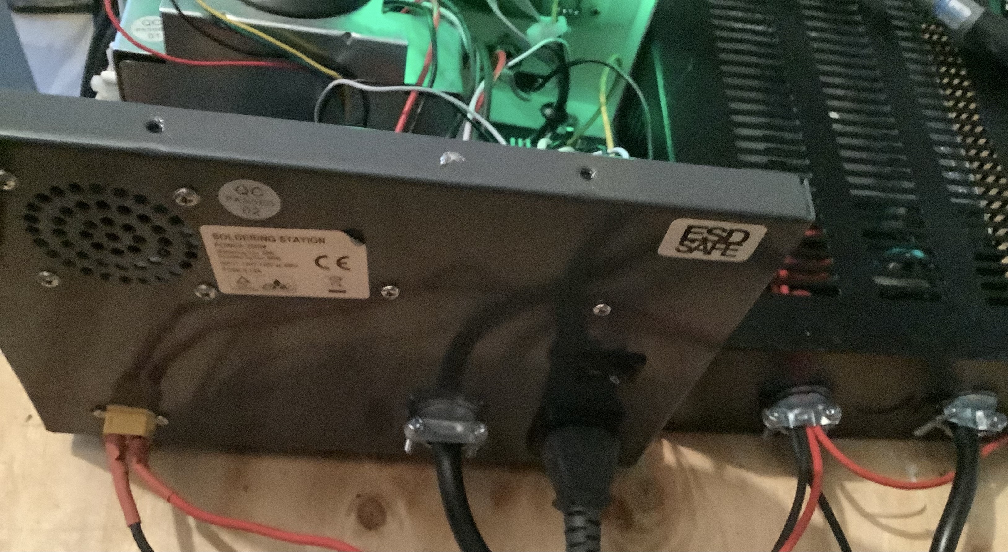

    I now have to wire up the switching power supply to the on/off switch and to the input outlet on the soldering station system so that the switching power supply is controlled the way it was originally designed to do but with a better made switching power supply
    Here is where I started the this conversation about weather or not the switching power supply would be the right choice
    https://www.badcaps.net/forum/troubl...8-volts-20-amp

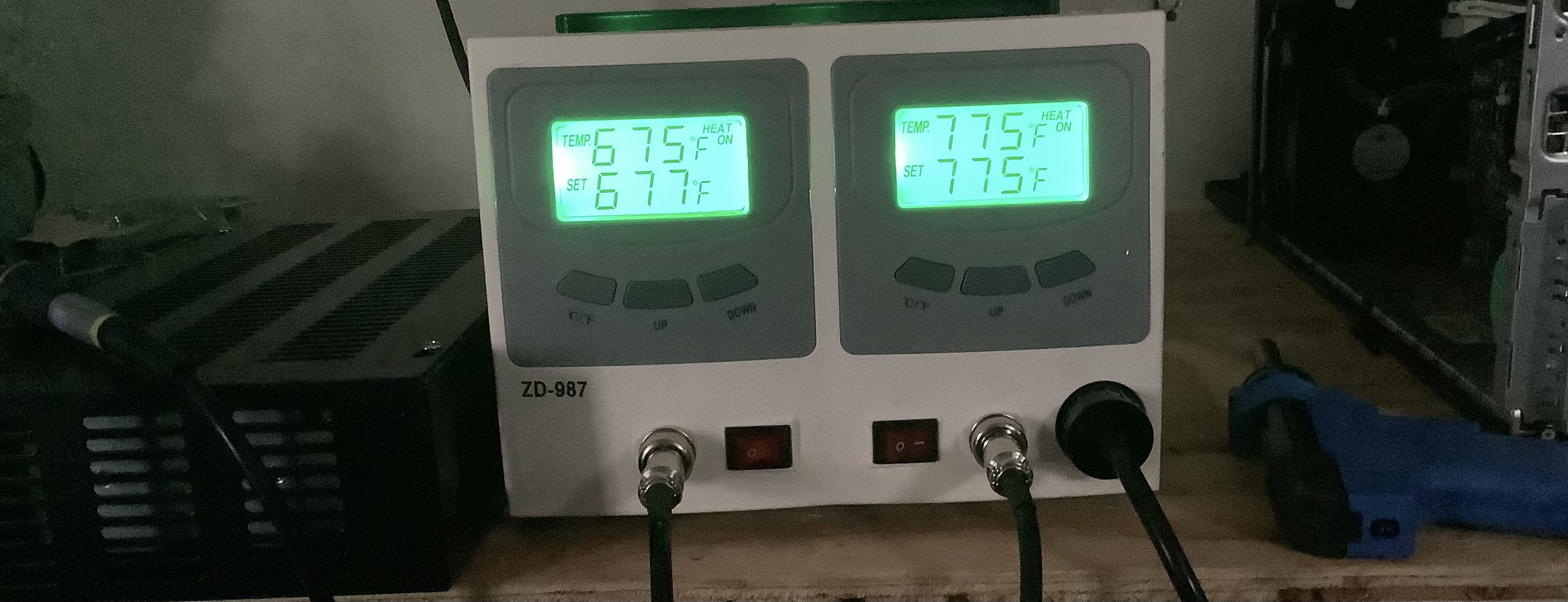

      Well I turned on the soldering iron side today to test a soldering iron that I had on the bench and I could not remember why it was there at first but then I remembered why it was there because one of them the tip almost to far gone on one side of it which is weird but this was not caught my attention what did catch my attention was when the iron came up to working temperature the switching power supply fan would speed up when it was calling for heating and when it was not calling for heating it slowed down to almost nothing these very well built switching power supply from what I have seen so far

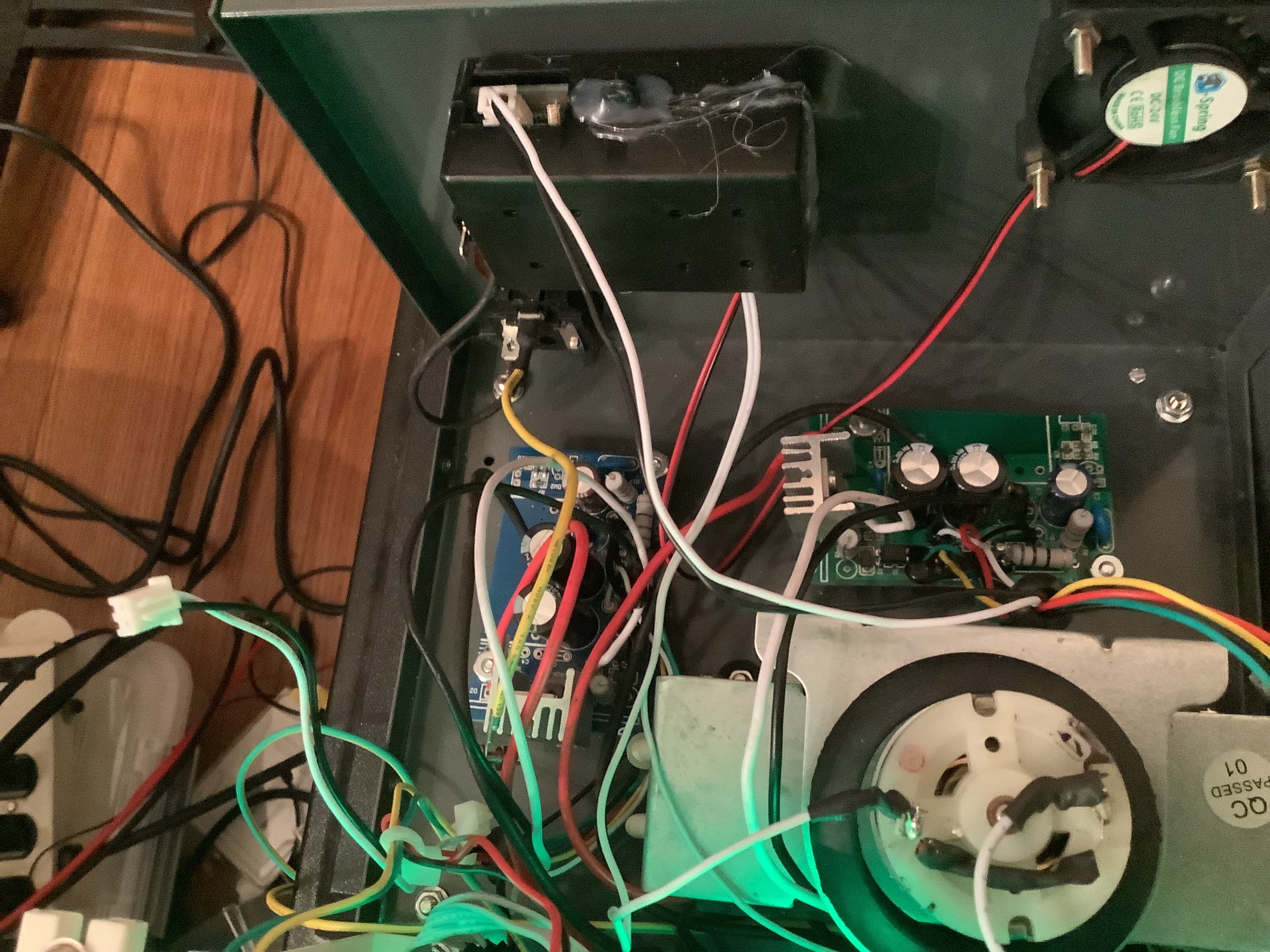

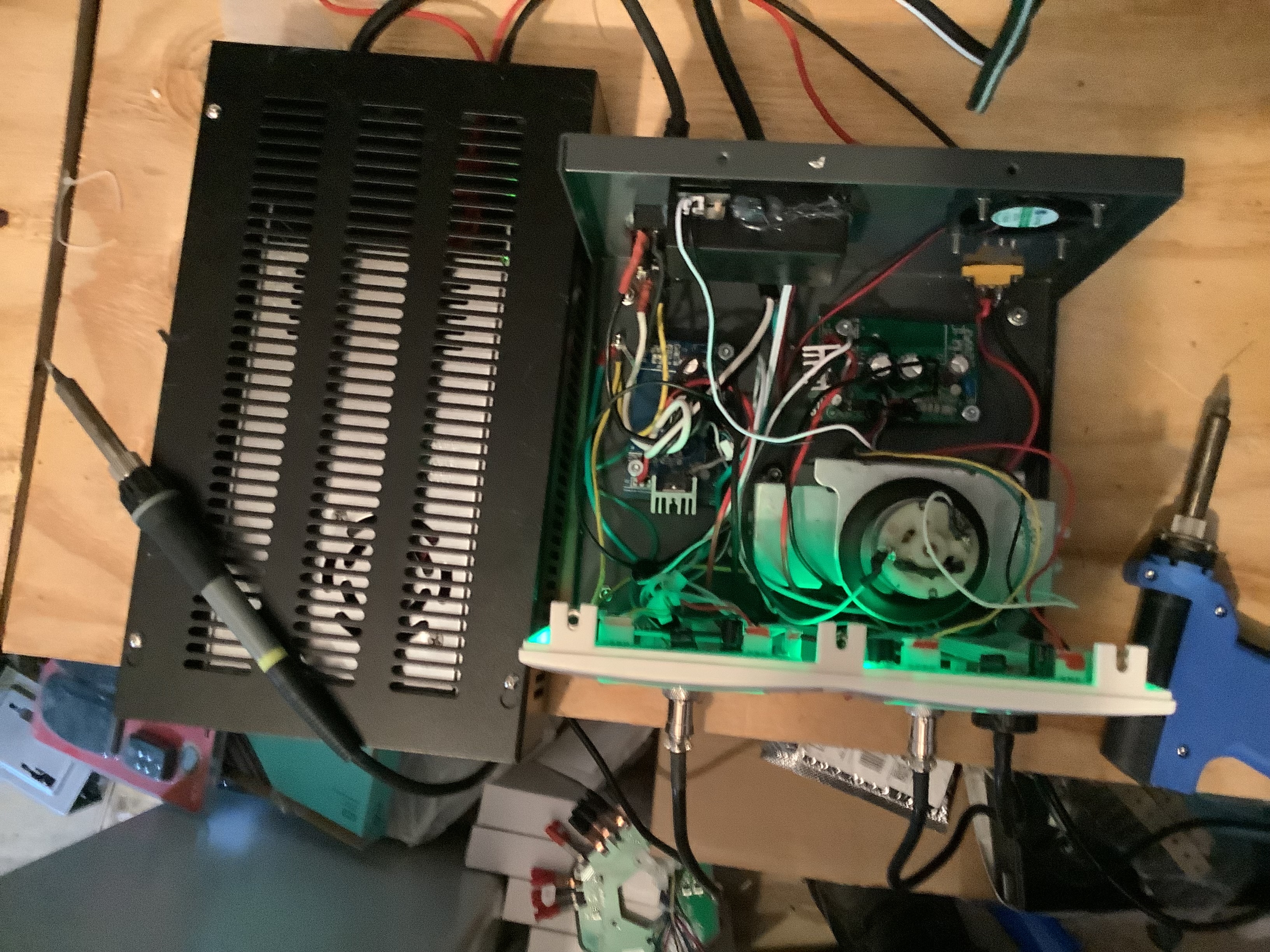

                Well I had some time today to work on the switching power supply enclosure I hooked up the DC power supply and now I have to finish the outlet side of the switching power supply to the soldering/desoldering station some pictures to later when I have incoming power supply hooked up and just before I put all of the covers back on and torcher test all put together
                  • Jul 2011
                  • 6033

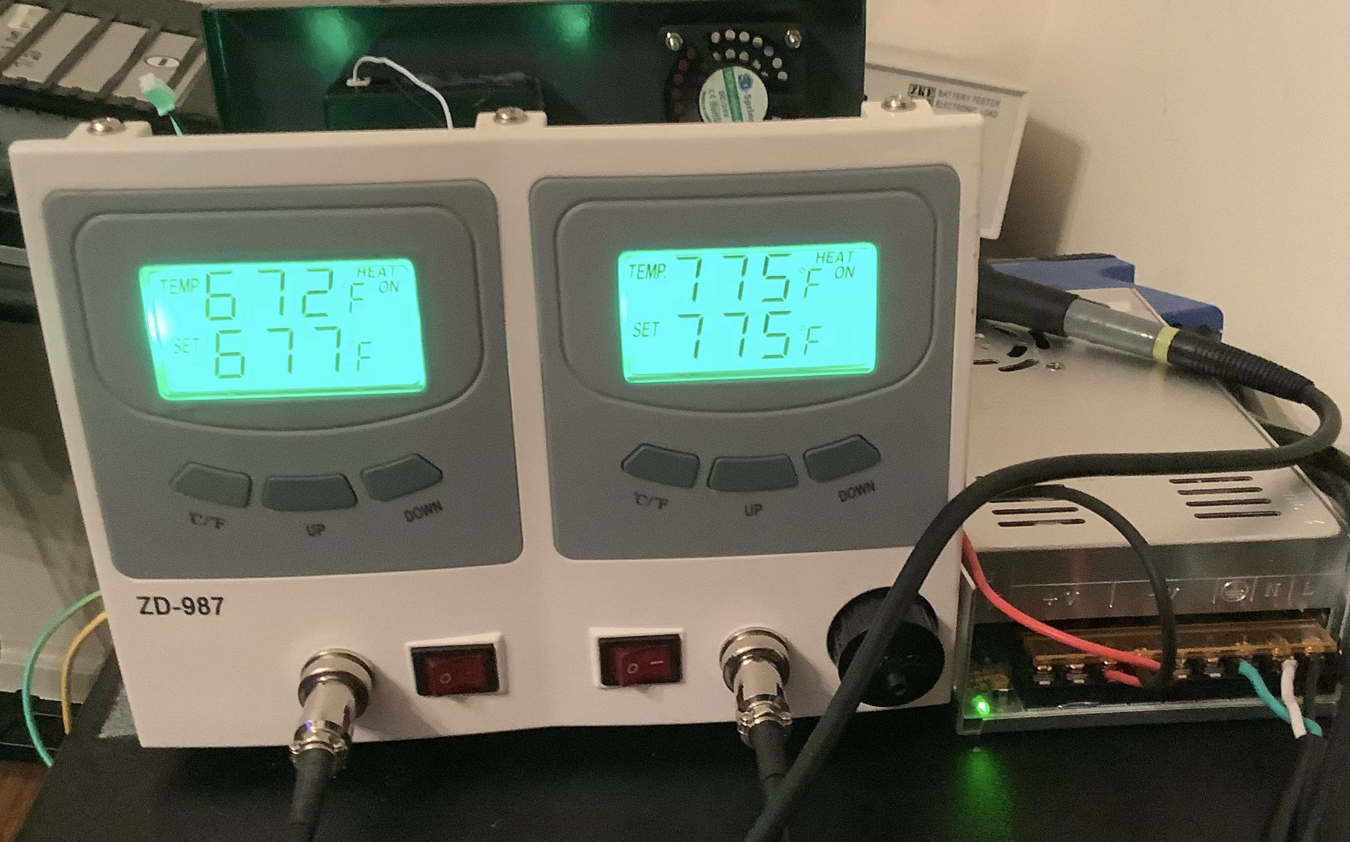

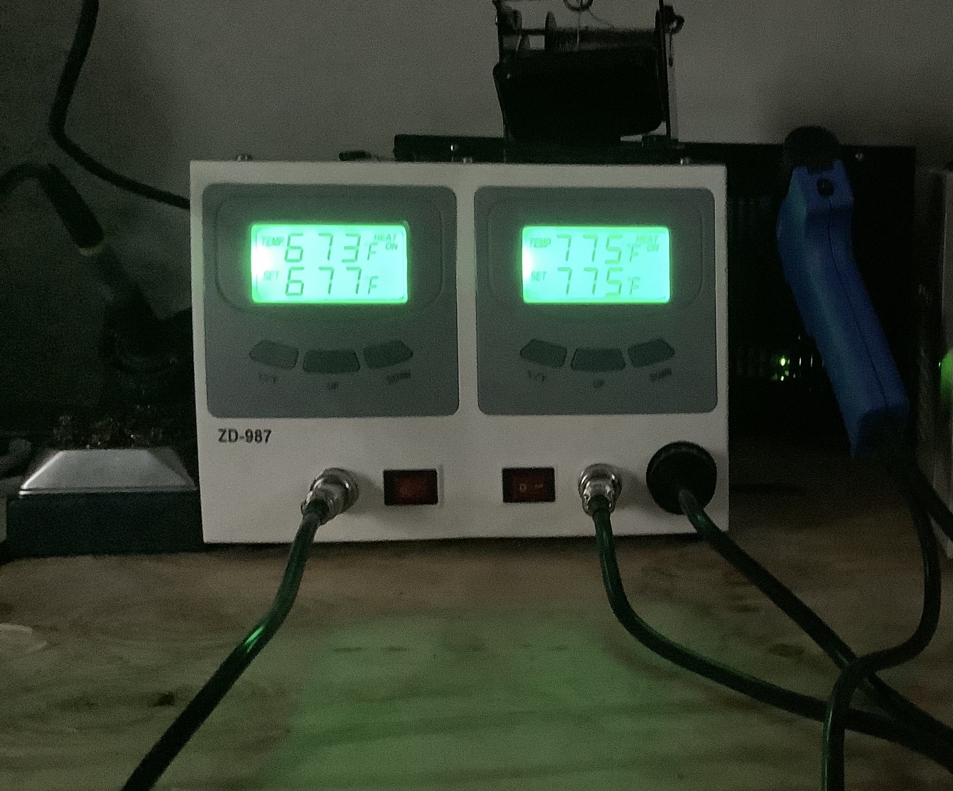

                  Well this project is almost done all I have to do now is put the cover on the enclosure and put it all together and the last picture is the desoldering/soldering station is set up and ready to go
                  This project took a little while to do because of the challenging part that I had to figure out how I was going to put everything together and make it look professional which is the main problem yea I know could have it together but I know how that turns out in the long run
                  I tried again to power this on battery power and the mosfet gets very warm very fast so it was not an error that I did the first time I have to set it up like I talked about in a post a long time ago but sense I was messing around with this again I thought I would try it again just for my curiosity and this has bothered me for a while and I had to put it to rest once for all

                    Now I have to modify the other desoldering/soldering station this version does not have the sleep function this is the reason I did the other one first because it does have have the sleep function on it then I several hot air gun/soldering iron station but I have to figure out how I going set them up because I do not use the hot air gun very often but these two have the sleep function on the soldering iron part so I going to change it to the version that does not have the sleep function because I will probably used this unit when I have to use the hot air gun

                          One note I did use the soldering / desoldering station that has the sleep function on with the new switching power supply and it works perfectly fine no issues

                              Interesting project, why the external power supply at all, though? Battery power I can understand but don't these already have a PSU inbuilt?

                                To answer your question about why using an external switching power supply is because the switching power is not of a good quality and after many hours of use it tends to have a higher rate of failure that I have not figured out exactly what the fault is but sometimes it is a switching power supply regulator failure and sometimes when you replace the switching power supply regulator it fails again or it just refuses to turn on again
                                Plus the original switching power supply is underrated for the amount of current that it sometimes needs to provide when you first turn it on and I have also had the switching power supply transformer failure as well plus the size of the switching supply board plus the switching supply transformer are small compared to the switching power supply that I replaced it with
                                Like I mentioned earlier when you convert it to battery power you have to add a PWM controller and a 3D mosfet controller board as well because you do not have any control for the mosfet was was originally used on the switching power supply board

                                      An update on the situation with the new external switching power supply with this desoldering / soldering station working extremely well and no issues or problems with this new setup ran smoothly and for 4 hours today so far and probably 6 hours last weekend
