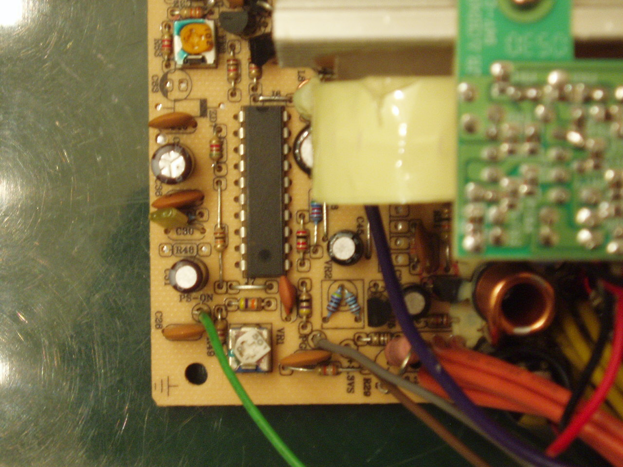

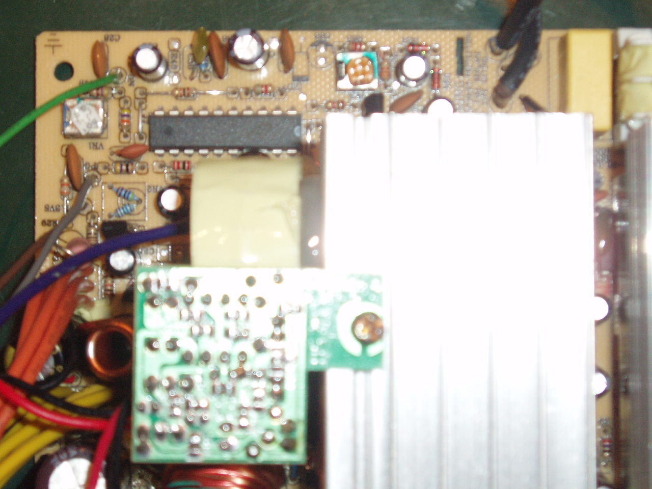

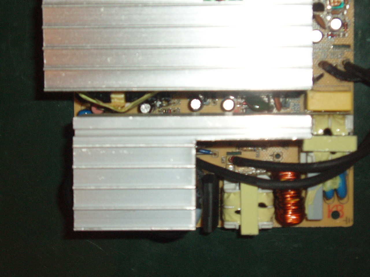

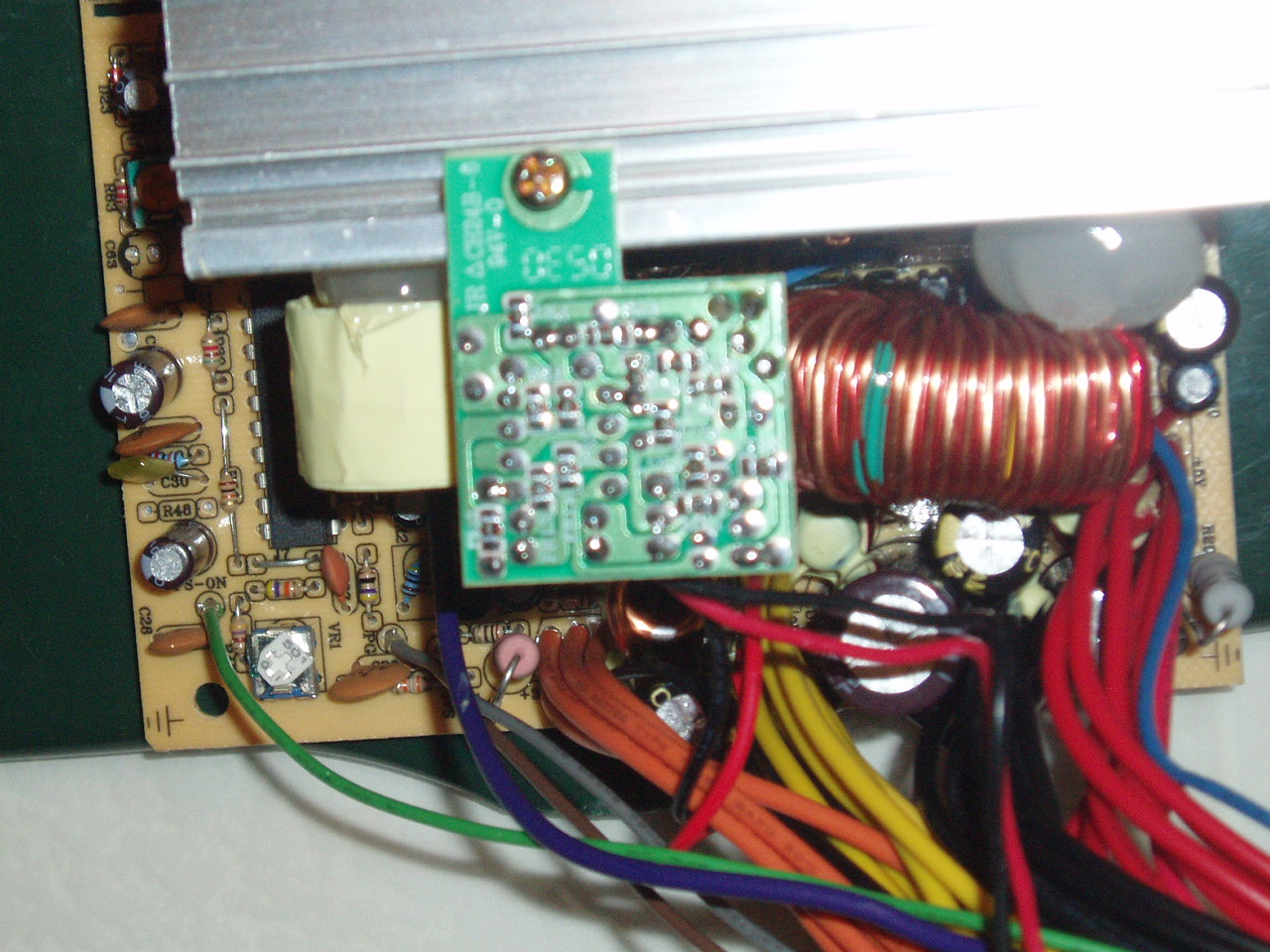

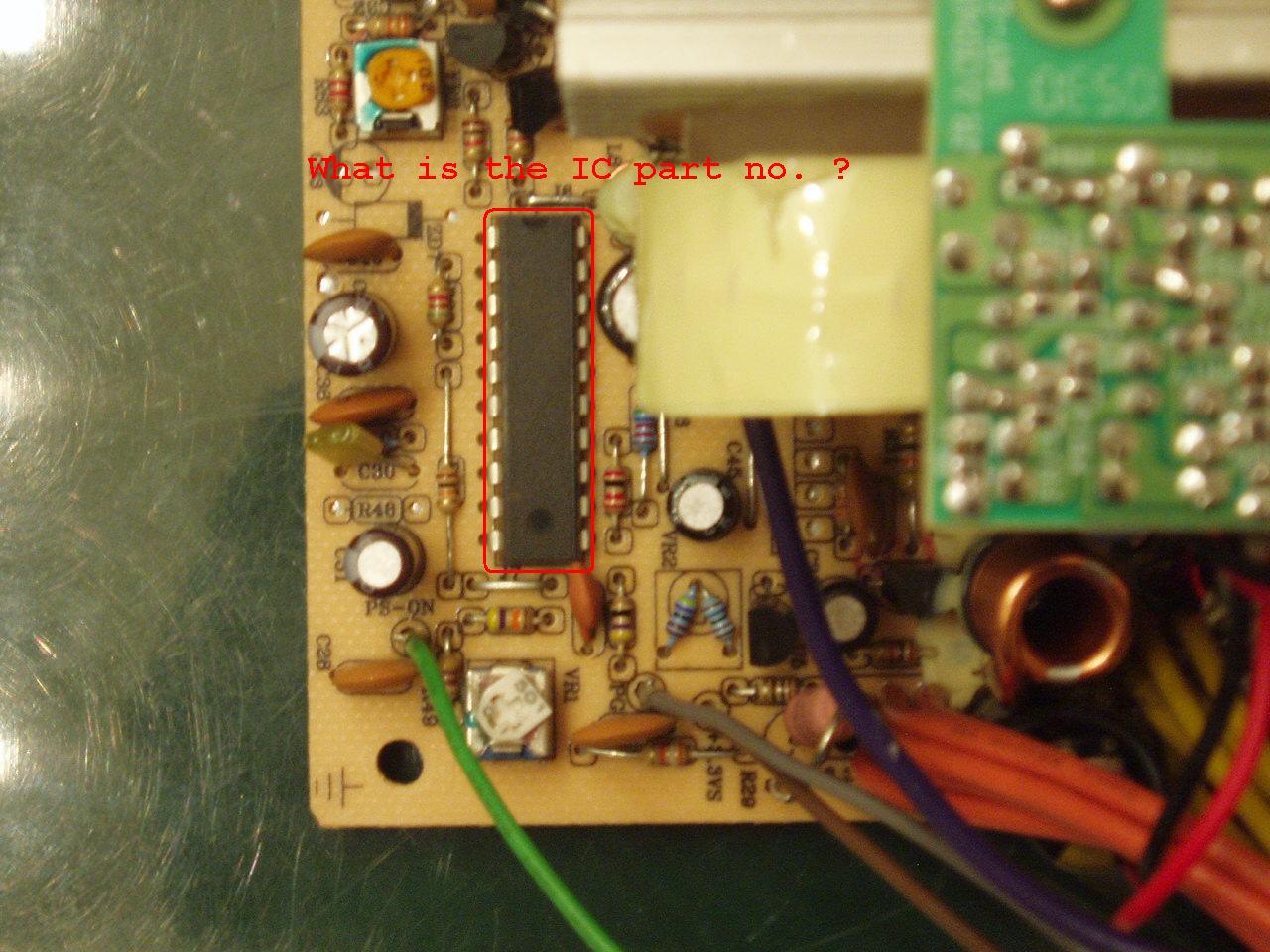

                          Here are some pics... apparently I am not very good at taking them... how does everyone else get such clear ones? Anyway, what should I do now?

                            "Good lighting, no flash" works for me. The flash is terrible with electronic components, but a fluorescent light or sunlight tends to create a good picture, even with an older camera like mine (2 megapixel Kodak EasyShare).
                            Still, those pictures aren't bad at all.

                              What is the IC part no. in the picture ? It is probably the PWM controller IC.

                                    • MixMasta
                                      • Feb 2006
                                      • 142
                                      Re: Out of spec 12v and 5v. Recommendations?
                                      FJ 3528
                                      536 J771C
                                      The FJ part is a logo...
