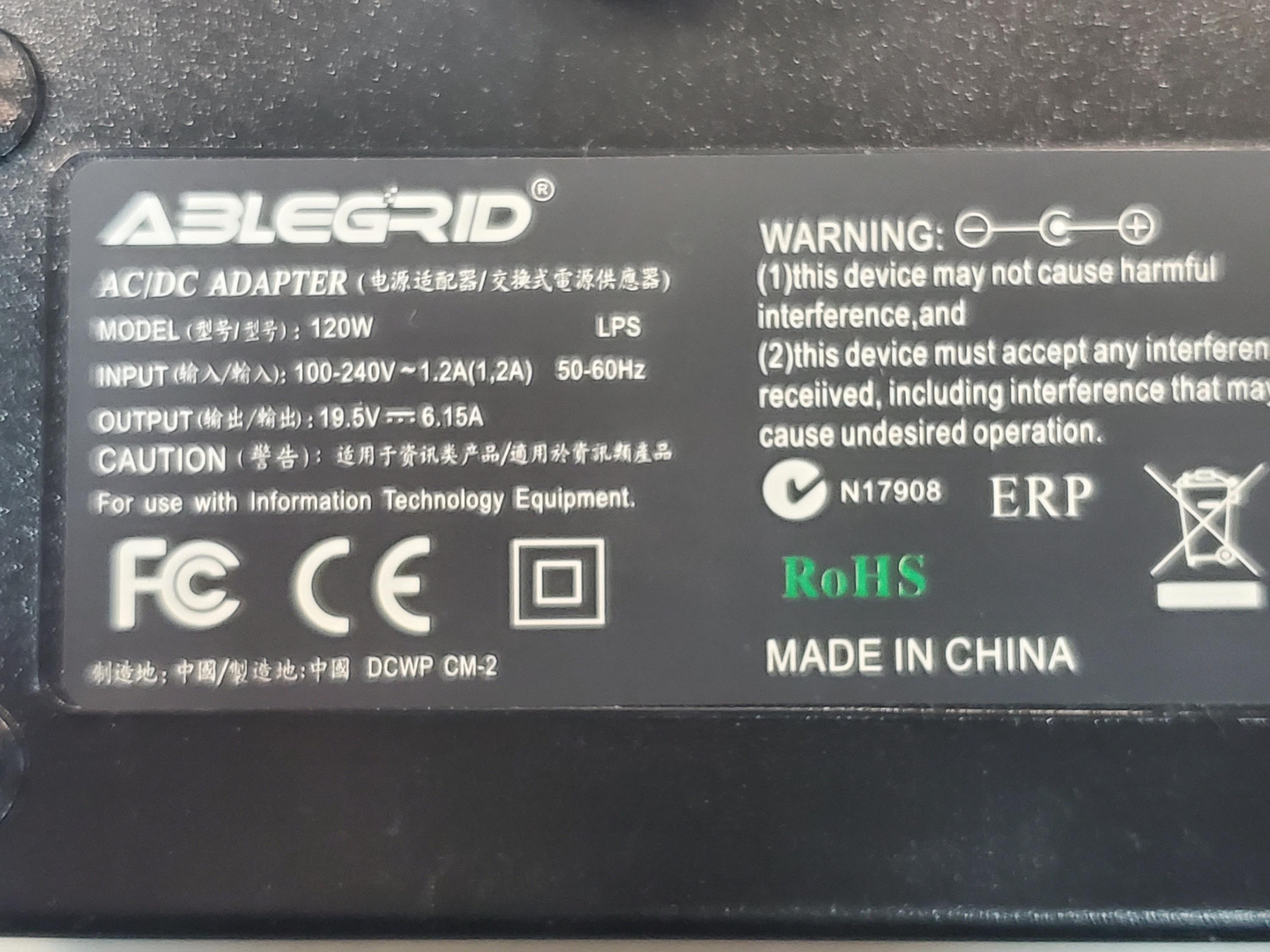

    I purchased 2 new from Amazon After Market Power Supplies(PSU). Same Voltage and Same Amperage and in fact it mentions on the Amazon page they are supported for these docks as well.
    https://www.amazon.com/gp/product/B0...?ie=UTF8&psc=1
    So when I received both the Docks and the PSU's I hooked them up to test them out at my home office.
    Nothing appeared to work, does not even charge laptop, and there is no light on the bottom where the PSU connects in to the Dock. (Exactly as the one at my work office does)
    So I figured I got some bad Docks as both were doing the same exact thing.
    The connector of the PSU is the same type/size/voltage as my laptop. Upon plugging it in to my laptop directly it charges my laptop...So this also pointed to bad Docks.

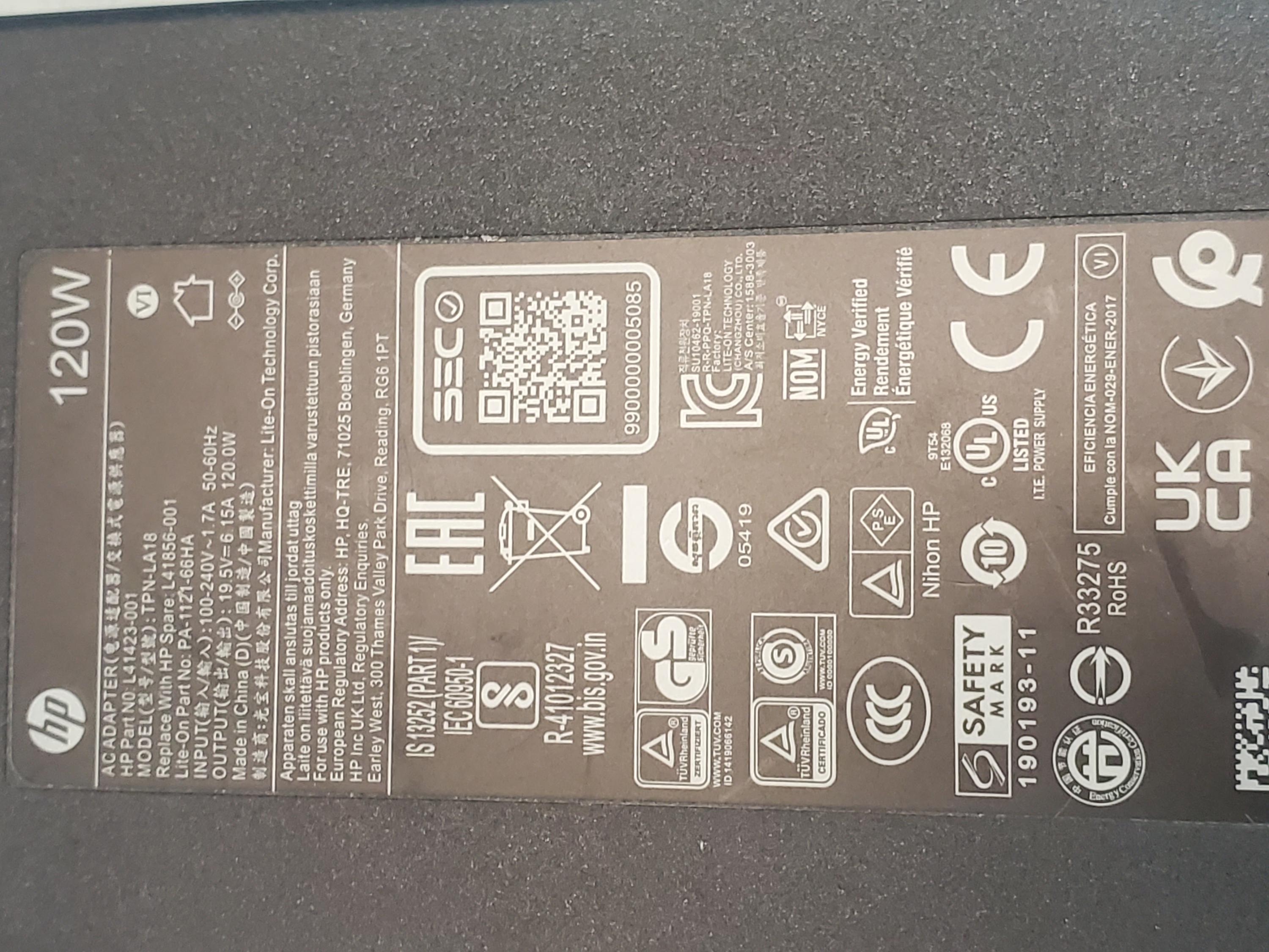

    So I for the hell of it I brought both docks and new PSUs into my work office. I swapped the HP Power Supply to my eBay bought docks and they both work fine. I take the new Amazon bought PSU and hooked it to my work office Dock and it does not work and acts exactly like my other docks on the PSU.
    So I now think the Docks are good the PSUs are bad.

    Probably connector issue, I mean on psu side center + pin might to be too wide or too deep, then cannot touch docking pin... on 5mm "standard" plug, there is so many type, dimension, missmatch with iner pin... I guess that s the problem, not bad psu.

          Typically I would buy a HP one but actually the HP one appears to be made by Lite On. So its actually relabeled.
          Unfortunately the HP PSU used is more than double the cost of the after market. Not to mention more than what I bought the Docks for originally.

              Over here a genuine power supply is £40 new.
              Lite-on make quality power supplies and have done for years.

                Most likely the non-original doesnt have proper HP ID circuitry so the laptop/dock think its a 65 (or 90W?) power supply. Thus the laptop charges but dock doesnt. It wants a 120W+ power supply.

                    Its a 120 Watt PSU 19.5V 6.15 amps.
                    Its 90 degree 4.5mm blue tipped end.
                    So today I decided to send the PSUs back to Amazon and have them replace them.
                    I got my scope out and looked at the connector on the docks. They are clean and solid and not pushed in and I believe it would be hard to actually damage as its a 90 degree design. In both docks they look fine.
                    So I got out my multimeter. I measured the voltage at the PSU connector end. It measure 20.06 on the PSUs from Amazon. So Voltage a little over but stable over a period of time I watched it.
                    I did the two HPs at work 20.76V and 20.66V.
                    So they are also both over the stated 19.5V.
                    Would this Voltage difference (i.e. 20.06 vs 20.76) be enough to cause one to work and another not to work? (My feeling is no I would assume some variance is acceptable)
                    I would think that the 19.5 stated Voltage would be the required minimum?
                    Thoughts?

                      the voltage is not important, most stuff will run from 15 to 22 or more.
                      but dont go over 20 because the caps are rated for much more.
                      it's probably a connector issue on the clone chargers

                        Indeed some variance is accepted... and actually as sjt noted, the voltage is not too important, because laptops have internal buck regulators that will convert the input voltage to the much lower voltages needed.
                        Generally, most parts inside the laptop on the input side (where the power adapter connects to) will be rated 35V or 50V, so higher voltage is not a problem. However, just in case some manufacturer used 25V -rated parts, it's usually not a good idea to go over 23-24V for the input. And as far as how low you can go - as low as you like, so long it's a few volts more than the battery's max voltage (when fully charged - i.e. ~4 to 4.2V per cell on most Lithium, IIRC.) But generally, 15-16V is indeed the lower limit.
                        As to why those adapters read a little higher than 19.5V: once the laptop is under load (CPU or GPU or both), this will cause a higher current to be drawn from the adapter, which would cause some voltage drop through the cable. So under load normal loads, the voltage will indeed likely measure closer to 19.5V on the laptop end. And with really heavy CPU/GPU loads, the voltage could go even under 19V.

                          I wonder about the connectors myself and the docking plug.
                          They appear to fit snug, the center is a single pin and both sides look good.
                          The outside of the PSU connector is 4.5 mm.
                          The inside on the Docking station has three points of contact that the PSU connector would make contact.
                          I am wondering if there is possibly not enough amperage coming out which I would have to put my DMM in circuit and unfortunately I do not have the proper connector to the docking station...I have been meaning to buy a "Set" of the adapters connectors for just this purpose.

                            i personally dont trust barrel type plugs with more than about 4A,
                            they where originally designed for about 1A and even with the forked type center contact i really dont trust them at over 5A
