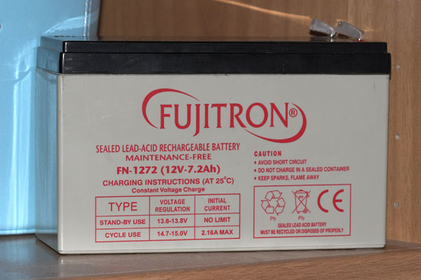

                      another different china brand found in a brand new APC ups. the funny thing is they put all these APC stickers on the battery but it would probably cost nothing to get them APC branded at the factory....
                      here is what they have in the shop today
                      its a Fujitron FN-1272 12v 7.2Ah sealed lead-acid rechargeable battery
                      the shopkeeper has put all his faith in Fujitron now........he says they are made in japan...my ass....anyway there is no reference in google for this model or company....except this post shortly......
                      at the moment i am thinking the Back-ups RS are better at not overcharging the batteries than the smart-ups. i dont recall changing batteries in any RS yet and i have some over 3 years.

                          anyone else notice the blatent ripoff on fujitsu?
