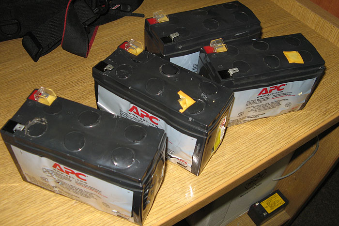

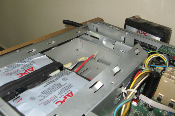

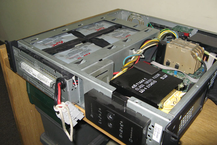

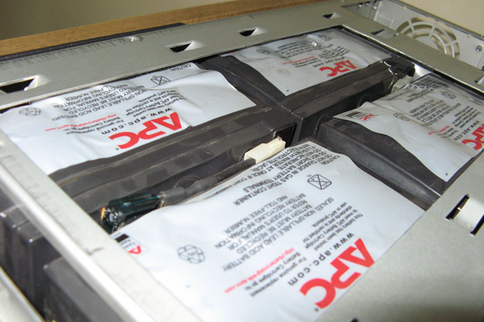

            troubleshoot this then........first set of batteries CSB brand (made in guangzhou) with APC stickers. About 3 years of 24/7 service. The battery drawer is at the front of the unit and the batteries cannot exit because they have all expanded. OK but there is no provision for this situation, the battery compartment is folded steel and riveted.
            Only way i see is to bend those folded edges up

              yeah this is where computing meets engineering

                and we hope it fits in the rack again.....

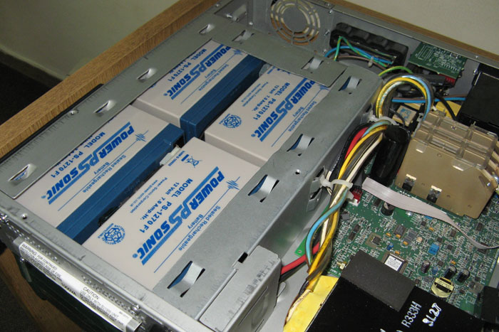

                  Daaaaaammmmnnnn, those batteries are toasted I had a Panasonic battery for a Smart-UPS 600 that looked bad , but not that bad!
                  How good are the Powersonic batteries? I have a stack of UPS units to rebuild. The only ones I really bother with anymore are APC, unless I find a really big one >2500VA.

                    Wow Willa, that's some bad failure!
                    I don't ever think I made a thread about that APC I was talking about above but one of it's batteries where also in pretty bad shape, not like that tho...
                    Intelligent UPS my ass
                      they do similar failures but there is not much choice here. I have come to the conclusion that everything is crap nowadays anyway.
                      mine too. yesterday there was a smell in the server room which i could not locate (i think we know what that was now) and only today the battery alarm was sounding.......the casing was very hot. how about a case temperature sensor APC?????

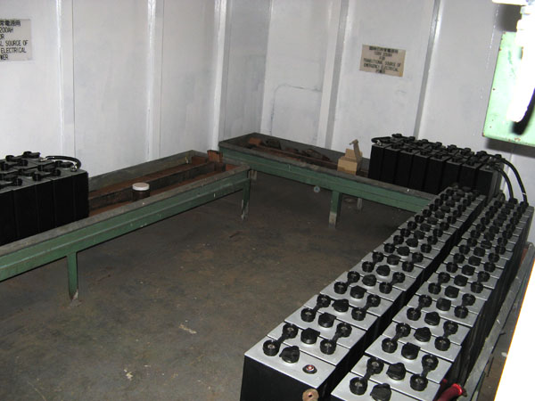

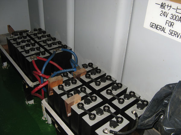

                                        here is one of the emergency power rooms on a cruise ship. (ships have UPS also) They also had a brand new emergency generator which at 2000 rpm was fucking loud.
