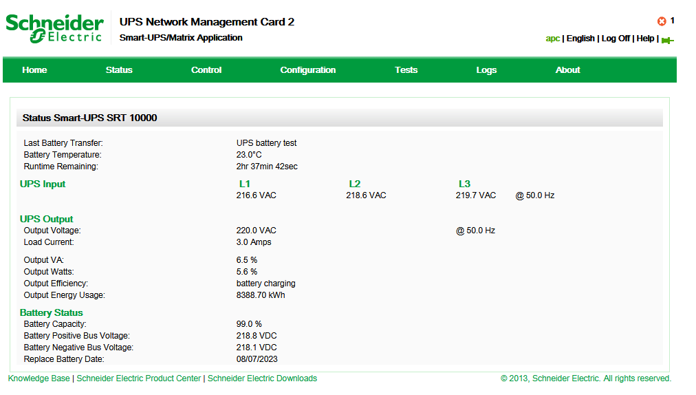

              Hello, I have 2x SRT10KXLI units, one of which shows Critical alert : Bypass Voltage not in range ; Low Voltage.
              I have also attached a photo of the connections in the back of the unit (3phase) also showing the bypass jumper bar installed in place.
              I have measured in both ends of the bypass jumper bar and there is normally 218V in both ends ( on top of screw ).
              UPS firmware was updated through USB ( device ID went from 1002 to 1014, FW from 02.1 to 04.7).
              NMC firmware is 6.0.7 version (AP9537SUM module) (did not update this).
              Tried several times to turn off, alter settings etc. Even "braindeading" the unit , as described in this discussion.
              I have also attached the Data log, showing Vmin and Vmax as zero.
              Battery modules have been replaced on February (2 months ago).
              Thank you in advance for your support and your help.
