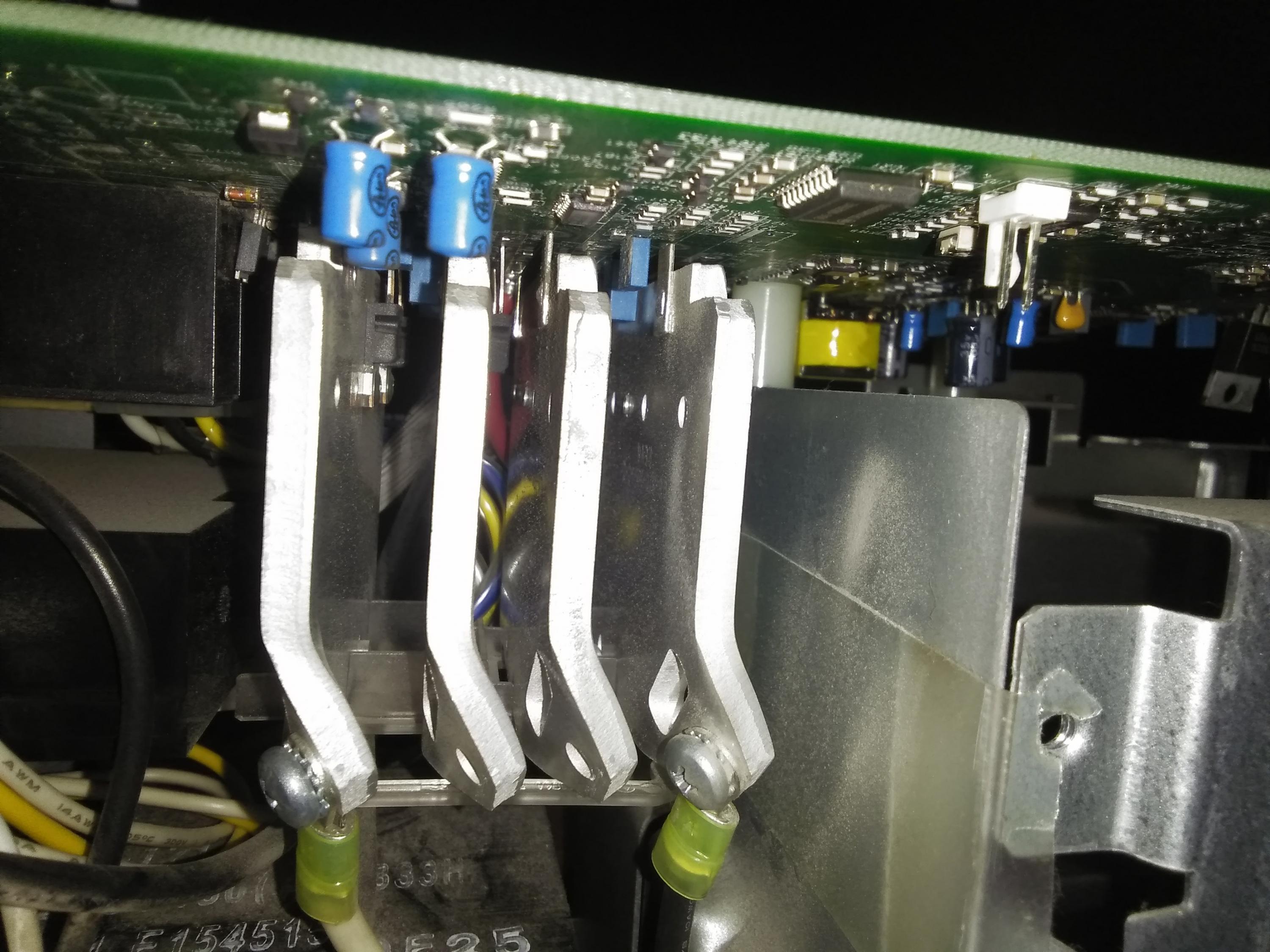

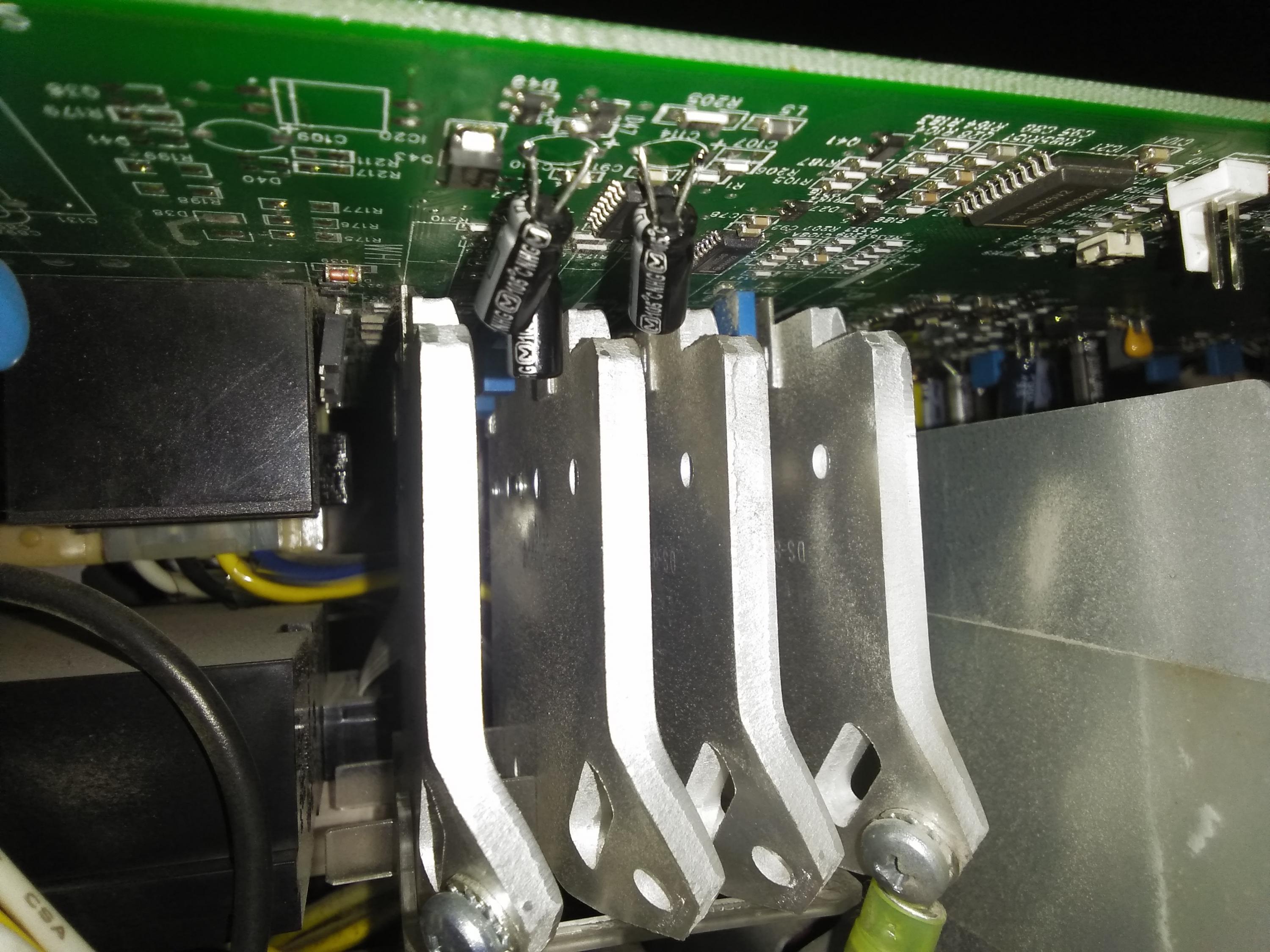

                              Result: SUA1500I still works, tested dod 100%
                              Original caps: 5x lelon sea85 h927(m) 22uF 25v replaced with pana nhg.
                              Was a pia to get some joints pumped clear. Not pretty.

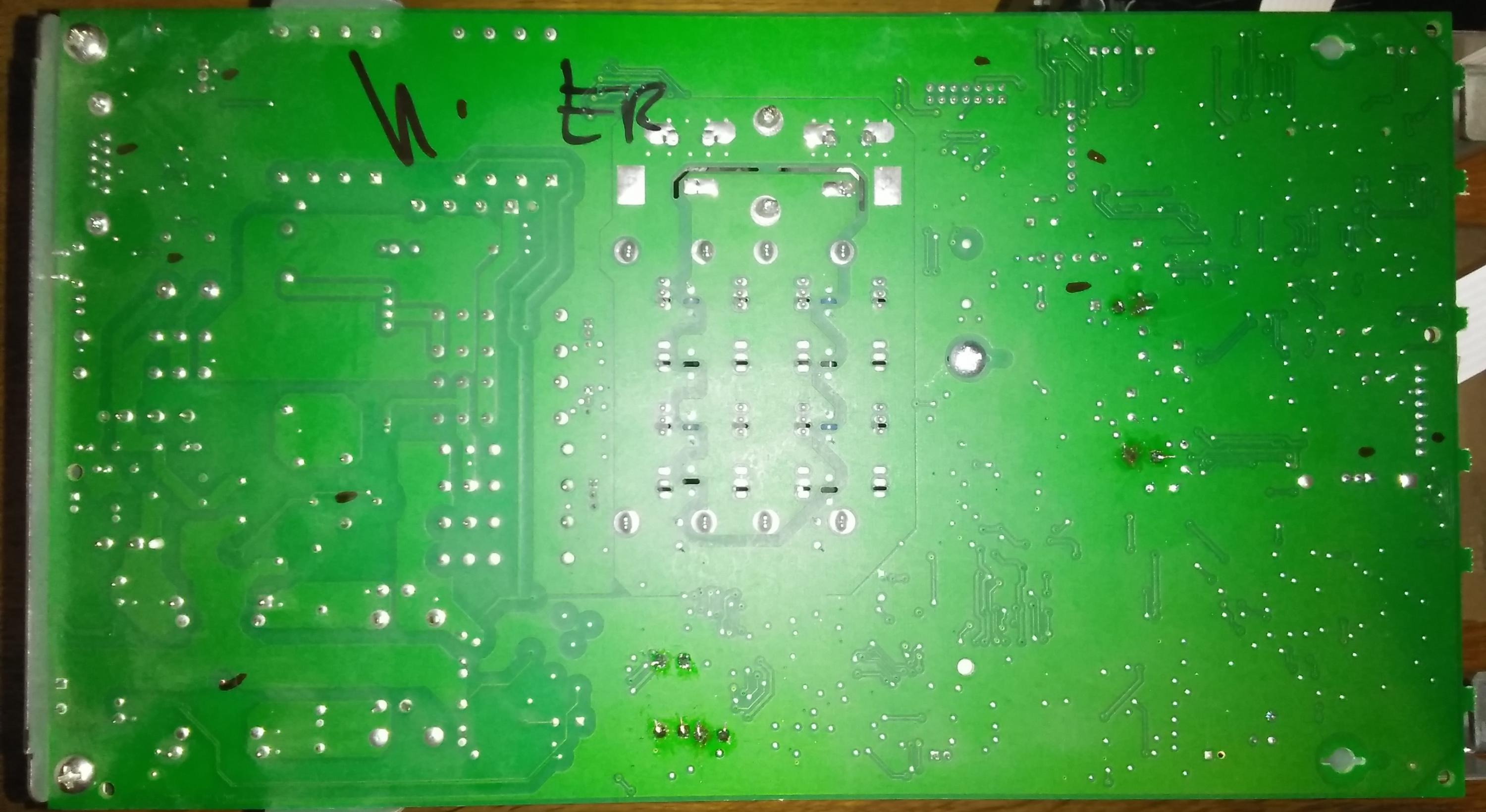

                                          Ended up here jumping links when trying to fix. My APC UPS Rs1000...
                                          I was wondering if you would be so kind to check images of my main board to see if you spot anything "fatted" or "burned down", as I couldn't find anything weird on this unit, which aside from having been stored for a few years, I performed a battery replacement in order to bring it back to life but all I can get is power from the batteries, not from the AC/wall.
                                          Already checked AC in up to the main board and fuses seem to be in good shape, so I'm a bit lost right now. All I can see posted here and there is about capacitors being replaced...
                                          Is there a way to test capacitors with a multimeter and not dying in the try? 😂
                                          Here are the pics:
                                          https://www.dropbox.com/sh/cwszg48qd...Xaxu_FPKa?dl=0
