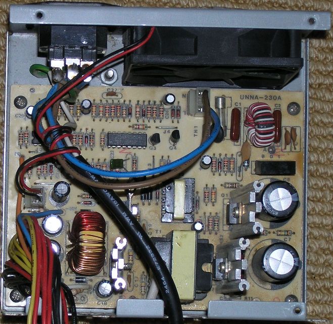

      Unbranded 200W AT unit (UNNA-230A on PCB, made in 1993)
      220uF 200V primary JP CE-TUR capacitors; the rest are GPE units (Anyone else seen GPE units?).
      1000uF 16V on +12V rail
      1000uF 10V x2 on +5V rail
      220uF 16V Jamicon TK each on -5V and -12V rails
      Non-approved capacitors used as X and Y class units .

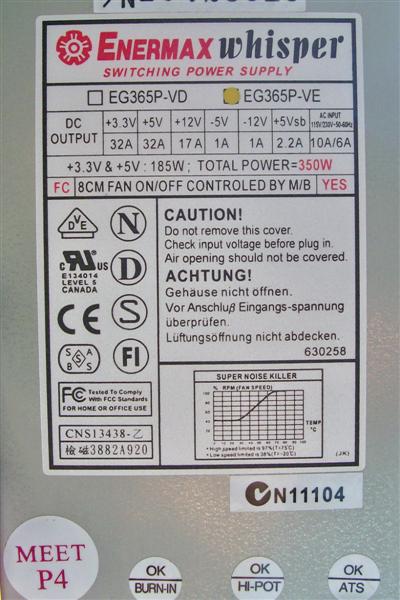

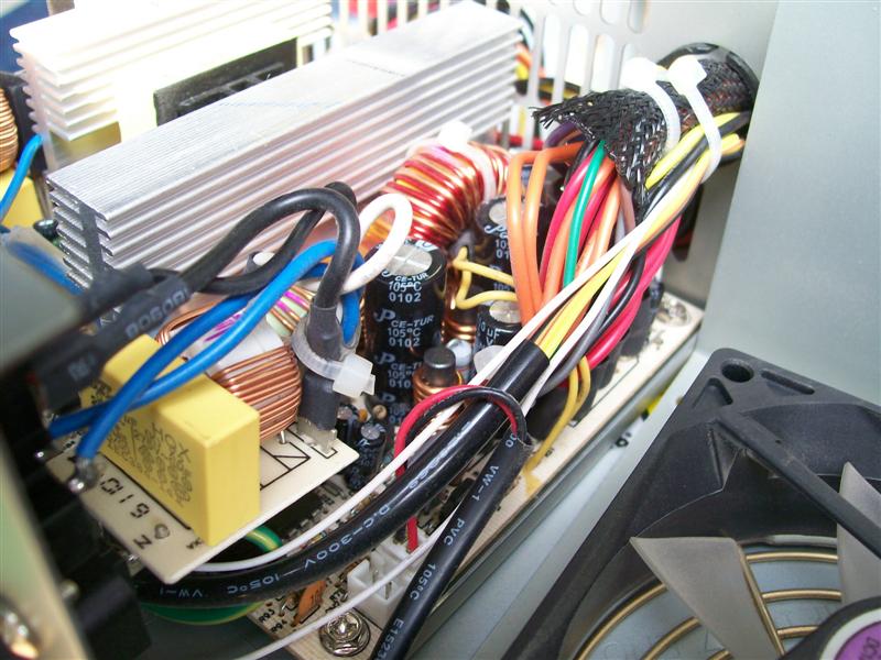

        Enermax Eg365p-ve
        ENERMAX EG365P-VE
        Not sure if this one has been posted before, think some thing similar may have
        This Supply replaced the Macase PSU and has been in service for aprox 5 years.
        (probably really due for recap)
        I have known this thing to hold the computer (AMD socket A GB recapped MB) for about a second when the mains dies and come back on
        (think they are switching phases)
        Mains DC filter caps are
        Hatachi 820 uF 200 Volt
        (forgot to write down if it was 85C or 105 C doh!)
        The rest are CE-TUR
        bit hard to tell but think the following values, didn't really try and tell which rails
        3300 uf 16V x1
        3300 uF 10V x2
        2200uF 10V x2
        1000 uF 10V x2
        330 uf 16V x2
        100 uf 16 x1
        Few misc caps of course
        chip UC 3842 hiding under mains wires (near fan) do pdf search on it if you want to know more
        LM 339 I think was there somewhere too.
        whats on the heat sinks a bit hard to tell
        Dood great idea this post Thanks
        Hope this helps someone further down the track , Cheers all

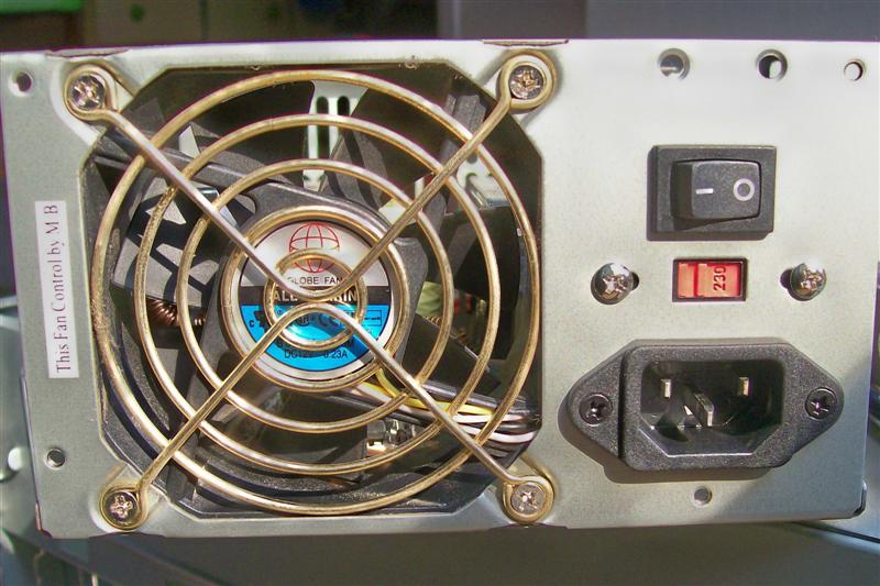

          Coba Power Supply

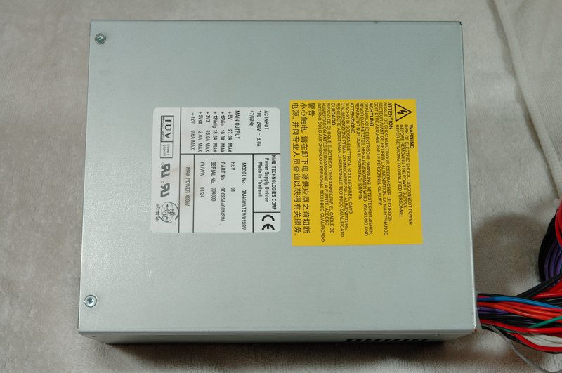

            Nmb 460w

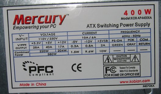

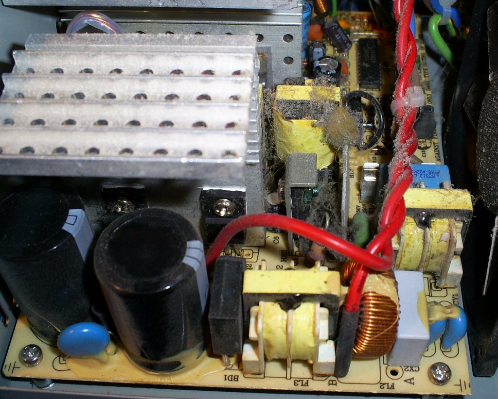

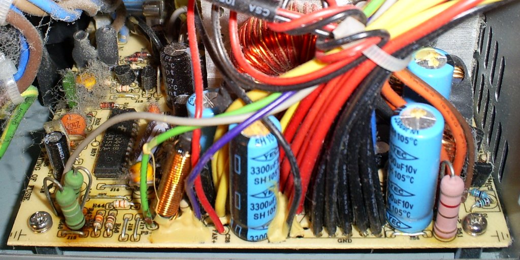

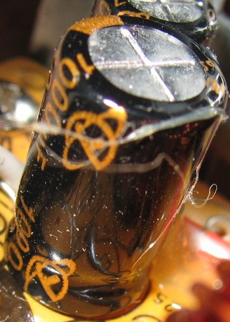

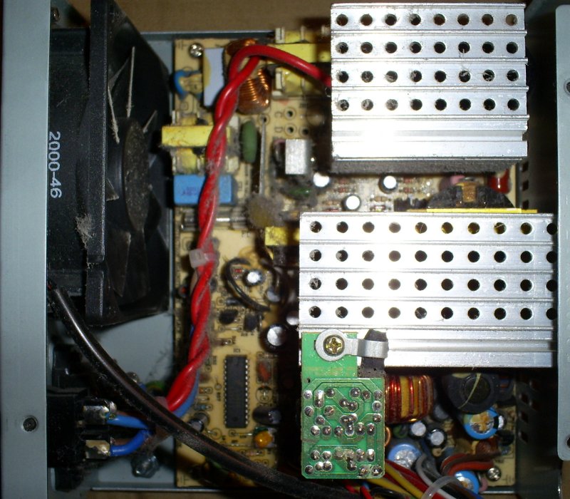

              Kobian Mercury ATX PSU, model KOB AP4400XA.
              HEC caps on the input, "F" (planet logo) caps on the output.
              Died after 8 months of service - note the vented cap by the fan.
              PC it was in kept rebooting occasionally, sometimes doing a 'bad memory' error beep code from the BIOS, and made a high-pitched squeal (like a CRT TV) when in standby mode.
              I've also enclosed the best picture I could get of the F-Planet logo; did we ever identify these?
              Also, I disconnected the PFC (mounted to the top case) to take these photos, rest assured it DID originally have one

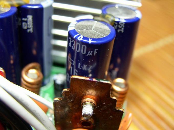

                  Built in July of 1999. If that's an NMB fan, that'll probably put out its full rated 200W for a long time. Appropriately sized heatsinks and O/P transformer and nice beefy bridge rectifier and O/P rectifiers (Lite On brand perchance?). Heavy metal is goodness.

                    Wowo, look at that copper heatspreader at the main switching transistor awsome.

                      Good eye, gonzo. The switch devices are also in TO-3P packages, much better thermally than TO-220 devices. Of the O/P rectifiers, the one nearest the camera in the one pic is a TO-3P, the center one is TO-247 (thermally similar to TO-3P), and the far one is a TO-220 device (probably the +12V rectifier).

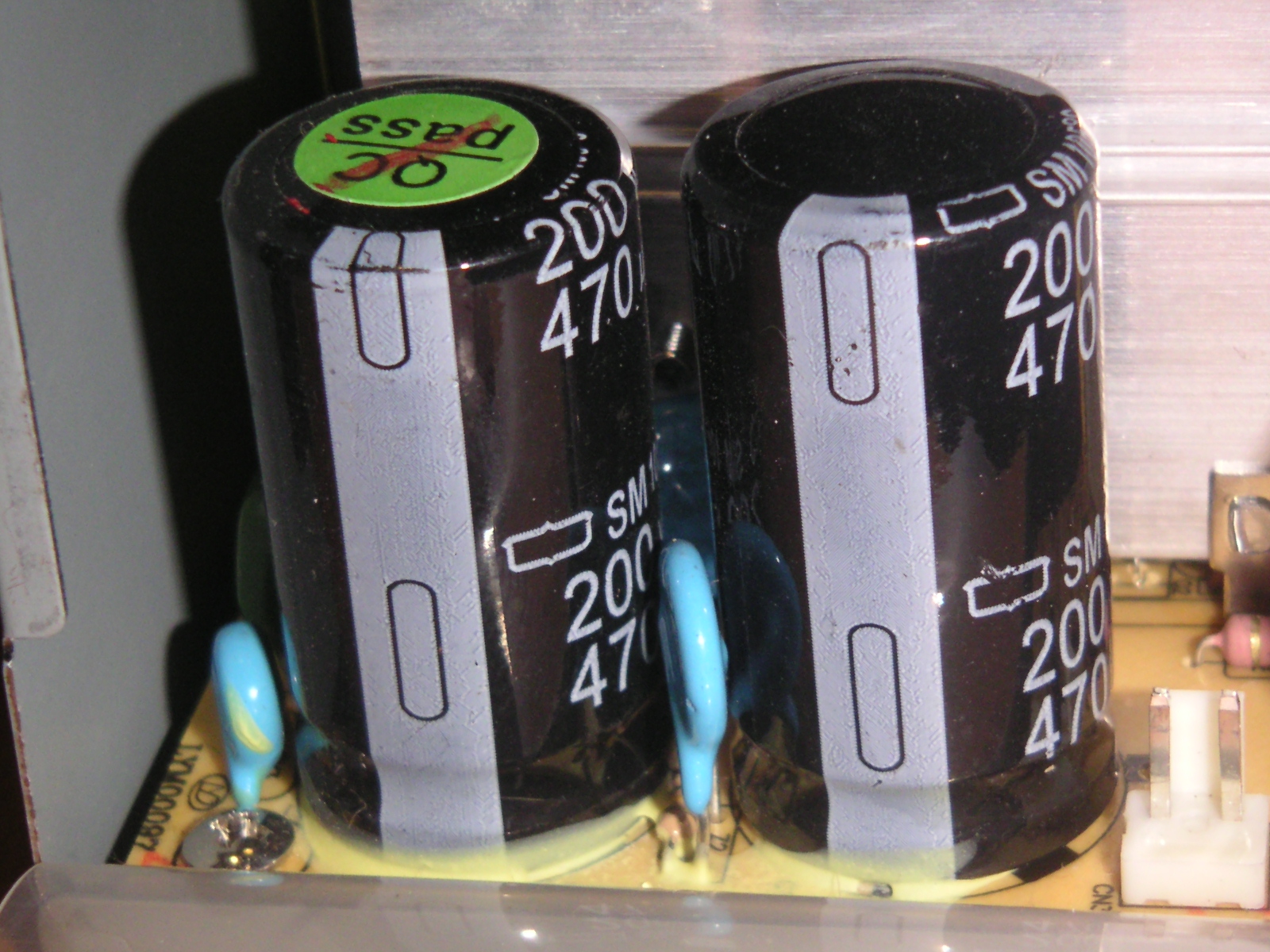

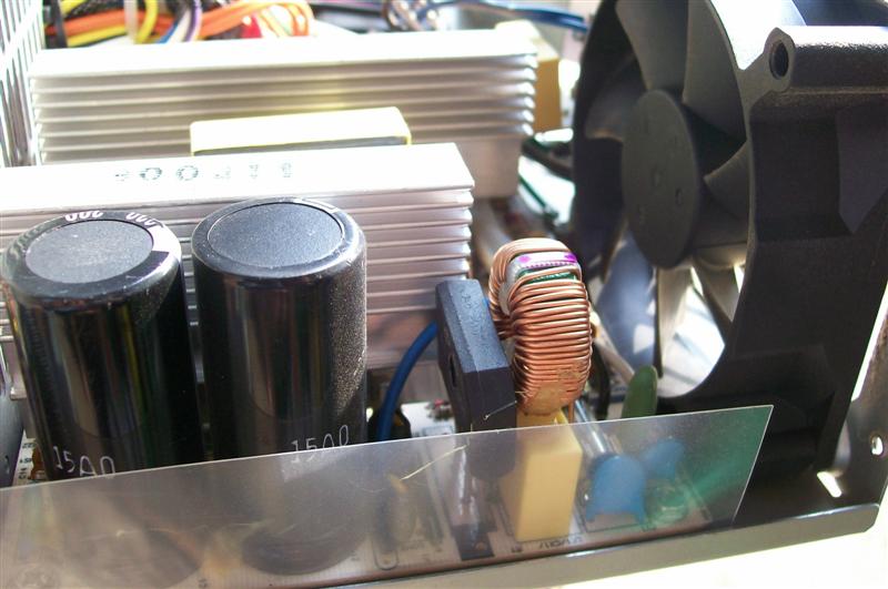

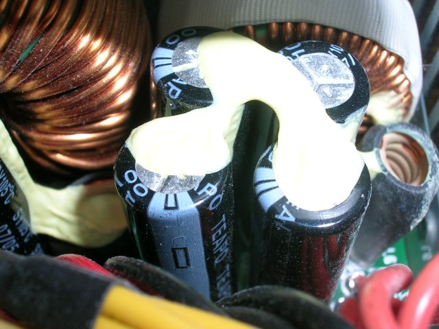

                        It's been a while since I contributed to this thread, but here's a 560W Silverstone ST56ZF, aka Etasis EPAP-560. Caps are Nichicon, Rubycon, and Teapo. Very heavy PSU.
                        Teapos on the secondary for 3.3v and 5v.
                        One of three identical primary Nichicon main filter caps.
                        Rubycon for the 12v, hidden too far in there to make out which series.

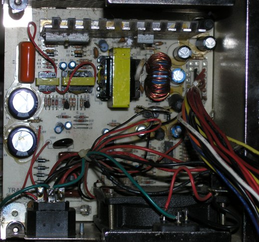

                          Trans-Am TA-300 (can anyone identify its wattage?) from the late 80s.
                          Non-approved X and Y class units.
                          Rubycon 220uF 200V CEW primaries.
                          Rubycon 1000uF 16V CEW on +12V rail.
                          Rubycon 2200uF 10V YK before and after output inductor on +5V rail.
                          Small value capacitors have brands Sowa, TMC, Huder and NKL.
                          +5V rectifier is 15A, with the +12V rectifier having a current rating of 3A
                          MJE13008 primary switching transistors.

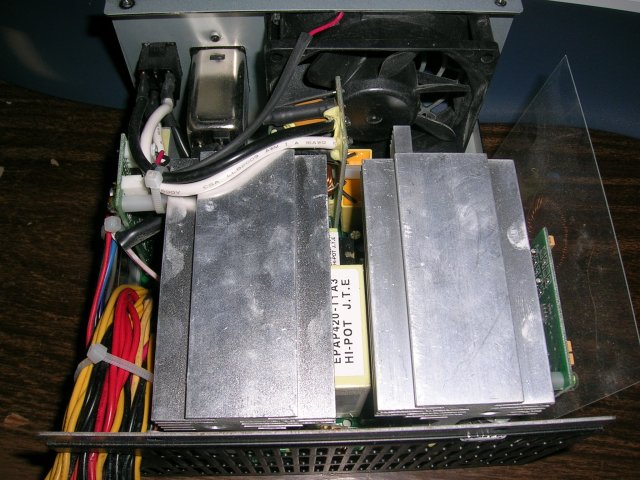

                            Astec's custom built TEC power unit. Looks pretty solid. Full of UCC/NCC and Nichion caps.

                              Guess which unit we have here?

                                Is it a 450-500W Antec SmartPower?

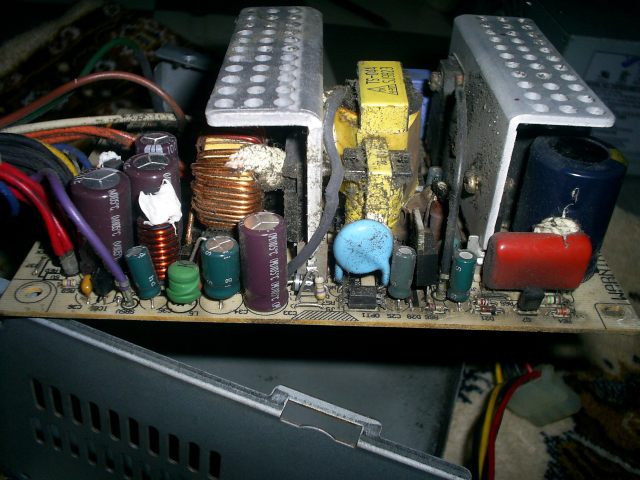

                                  Re: Power supply build quality pictorial

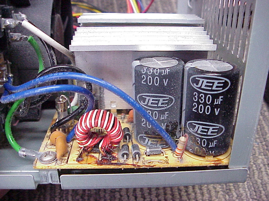

                                  sun pro "400" watt.
                                  i repaired this one.
                                  repair tool also shown.
                                  • kc8adu
                                    • Nov 2003
                                    • 8832
                                    • U.S.A!
                                    #237

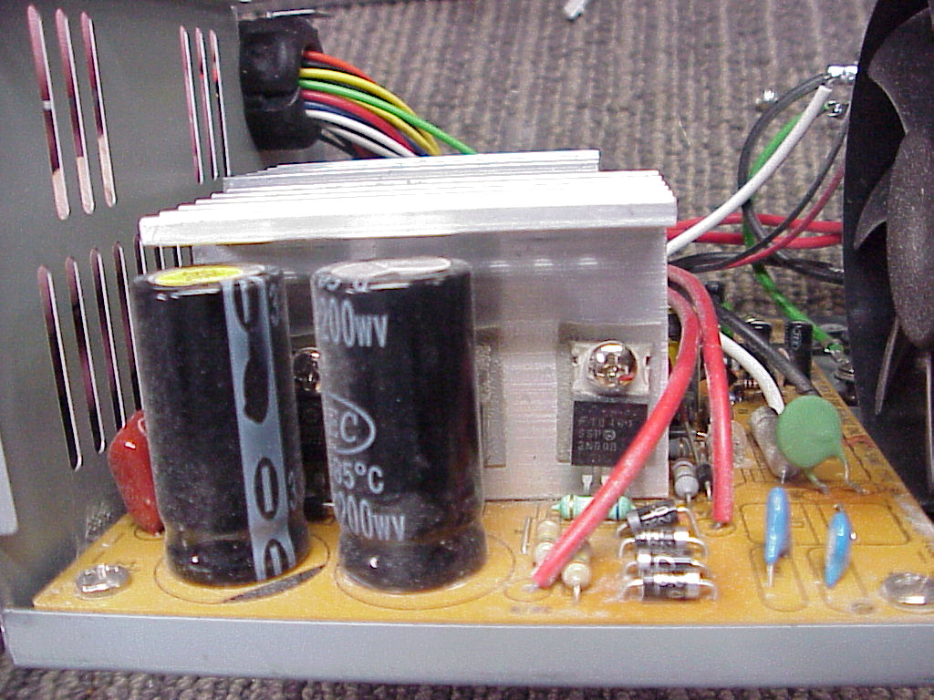

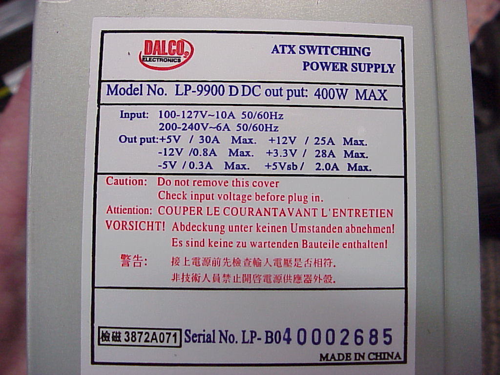

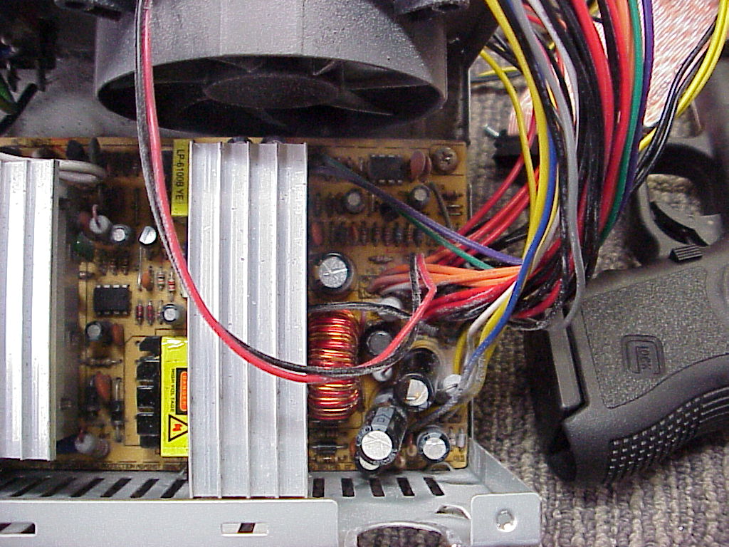

                                    dalco 400
                                    note cheong wah on board.
                                    this one will also be "repaired" by dr.glock.

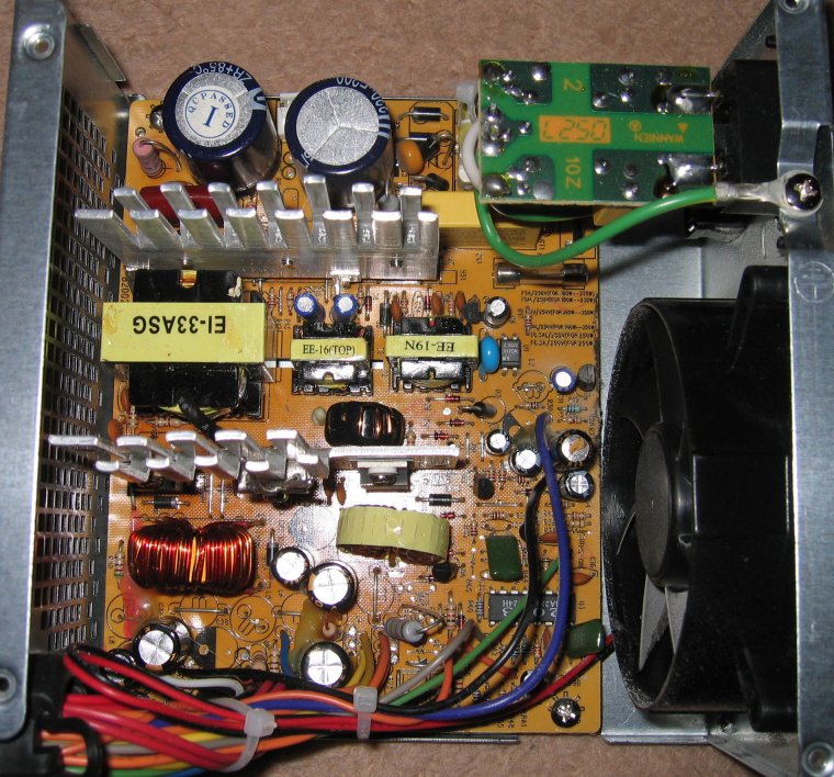

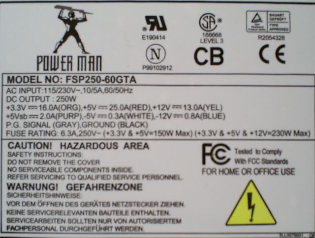

                                        InWin/PowerMan (Fortron) FSP250-60GTA.
                                        I believe there are also identical PSU's sold under the Sparkle and AOpen brands with the same model number.
                                        I have 4 of these, this one I suppose is the worst because it's putting out -16V on the -12V line. This one has 3 leaking YEC 3300uF 10V caps, so I'll probably replace those. The others also have some bulged caps, only 1 of them appears to be perfect, but I didn't actually open it.
                                        Weight including the cables and the whole casing is 3# 1-1/8oz. That should be 1.39kg if I did the conversion right.
                                        I have 2 of these on Asus P2B-F's, and 1 crammed into a Gateway 433c with Intel FJ440ZX motherboard. The other has been used for random testing and apparently the -12V line got hurt somehow.

                                          Hey, I have the same Powerman 250W. All 4 of the YEC caps in mine leaked. I believe the fact that the fan is thermistor controlled might have added to the problem. It must have overheated the caps when the fan is barely turning.
                                          Mine came from an Inwin S500 midtower.
                                          Deciding whether to toss it or recap it. Must source the small YEC cap equivalent.
