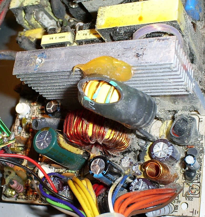

    #281
    Re: Power supply build quality pictorial
    Look at those discrete diodes on the secondary heatsink.
    Why do manufacurers do that is it cheaper to use discretes then to use the proper TO-220 package?
    Not to mention discretes in that package aren't designed to transfer their heat to a heatsink.

          #284
          seems the labor to prepare those diodes would ofset any savngs over a proper to-220 device.
          well maybe not if your products are assembled by child slaves.

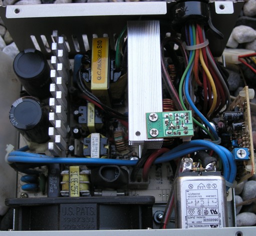

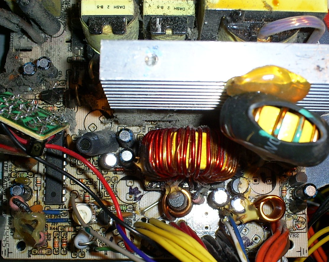

            Sparkle "Power-Q" ATX-300GU (built by FSP)
            Date code on PCB is 0445.
            After about a year, I got a phone call from my sister that her motherboard heat alarm was going off. About a day later I came down and noticed the PSU was baking, and the fan was dead. I was impressed it lasted like that.
            There's a little circuit board attached to a heatsink for the temperature sensitive fan. When I replaced the fan I gave up on trying to hook it up "properly" to that gizmo.
            I recently recapped this PSU. Mine had Teapos and Jamicons in it, almost all are general purpose 105C. None failed even with that overheating incident. One of the photos shows the strange rubber ring I found underneath the 3300uF Teapo. It's not the bung - the cap was still intact.
            There's 1 16V cap in there, and it's a difficult size, 2200uF 10mm IIRC. Lesser voltage caps are also still 10mm, so they're easier to replace.
            Input caps are 2x 470uF 200V Teapo LXK, as can barely be seen in the overhead photo.

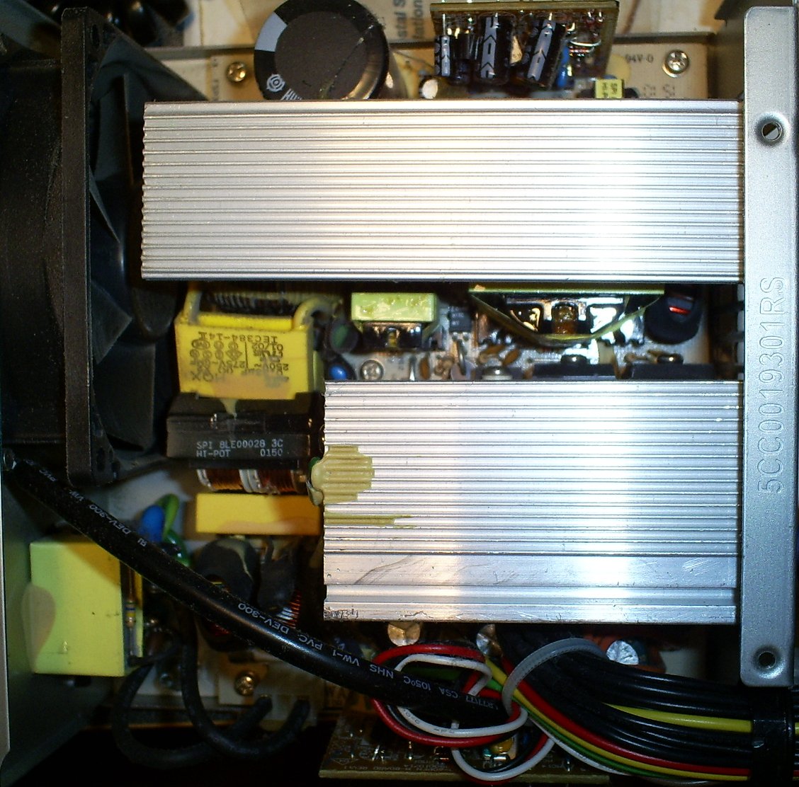

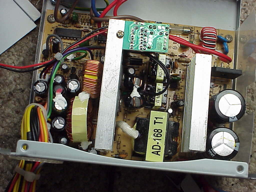

              Fortron/Source FSP300-60PFN(12V)
              Date code on PCB is 0151
              This is apparently one of those newfangled jobs with 1 input cap. It's only 220uF - is that normal?
              I just got 4 of these, but only this one has been opened yet. This PSU has many Fuhjjyus in it, especially on the input side. Output has 1 Fuhhjjwhatever, 1 OST, and a few Teapos.
              They hot glued a vertical PCB at each end. Looks kind of ghetto, but I guess it works.

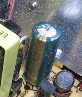

                      Ipex/Seventeam ST-251R
                      Rubycon USR 470uF 250V primaries; the rest JP CE-TUR.
                      2200uF (bulging) on the 12V rail.
                      2200uF 10V before and after the output inductors of the +5V and +3.3V rails (the capacitor after the +3.3V inductor was bulging).
                      The capacitor before the +5VSB regulator was bulging too.
                      D83-004 rectifiers for all rails (two in parallel for +3.3V)

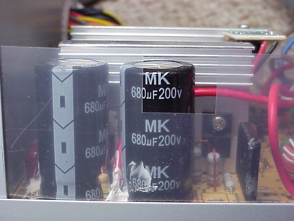

                        Here's the PSU that I had in my newest PC until it died (see the Whistling PSU thread). This PC sure seems to be going through a lot of PSUs!
                        X-Power ATX-400D 400W Dual-fan
                        This PSU is packed with Teapos everywhere, both on the input and output. For those who say Teapos fail without physical signs, these sure didn't! Three of the Teapos on the output side have bulged, with one actually exuding a small amount of electrolyte. I've also included a close-up picture of the Teapo that's leaking.
                        You know there's something wrong when you open your PC and it has vented Rubycons...

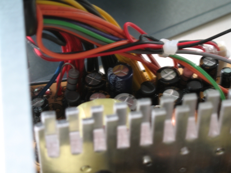

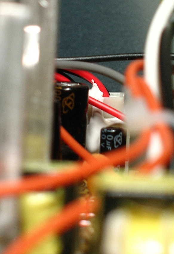

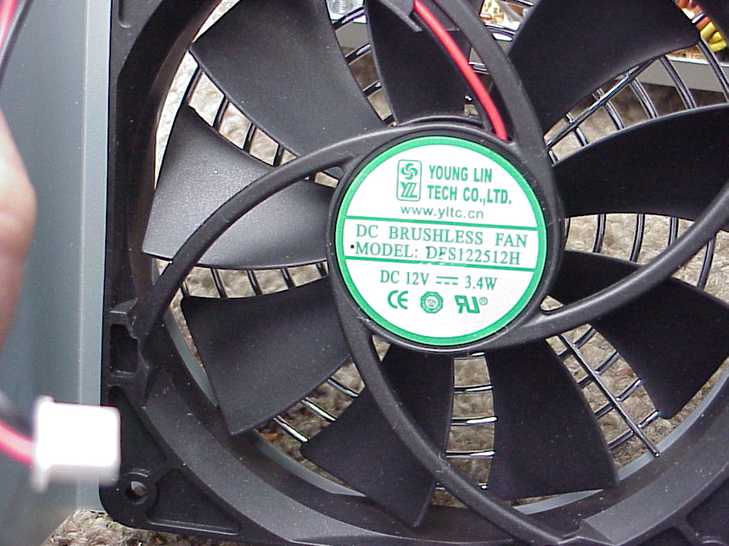

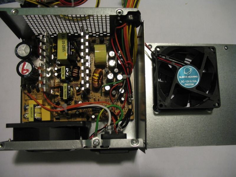

                                    Allied 350W: am I blind?
                                    After reading this thread and watching all photos I decided to open the Allied 350W I bought some months ago as spare PSU for testing purpose.
                                    I have lost the warranty because I have broken the label... but I couldn't resist .
                                    The big surprise for me is that on the box they write PFC-MATCHING THE SPECIFICATION OF THE POWER FACTOR CORRECT OF EUROPEAN UNION 2001
                                    Somebody can show me where is the PFC? I can't see it .
                                    I suppose the Asia X output caps aren't good, am I right?
                                    I have another question: what is the brand of the caps in picture allied3?
                                    To end the post: the only good thing I see in this PSU are the 2 fan .
                                    I have spent 26,00€.

                                      #298
                                      well. i guess in 2001 thetre was no law for pfc so they didn't put any in...hehe...
                                      this psu has no pfc. active of passive.
                                      yes, asia x is crap(somebody mentioned it on this forum, do search), and this reminds me of this
                                      https://www.badcaps.net/forum/showthread.php?t=5727
                                      for 26€ i get fortron ( https://www.badcaps.net/forum/showth...hlight=fortron ) that looks like tank comapred to this "gutless wonder" as kc likes to call them...
                                      your only excuse for buying this can be that you were not reading this forum at the time

                                        #299
                                        no pfc there.
                                        not even a cheap choke.

                                          #300
                                          Re: Allied 350W: am I blind?
                                          Welcome to psu hell
                                          In factory: the guy at the assembling line forgot to include it.
                                          Absolutely right: Asia X is a new name for Fuhjyyu, which is the crappiest badcaps brand known to present day. Good only for shooting.
                                          It's usually called Saturn logo, but the real name should be YC (even guys from capacitor.web aren't sure about it). Better than Fuhjyyu, worser than all others. My old Allied DR-B400BTX was full of these craps.
                                          You have an I already saw it feeling, right? Me too: it's a clone of yours.
                                          Cheap sleeve bearing ones: they become noisier over time until they fail. Don't put them into your friend's P4 unless you want to replace them in a year or so.
