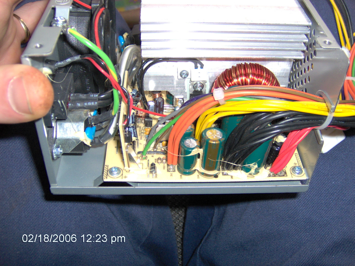

    Topower TOP-420P4(420PII) 420watt server supply
    Active PFC couldn't save this from bad caps... and I don't think a recap will be possible with where the caps are located.

          • kc8adu
            • Nov 2003
            • 8832
            • U.S.A!
            #85
            Re: Power supply build quality pictorial
            makeit easy.desolder all the rectifiers and heatsink mounts.pull heatsink/rects as a unit.
            recap.reasemble.
            i can do that in less time than it takes to pull/install caps with hemostats.

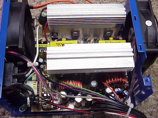

                • Spacedye69
                  • Nov 2005
                  • 698
                  • US
                  #88
                  Hipro HP-D2537F3R Compaq OEM
                  +5v 25A, +12v 14A, +3.3v 18A
                  MAX POWER 250W
                  Tested good. All Teapo caps. 560uf primary, 3300uf and 2200uf 16v, couple 2200uf 10v, big size 6.3v but cant read uf.
                  Much heavier than most my other ps.
                  Last edited by willawake; 02-18-2006, 12:53 PM. Reason: inline pics too big, original sizes remain in thumbnails for those interested

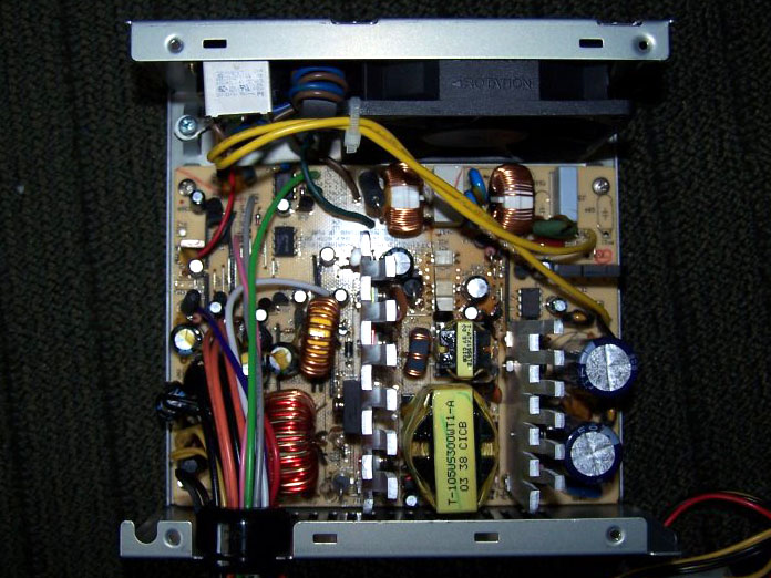

                  • kc8adu
                    • Nov 2003
                    • 8832
                    • U.S.A!
                    #89
                    okia 450w
                    • PeteS in CA
                      • Aug 2005
                      • 3583
                      • USA, Unsure of Planet
                      #90
                      With those wimpy thermistor, I/P rectifiers, main O/P transformer and heatsinks, 250W from that might be pushing your luck. Those I/P lytics look like they might be a bit wimpy, too. That non-existent line filter should make you popular with your neighbors.
                      PeteS in CA
                      • kc8adu
                        • Nov 2003
                        • 8832
                        • U.S.A!
                        #91
                        that okia unit was in a p4 2.8 with 6 hdd,2 opticals and lots of lights.
                        +5 was running 4.35!
                        it got hot enough to stink.
                        got a worse one than that to post later!

                              • Spacedye69
                                • Nov 2005
                                • 698
                                • US
                                #95
                                Looks similsr to the 250w Hipro I posted, but on mine all big o/p caps are the green Teapo. Over 1 year old and none bad.

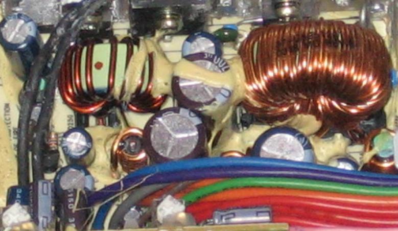

                                • tiresias
                                  • Feb 2006
                                  • 489
                                  #96
                                  As promised in the other thread, a top-down shot of the Liteon PS-5651-1A1, as marketed by Supermicro under the name PWS-0060.
                                  All the meaningfully large electrolytics are Chemicon and Taicon, although if you look carefully you'll see one tiny, but definitely ugly, little OST staring back out at you.

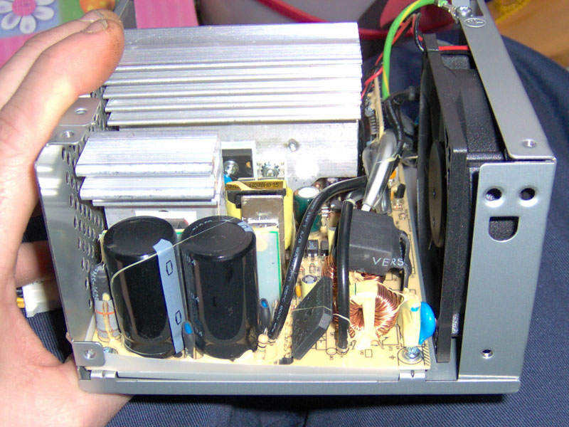

                                  • Rainbow
                                    • Aug 2005
                                    • 1375
                                    #97

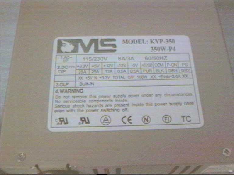

                                    MS Industrial KYP-350
                                    JEE cap bulged on +5VSB line. Output voltages were very low under load and hissing sound was coming from inside. There were also 2200uF JEE caps on other outputs - no bulging but changed them anyway - did not help. It turned out to be bad TL494 chip.
                                    (photos taken after repair)
