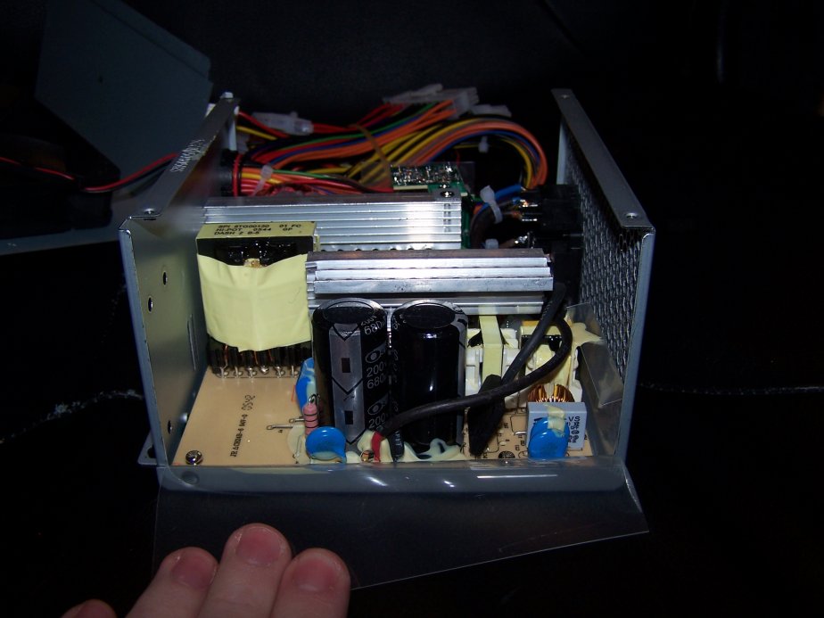

Sparkle Power FSP200-61GT 200watts total output. Looks a lot like the other Sparkle I posted above...

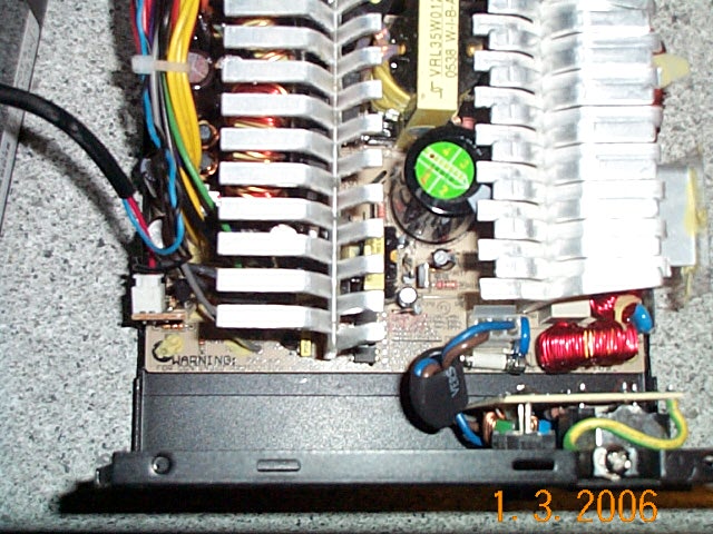

Skyhawk CTX-400WCE - 330uF 200V CapXon caps on primary (inadequate), inadequate heatsinking and rectifiers, "GL" capacitors (CD287 series) - none bulging, but unit does not work. "DEER" is printed on PCB.

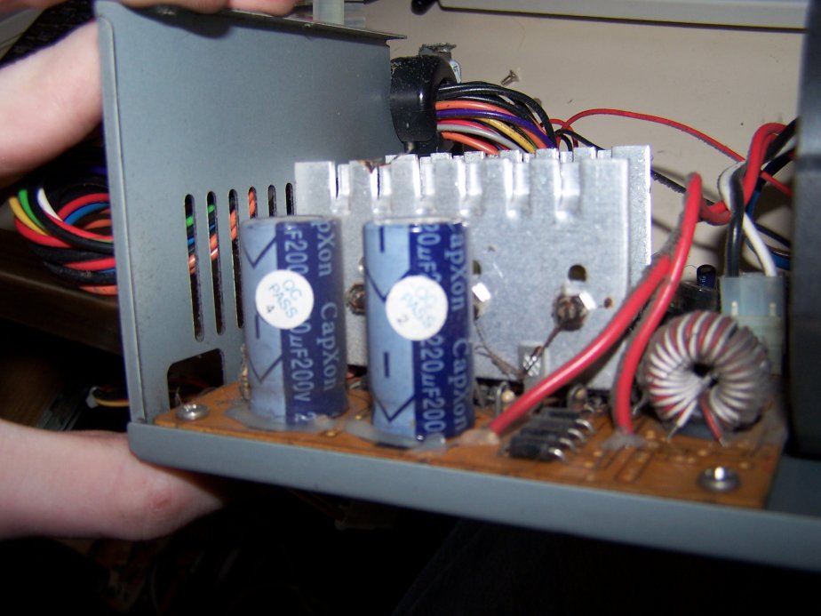

Most of the caps in this PSU are Capxon, from the biguns to the littleuns. Still works fine, and has been in service for a good many years in a P-III 500mhz system. I've taken to opening every PSU that comes through here that's no longer under sealed warranty!!!Attached Filesif you find these attachements useful please consider making a small donation to the site

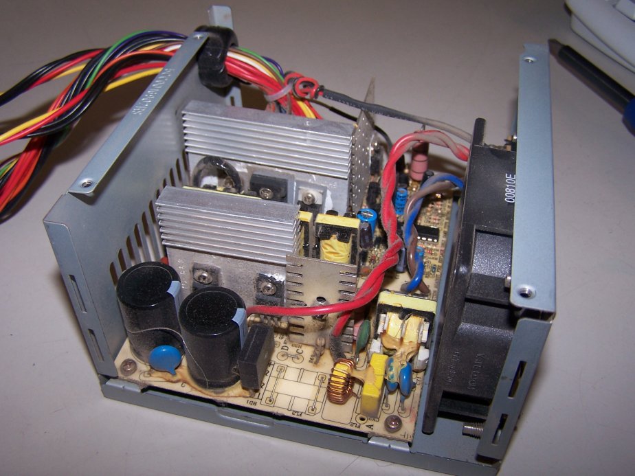

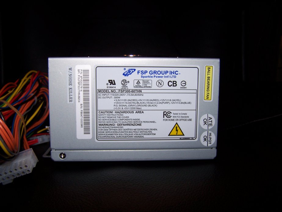

Sparkle (FSP Group) FSP300-60THN 300w PSU
Only down side I see is that they don't appear to have used that great of caps... OST on the main input side, and a combination of OST, Teapo and some others on the output side... not very impressive for something that's supposed to be a decent PSU. I like the big, quiet 120mm fan, but I think that a through and through air pattern cools better (in the one end and out the other, instead of having to make a 90* turn in the middle...).
Anyway, that's my new entry...Attached Filesif you find these attachements useful please consider making a small donation to the site
