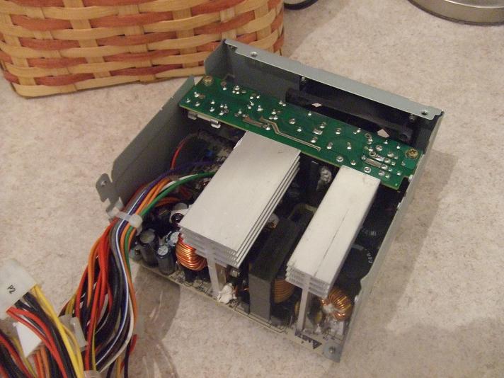

                        Micase WR300
                        Micase WR300
                        Jee everywhere:
                        Jee 330uF 200V (CE.W, 85C)
                        Jee 1000uF 10V
                        Jee 2200uF 16V
