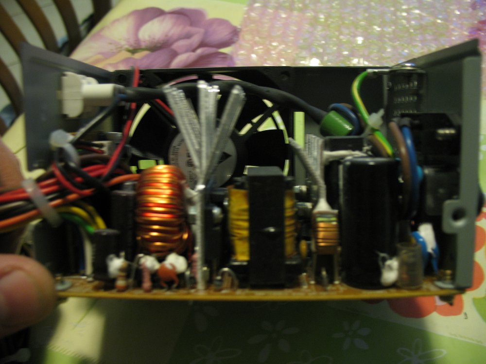

    already posted in the discussion thread...

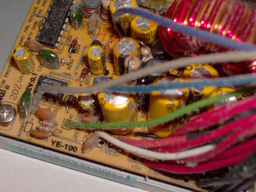

    noname PSU rated for "520" watt (partly disassembled, but anyways...)
    http://bambooz.pytalhost.net/WHF/Bil.../520Watt_1.jpg
    http://bambooz.pytalhost.net/WHF/Bil...520Watt__2.jpg
    350ATX ...?! smells *really* fishy.. and thats probably the peak wattage this POS can do..
    http://bambooz.pytalhost.net/WHF/Bil...520Watt__3.jpg
    Zhifa? Zhila? Zhi.... whatever..
    http://bambooz.pytalhost.net/WHF/Bil...520Watt__4.jpg
    this thing already went into the trashcan..
    i wouldn't even use this thing any of my old Pentium 3 PCs.. lol
    for the records: that UL number on the label leads to L & C Power according to jonnygurus database..
    L & C TECHNOLOGY INC
    E164554
    L&C, Apex/Allied, Austin, Deer. NOT to be confused with "LC-Power"
    see here:
    http://www.jonnyguru.com/modules.php...ory&ndar_id=24
    UL Number: E164554
    edit: looking at the label again.. that german part is just horrible..
    they used AOU instead of ÄÖÜ and it should be Kundendienst instead of Kundndienst.. lol
    looking at those "caps"... "LOW 105°C" ...!?

      #342
      Re: Power supply build quality pictorial
      Not too bad for 200-250 watts tops, of course if it had nice caps and filtering. But it seems ridiculously overrated for 520w.
      Still, though, you shouldn't throw it in the trash can. They put out a lot of bad contaminants in groundwaters, even at good disposal sites.

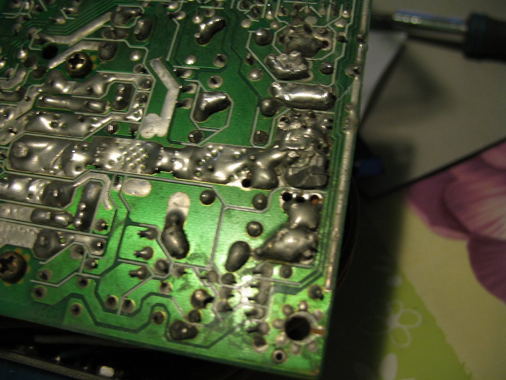

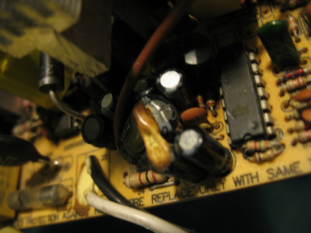

            Antec True380 380watt ATX PSU
            Bad Fuhhhjjjweruuyyyyuuu's
            The Panny mains almost feel a little bulged, but it could just be a fluke.
            Three more bad Fujjhuurrrrkkuu's
            Way too much flux residue... bad solder
            Closer... looks nasty.
            All better.
            Took me the better part of an hour to get it completely recapped and resoldered.
            Ludicrous gibs!

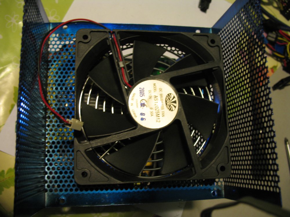

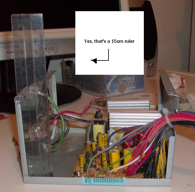

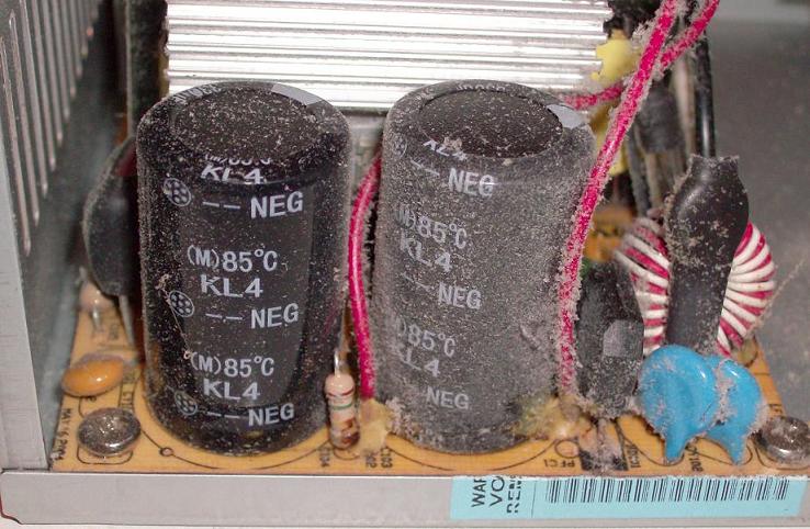

              Young Year 350W ATX PSU
              The label
              Top View
              Tiny lil' thing eh?
              Yellow caps of some sort. The picture's kinda poor but most of the caps are leaking.
              Big caps. I have no idea what brand they are.
              This PSU's wires are 20AWG and fairly short.
              It's extremely light and it's casing is extremely bendable. I've warped the casing beyond repair just by opening this thing lol.
              The absence of a fan is because I ripped it out and used it for something else. This PSU has never been turned on without it's fan though.
              It's fan is an 80mm Yate Loon Sleeve bearing fan "D802SM-12"
              Fairly loud.
              For those wondering, this thing still "works". It was used for 5 1/2 years without any noticeable trouble.
              I can't imagine how unstable the voltages and ripple were though.

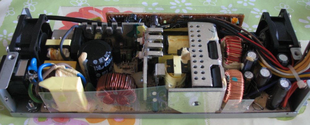

                        #351

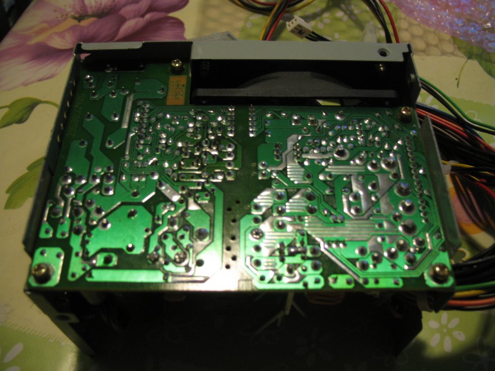

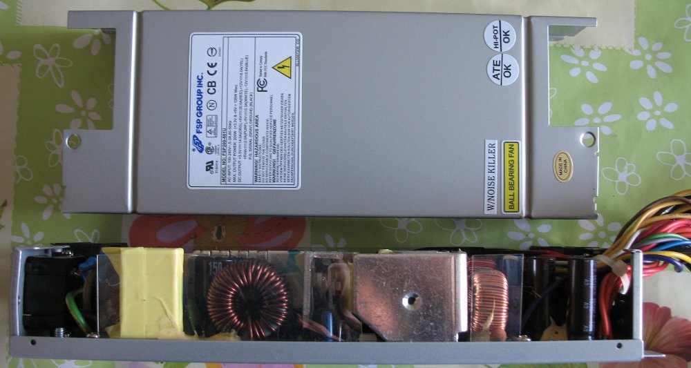

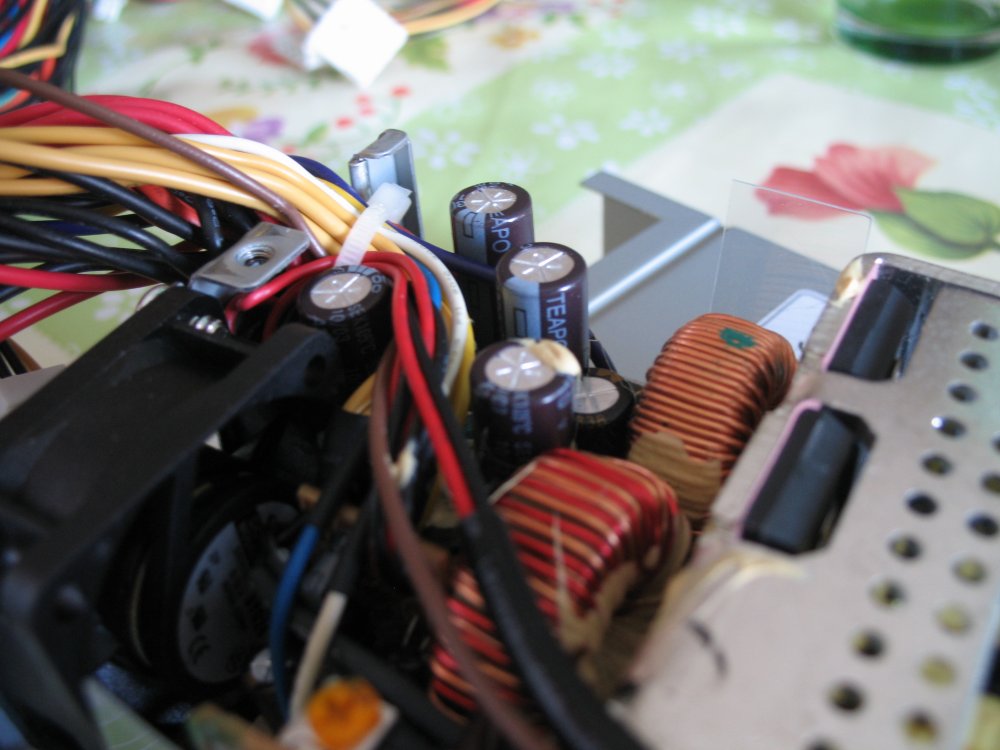

                        FSP200-601U
                        A colleague gave me this slim PSU, 200W 2 FAN and Teapo caps.
                        Ciao
                        Gianni
                        "In the confrontation between the stream and the rock, the stream always wins...Not through strength, but through persistence."
                        H. J. Brown

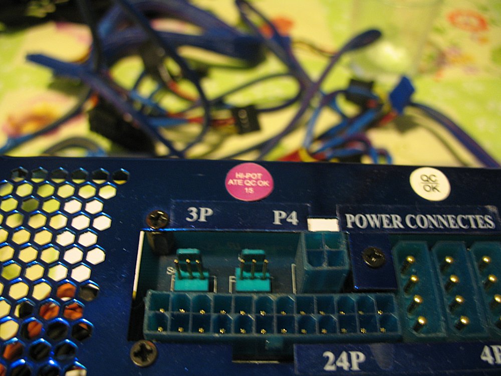

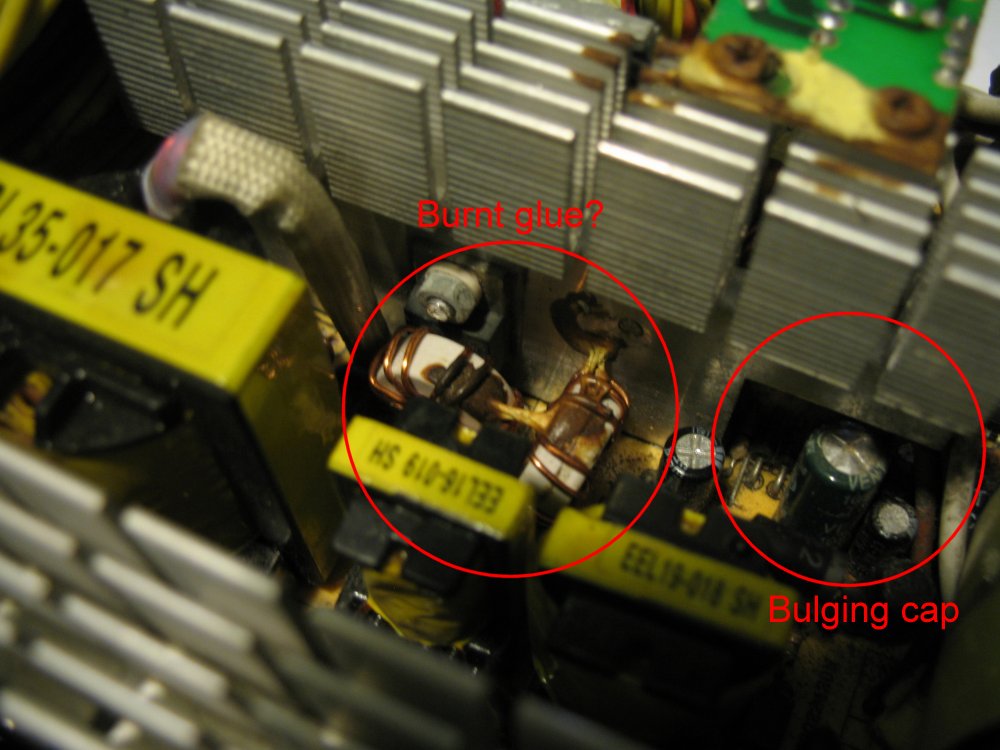

                            #353

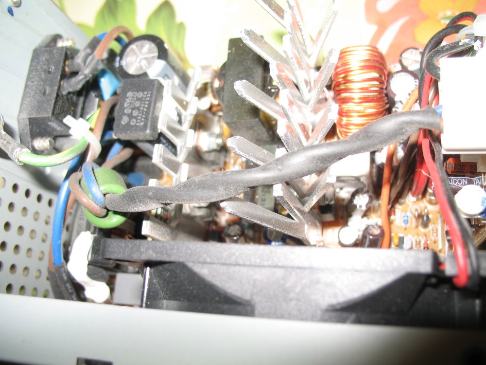

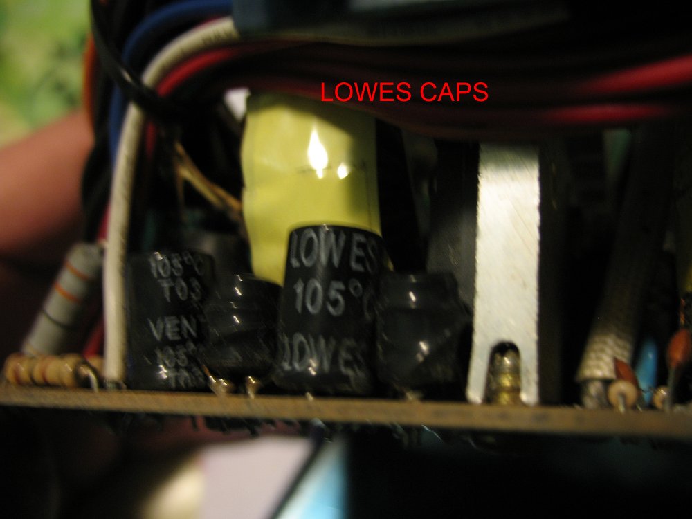

                            Me and other parents are helping our children's school to renew the computer room.
                            One parent gave me a Techsolo PSU and said it is working but sometime gives problem with the mouse
                            I opened it and found a lot of bulging caps. Some caps brand are new to me: Jenpo and Lowes.
                            The PSU looks nice, it is blue and it is a modular type but I'm wondering if it is worth to recap it because I don't think it can give 400W
                            I want to use it with a AK77 MOBO I'm going to recap, tomorrow I will post some pics of it.

                            • zandrax
                              Hit and miss
                              • Dec 2007
                              • 1157
                              • Italy
                              #354
                              I'd like to see the whole pcb: heatsinks are substantial, cables seem average (AVG 18?), sloppy soldering and bad caps. Don't know if pfc is present, I doubt anyway, but if the rectifier is a mosfet and not the cheap 4 diode pack and the emi filter hosts all pieces then I'd keep it: an honest 250-300 W which is good for your Athlon system.

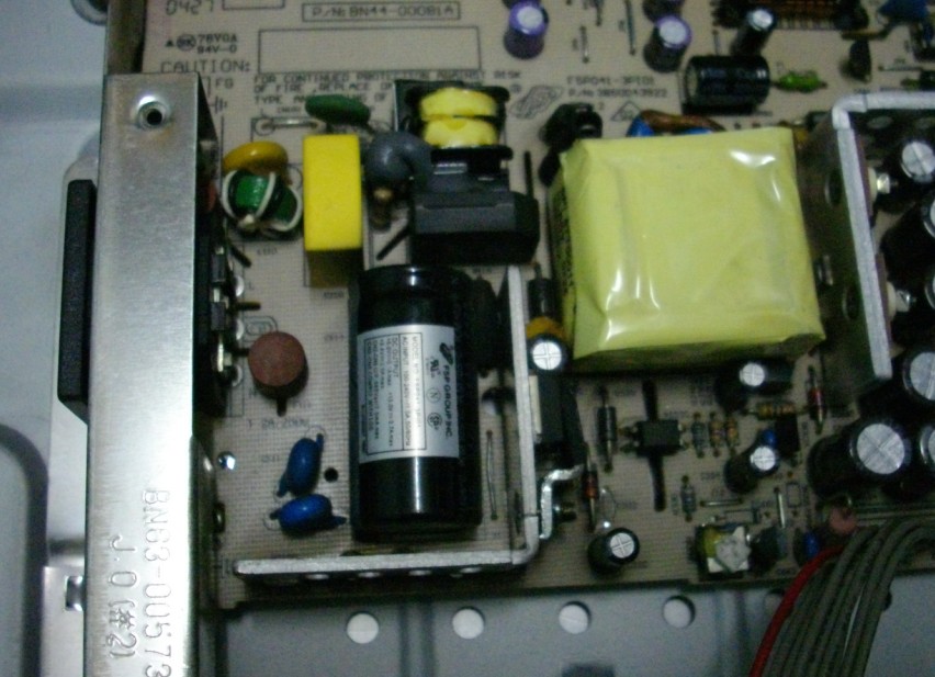

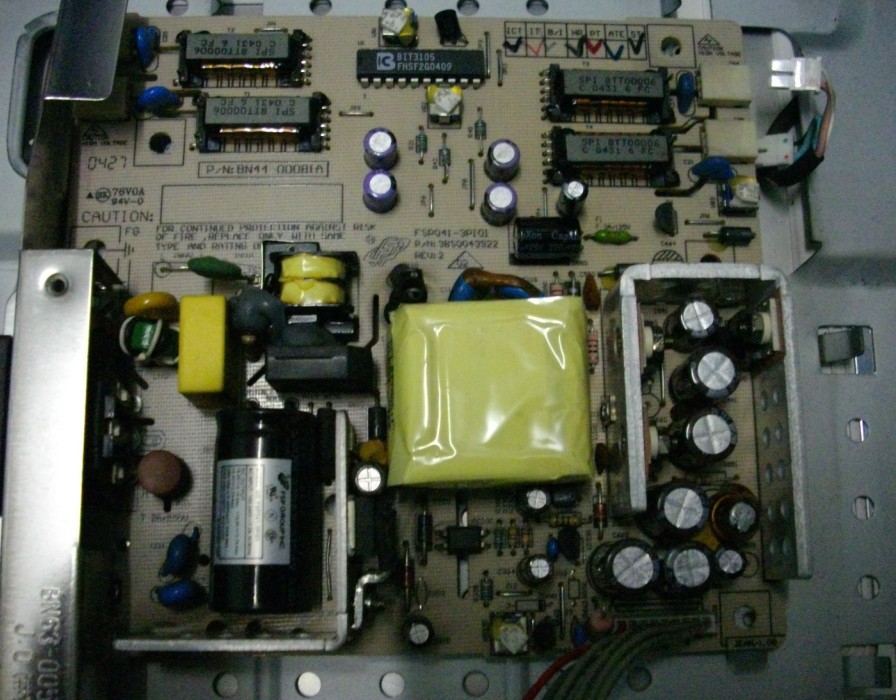

                                    Dell 1504FP LCD with a FSP-041-3PI01 power supply board. The monitor goes dark because one of the back light transformers is bad. The custom wound Sparkle Power SPI 8TT00006 transformer with the (X) on it needs replacement.
                                    The board revision is different. The date code moved. A logo below the date code changed. Several parts in the PWM have been changed or moved.
                                    I don't think I've ever seen a board other than this one that fuses both incoming lines which definitely makes sense for 220v operation.

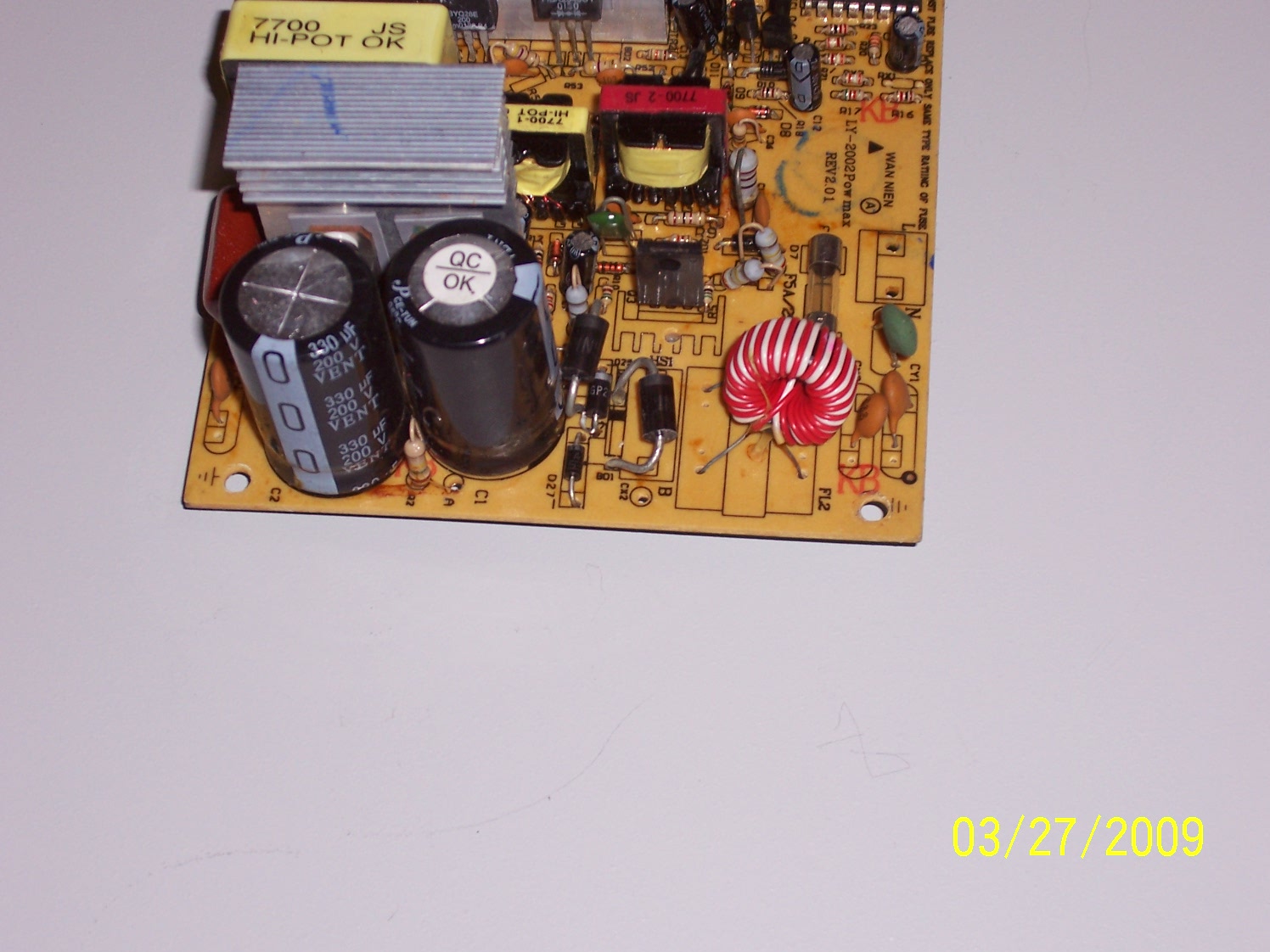

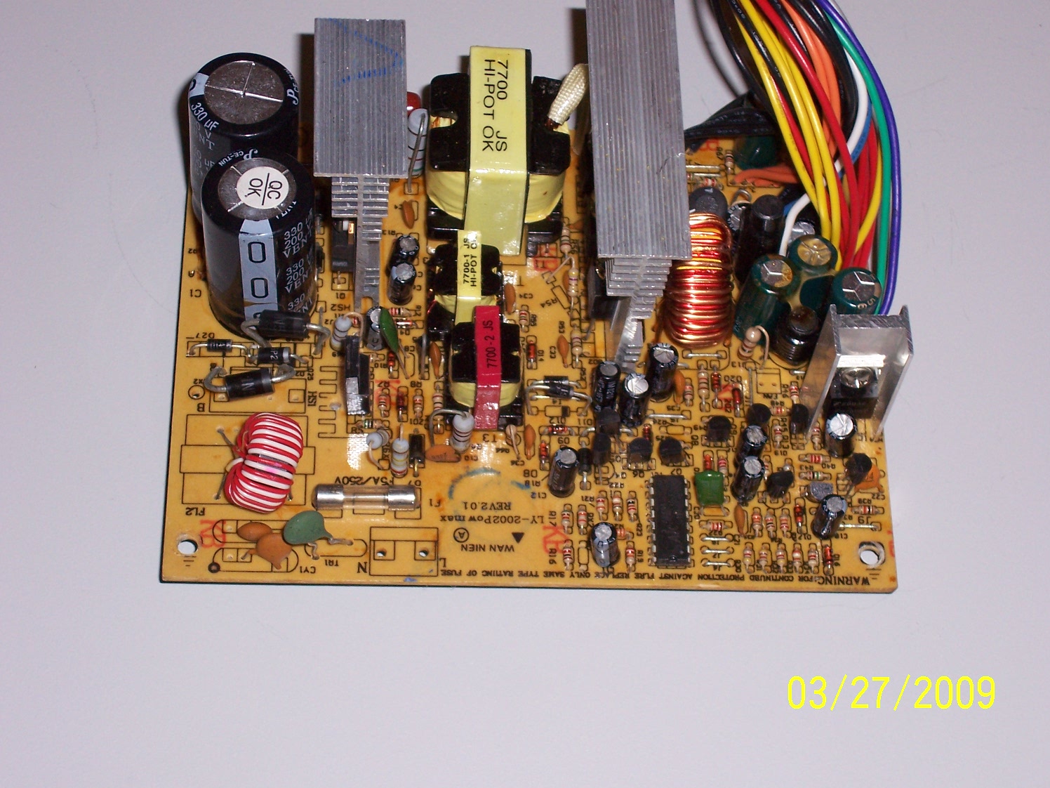

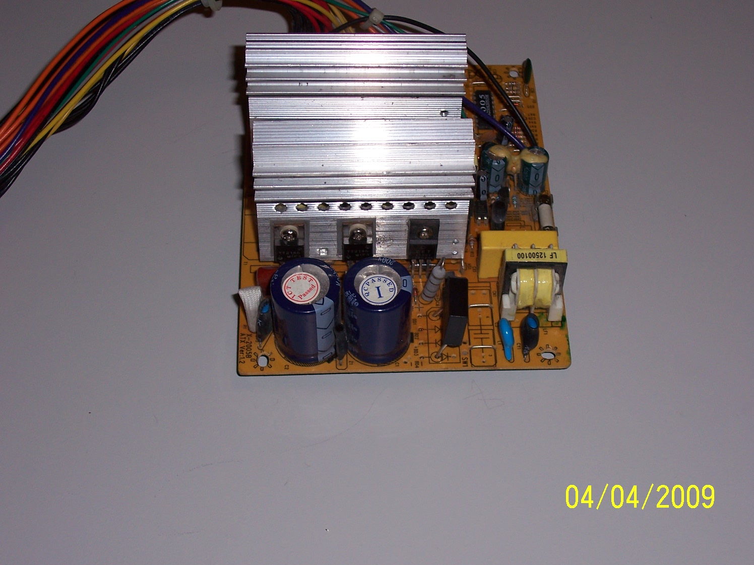

                                      PowMax LP-7700D 350 watts(?) ran in one of my computers six years - never failed but pulled when I found out about PowMax quality!
                                      Old proverb say.........If you shoot at nothing, you will hit nothing (George Henry 10-14-11)

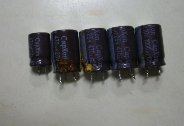

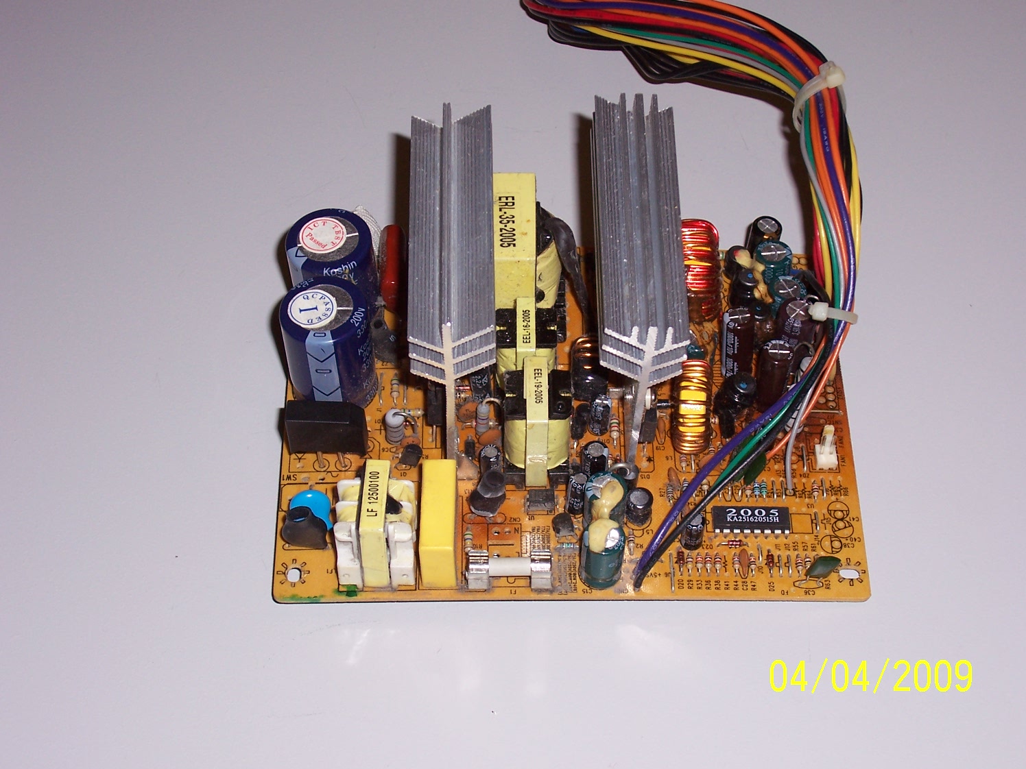

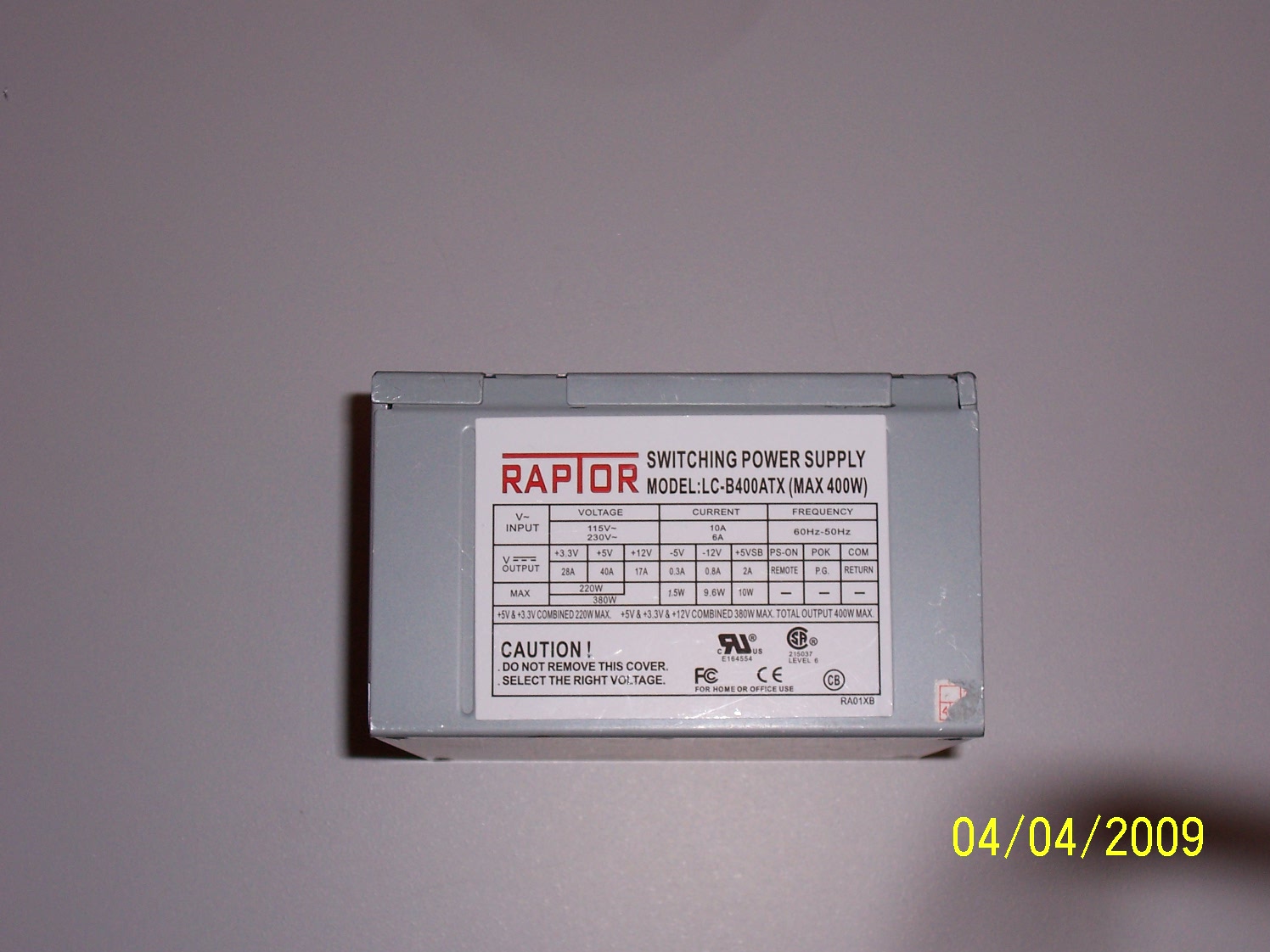

                                          Raptor LC-B400ATX 400 watts(?) 2 bad 1000uF caps replaced and 2 diodes in bridge were shorted, replaced with a one piece bridge rectifier - probably another PowMax class power supply
