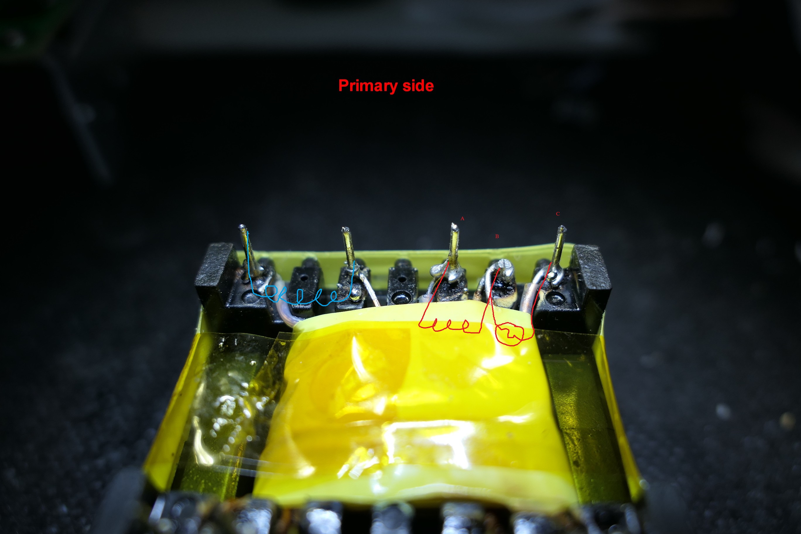

    Is this one from attach?
    Please write the reading you get on each coil, say 3 red, 1 yellow...
    So, it is 3 coil
    Primary main
    Primary aux
    Secondary out

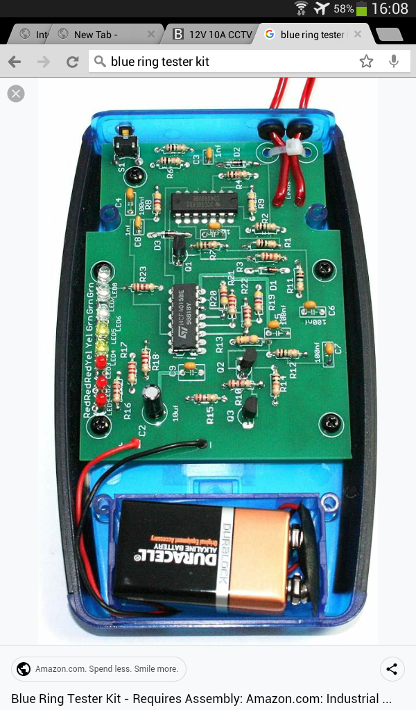

    What is resistance of each coil, and value of ring tester, and if you have transistor tester for inductance...
    Suspicious is primary main coil...
    Secondary output coil may have only few turns and appear in short?

      Yes that is the blue ring tester I have. Attached are photos of the primary and secondary side of my transformer. Can you pinpoint where I should measure?

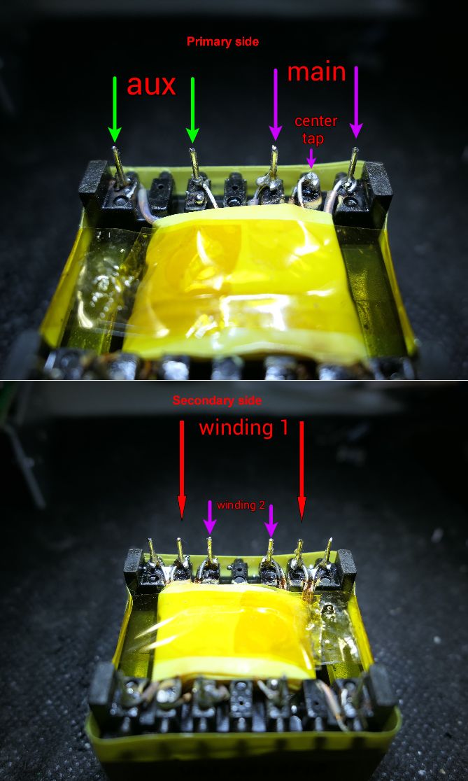

        First make a schematic of transformer windings on paper, using multimetar determine each coil and confirm no continuity to others coil, neither primary or secodary coils. On that schematic add note of all measurement you done.
        On pcb the secondary is all connected, but it seems there is a separate 2 coils. If one of coils is defect, and parallel connected to good one, nothing gona work.
        And get rid of all this solder balls around pins!
        I thing that on secondary is two coils, but check.
        On primary main coil is probably center tap, and it should be on half resistance from each side. I see suspicious markings on center tap pin, just like sparking...?

          The secondary side likely has 3 separate windings to supply the higher current (10a)
          The primary side has the feedback winding (blue) and the main primary winding which likely has a thermal fuse, the middle pin is where one end of the thermal fuse is connected.
          The primary fuse is likely between A & B or B & C The primary winding will be between the other pins

            I agree with RJ. That’s how I see the transformer construction too. Showing a short with the ring tester on the primary winding, it’s game over.
            It does make sense, since everything else on the board has been triple and quadruple checked in wich ever what way, plus the primary had blown components.

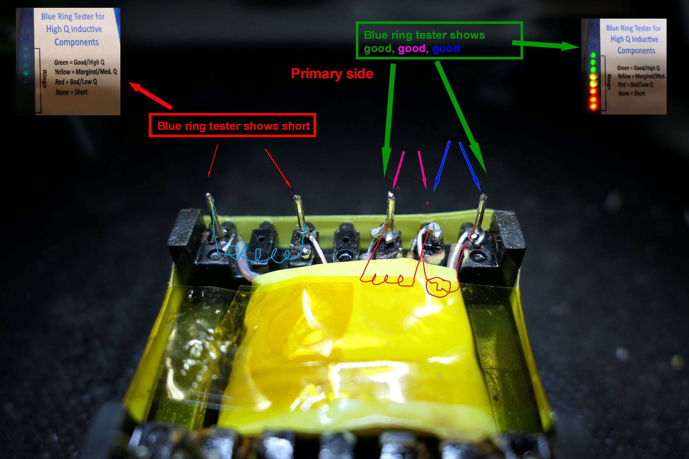

              Well, not very good news as one of the primary windings shows a tremendous short!
              When measuring with ohmmeter, the shorted winding gives me .1 ohm, but then the good windings also give me .1 ohms.
              So I guess we're toast?

                  This short-circuited turns meter measures only the primary (power) winding, it will not show on all other (secondary) windings.

                      Lotas you're right, Momaka gave me an idea and I pulled 2 other transformers from scap boards with pretty much the same winding configuration on the primary side, and both show the exact same results. So in the end, I think my transformer is good, the problem is elsewhere, but where??

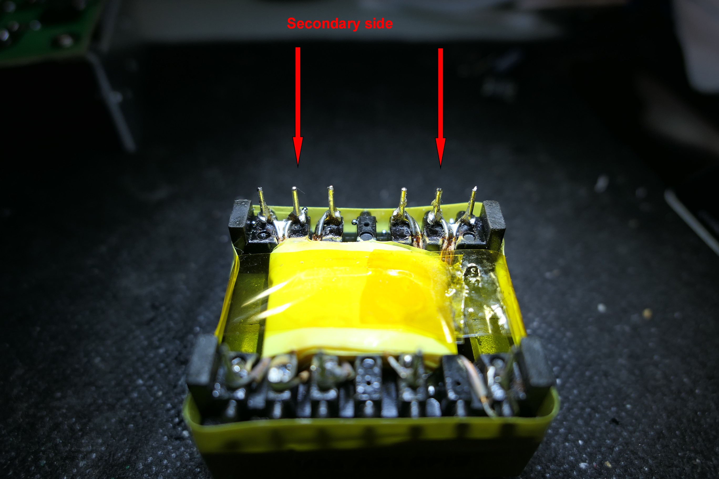

                            The secondary windings should measure close to a short less wire and thicker. The primary winding should show somewhat of a resistance since it has the longest wire. Look up at how a switching transformer is constructed. There are quite a few variables like wire length, thickness and coating thickness. When a primary measuring the same at 0.1 ohm like a secondary, I smell fish.
                            I do have another idea. Measure the inductance of the primary and secondary if you can.

                                Ok, the primary being the one on the right in the photo (I think) measures 465 uH and the secondary measures 17.03 uH. When I measure another transforer I have with same configuration, I get 474 uH on the primary and 17.03uH on the secondary. Not sure what that means however?

                                      Ok. So this is what I would expect. The primary winding is good then. The auxiliary winding would show a short as the wire length is much shorter than the primary one. The secondary probably shows a short too, since the wire length is also short and a thicker wire is used. Plus you actually measured 3 windings at the same time.
                                      More uH means more inductance, which also means more wire turns.
