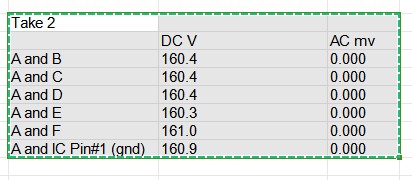

    Ok, redid the readings with my other multimeter, and this is what I get (see photo).

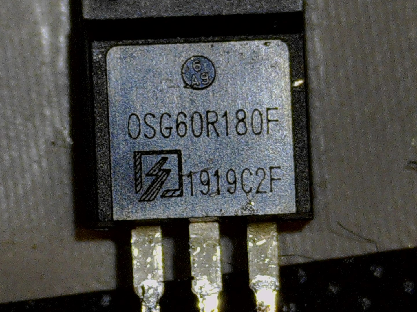

      Also, after taking the readings, I took out the mosfet on the primary side and here's a photo, and the readings it gives me in my component tester (there are 3 screens).

        Now run this PSU without the mosfet and measure the pins on the PWM

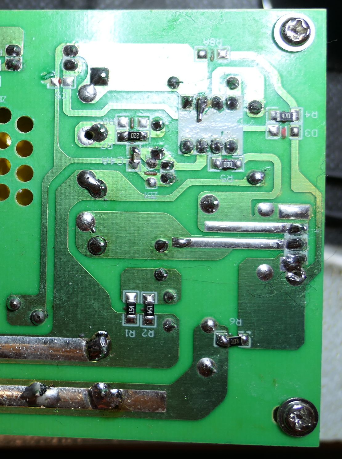

          Btw fix that solder joint on point A. Looks to me suspicious. Matter effect reflow all them solder joints that you
          A: didn’t touch yet
          B: looking shady like point A in the picture.

            Ok, so took the readings on the PWM without the primary mosfet in and fixed the suspicious solder joints (I think I've now reflowed the whole board ):

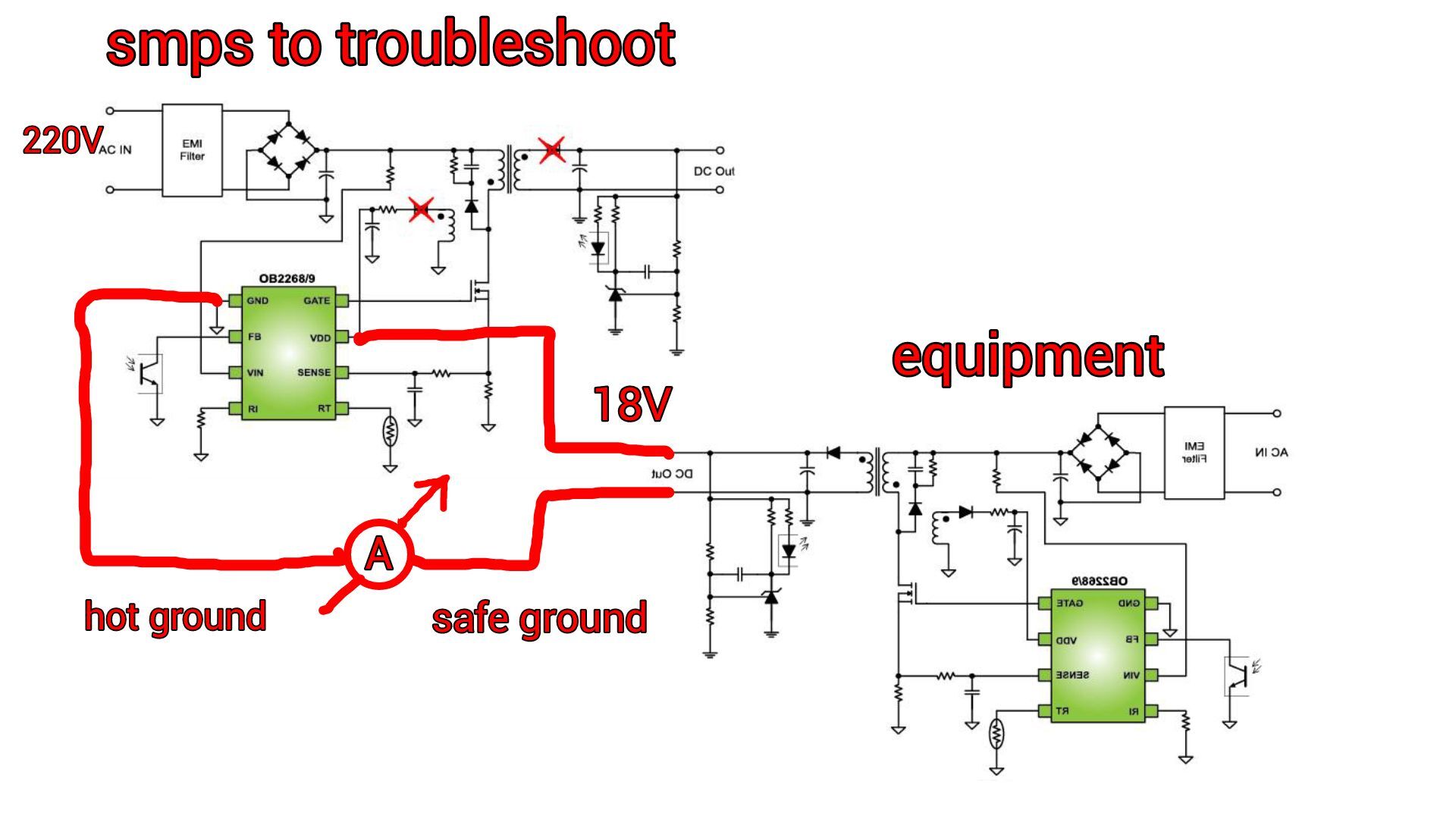

                                          Originally posted by R_J
                                          Re: 12V 10A CCTV camera system power supply pulsating
                                          You can NOT feed an external voltage to pin 7, If you connect an external power supply ground to this power supply HOT ground you will blow it up.
                                          R_J, can you please explain how exactly external psu will blow it up, current pathway?
