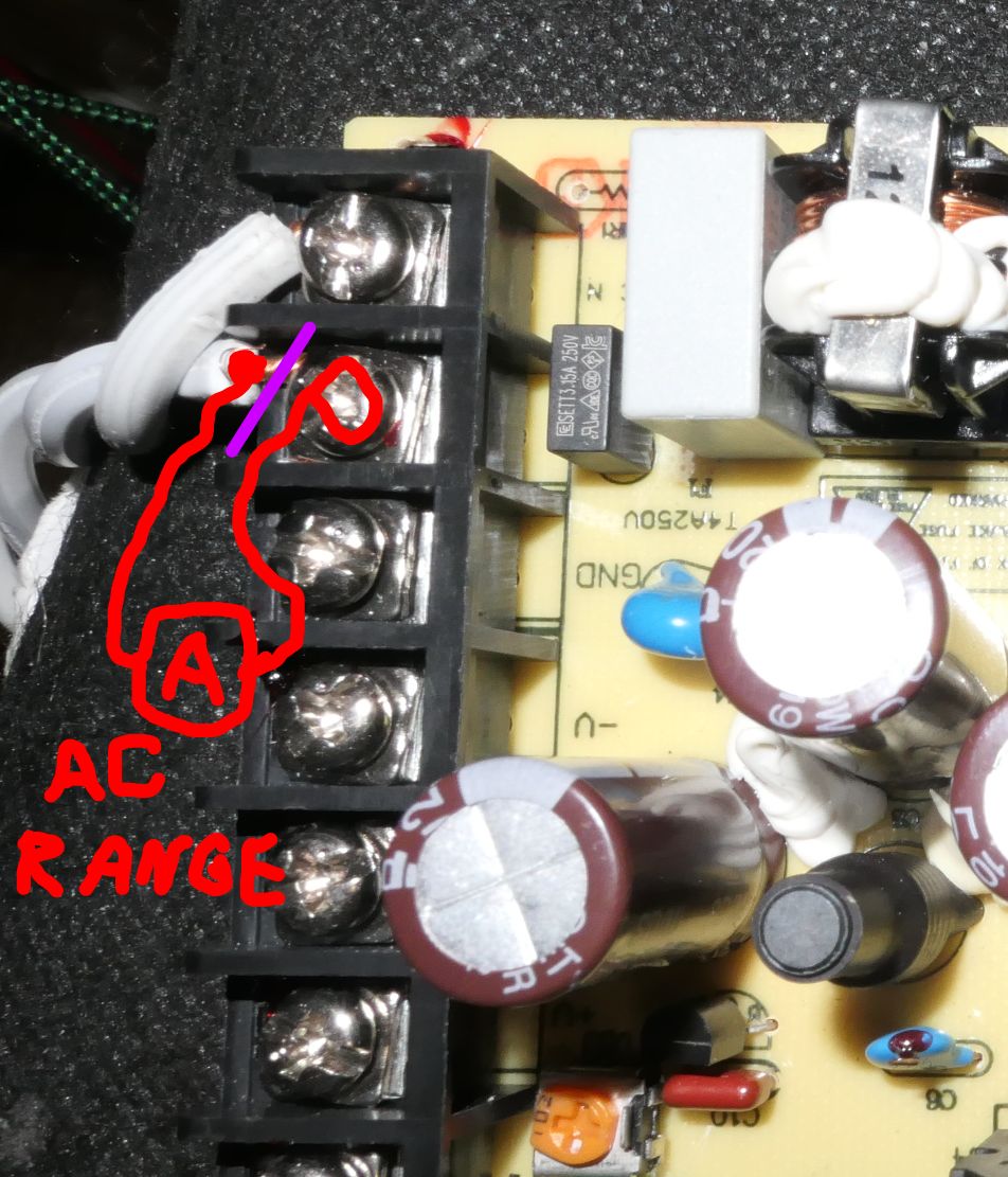

                          Re: 12V 10A CCTV camera system power supply pulsating
                          Originally posted by rddube
                          Ok, checked and it oscillates between 98 hz to 100.5 hz, that is hz, not khz.
                          did you have a load connected to dc output ?
                          • rddube
                            Aspiring Expert
                            • Jun 2013
                            • 908
                            #193
                            Yes a 12V fan
                            • harp
                              • Jun 2022
                              • 584
                              • Planet Earth
                              #194
                              Just put AC ampermeter in series with one cord, be sure to set it in 10A range.
