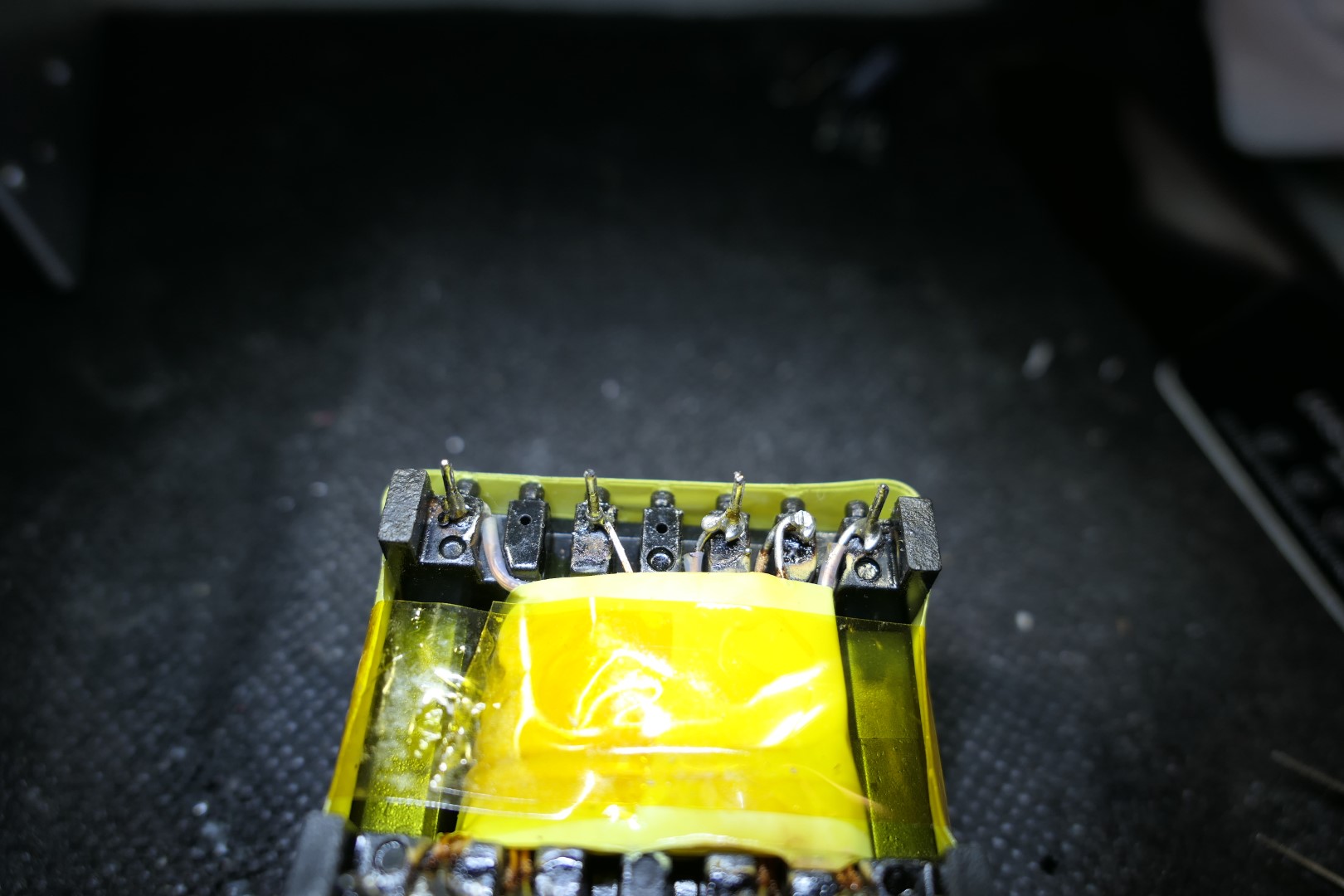

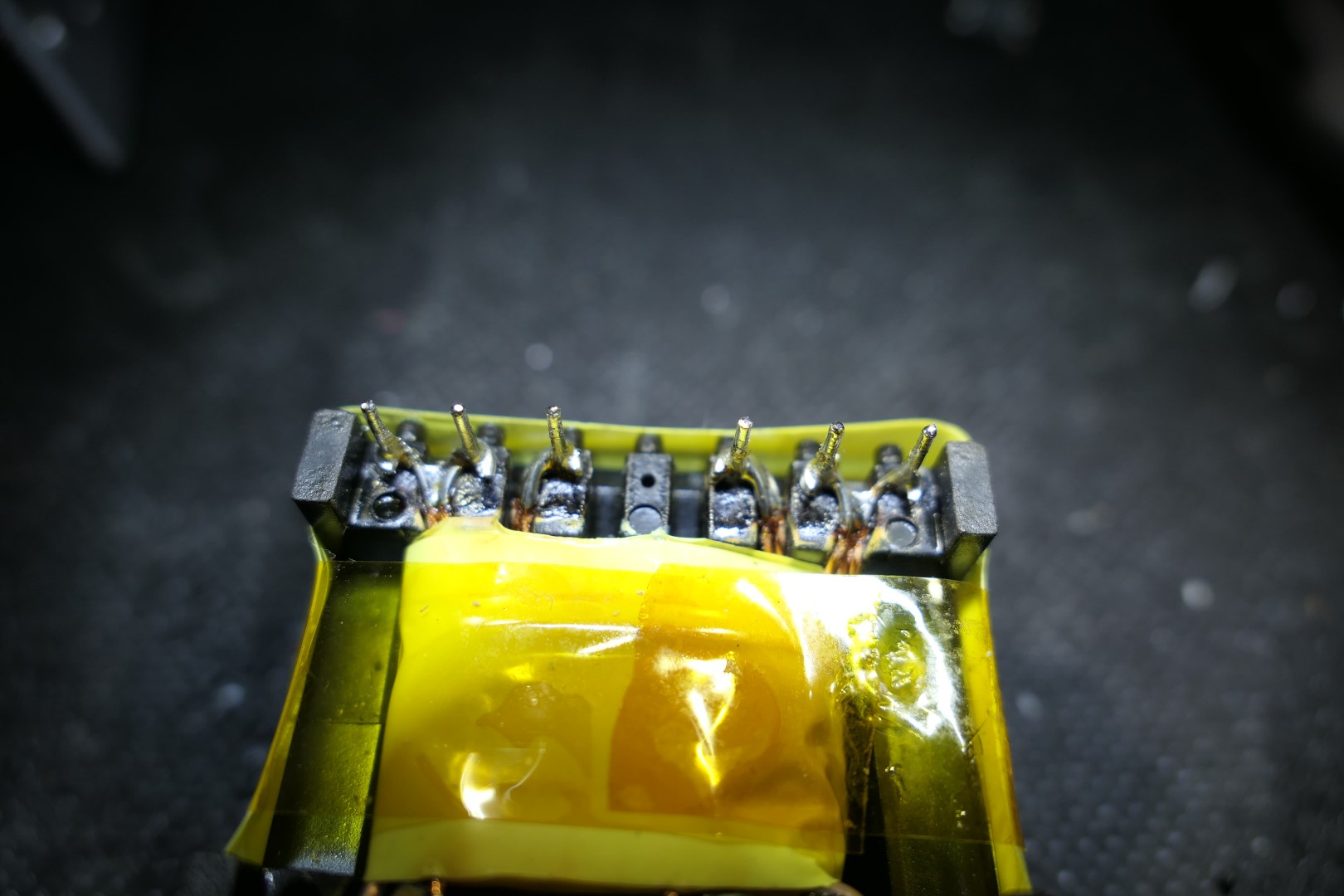

    Re: 12V 10A CCTV camera system power supply pulsating
    Make sure the transformer windings didn’t brake off from the legs.
    • rddube
      Aspiring Expert
      • Jun 2013
      • 907
      #102
      So removed transformer, checked continuity for all the legs, redid the solder joints just in case, re-checked continuity between windings and legs. Reinstalled, tested and same result.

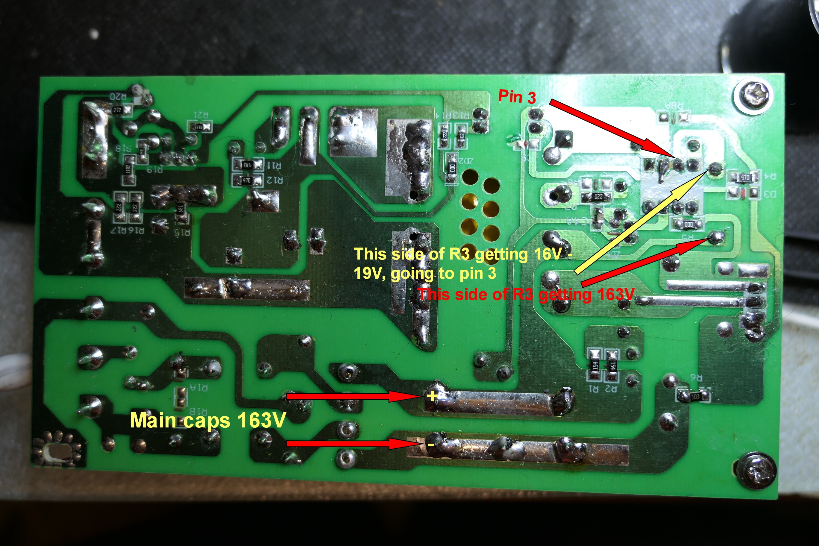

          looked at the datasheet.
          pin3 is not getting power - if it follows the example then it's just a resistor or 2 to the rectified mains - check that.

              Not sure I understand, pin 3 is getting from 16V to 19V coming from those 2 large caps, going through the 1.5M ohm resistor?

                    the first problem is pin3 not getting power
                    if the main caps are stable at about 160v or 340v if it's a doubler, then you need to check the traces and resistor to pin3
                                Originally posted by rddube
                                Do you really mean pin 3? The main cap is getting 160V and on one end of R3 getting 163V, while the other end of R3 (1.5M ohm) going to pin 3 is oscillating between 16V to 19V.
                                well thats good - i wonder why it's oscillating.
                                maybe the chip is trying to drive a short circuit
                                        Originally posted by harp
                                        Found working voltage on ic OB2269
                                        If you disconnect psu from mains, and remove secondary output diode and then feed adjustable 10-14v to output terminals, so that tl431 circuit is working, you can monitor opto transistor resistance (primary side) and confirm that switch on at 12v point. Set on 12v with trimpot 1K.
                                        If this is ok... so 12v connected is to output without diode and optocoupler working.
                                        When you connected psu in mains like in that condition, what is voltage on each ic pin, is they still pulsating or not?
                                        If they are still pulsating, and energy on secondary is independed, regulated and calm, that prove that problem is on primary side.
                                        On primary is generaly main windings and aux... and then we must find a way to separate one from another... maybe is transformer windings problem, if you have ringing tester you can confirm that.
                                        Ok, so did the above test - removed secondary output diode, injected 12V on the output and took measurements of optocoupler resistance primary side:
                                        No voltage applied (power off) - 3.191K ohms
                                        10V applied - 1.086Mohms
                                        12V applied - 1.086Mohms
                                        13.3V applied 1.088Mohms
                                        Took out the voltage from the output, left the secondary diode out and plugged into mains, readings on the chip:
                                        Pin 1 - Gnd
                                        Pin 2 - .03V - 5V jumping around erratically
                                        Pin 3 - .14V to 19V jumping around erratically
                                        Pin 4 - 0V - 1.9V jumping around erratically
                                        Pin 5 - .2V to 4.6V jumping around erratically
                                        Pin 7 - 11V - 22V jumping around erratically
                                        Pin 8 - .01V - .28V jumping around erratically
                                        Will reinstall the ouput diode and do the tests that Petehall437 just asked.
                                          • 30911
                                          #120
                                          pin3 should not be eratic - it should be a stable voltage from that resistor-dropped mains
