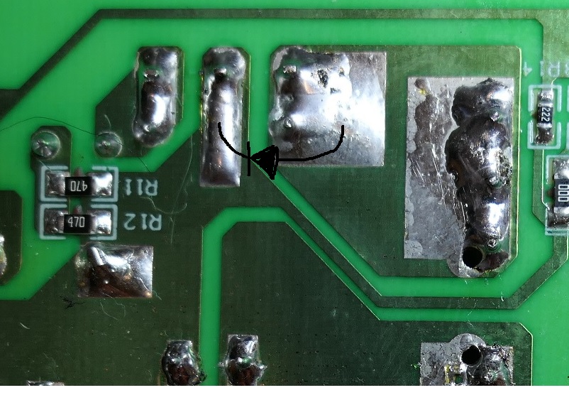

            I would remove the output diode and replace it with a single diode even a 1 amp should be fine for a test without load, maybe it is breaking down under even a small amount of current.

              Boy R_J you are creative, I love that! Ok, so I see what you mean...what does the other diode serve for? I might have some replacement diodes I used once to repair another type of power supply, I'll check and give you the references before installing anything.
              Ok so I checked and what's there is a sr30100ct, datasheet attached. Can I install any type of diode where you indicated?

                I think the one that is in there SR30100ct is a dual 30A Shotcky diode. I have some EN220A (20A I believe) or some MBR2020CT or individual SB5200TA.

                    Without feedback from the secondary, the feedback pin would go high to 6v and the ic would detect that and at 4.4v it would go into power limiting mode. you might be able to install a resistor from FB to hot ground without the opto, but I'm not sure what value would hold it to about 3v
                    As for the diode I suggested, this is just to test the circuit, it doesn't need to supply 10 amps of current just to test the circuit.

                      So R_J for the test, should I use MBR2020CT (dual diode) or individual SB5200TA (5A) like you indicated in the photo?

                        You can use either one I would just use an individual diode, The other section of the dual diode would not be necessary for this test, this is just to eliminate the dual diode as being the problem. We are running out of components to suspect.
                            Ok, removed the output diode and installed a single diode 5 amps, and the result is similart oscillating at a lower voltage i.e. from 2.8V to 4.5V erratically and everything in between.
