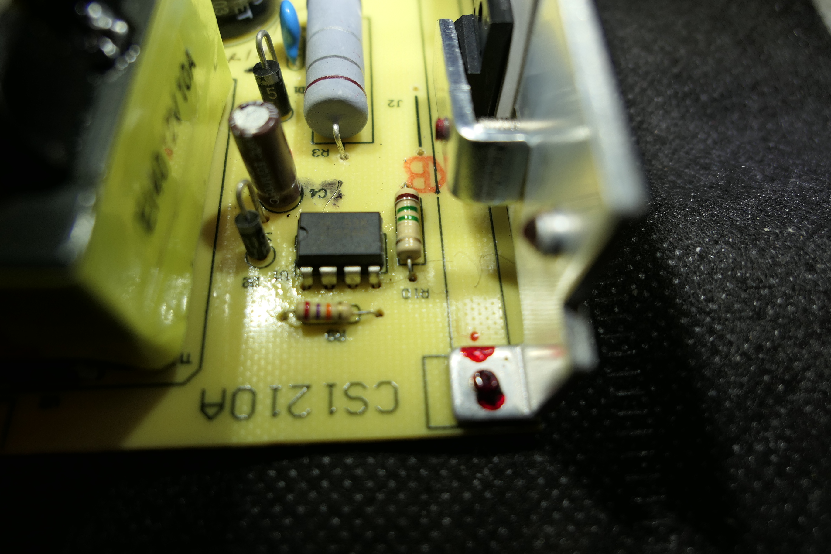

                        So I started to concentrate on the resistors, and especially R10. Very very weird, but maybe it's normal R10 is a 1.5Mohms resistor. When I measure it with probes on each side, I get a reading of 1.239Mohms. When I turn my probes around, believe it or not, I get no reading (see photo of my multimeter).?? What is going on?? Thank you gentlemen for all your help, learning a lot from this little experience!

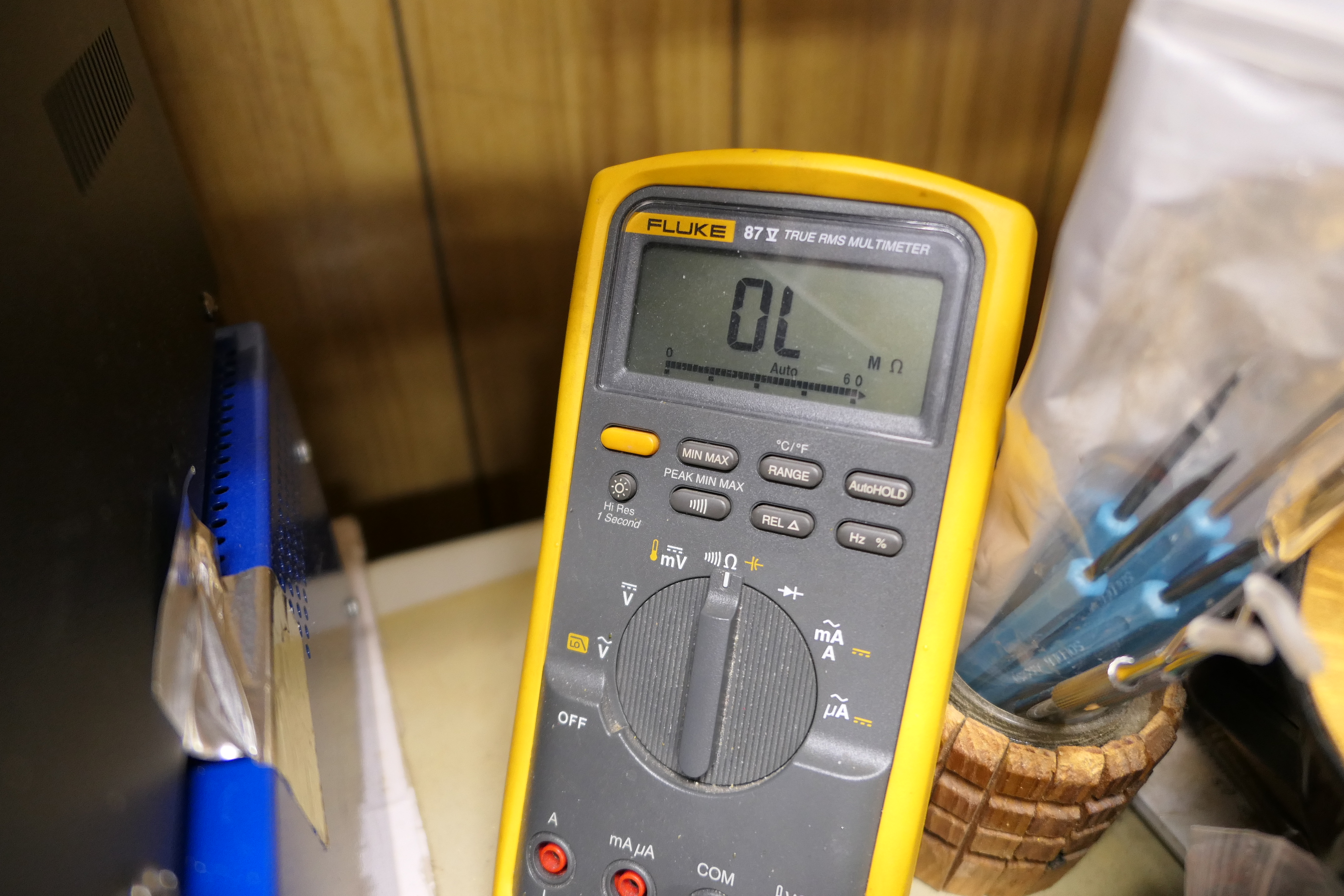

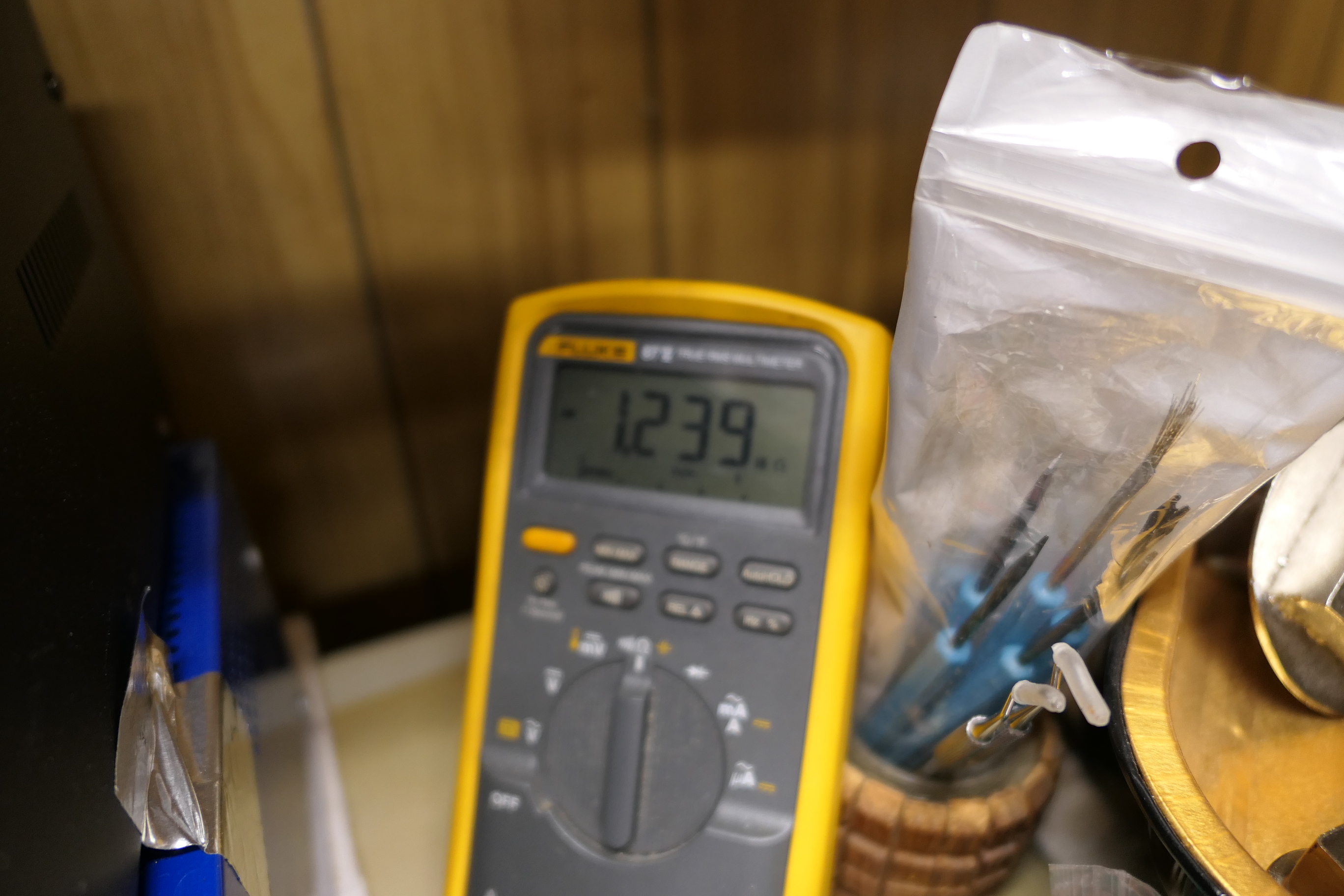

                          Ok, so I removed R10 and it measures 1.5Mohm both sides. On the board, if I put the black probe going to pin 3 from that resistor side and the red probe on the other side of where the resistor connects I get 435Kohm reading. When I switch the probes around, I get 10Mohms reading.
                          Not sure what that means.

                            Voltages on the PWM relative to the negative of the bulk capacitors:
                            Pin 1: GND
                            Pin 2: .1V to .3V oscillating
                            Pin 3: 16V to 19V oscillating
                            Pin 4: 0V to 1.3V jumping around sometimes to 3.2V
                            Pin 5: same as pin 4
                            Pin 6: 0V, sometimes shows .1V or .2V then 0V
                            Pin 7: Oscillating between 11V and 15V
                            Pin 8: .001V
