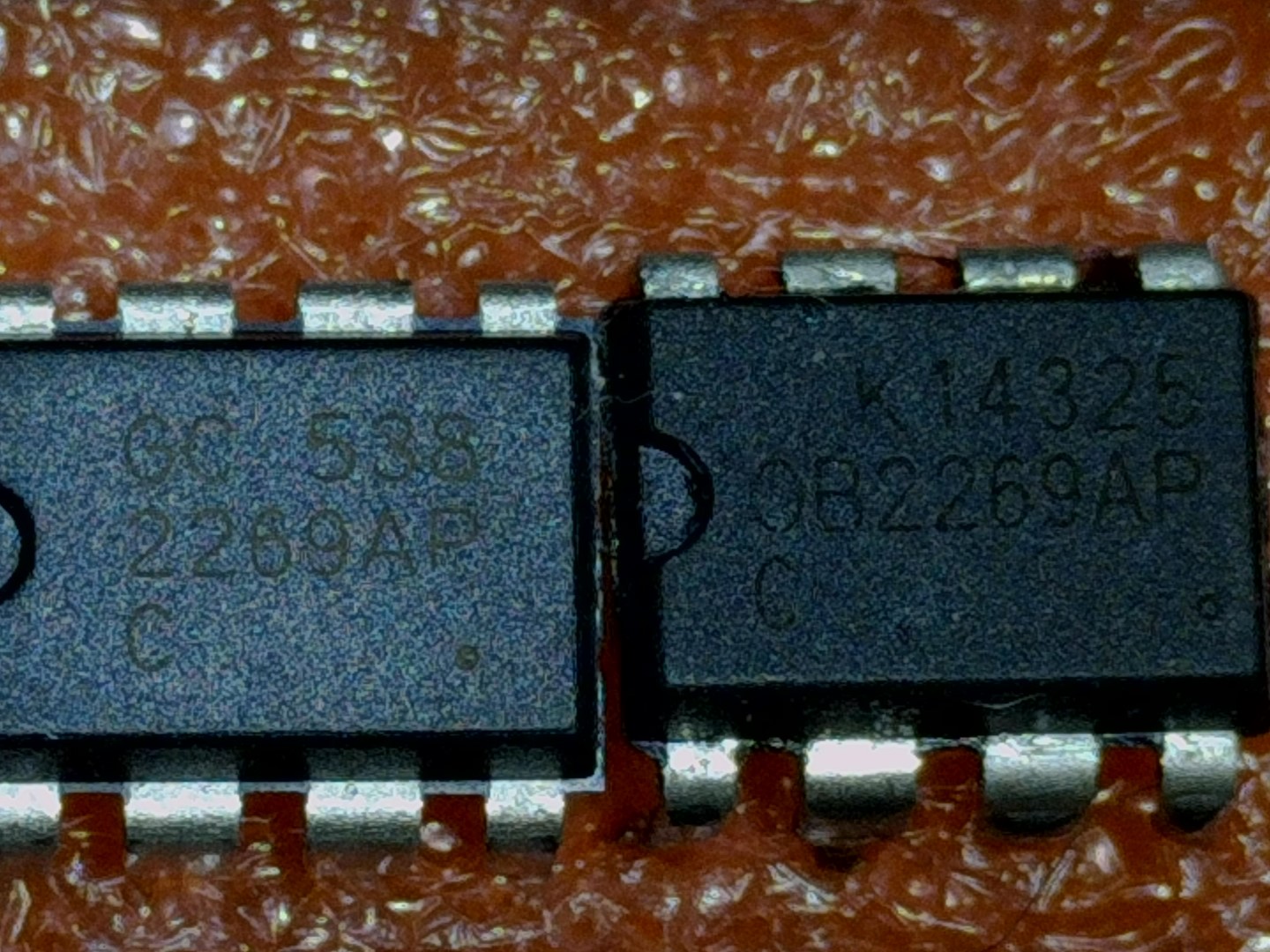

            D2, I'm on my 3rd one...do you think it could be the chip itself? The one in there is a 3rd one, but I got 5 of them when I ordered them. The thing is is that the pads that hold the chip are getting weaker and weaker (I have to bridge a lot with solder to make a good connection).

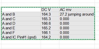

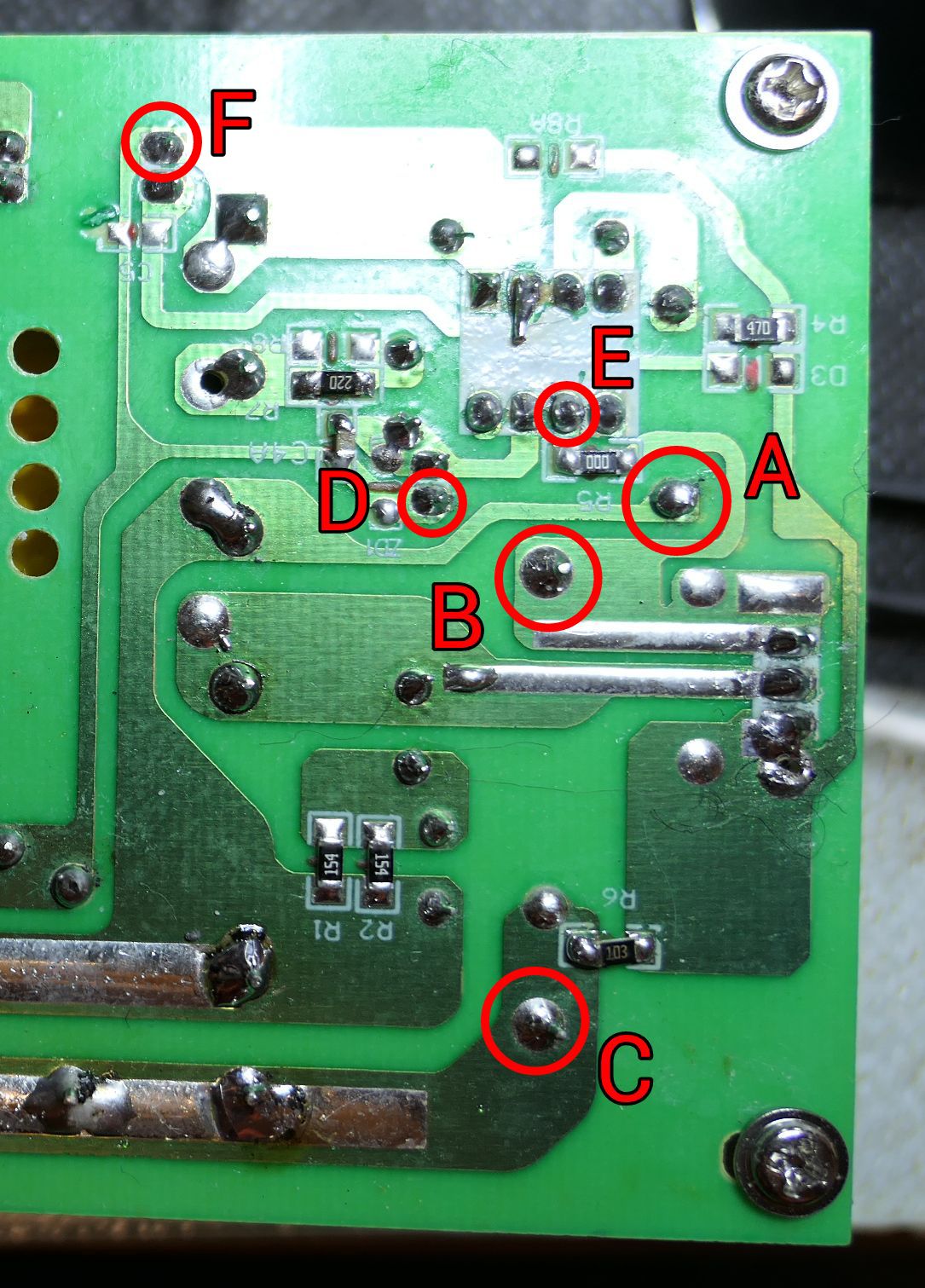

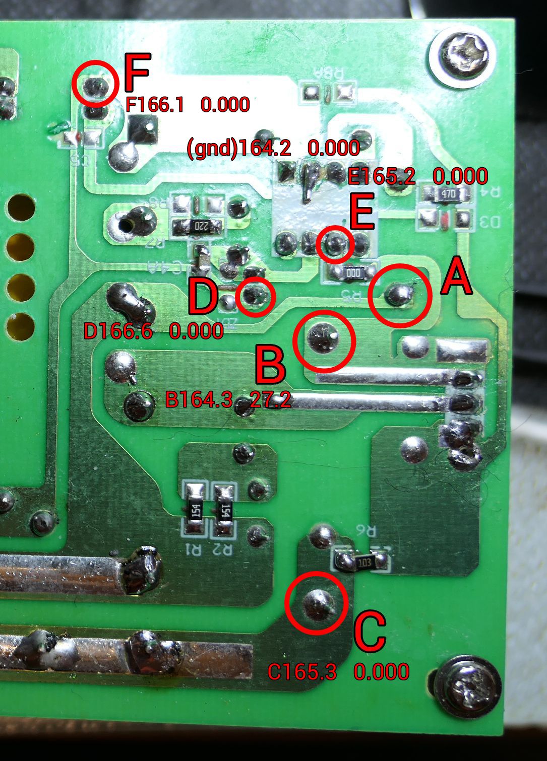

                                    OK, here are the measurements with 100k resistor installed:
                                    DC V AC mv
                                    A and B 164.3 27.2 jumping around
                                    A and C 165.3 0.000
                                    A and D 166.6 0.000
                                    A and E 165.2 0.000
                                    A and F 166.1 0.000
                                    A and IC Pin#1 (gnd) 164.2 0.000
                                    Might be cleared and better aligned on the photo.

                                        before do anithing, do exactly one more time very same measurement, write data to compare.
                                        my analisy
                                        point A is far end of +, our reference of this test
                                        probing ground
                                        point D is maximum 166.6 through jumper wire
                                        point F slightly lower 166.1
                                        pin#1 dramaticaly lower 164.2, on sam plane with F, were is 2v lost?!?
                                        point C near cap 165.3... something is pulling it down (mosfet try switch)
                                        point B 164.3 (27.2mV ripple present)
                                        point E 165.2 no ripple! there is only a 000 resistor between point E and B.
                                        So, check what is going on between point F and pin#1, also point B and E, where is lost 1v and ripple? Check 000 resistor, it is not posible it is ok.
                                        Is this make sense to you?

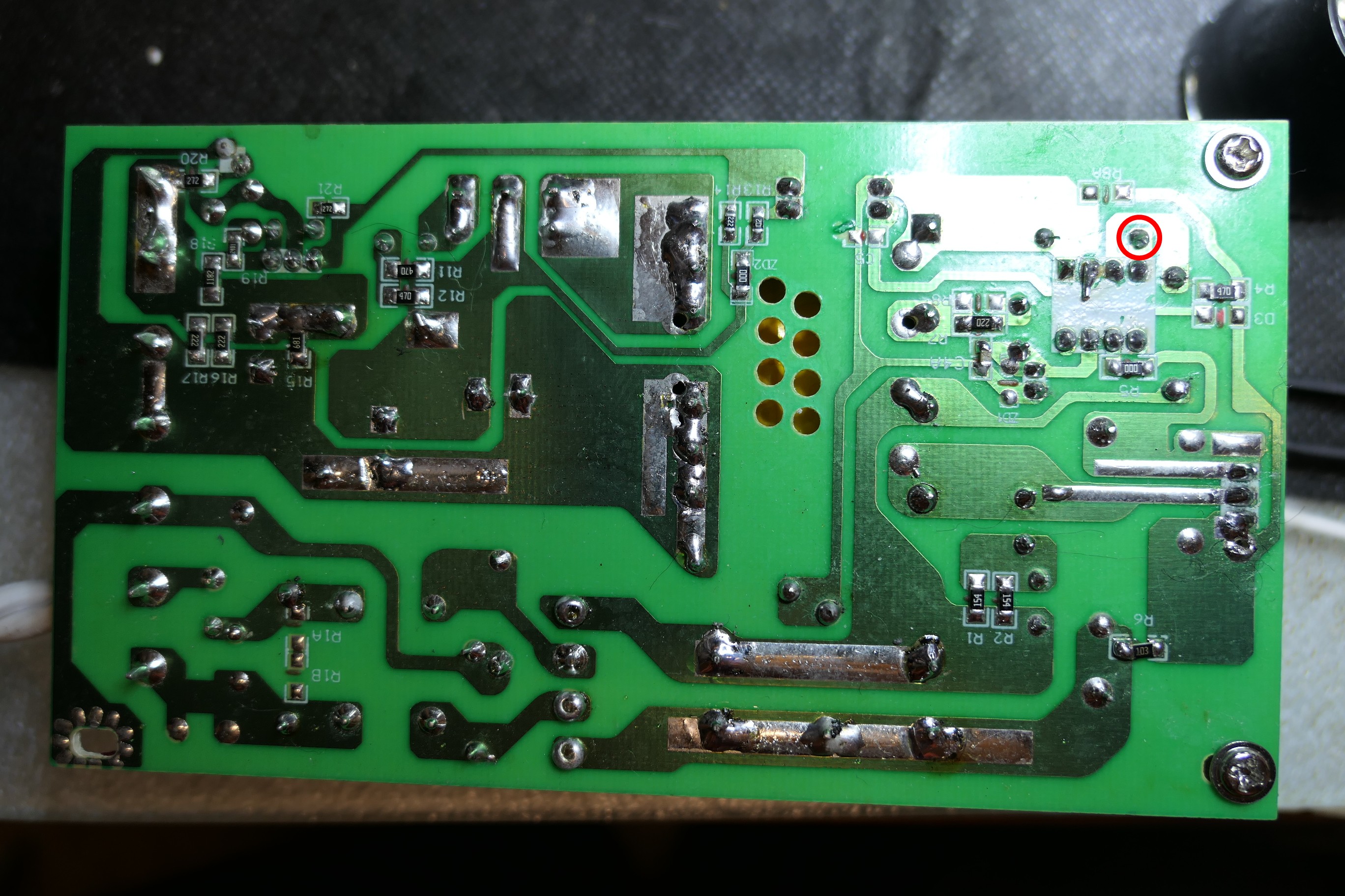

                                        Your board may suffer of circular crack arround solder point, and when you measure this, you push it with probe and connect again with track, and all seems ok, but it is intermitten.
                                          Very funny you say this Harp, as when I initially took out the board on this PSU, I noticed a cold solder joint on the R9 leg shown in the picture. At first it looked like a cold solder, but now that you mention this (circular crack), I think that's what it was! And the board is very fragile in that area as I mentionned, around the legs of the IC using my Hakko desoldering tool, it removed some of the traces, so I think I should almost do an Xray examination!
