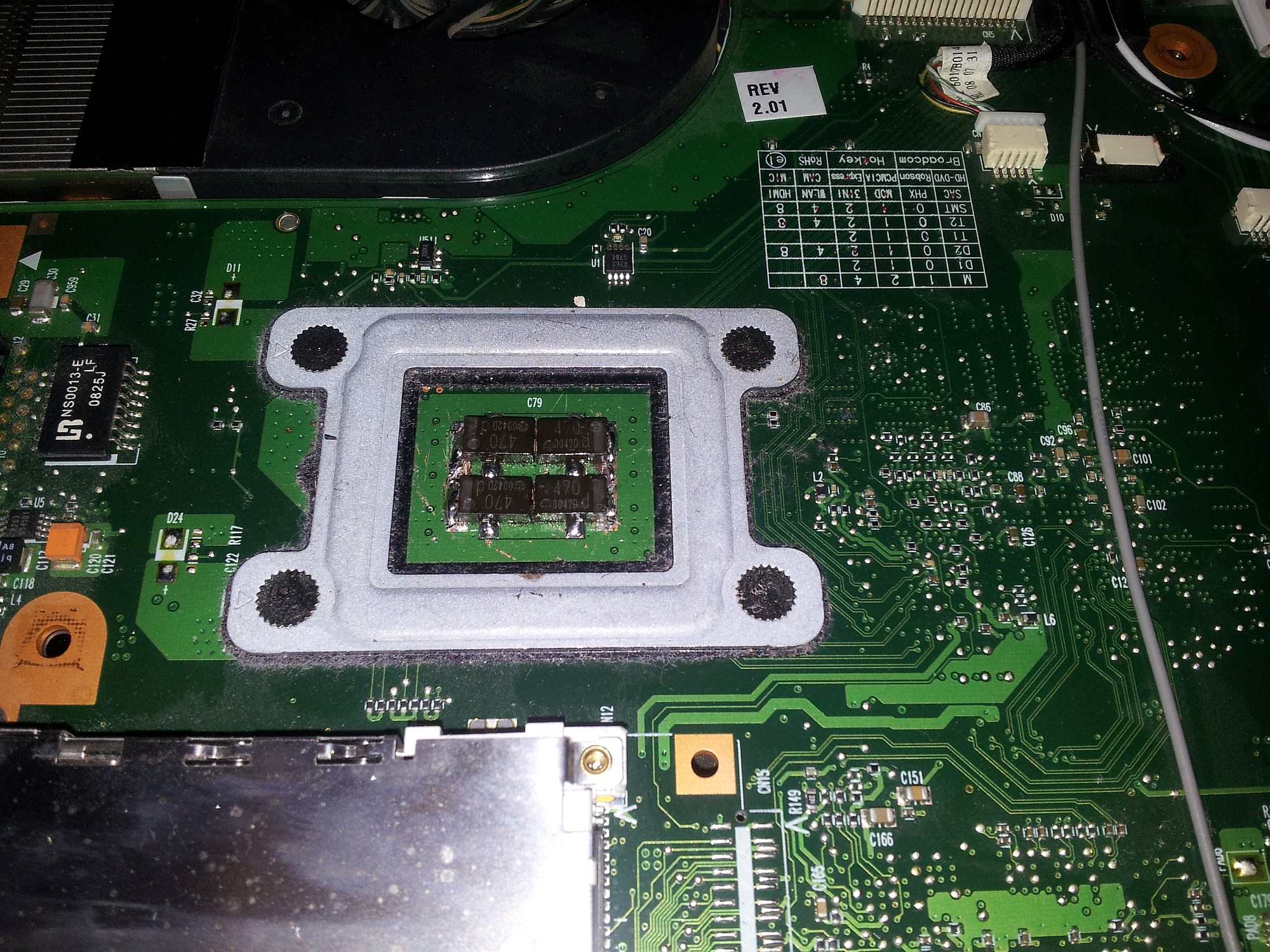

            This question has a Toshiba L300 laptop is a known problem in our country are sold only tantalum capacitors 330 microfarads 6,3v or 10 volts suit if they return 2.5V.

              whether you can put 4 x 330 uF 6,3v?

                Yes you can use 330uF 6.3v.

                      VISHAY 293D337X96R3D2TE3 SMD D (7343-31)
                      Размер корпуса, LWH (мм) 7,30x4,30x2,90
                      Емкость 330uF
                      Допуск (±%) 10
                      Рабочее напряжение (В) 6,3
                      Рабочая температура (°С) -55…125°C
                      • mockingbird
                        • Dec 2008
                        • 5484
                        #851
                        Re: Toshiba Satellite - Locks up when plugged in
                        Емкость 330uF
                        Допуск (±%) 10
                        No!
                        Only 0.60 ESR and 500mA ripple rating. Not good enough.

                            Part number is OK, but Aliexpress will send you fake parts.
                            I have Kemet A700:
                            Part number: A700X477M2R5ATE010
                            2V 470uF ESR 10mOhm Ripple 4700mA (Dimensions: 7.3mm 4.3mm 4.0mm)
                            Part number: A700X277M004ATE015
                            4V 270uF ESR 15mOhm Ripple 3900mA (Dimensions: 7.3mm 4.3mm 4.0mm)
                            Please note that these are "X" size case, and they are taller than "V" size (2.0mm) and "D" size (2.8). So I don't know if they will fit.

                                  Hi i have replace the nec tokin with 4 330uf 2.5v tantalium capacitor on my toshiba a300-20w but the laptop is working ok only without the battery, when i have connect the battery and the charger the laptop shutdown unexpected. Any advice?

                                      Are you saying that the laptop works normally when powered from the charger only?

                                        Yes, i use this capacitor from ebay maybe is crap but i remember that i have use it again without problem

                                          Im still trying to make sense of this. While the laptop is being powered from the charger only, what happens when you insert the battery?
