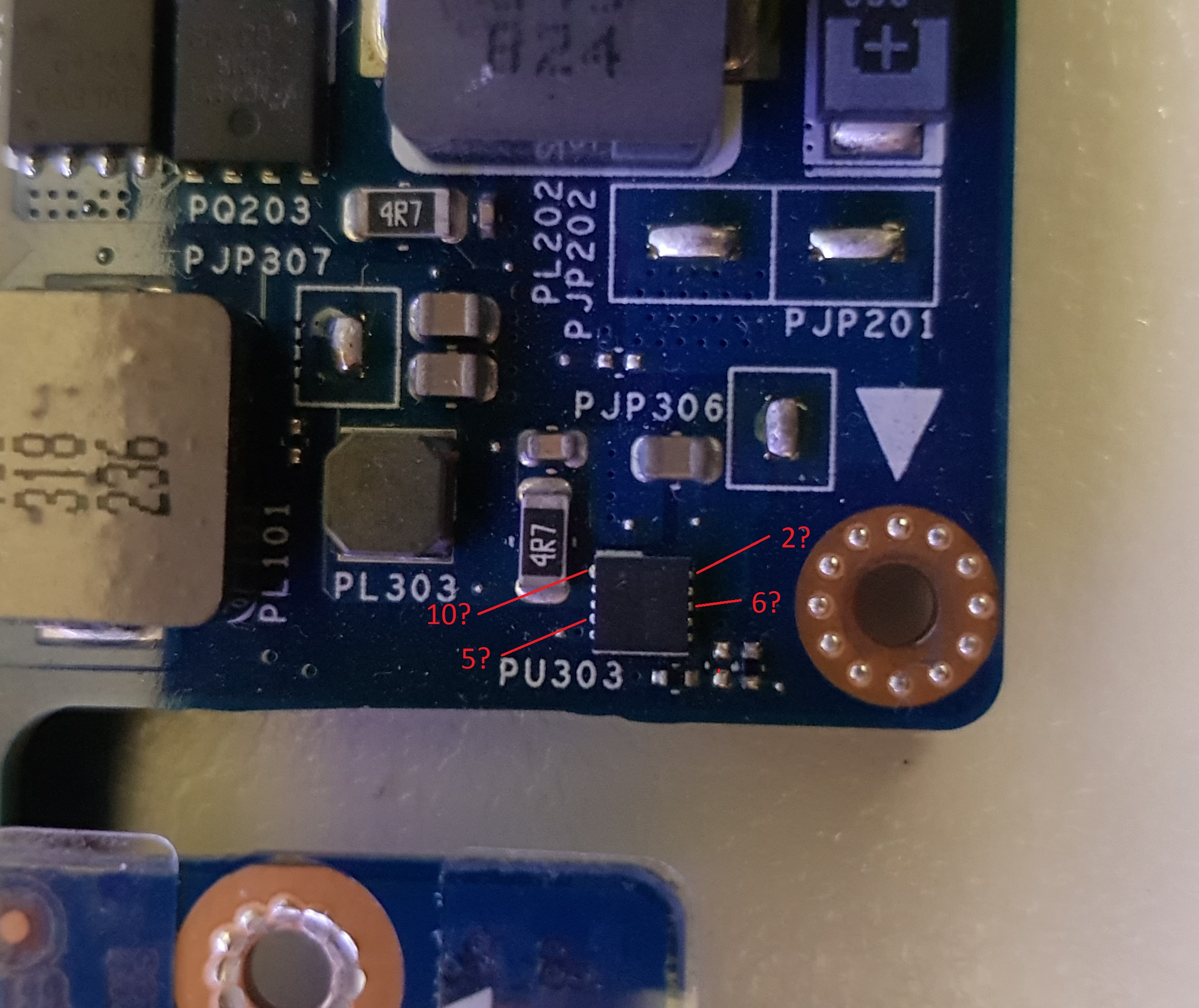

            now go to page55 and measure voltage on pins 2,5,6,10 of PU303 after turning on.
            report if you observe a temporary voltage on PL303 just after turning on.
              Re: Alienware M14x R2 with 7 beeps error
              Ether I've done this wrong or it's very odd
              PU303 is very small and unsure if they're the correct pins
              pin 2 - 3.322V
              pin 5 - 155.5mV and keeps riseing/fluctuating
              pin 6 - 3.322V
              pin 10 - 0.1mV
              PL303 - first on 0.8mV
              0.5mV
                Is this correct?

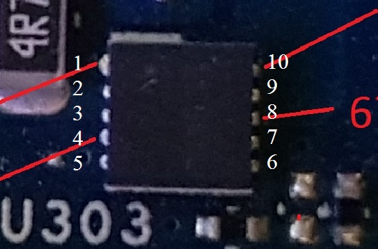

                  Originally posted by Johndill View Post
                  Is this correct?
                  no pins are not ordered like this on any IC.
                    I corrected the pin numbers.
                      #30
                      Thanks :-)
                      PU303
                      pin 2 - 1.497V
                      pin 5 - 3.287V
                      pin 6 - 0.604V
                      pin 10 - 3.320V
