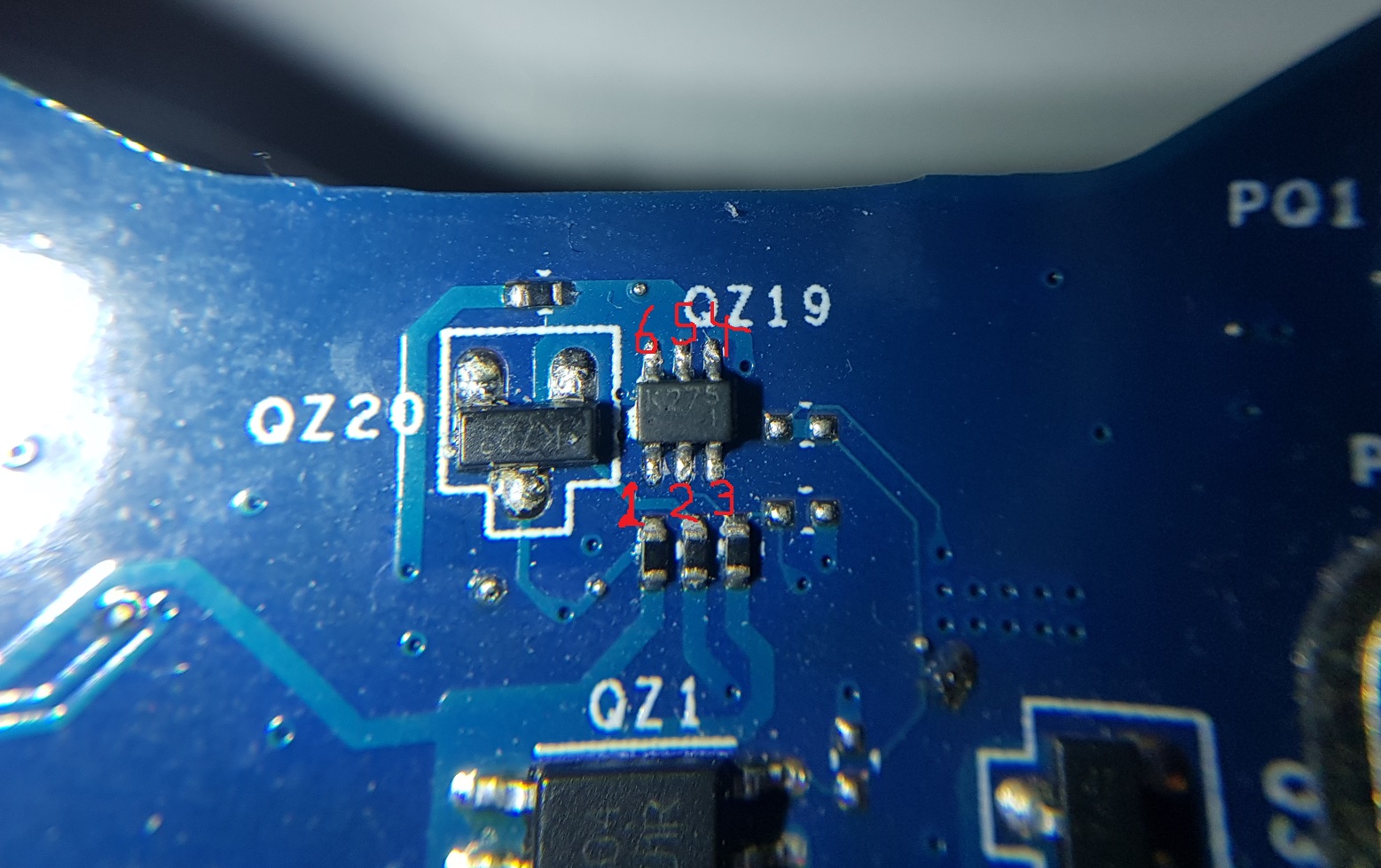

    so pu601 does not work yet.
    Now measure voltage on all pins of QZ19 and Q294 and QZ1.
    This laptop had multiple problems at different places. What did happen to it that made these problems?
    • Johndill
      • Aug 2015
      • 314
      #182
      Re: Alienware M14x R2 with 7 beeps error
      Looks like QZ1 is not converting to 3VSDGPU, could be the line on pin 4 or QZ1 itself, perhaps a bad bach of IC's.
      Wasn't 100% sure on QZ19 pins so marked and measured from the picture.
      QZ19
      Pin1 - 0.0mV when not beeping, 0.1mV when 7 beeps sound
      Pin2 - 1.0mV when not beeping, 1.2mV when 7 beeps sound
      Pin3 - 1.1mV when not beeping, 1.3mV when 7 beeps sound
      Pin4 - 0.0mV when not beeping, 0.1mV when 7 beeps sound
      Pin5 - 3.282V
      Pin6 - 3.282V

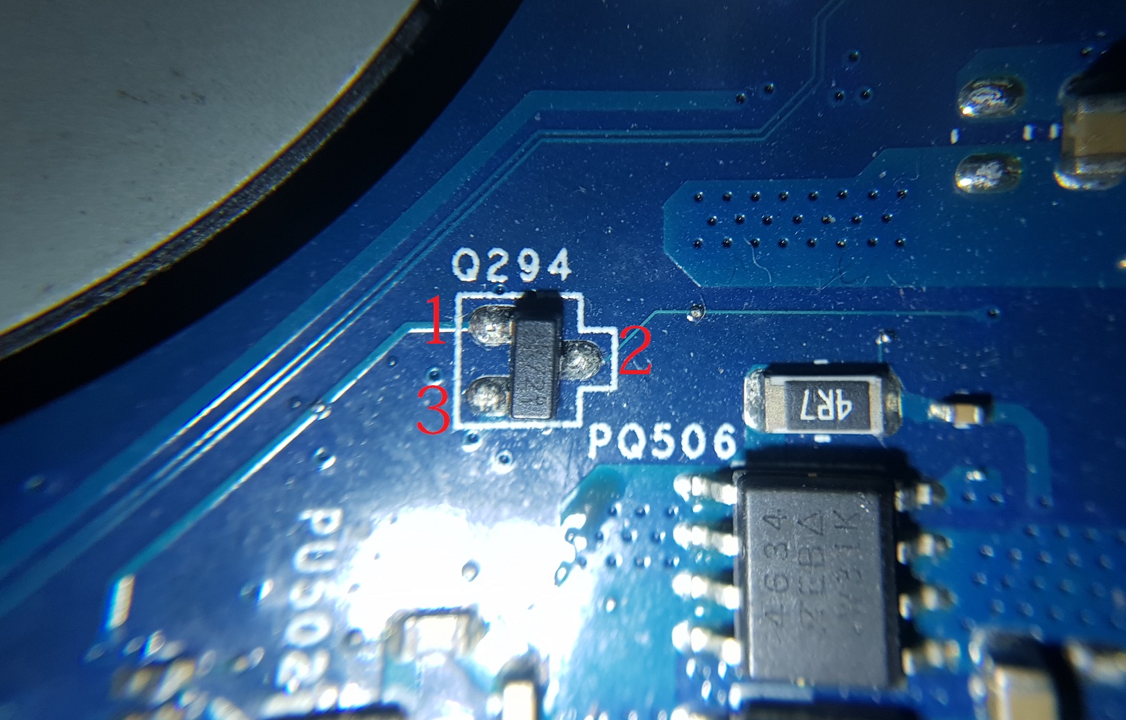

      Q294
      Pin1 - 3.319V
      Pin2 - 0.9mV when not beeping, 0.7mV when 7 beeps sound
      Pin3 - 0.0mV when not beeping, 0.1mV when 7 beeps sound
      Qz1
      Pin1 - 147.9mV when not beeping, 147.7mV when 7 beeps sound
      Pin2 - 147.9mV when not beeping, 147.7mV when 7 beeps sound
      Pin3 - 147.9mV when not beeping, 147.7mV when 7 beeps sound
      Pin4 - 1.4mV when not beeping, 1.2mV when 7 beeps sound
      Pin5 - 3.323V
      Pin6 - 3.323V
      Pin7 - 3.323V
      Pin8 - 3.323V

        please take a photo of Q294 too.
        • Johndill
          • Aug 2015
          • 314
          #184
          I think this is the way I measured it.

            Now check resistance between the following point pairs:
            - pin1 of Q294 and pin2 of QZ19
            - pin2 of Q294 and pin2 of QZ19
            - pin3 of Q294 and pin2 of QZ19

              pin1 of Q294 and pin2 of QZ19 - 18.11k ohms
              pin2 of Q294 and pin2 of QZ19 - juggles around 1.2 - 1.1 ohms
              pin3 of Q294 and pin2 of QZ19 - 16.35k ohms

                What you labeled "pin 1" of Q294 is the gate, according to the 2N7002K datasheet. So DGPU_PWR_EN# is high when it should be low.
                This signal comes from the PCH during BIOS initialization (well, I'm not even sure the dGPU turns on at startup on this board). It could be many things: display not detected, corrupt BIOS, bad PCH, something else preventing the BIOS from POSTing correctly.
                Try connecting an external display, on the VGA and the HDMI port.
                Also, check the voltage on PL702, and make sure BUF_CPU_RST# is present.

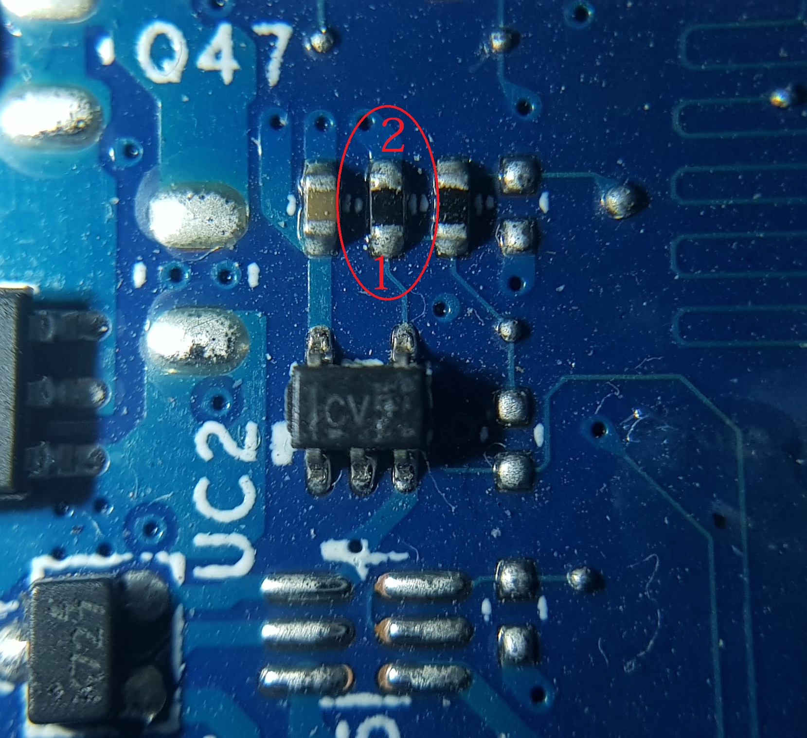

                              BUF_CPU_RST# is on pin2 of RC33.
                              if you do not find RC33, post a picture of UC2 to help you find it.
                              Is this RC33? Pin2 - 1.059V

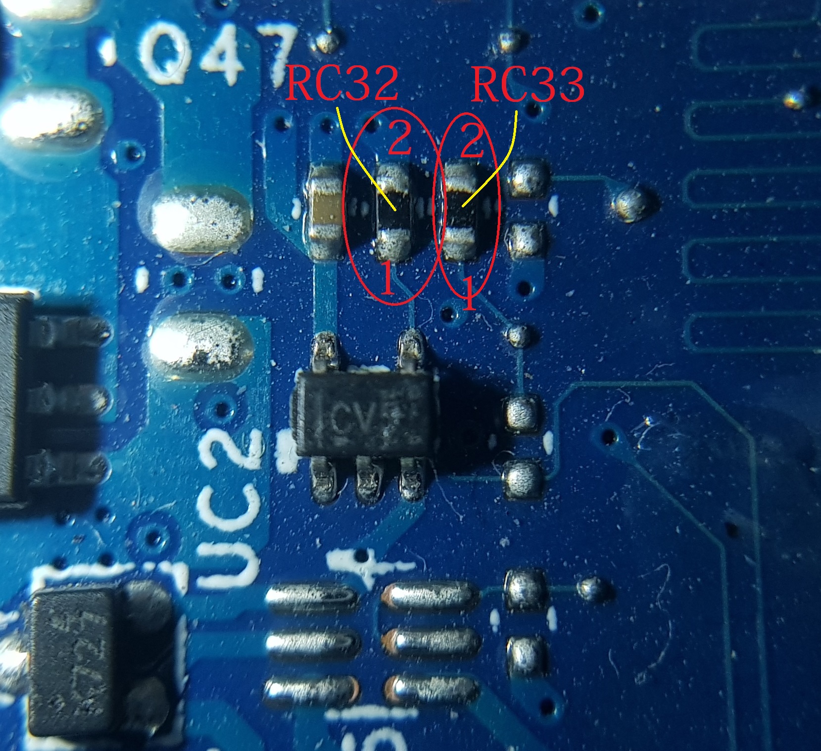

                                I think RC33 is the next black one beside the resistor which you measured.
                                to make sure, measure resistance between the two pins of each resistor.
                                then measure voltage on each side of them.
                                    You where correct, edited the picture.
                                    RC32 - 74.1 ohms
                                    Pin1 - 127.9mV and slowly rises
                                    Pin2 - 1.059V
                                    RC33 - 43.1 ohms
                                    Pin1 - same as RC32 pin1
                                    Pin2 - same as RC32 pin1

                                      So no BUF_CPU_RST#? That's weird.
                                      What's the voltage on PLT_RST# (UC2 pin 2, bottom center)? And on PCH_PLTRST (UH5 pin 1 and 2, left and center one on 3 pins side)?
