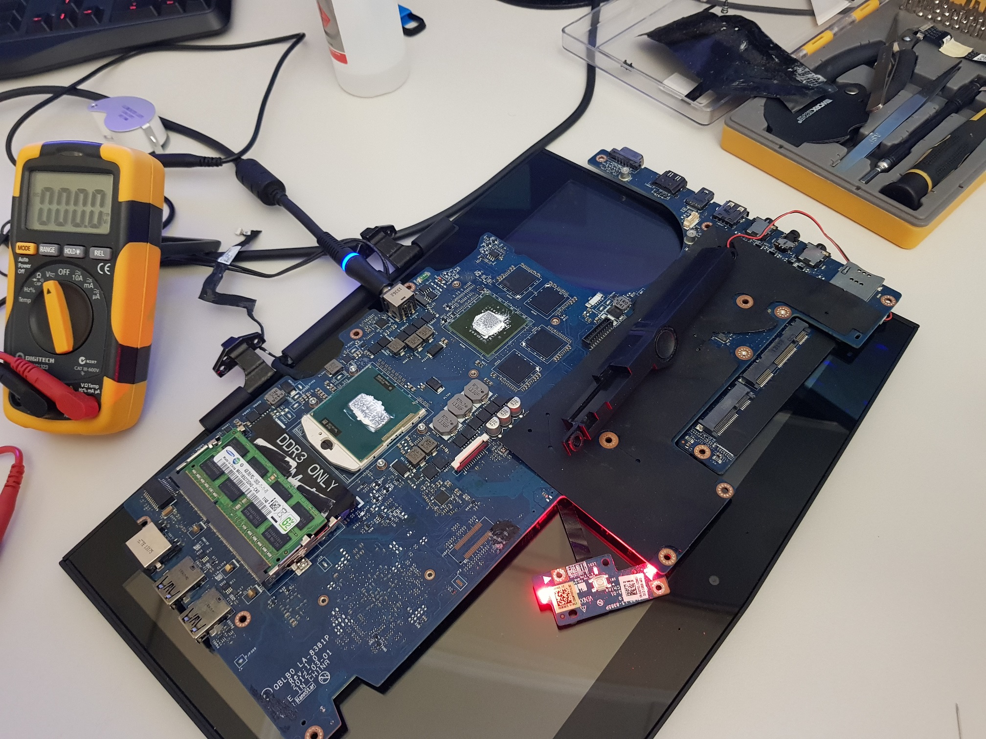

                            if you remove the cmos battery, it would be safe too.
                            The board is out of the casing as the components being tested are on the bottom of the board.

                              Re: Alienware M14x R2 with 7 beeps error
                              I'm still testing but I get slight fluctuations each time the 7 beeps start

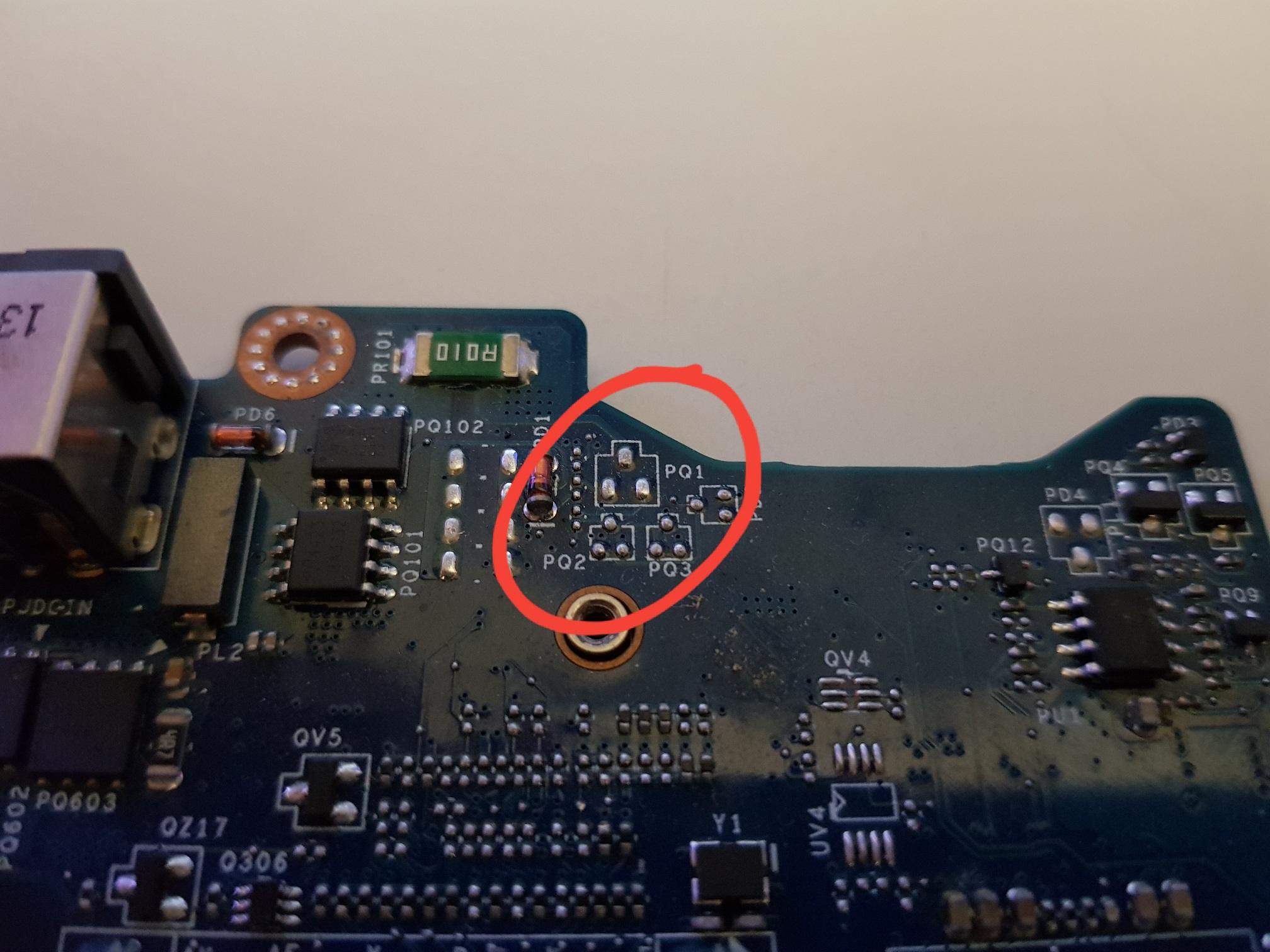

                                    to make sure, measure voltage on all the 3 pins of PQ1.
                                    and read the voltage written on the AC adapter brick.
                                    PQ1 has no component from factory, what do I do with it?
                                      #78
                                        instead, measure voltage on PL102.
